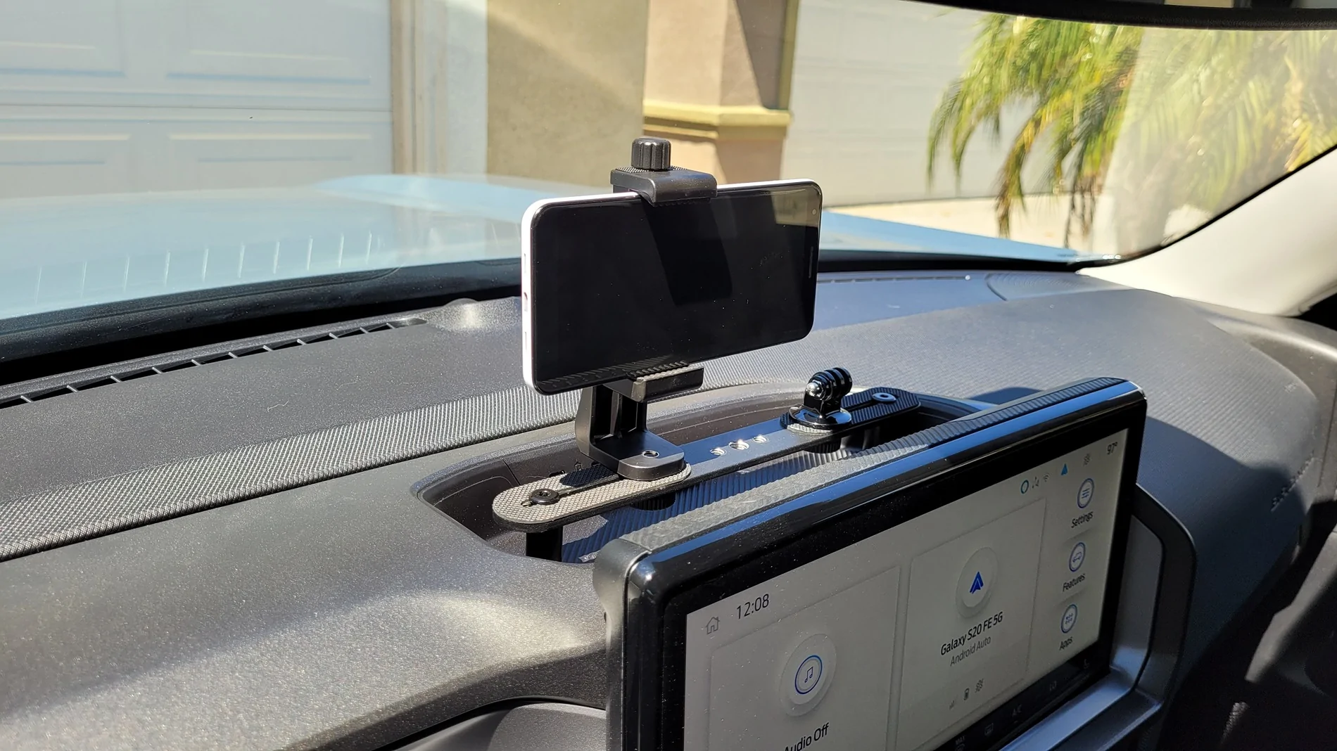

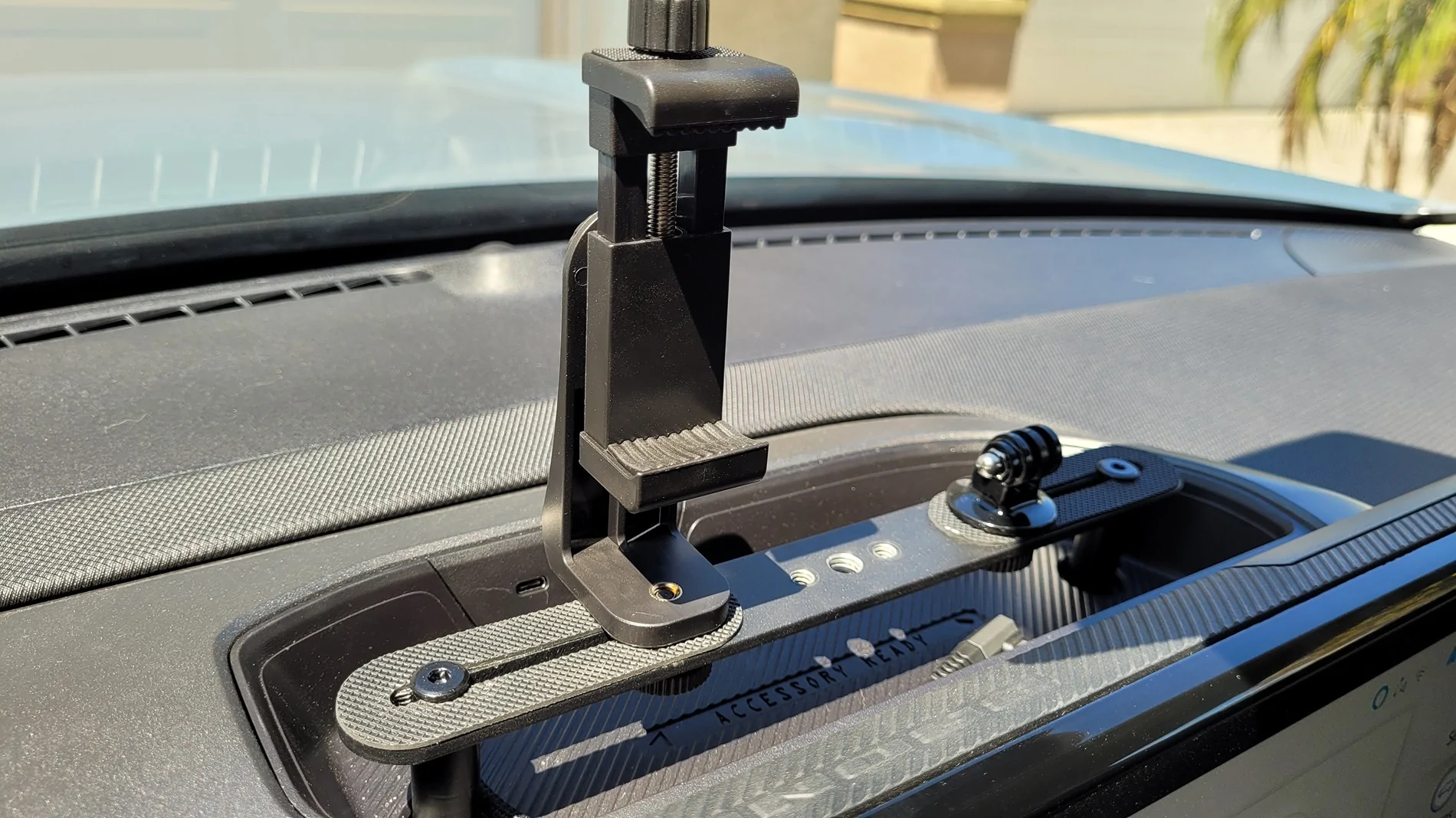

Today, I made a cellphone/action camera holder/mount. I'm still debating on the action camera as I might just use my phone for videos. I already made a few on the trail, holding it above the steering wheel while driving, and the actual video quality and POV were good enough for me.
Ford Bronco Sport What did you do TO your Bronco Sport today? 1000003798
Had to find an old phone for the photo as phones can't take selfies yet.
Ford Bronco Sport What did you do TO your Bronco Sport today? 1000003799
I went with a cheap phone holder for testing purposes, and a GoPro mount to keep the other 1/4 20 knob from rattling around. I'll probably change the phone mount to something that will pivot down out of the way after I do some testing, as is.
Ford Bronco Sport What did you do TO your Bronco Sport today? 1000003800

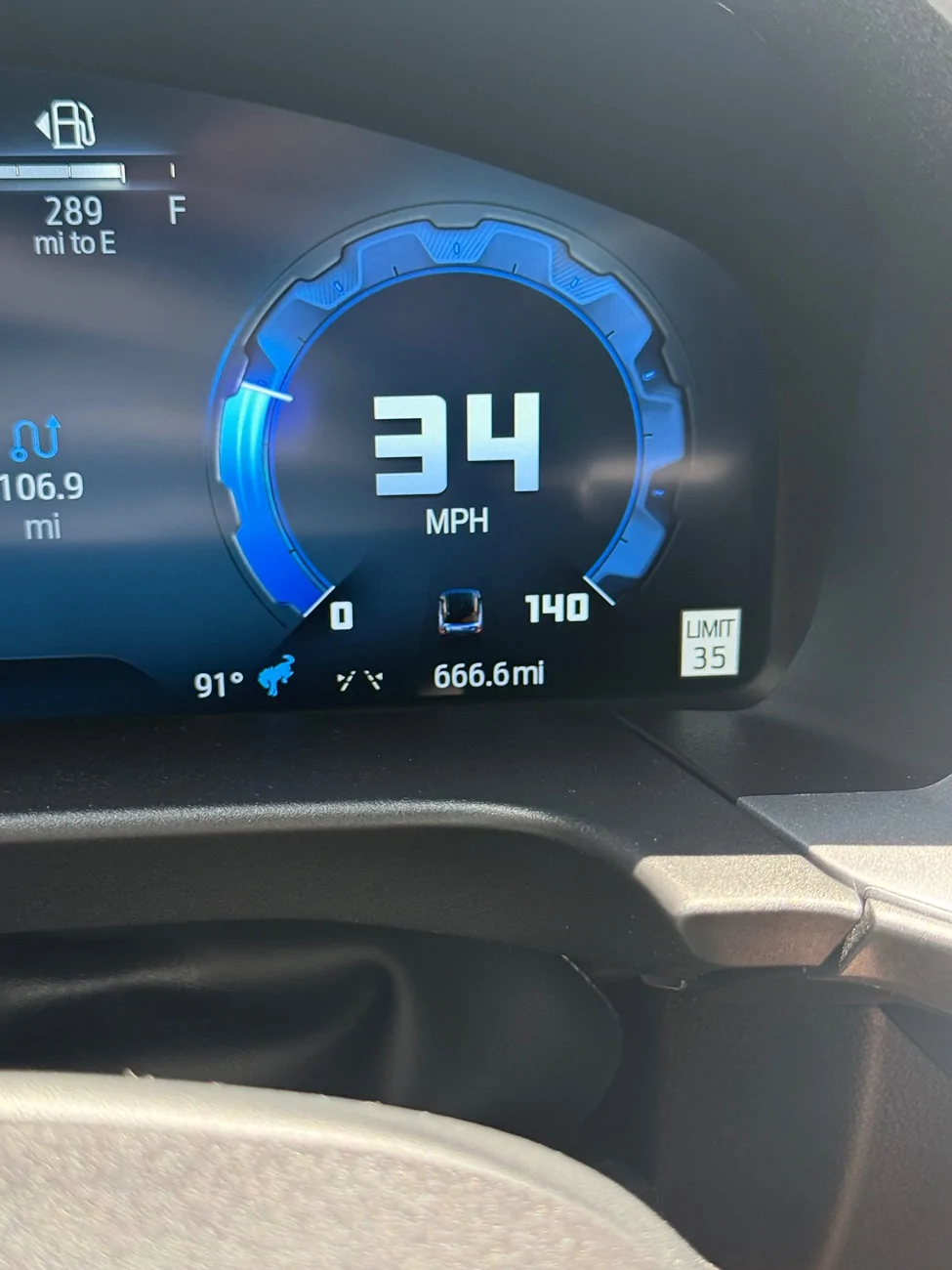

While I was installing it while running the AC I noticed the mileage and thought it was photo worthy.....lol

Nice. Did you print that or cobble it together from miscellaneous hardware?

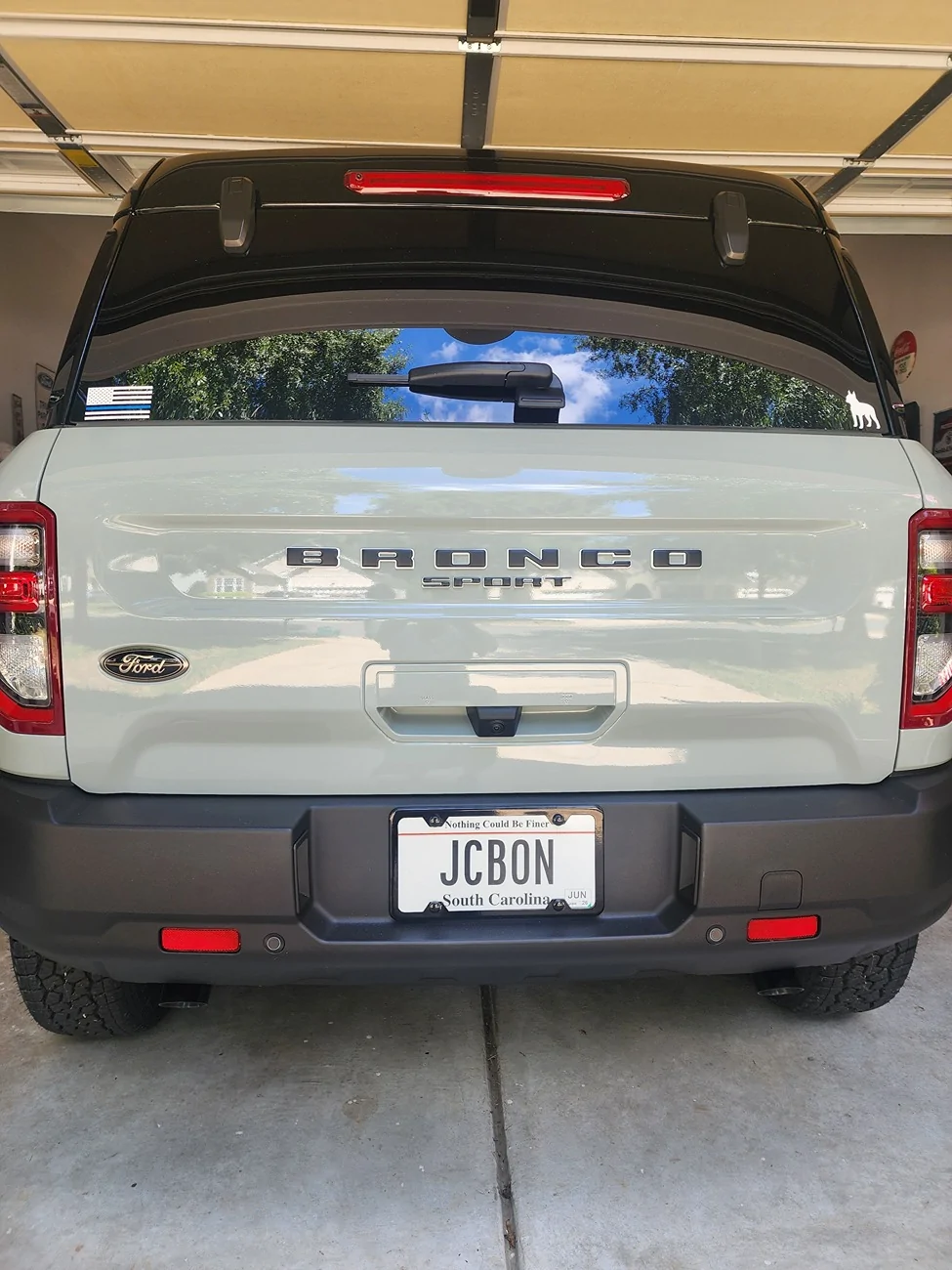

Bronco Tufskinz black letter overlays.

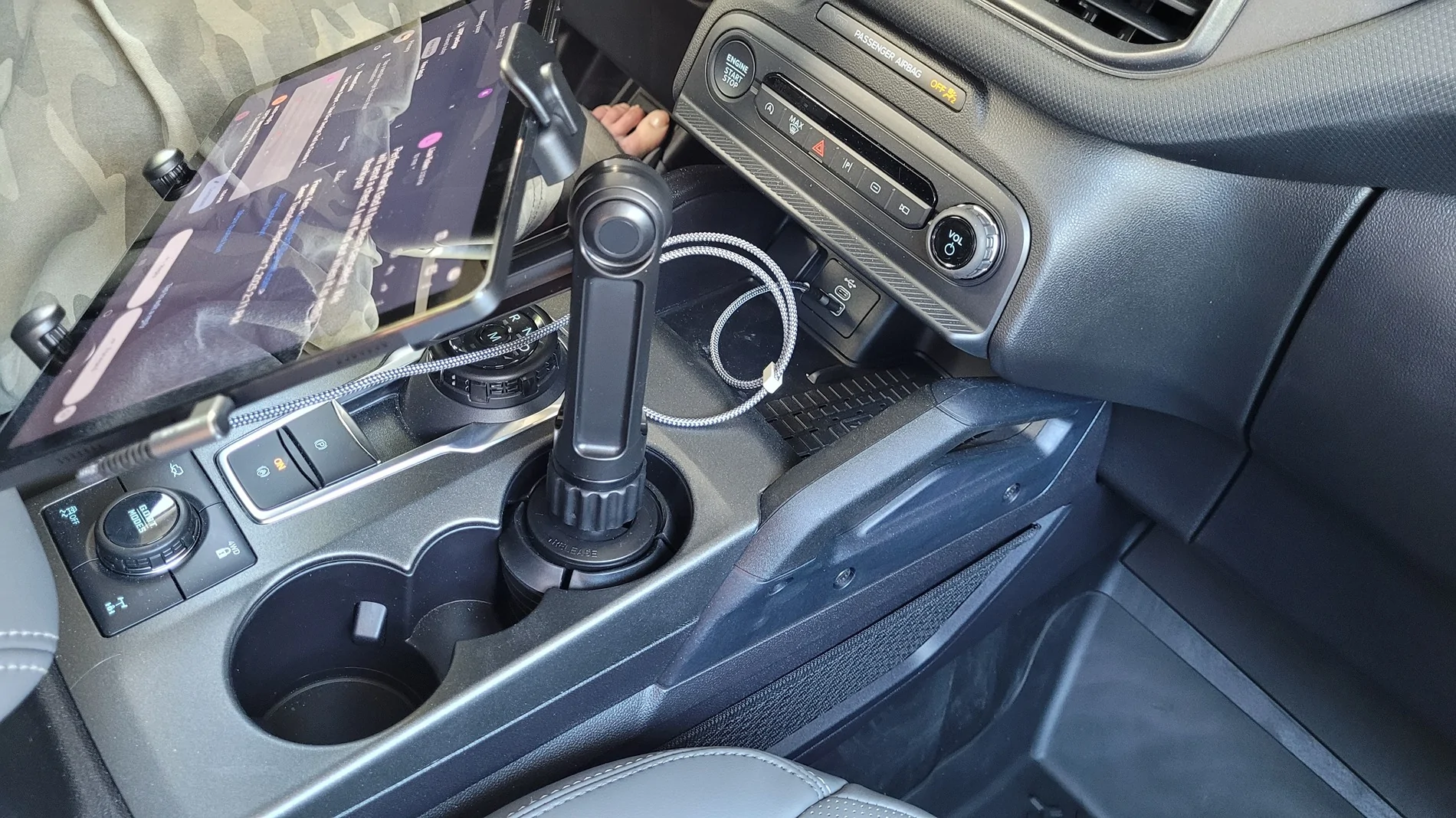

When I hit the trail last week, I lost cell reception and my map. I did come across a fork or two in the trail, but managed to stay on course. I decided I'll take no chances next time and opted for a tablet with built-in GPS. Maybe they all have GPS now? I haven't bought a tablet in forever....lol
Ford Bronco Sport What did you do TO your Bronco Sport today? 1000003811
The tablet has 256GB's of storage so I've been downloading low-res maps of most of Southern and Central California, parts of Nevada and Utah, all the way to Bronco Off-Roadeo so far. The areas with trails I might try in the future, I've downloaded higher-resolution maps.
Ford Bronco Sport What did you do TO your Bronco Sport today? 1000003814
I'll probably have to rethink the mount as it might not be sturdy enough. It was an Amazon used, like-new offering and cheap, so worst case, I'll give it to my granddaughter to use with her tablet.

I'm pretty happy with this one for functionality and build quality: https://www.amazon.com/dp/B0D571YPSX?ref=ppx_yo2ov_dt_b_fed_asin_title

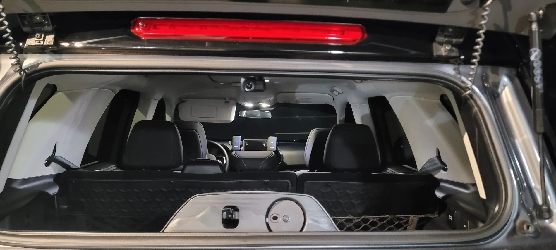

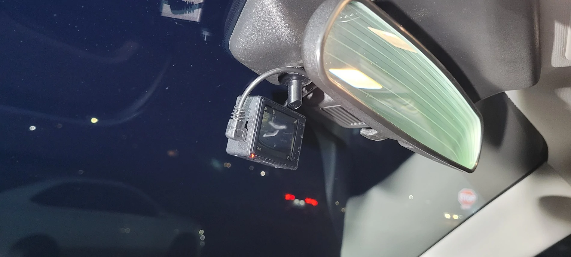

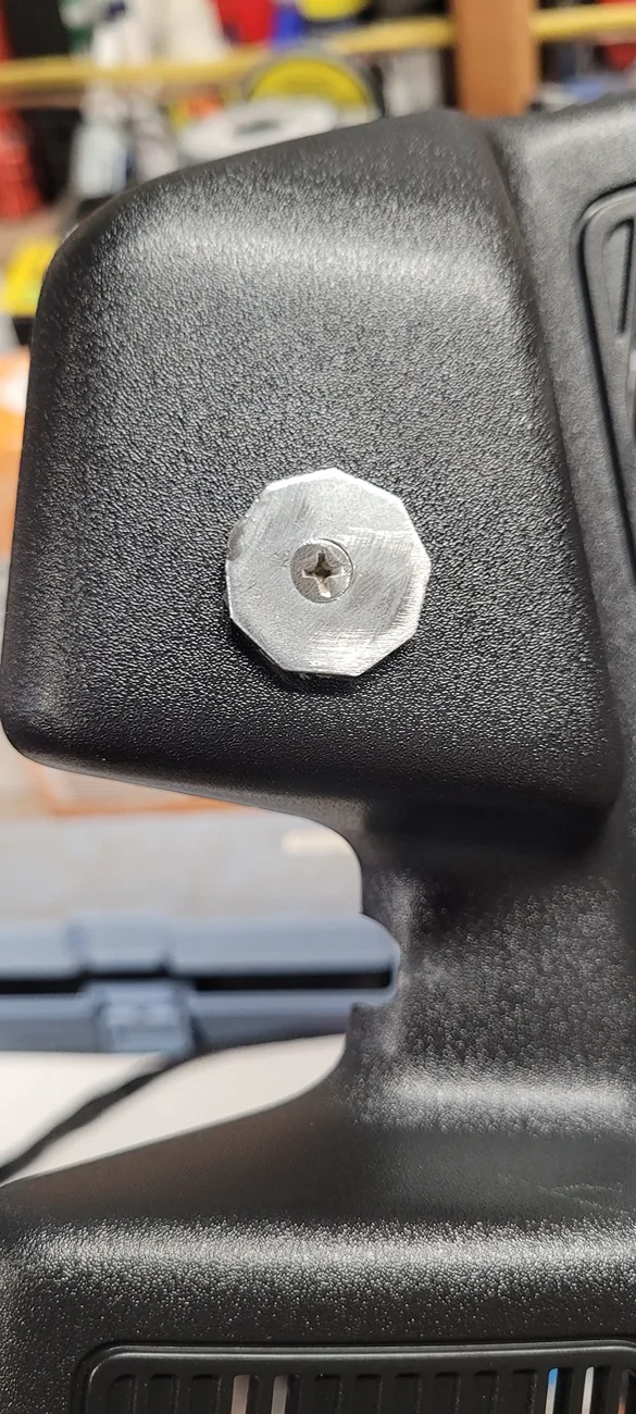

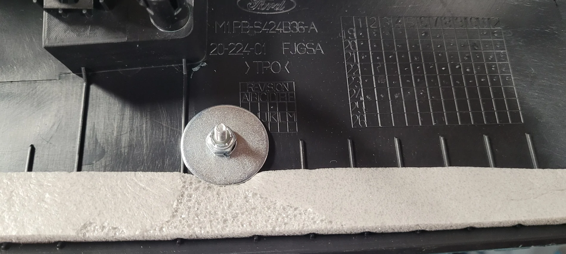

Tired of the rear dash cam un-sticking! I've tried 3 different types of 3M double sided adhesive. It lasts until it gets really hot for a day or two then I notice the camera is hanging.
No more!
I got an extra garmin magnetic mounting attachment with extra magnets. The rear camera didn't have the magnetic base that the front one came with, so now they match. I drilled a hole through the (almost) center, and beveled the edges best I could so the head of the machine thread screw will sit flush. Took a worn out flappy paddle on the grinder and made sure it was a flat surface for the receiving end of the magnet to mate up as best as possible. Fender washer and nylock nut on the other side.
Ford Bronco Sport What did you do TO your Bronco Sport today? 20250902_194447
Ford Bronco Sport What did you do TO your Bronco Sport today? 20250902_194405
Ford Bronco Sport What did you do TO your Bronco Sport today? 20250902_200813

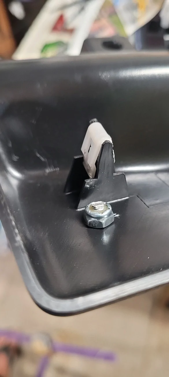

Haven't had issues with the front one. But did the same. Also crazy glued the annoying white plastic clips that are almost worthless and like to fall off.
Ford Bronco Sport What did you do TO your Bronco Sport today? 20250902_202535
Ford Bronco Sport What did you do TO your Bronco Sport today? 20250902_203437
Ford Bronco Sport What did you do TO your Bronco Sport today? 20250902_203928
