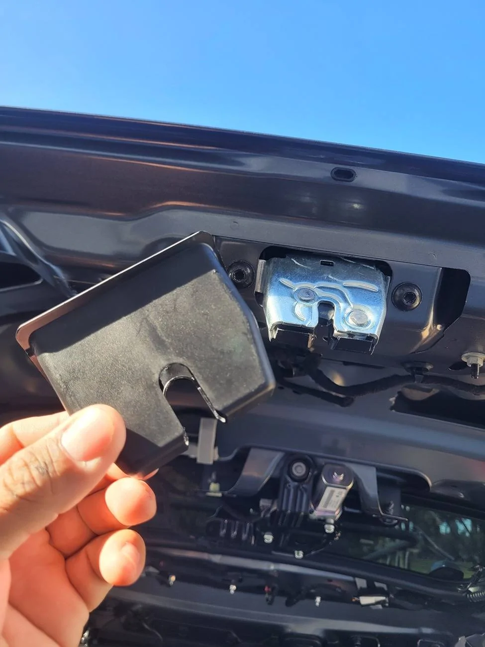

Finally sucess!!! I found the culprit of the incessant rattle in the rear hatch area that manifested after about 1000 miles, Probably wasn't the only culprit but it was the final one. Sweet sweet silence!!!
Ford Bronco Sport What did you do TO your Bronco Sport today? 20241102_144655
I put some generous dabs of silicone on the inside edges all around and re installed. Did some more foam silencing too. Check out my ride thread.

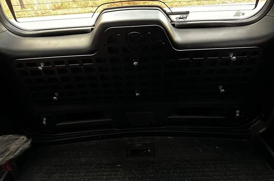

Installed the JCR back hatch Molle panel. Was about to have a fit reinstalling the panel, fought me tooth and nail. In retrospect, I should have used buttonhead fasteners and nut-certs but, in she is. Just ordered new struts and ends to install before I load it up
