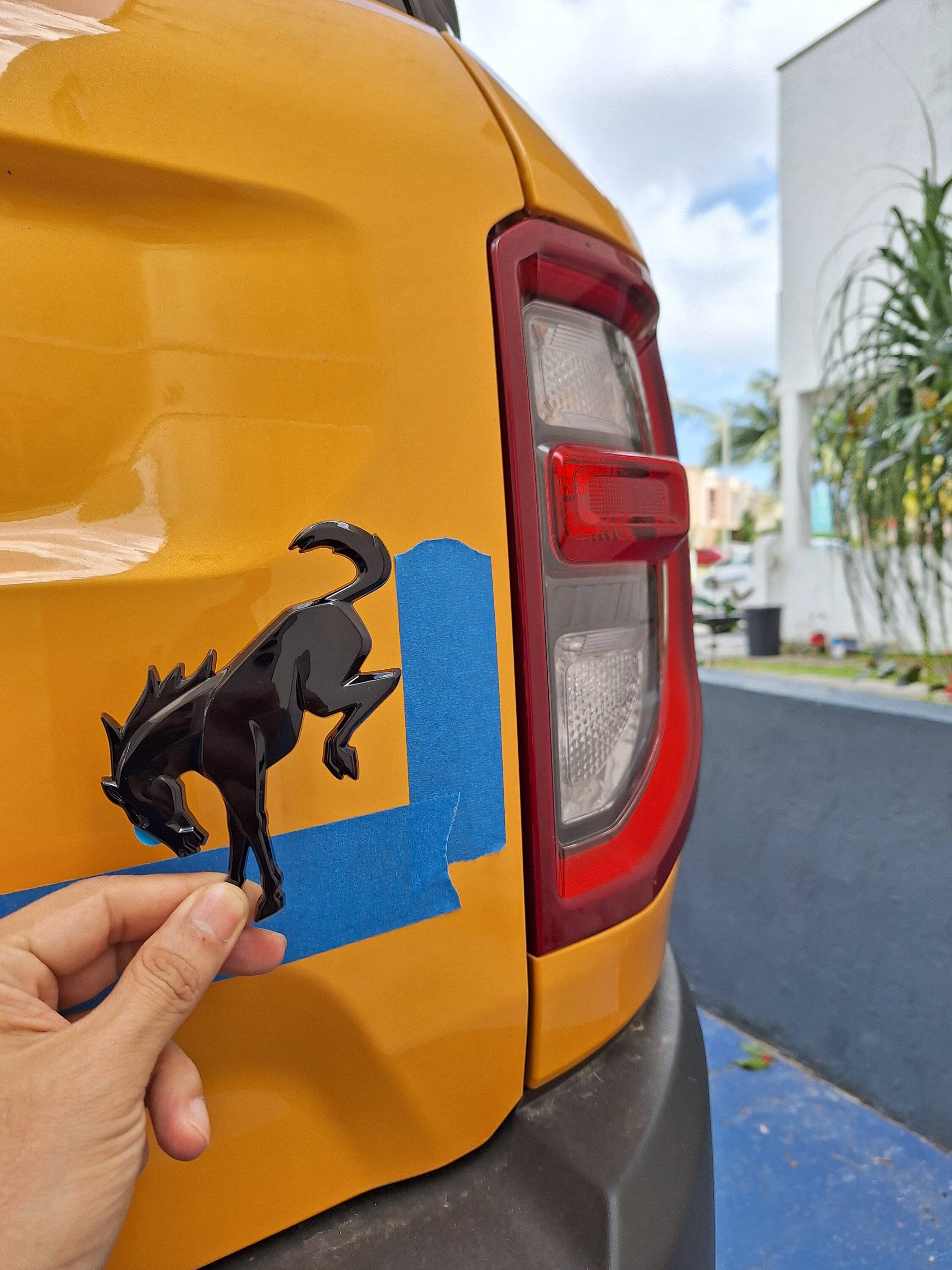

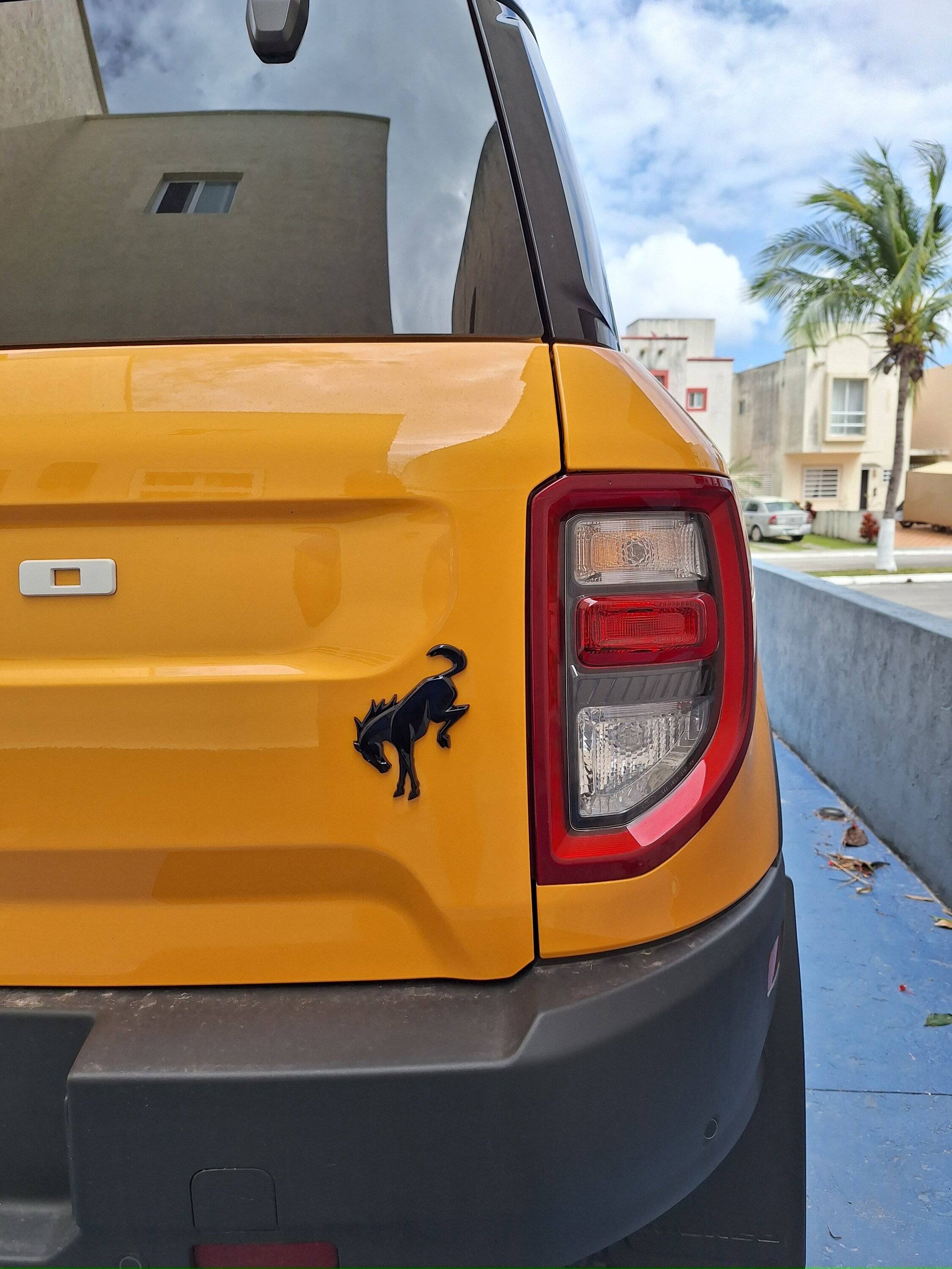

I got the Black Bronco 3D print logo for the tailgate, I think it looks outstanding ? for the #CO color!

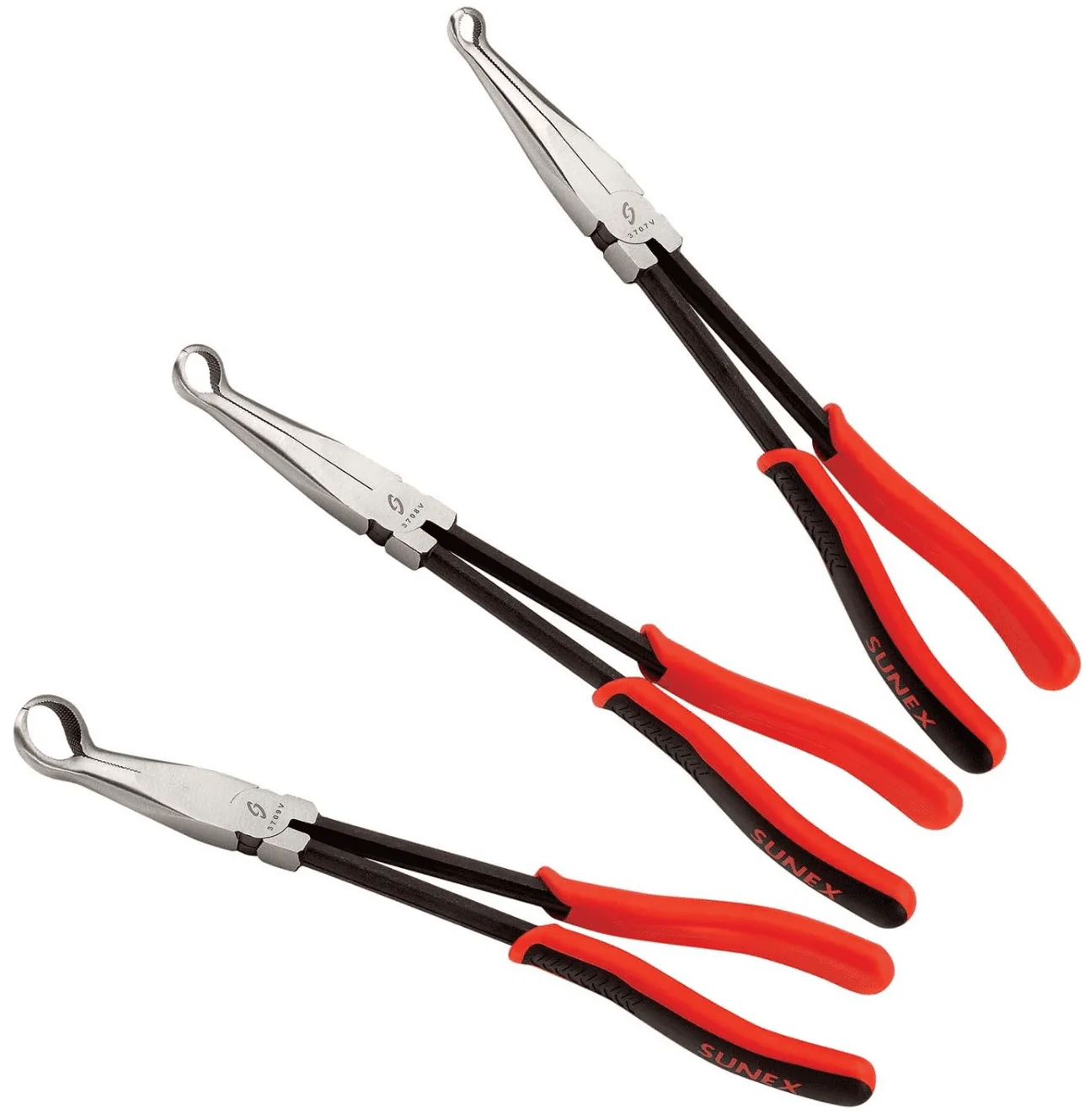

It comes out the front, but you have to get behind them to compress the ”arrowhead” clips that hold them in. I found a pair of pliers like one of these was the best tool for the job.
Ford Bronco Sport What did you do TO your Bronco Sport today? 1709680931432
Look for “hose pliers”
Will this work to detach the glove box to change out the cabin air filter?
I have no idea why they made it so hard to detach and it looks like it'll break after some time.
Maybe that's why the dealer charges $100 to replace that filter.
Hmmm I think you are doing something incorrect because with just light pressure using your fingers and perhaps a set of pliers for the damper the glove box detaches easily to gain access for replacement of the cabin filter.
Perhaps try using a strong light to see the mechanism and a couple practice attempts and you will quickly master the procedure.
here’s the manual steps and a YouTube video
Disconnect damper on right side
Squeeze damper end (with pliers if needed) to pull damper off
Release glovebox stops on both sides
Optional: add couple drops of tea tree oil on filter membrane (or Lavender oil)
Note: Air Flow arrow on cabin filter points down towards Passenger floor

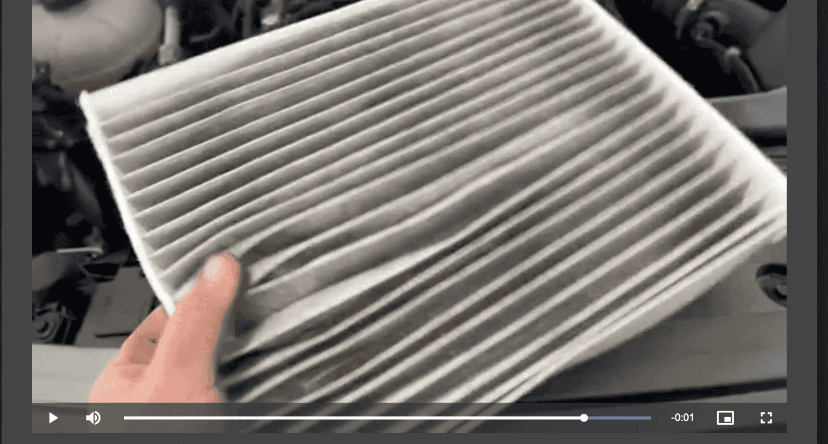

I was able to finally do something, although nothing too exciting.
I drove 720 miles to get an oil change!
So I bought it near Houston, which is about 3 hours from me. The location I bought it from includes two free oil changes/tire rotations. Is that a dumb idea to save a buck? Yeah, maybe, but I also planned to do some road tripping.
It didn't go as planned but it was nice getting out of the house and driving around. I also did some sight seeing and tried some new food. I ended up spending a little time in Houston, driving to San Antonio, then driving back home.
They also suggested I change my cabin air filter. I'm at 9,800 miles and it looks pretty dirty already. Thoughts??

Change it, but don't let your dealer because it cost 4X as much as doing it yourself. My dealer wanted $80 lol.
They probably added $20 since I got the oil change for free. I shouldn't even be surprised they charge for the labor to change it after they take it out to begin with.
Looks like I need to pick up one from somewhere.

David: here are part numbers for the cabin air filter and a link to one on Amazon.
Original OEM Cabin Air Filter:
FoMoCo JX6A-18D483-HA
G8VTE 665* LESA
Motorcraft FP100A (LX6Z19N619CA): new Cabin Air filters, Refresh95 successor part
Amazon has several available, you can search for Bronco Sport, here is one link (cost today is $10.09):
https://a.co/d/91o5bT8
It’s not a “Refresh95” which I’ve never been able to find the Refresh95 cabin filter.
22MRD154716
PC99542P REPLACES
FORD JX6Z-19N619-BA
Parts.ford.com MSRP: $33.95, "your price" $28.86
O’Rielly Auto Parts: $22.99, free shipping at $35+
Rockauto: $16.96 + $10.99 shipping for one filter (same shipping with 2nd filter)
Older (compatible, not as efficient) filters include JX6Z19N619BA, FP89, FP99
Another option: $20
FRAM CV12772, TrueAir Premium Cabin Air Filter with N95 Filter Media, for Ford and Lincoln Fits select: 2020-2023 FORD EXPLORER, 2020-2022 FORD ESCAPE https://www.walmart.com/ip/1872500402
