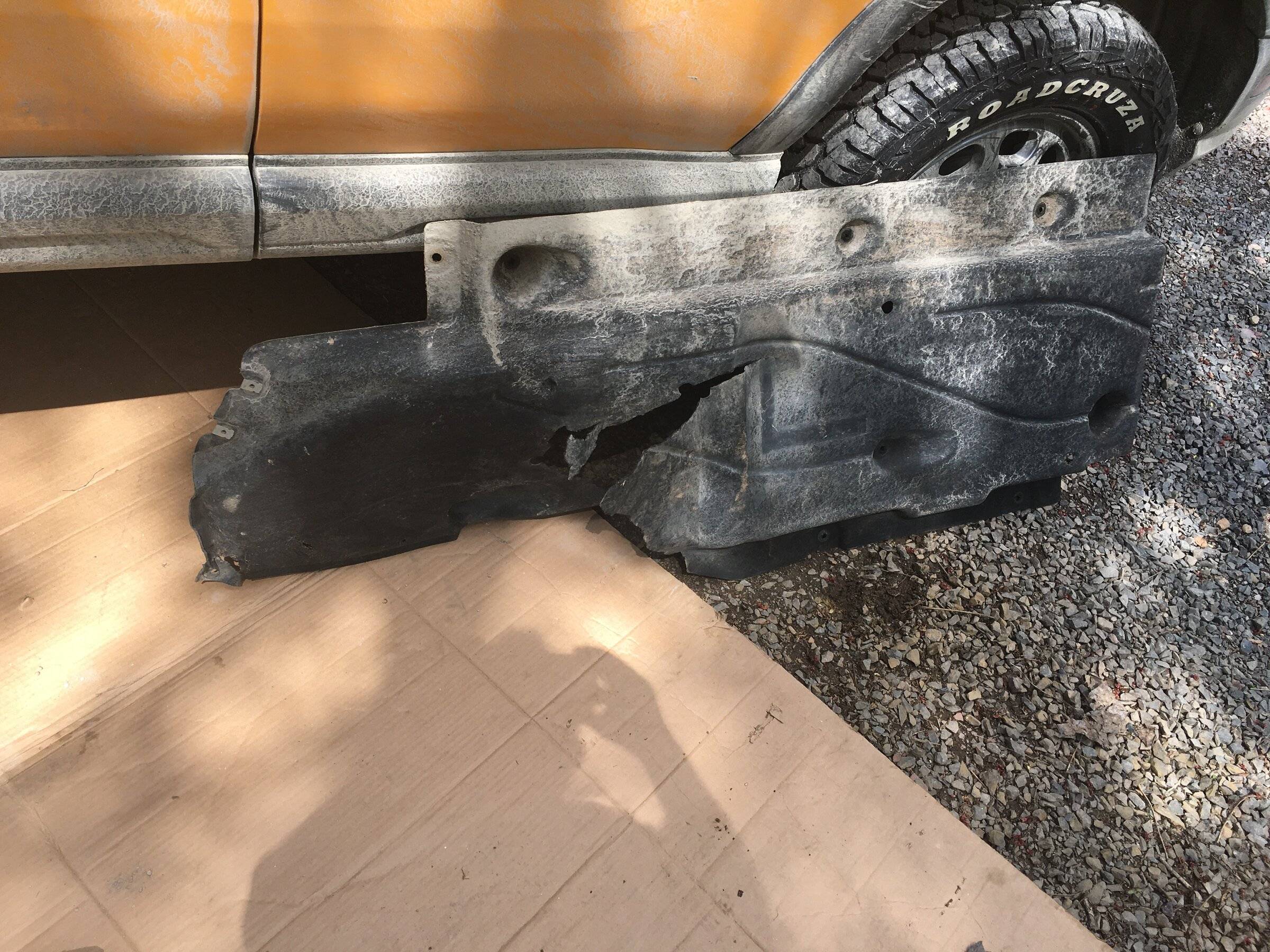

But… on to what I did to it….

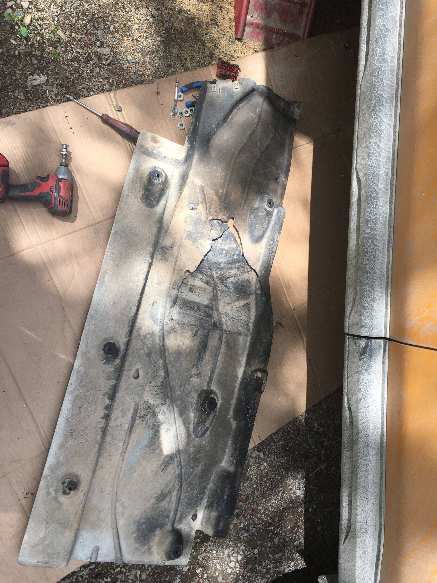

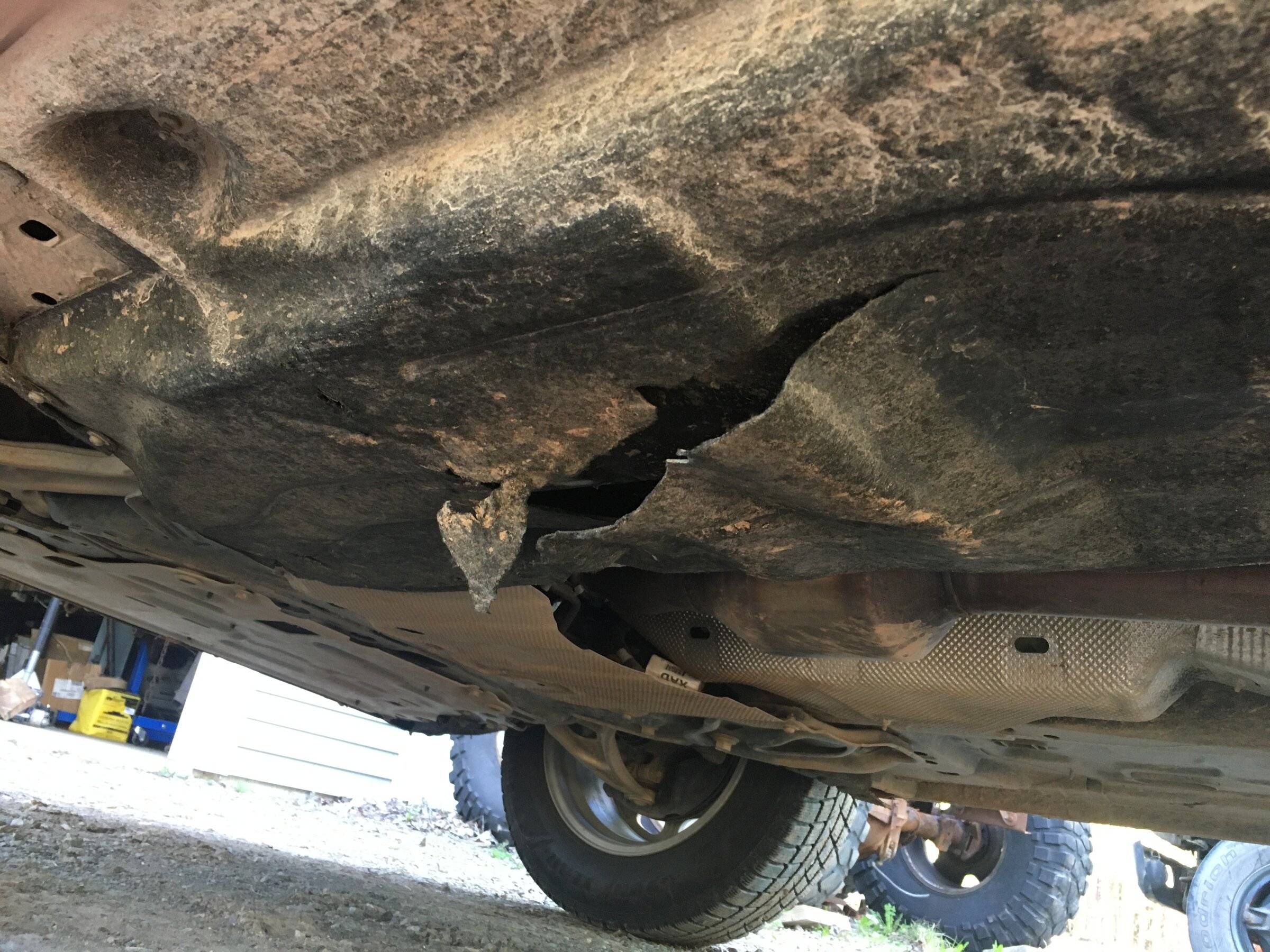

So far we have tore off two skid plates, ripped out the inner fender, broke the windshield and the latest.. tore apart the “skid plate cover”??
wife bottomed it out while trail riding with her girlfriend, I taped it but that lasted until it hit the highway the first time.
So, pulled the cover off;
Ford Bronco Sport What did you do TO your Bronco Sport today? F7C3A61C-3AD1-4832-82C1-F259D932E26E
Ford Bronco Sport What did you do TO your Bronco Sport today? 7C4F90F3-3384-4B79-A745-3C9D7B085F58
Pulling it off
Ford Bronco Sport What did you do TO your Bronco Sport today? D4AE9D44-1050-4863-8B23-49D201301A87
Ford Bronco Sport What did you do TO your Bronco Sport today? C6BEF2E5-2929-440C-86D0-BD6F8B42835D

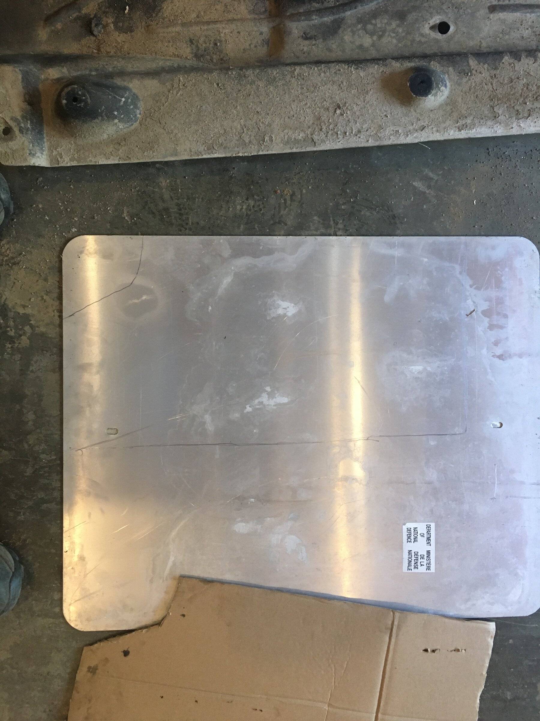

Laid it out and made a template

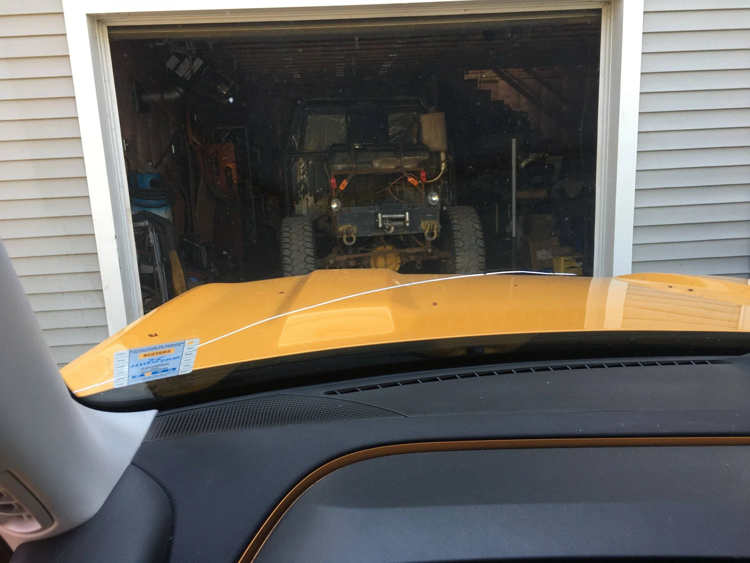

Damage….
Ford Bronco Sport What did you do TO your Bronco Sport today? CF17952E-B55D-40E2-BA67-2E74B4183592
broken windshield…

Oh yes for sure. When I say skid plate though, I should clarify, it’s not really skid plates as much as it is an aerodynamic cover over the actual skid plates. I was tempted to leave this cover off completely and make a proper skid plate, but I just fixed this one.
The issue is tearing the …. Ummmm… plastic/felt/whatever it is, (cover ?) or pulling it off over the nuts that hold it in place. The first time, it was hanging down because the nut was pulled off. The next time, it was pulled down over the nut. The last time it was ripped when the wife bottomed out on a rock and slid forward to get off instead of backing off the rock.
So, an actual aluminum or steel skid plate wouldn’t of been damaged, but I’m guessing the cover helps with mpg.
A concern I do have is the ecu being inside the front left fender… not sure what ford was thinking there. Maybe they wanted an “off road looking” truck to replace the escape and never considered people would do what I’m doing?? Awd and goat modes should do 99% of “soft roading” but what happens when someone does take it out in the “holy crap” area’s??
At some point I’m going to go over the underneath and add actual skid plates if/where required as well as look at the front skid plate which I think is a little light.
So, short answer is yes, aftermarket plates would be awesome but you still have to deal with the felt underbody cover and felt inner fenders.(again, felt, held in with plastic push pins, ford, what were you thinking???)

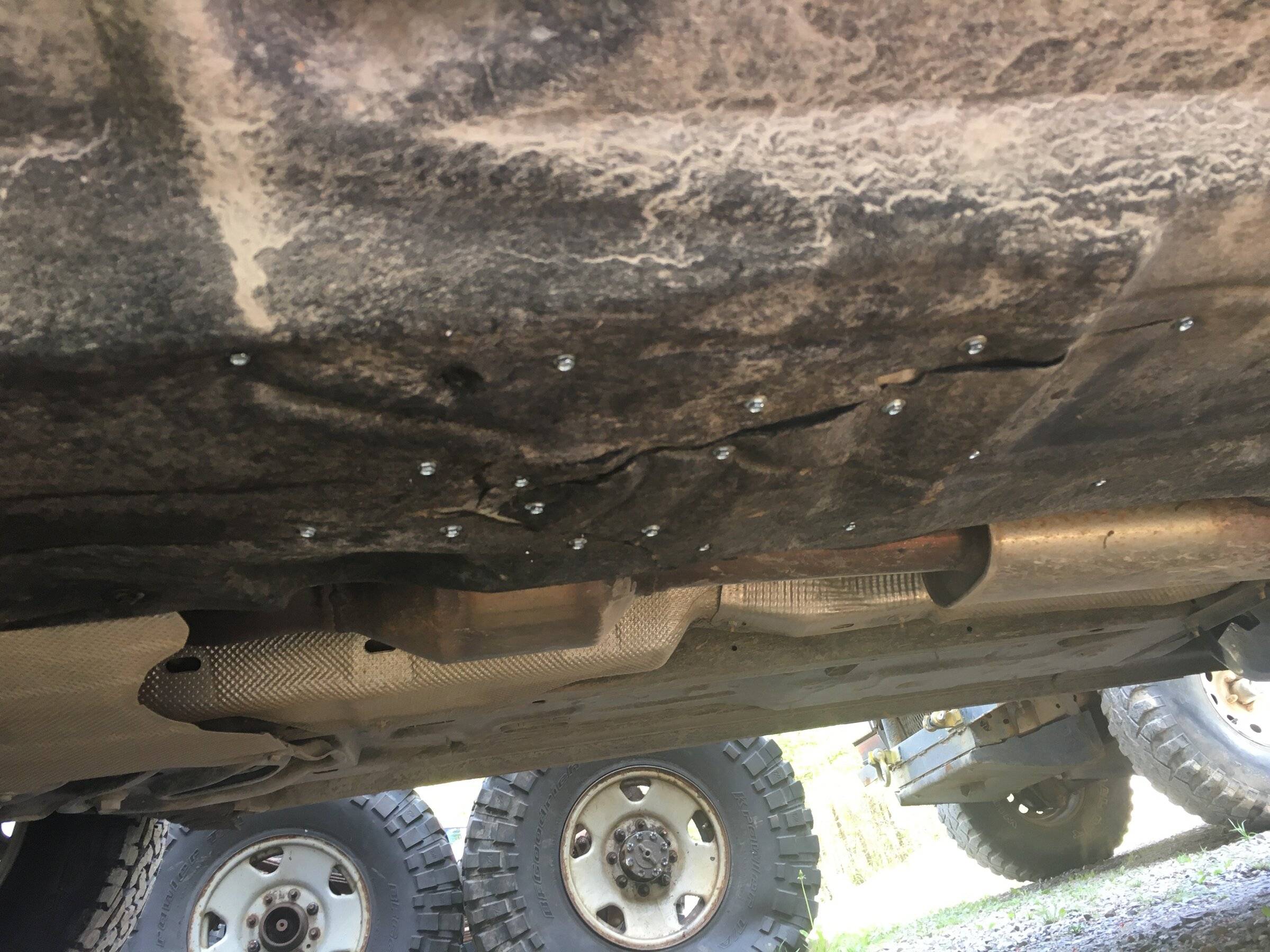

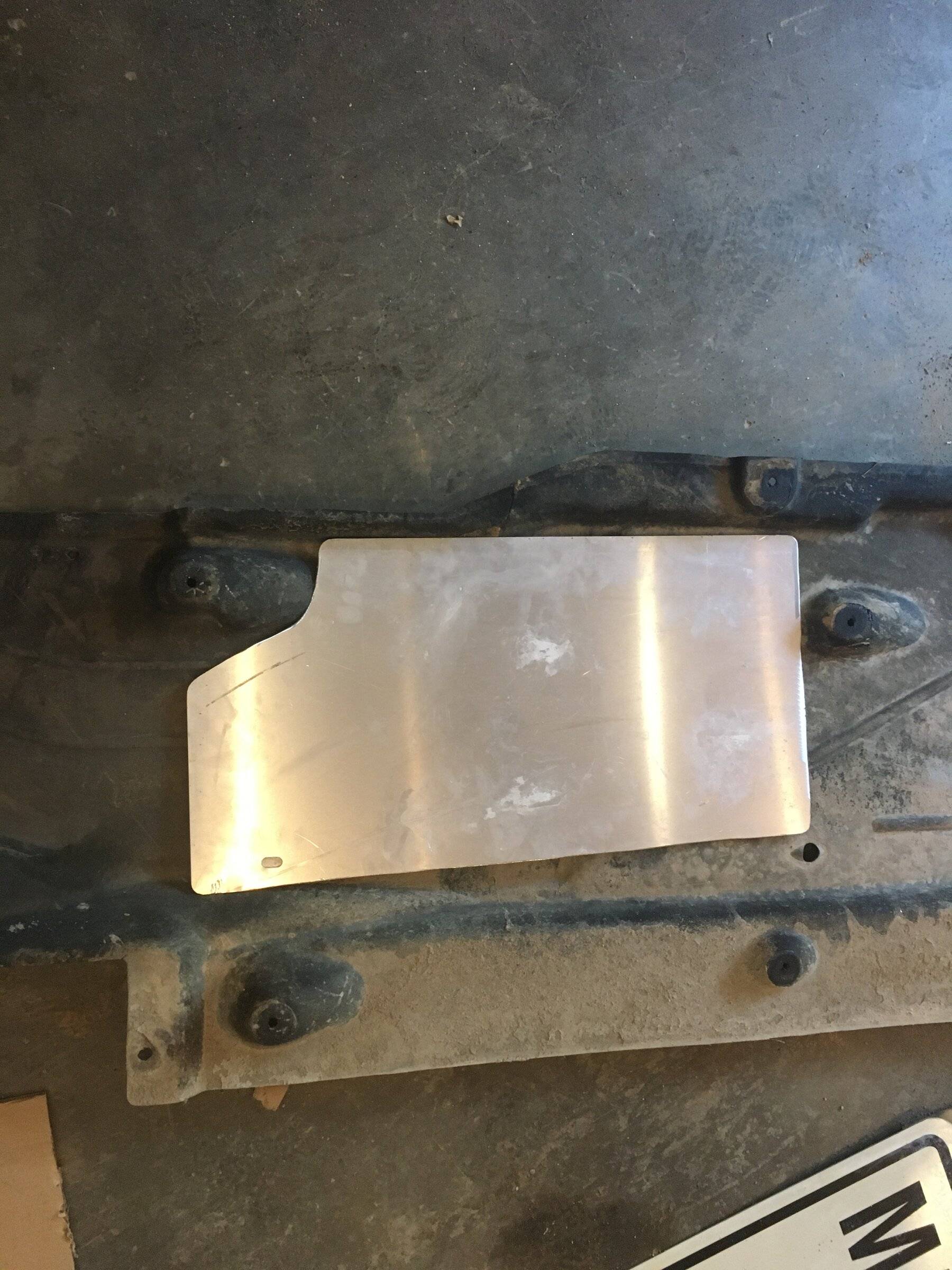

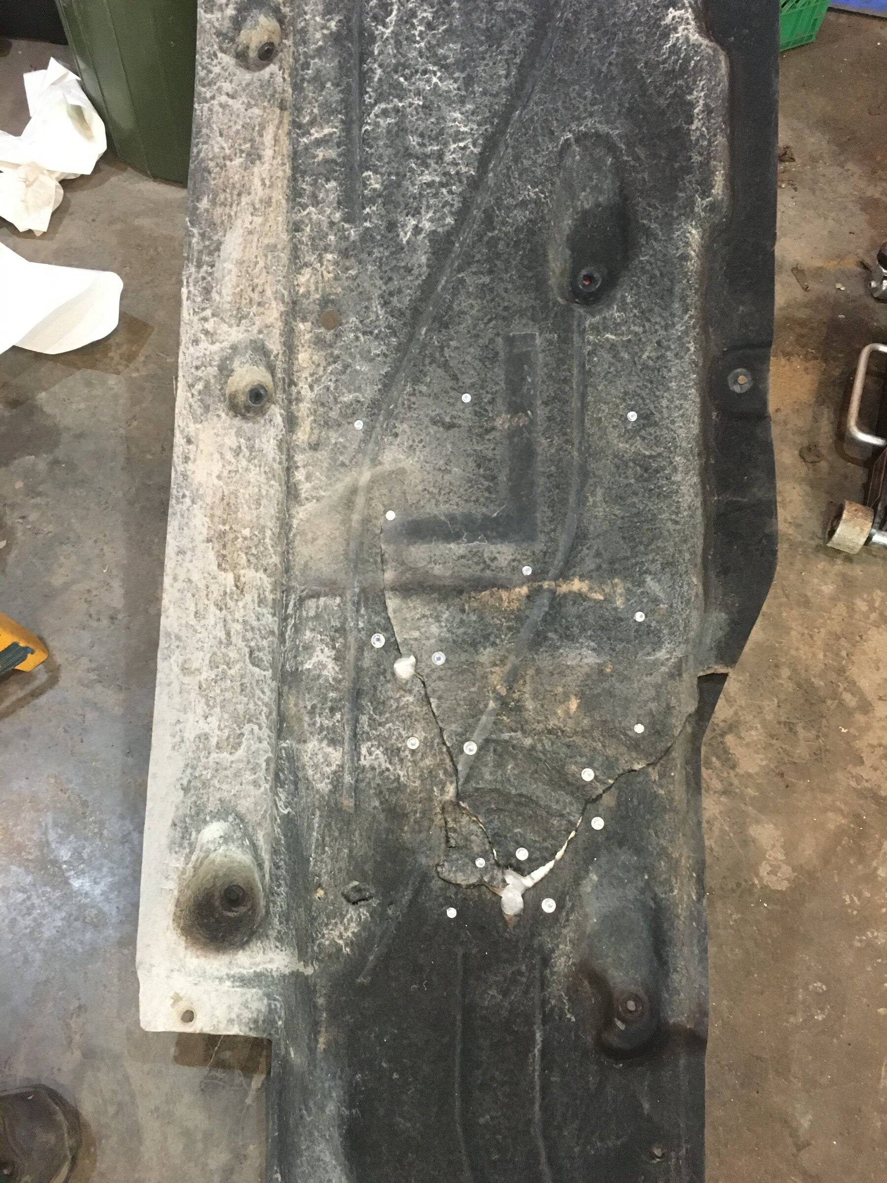

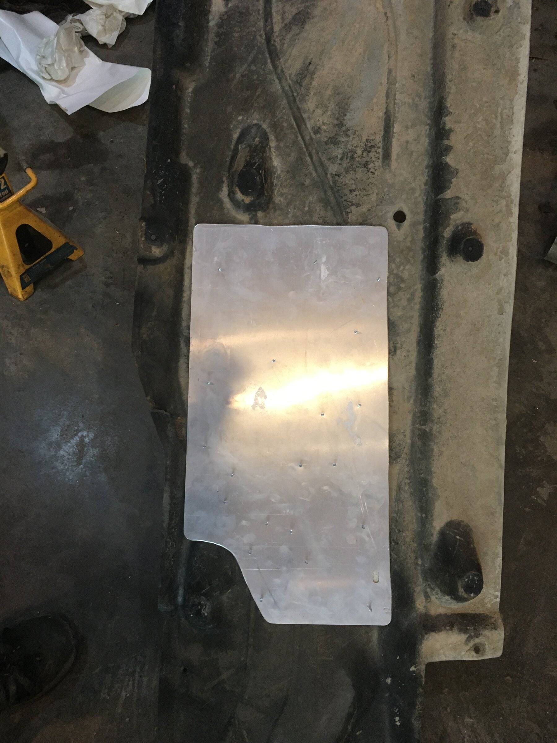

Then used a piece of aluminum (it just looks like an aluminum road sign… nothing to see here, move along..??
Ford Bronco Sport What did you do TO your Bronco Sport today? 75FAB498-D5B2-49F9-A6BC-6876AE8FFEC3
Ford Bronco Sport What did you do TO your Bronco Sport today? 13F702B4-992F-4ECC-BFCD-C581F07F3923
Ford Bronco Sport What did you do TO your Bronco Sport today? 0DA6B342-3DAD-4337-8BC3-C3C54A59AFC5
Now I’ll have to undercoat it to cover the screws!
I wonder if spraying those things with bedliner would be a good preventative move?

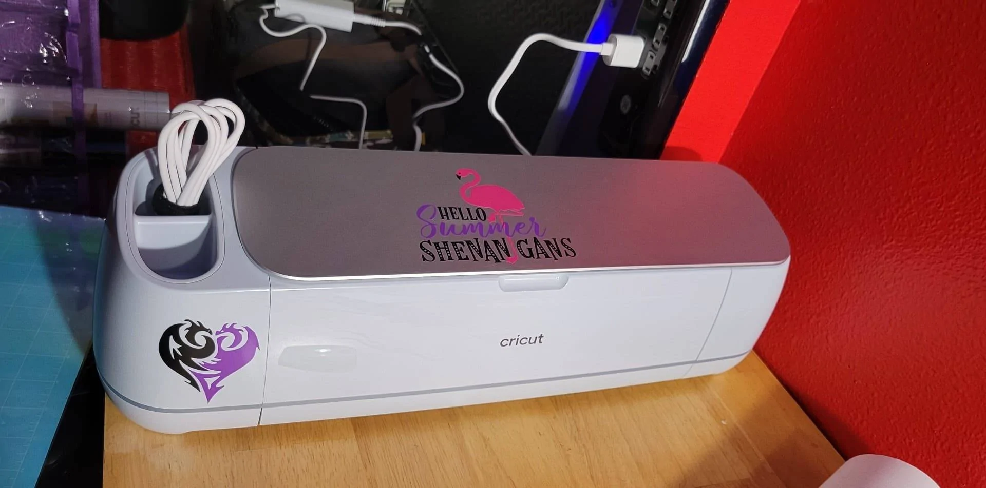

I've gone sticker happy!
My wife has started learning. I can't to see what she comes up with when she makes stickers for something other than the cricut.

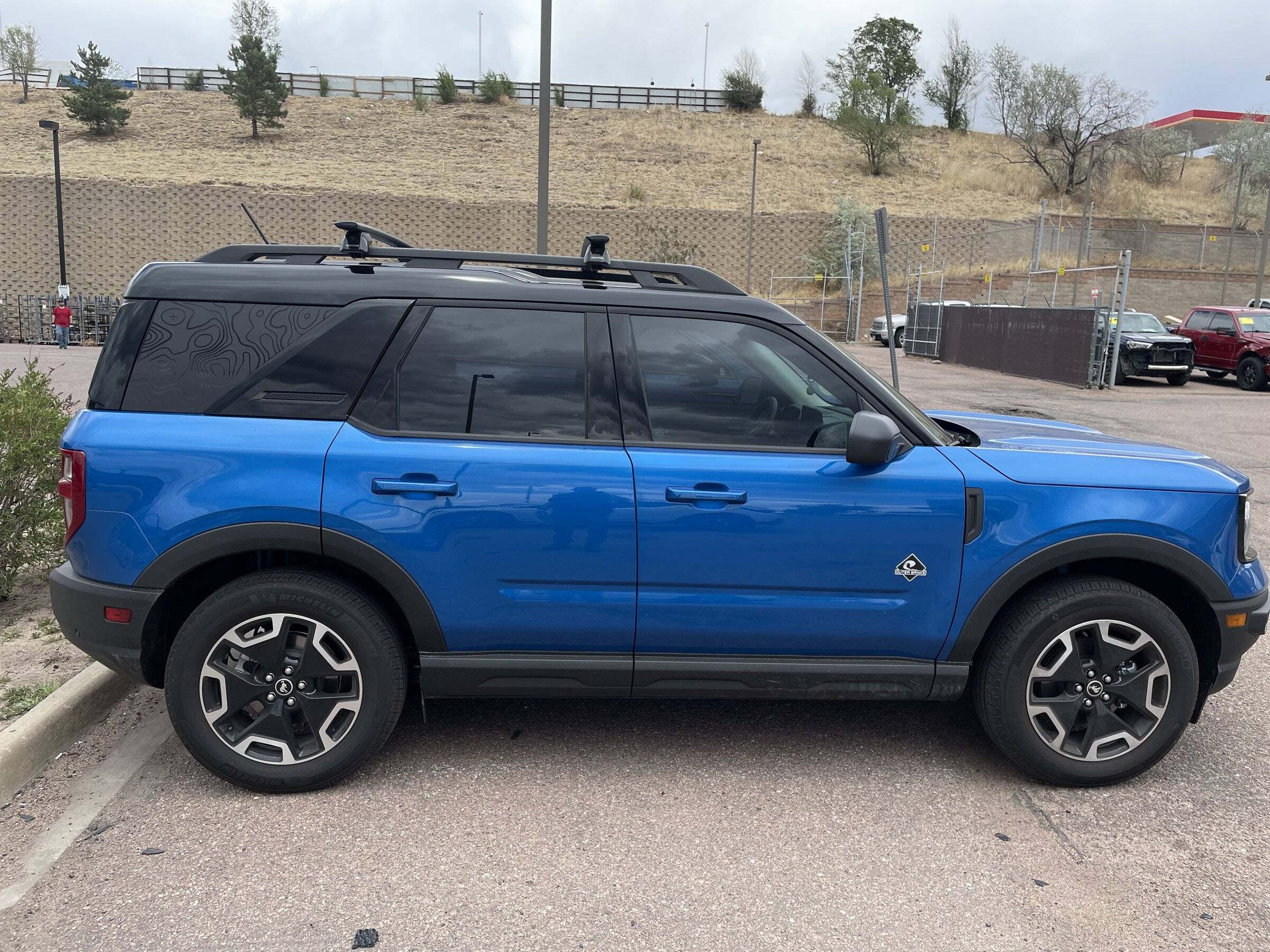

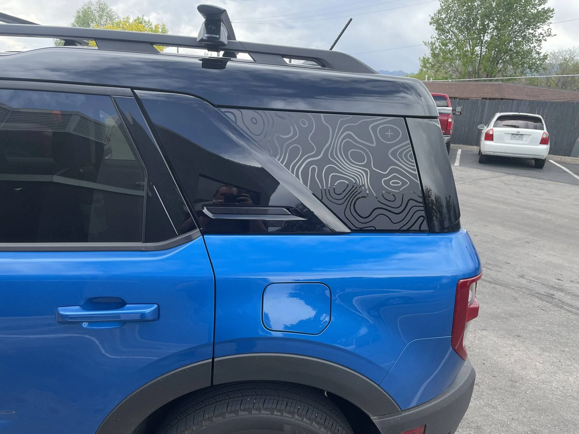

Finally getting around to posting these after decals were installed. Tinted the front windows to match the back, added the topographic vinyls on the quarter glass, and installed the Yakima roof rails.
getting clear bra done on the front tomorrow since I already have a rock chip and looking for some beefier tires.
