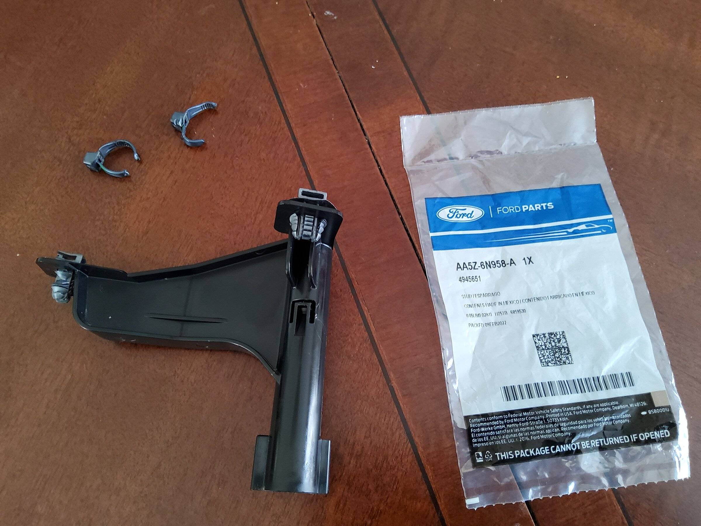

Ordered the parts to my home and did it myself with tips from Viking’s earlier post.
1. Used a little anti-seize on each screw and got those in first.
2. Carefully cut the two small zip ties with some cutting pliers. Make sure to not cut the tubes or their insulation. Also, make sure to not drop any small pieces of the zip ties into the engine.
3. Took a little bit of leverage, but pull the brace straight up. Don’t torque it at an angle, don’t want to risk breaking the special longer stud bolt that the brace holds onto. Make sure to hold the right side tube out of the way for when the brace pops off.
4. Place the cover on and push each of the four spots where the studs are til you hear/feel it engage.
5. Appreciate how much better it looks, and try to figure out why Ford couldn’t have just included the cover in the first place.
Sidenote: it appears with the cover installed, it completely secures those two tubes/cords. The brace just seems to prevent them from “lifting off” the top of the engine. The brace’s primary function doesn’t seem for supporting those tubes/cords from underneath. Everything fits nice and snug after.

See pic.....you already have the insulator installed. You will need 3 ball studs (see part number on bag) the long stud is already there but is being used by the black plastic brace shown. As previously mentioned, cut zip ties and carefull pry the pressure tab on the brace away from the the long white ball stud and pull up to remove. The cover will then pop into place (ball socket type fit) and connects at four locations

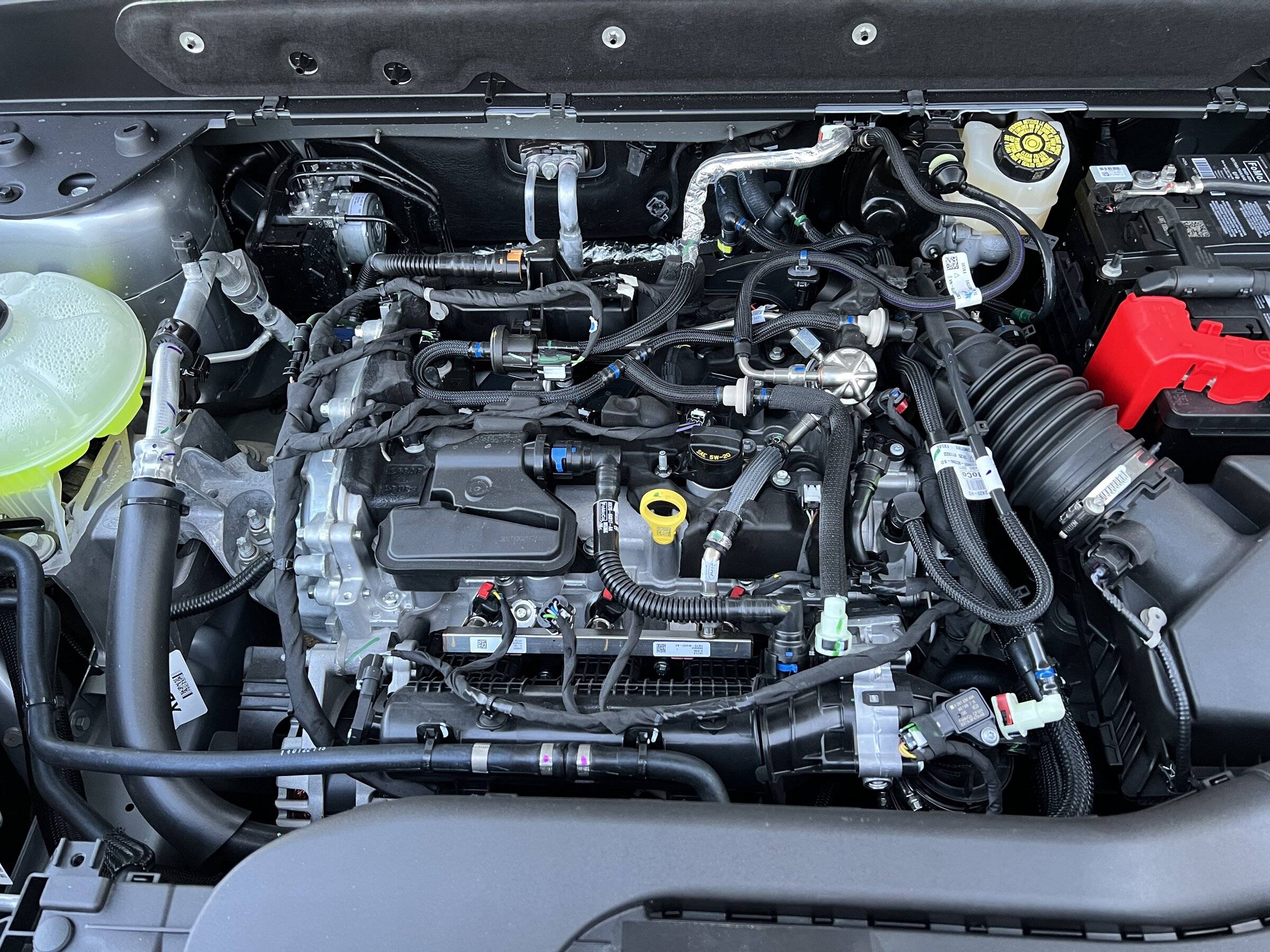

Just sold my 2021 Big Bend to Carvana. Here's what the engine looked like from the factory.
Ford Bronco Sport Upset over missing engine cover! 5D3BF539-7A57-46C8-A95D-3BA742922D74_1_201_a
Picked up my new 2022 Outer Banks yesterday.
Here's what its engine looks like.
Ford Bronco Sport Upset over missing engine cover! E9AE0900-BF64-43EA-9257-2E31B63FC5EB_1_201_a
Now I need some further instructions. Is this where I am supposed to be outraged about the lack of an engine cover? I really need some guidance on this. I slept fine last night. Was that wrong? Am I taking this huge injustice too lightly? Please help.
