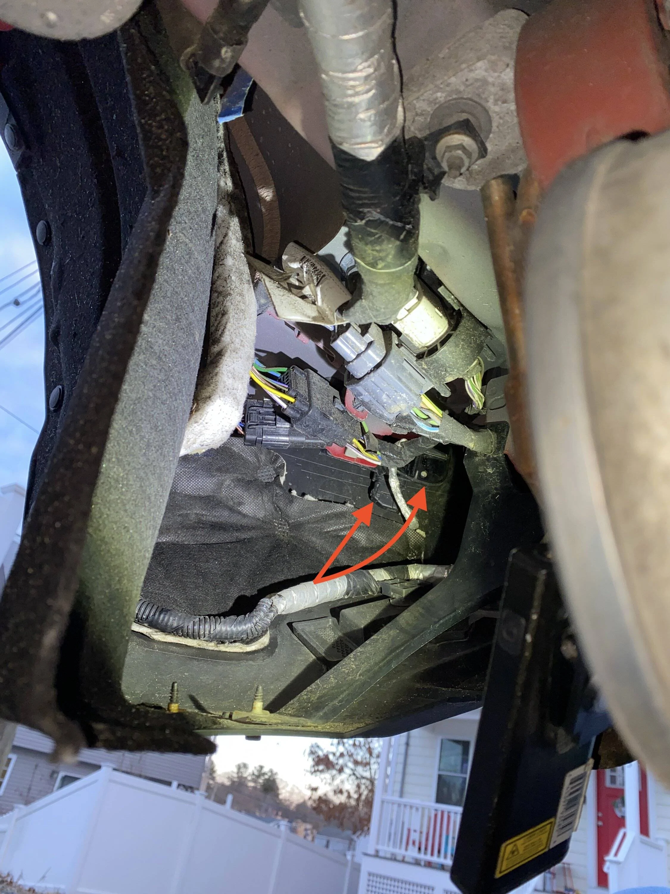

The trailer controller module is located in the right rear corner. Look for some water leaks behind the right rear wheel of maybe above that in the glass.

Is this what you're referring to?

It should have three connectors.
one harness heads to the front of the car.
one goes down through the hatch are floor
the last one goes up to the right hatch corner.
A total of about 7 or 8 wires
This module handles the trailer lighting from CAN BUS signals.
