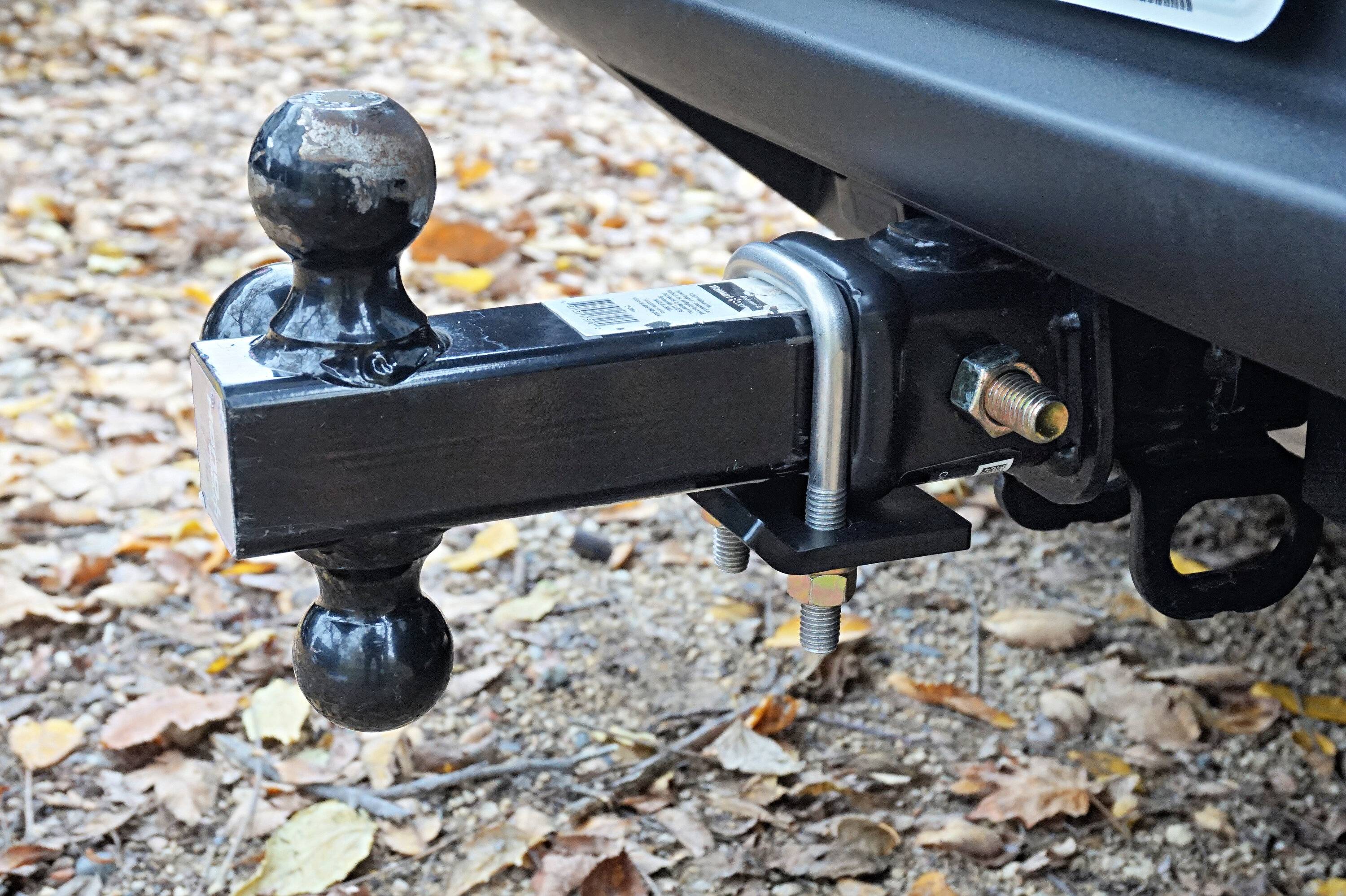

And no, the weld is not giving loose on the ball. I saw that too after I looked at the picture. It's an illusion.
2,679
3,384
This helps a lot especially with an empty or light trailer and not a lot of tongue weight. Once the tongue of the trailer is weighted , the noise generally goes away.
Also a must for cargo carriers or bike racks that don’t include a means to take out the wiggles.

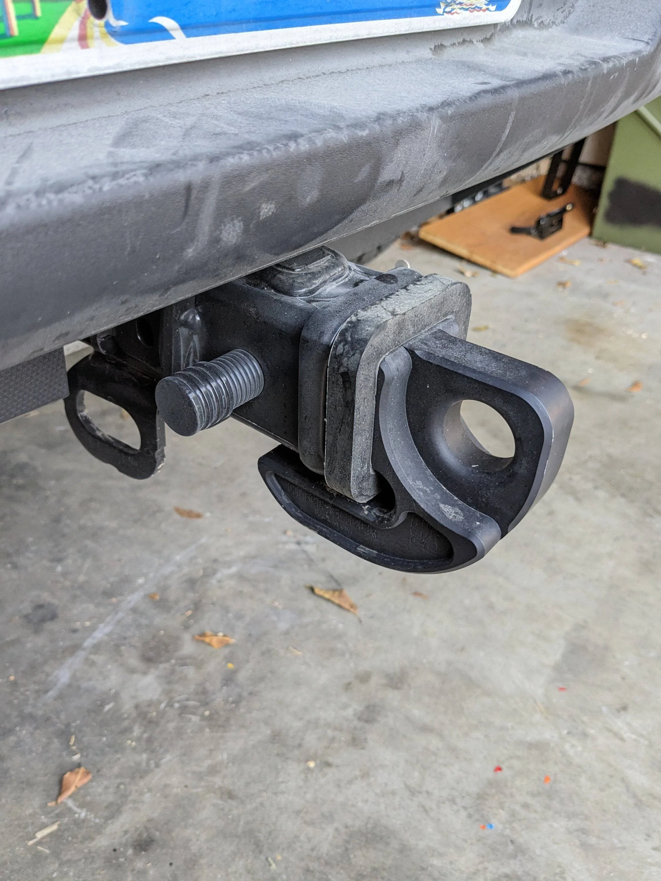

Here's another option...https://www.amazon.com/dp/B0BFGS9F84
Ford Bronco Sport Slop in the trailer hitch receiver gone... PXL_20231209_155022036
One ring between the hitch receiver and the recovery point and no more rattles.
