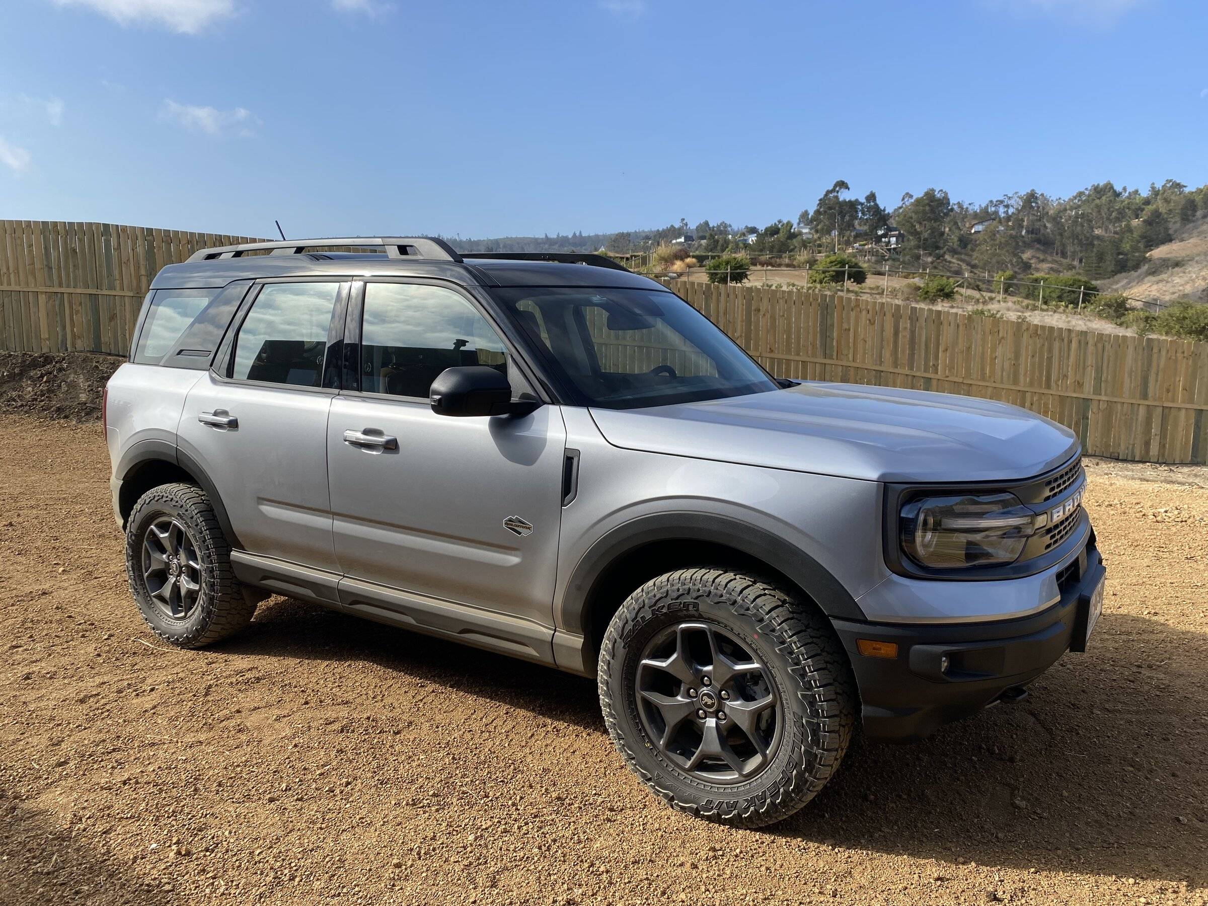

Just installed Falken Wildpeak 245 65 R17 with no leveling kit an NO rubbing, very happy with the driving sensation of the new tires, and the look is amazing!
Ford Bronco Sport Tires Size with stock height CEA63993-2C25-4F10-BB0C-55322C164AA9
This is the very best picture I have seen with regard to increasing the tire size... love it. Thanks for posting.... I too have a BL's and no desire to mess with a lift/levelimng kit... but also do not want to compromise my off road capability, that's why I bough the damn thing! hahaha No driveway queen here...
