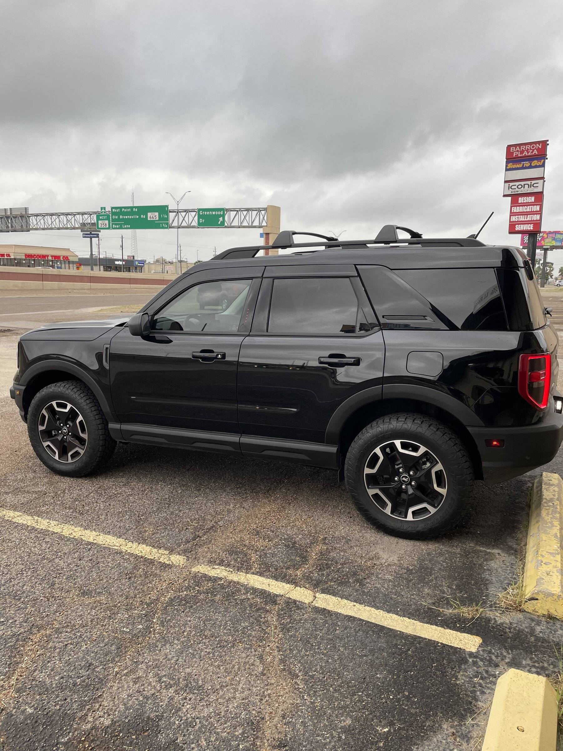

I’ve been reading threads of people putting 245/65 r17 on their BS but everywhere I go I am told they will rub without a leveling or lift. Thoughts?
Just installed Falken Wildpeak 245 65 R17 with no leveling kit an NO rubbing, very happy with the driving sensation of the new tires, and the look is amazing!

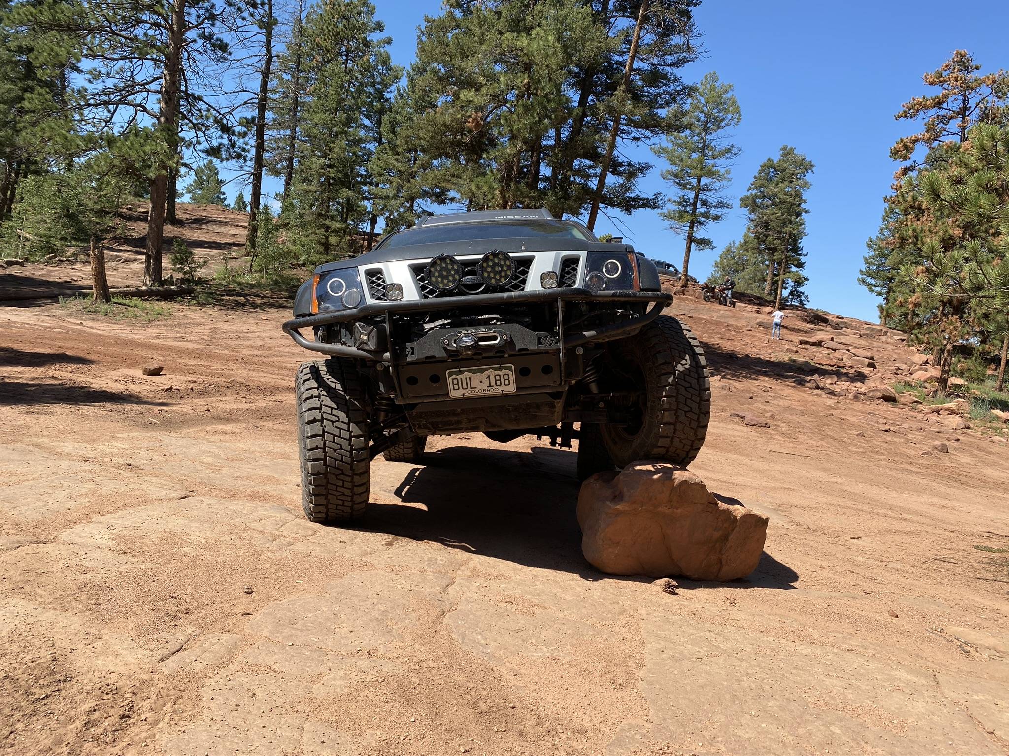

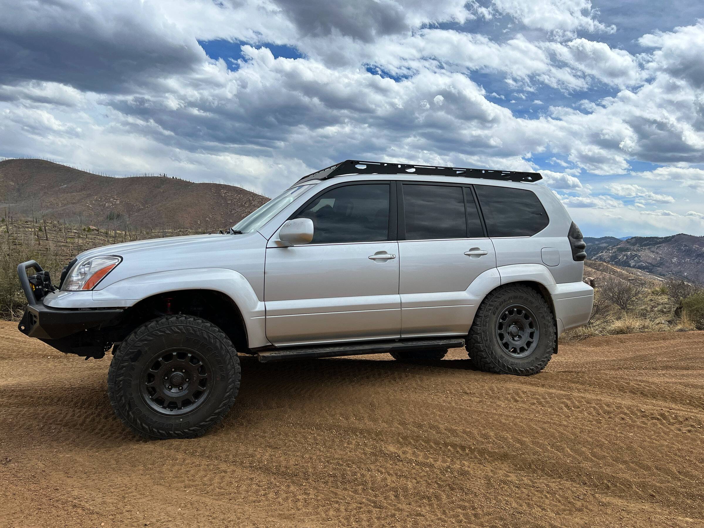

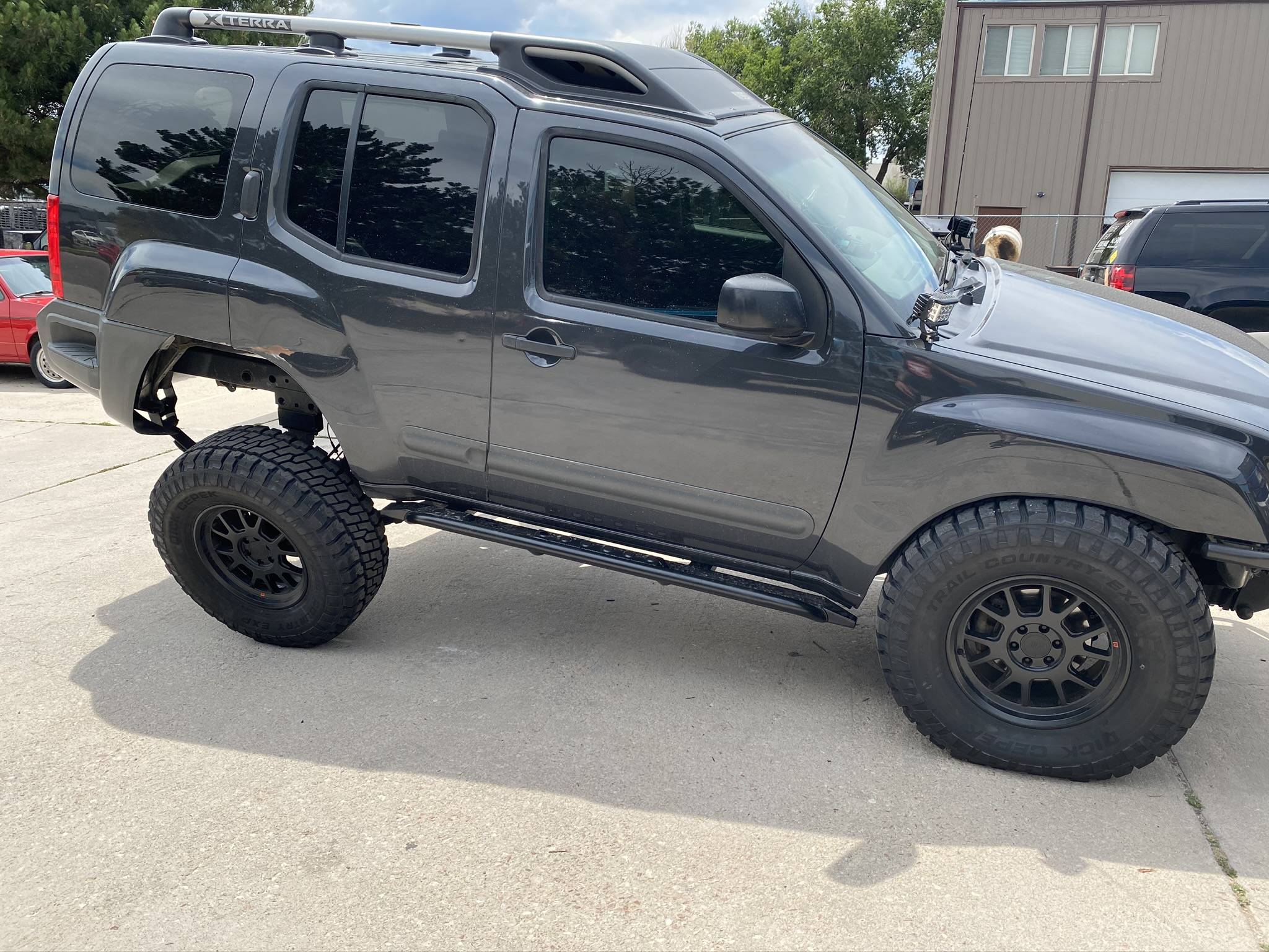

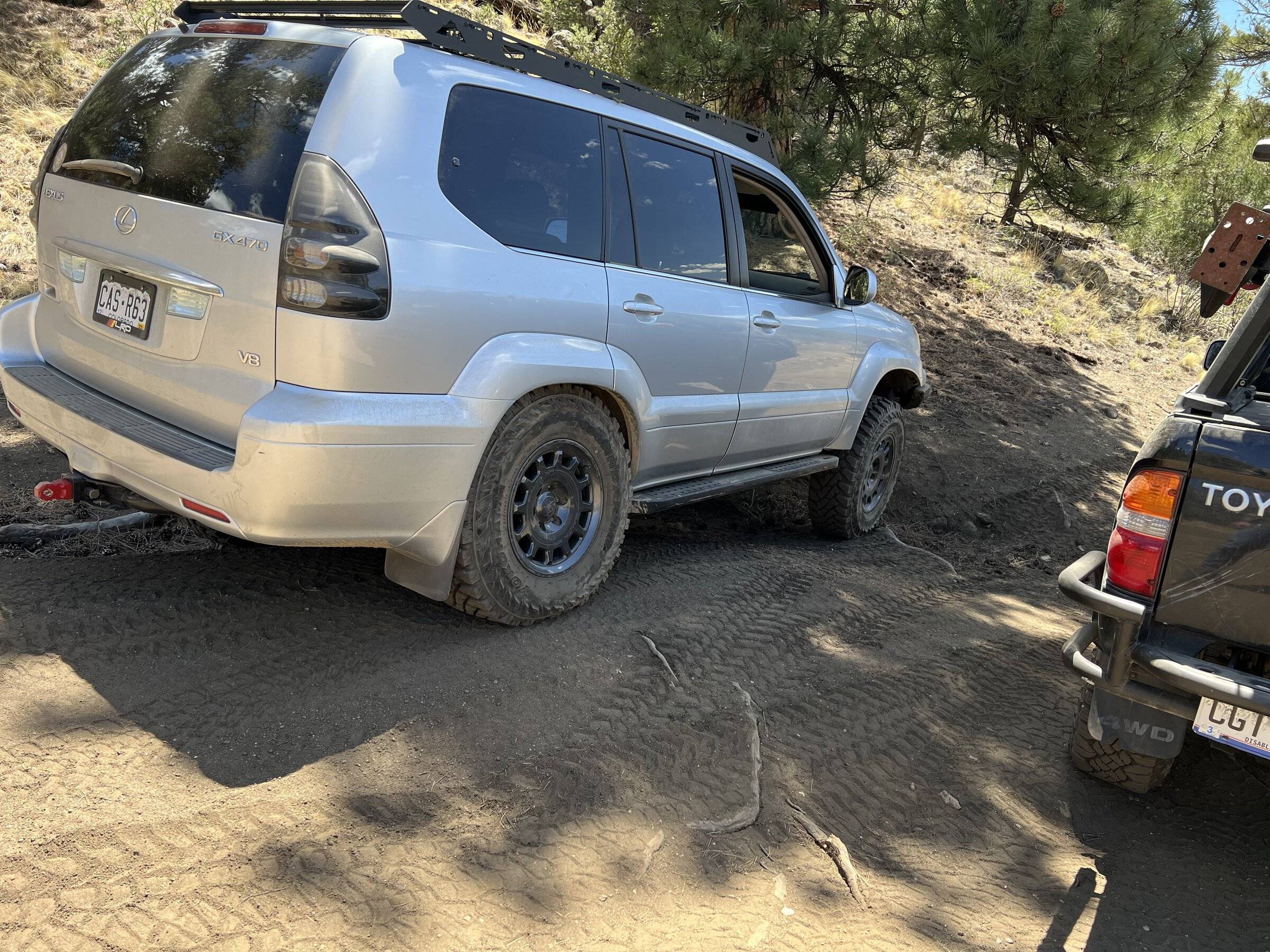

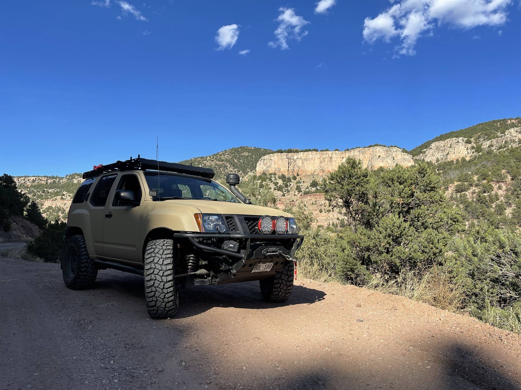

So people should stop lifting vehicles to fit bigger tires…..Lol, ok.

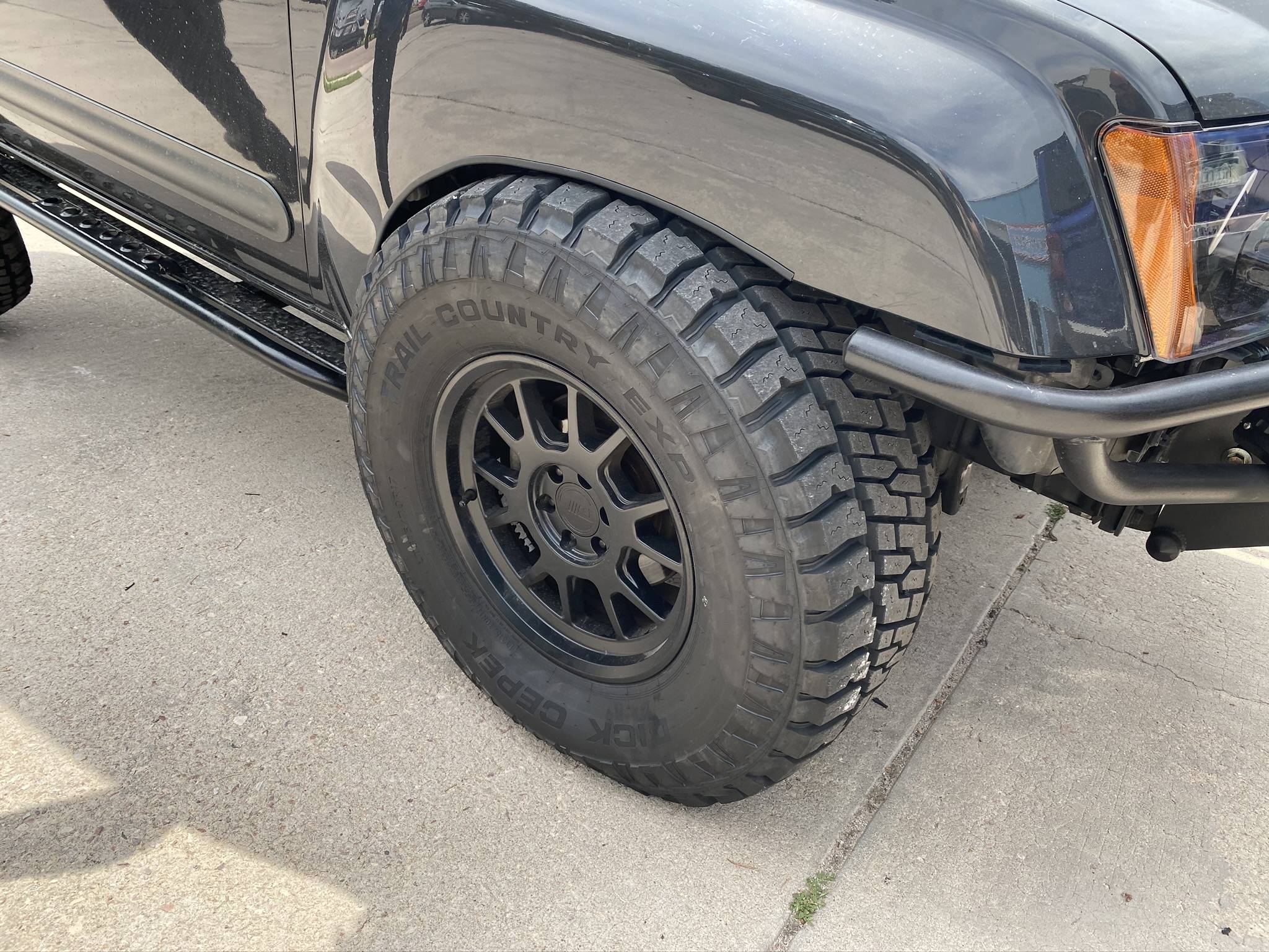

I’ve built plenty of mall crawlers with a combination
of lifts, proper wheel offset and fender manipulation to fit bigger tires.
It would not have worked without the lift portion of that equation.
Ford Bronco Sport Tires Size with stock height B4C1BD0E-00BB-485E-824F-3B80F05A959A
Ford Bronco Sport Tires Size with stock height B365F7E7-3A58-4808-BCD2-E709DBA6F05D
Ford Bronco Sport Tires Size with stock height 41086EAF-A92E-4366-AC9D-C1F10E3A90F4
Ford Bronco Sport Tires Size with stock height CE4C1419-CCF2-4FF6-823A-62C7712D51E4
Ford Bronco Sport Tires Size with stock height DC560A31-3AEB-4031-A950-D9C74E58D13D
Ford Bronco Sport Tires Size with stock height 2B873018-7C55-4960-A64D-1D5F05914C83
Your pictures are excellent proof that the lift does not change “if” the tire will rub, just “when” it will rub. That tire still has to go into the wheel well, the lift just changes when. Every one of your pictures shows that. Of course I am still talking about the limited lift that can be done on the BS. If you actually start changing suspension geometry, the outcome could be different. A spacer lift or lift springs do not change suspension geometry.
