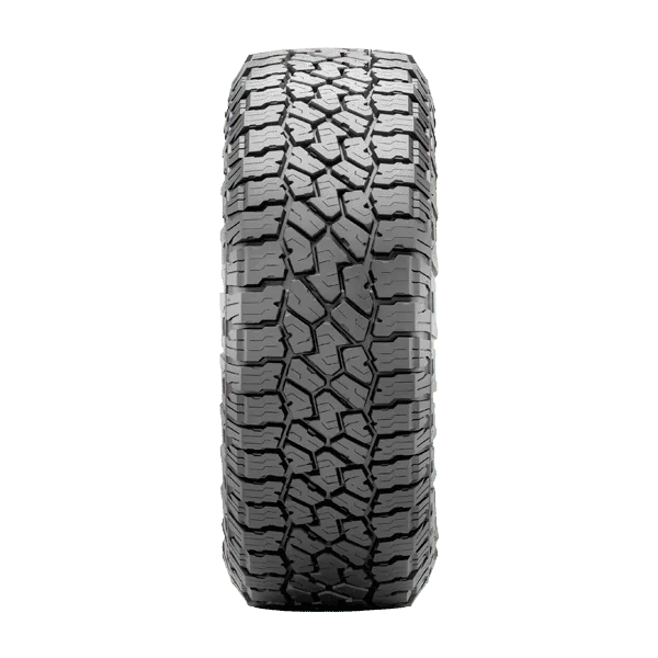

Falken introduces the NEW A/T4W
104
4,128
4,652
Here’s the data for 3 tires for comparison. Confirm all numbers are accurate before using this data. Links to the Specs are provided.
Edited: as stated by Discount Tire in Post #15 ā€˜Falken Wildpeak A/T4W is an improvement from its predecessor (Wildpeak AT3w), although Wildpeak A/T4W is 7lbs heavier, Wildpeak A/T4W is a more durable tire for off road and its UTQGL has improved from 600AB (I think Discount Tire meant 600BA) (Wildpeak AT3w) to 660AA. It's newer technologies equate to better snow traction and longer life.’
Falken Wildpeak AT3w OEM (Bronco Sport optional tire)
Where made: Thailand or Japan or Buffalo
Item number OEM part# 59000690 (for Ford)
Tire size 235/65R17
Load ID SL
Ply rating --
Service desc. 104H
Approved rim width (in) 6.5 - 8.5
Measuring rim (in) 7
Overall diameter (in) 29.1
Overall width (in) 9.6?
Revs per mile
Tread depth (/32) 13?
Tire weight (lbs) 31
Max Load Single / Dual (Ibs) 1984
Max Pressure (psi cold) 50?
UTQG: 600 B A
Warranty 5 Years / 55,000 Miles
Spec Link: OEM part# 59000690
https://www.tires-easy.com/235-65-17/falken-tires/wildpeak-a-t3w/tirecode/59000690
https://www.falkentire.com/wildpeak/at3w#size-list
WILDPEAK A/T4W
Item number 28841790
Tire size 235/65R17
Load ID SL
Ply rating --
Service desc. 104H
Overall width (in) 9.4
Revs per mile 731
Tire weight (lbs) 38.2
Max Pressure (psi cold) 51
UTQG: 660 A A (Edited)
Warranty ā€œup to 65,000 Milesā€
Spec Link:
https://www.falkentire.com/wildpeak/at4w
WILDPEAK A/T4W
Item number 28844768
Tire size 245/65R17
Load ID XL
Ply rating --
Service desc. 111T
Approved rim width (in) 7.0 - 8.5
Overall diameter (in) 29.5
Overall width (in) 9.8
Revs per mile 719
Tire weight (lbs) 41.9
Max Load Single / Dual (Ibs) 2403
UTQG: 660 A B (Edited)
Spec Link:
