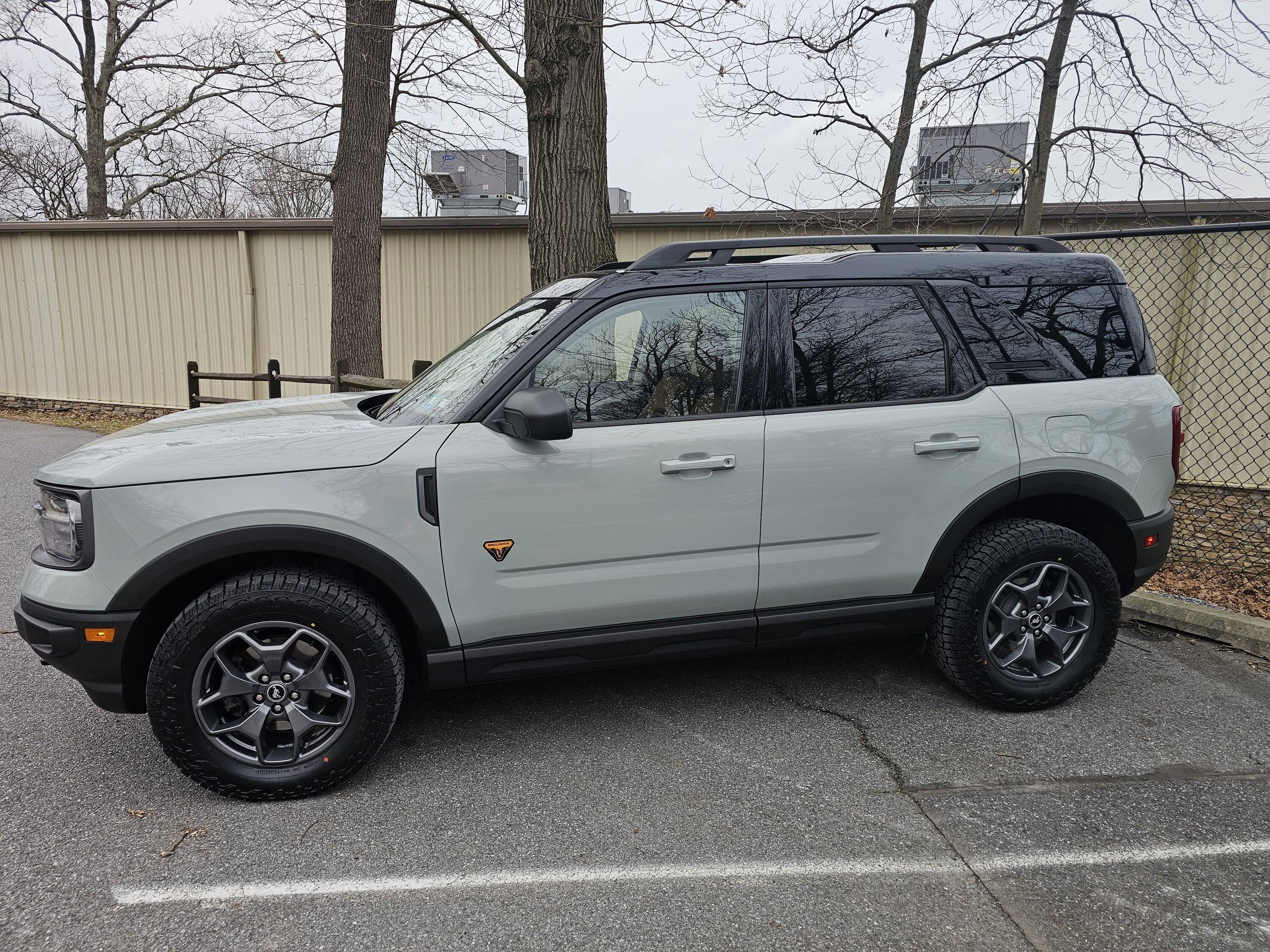

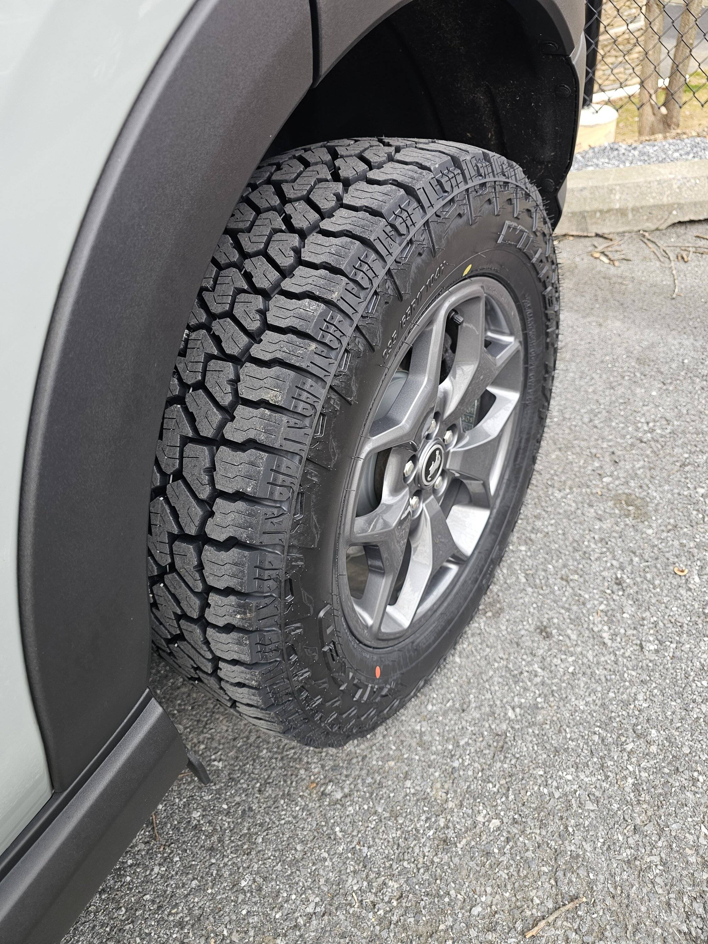

Just picked up my BSBL with the with the 4s. Nice looking, only got them a couple hours ago!!
Ford Bronco Sport Falken introduces the NEW A/T4W 20240222_125101
Ford Bronco Sport Falken introduces the NEW A/T4W 20240222_125045
Please update us with a report on performance (acceleration/fuel economy), ride quality, and handling when you get a chance.

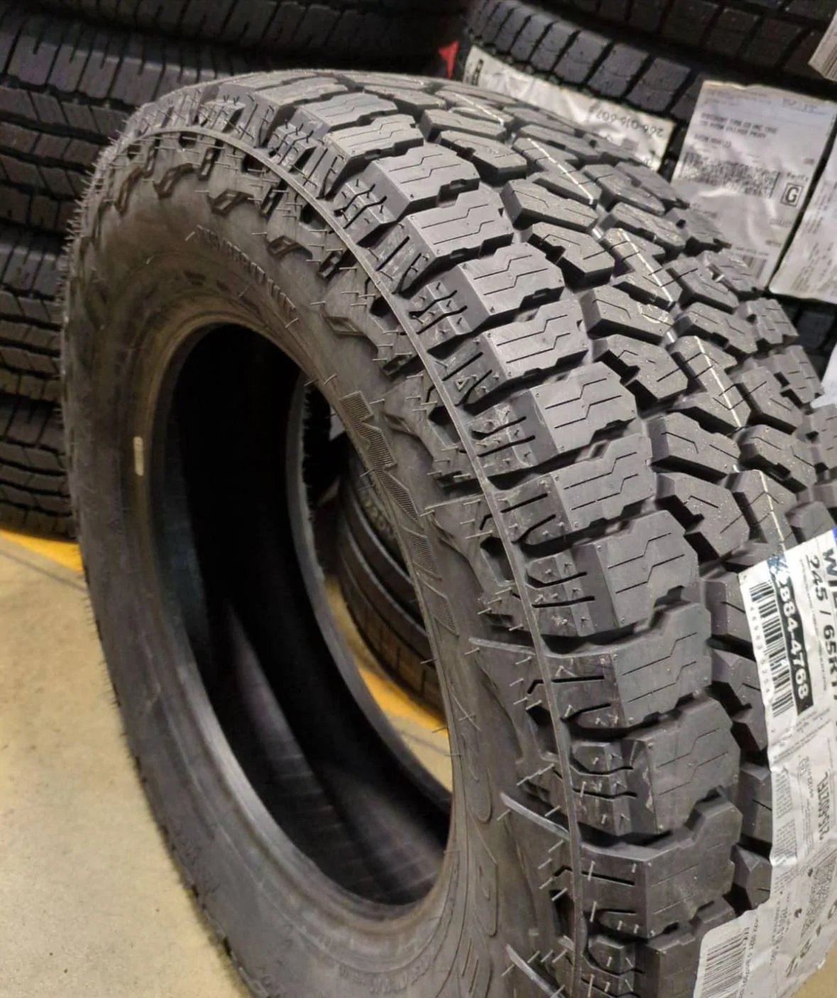

I will make a few assumptions. Deep down, you want 245/65's, you want a Rugged/Rugged looking tire, with a good reputation but not something above average weight.
Why haven't you seriously considered the Toyo Open Country AT3? It has an XL load rating, like the Falken AT4w and weigh 34lbs.
I will also point out tire weight does not affect how much load you can carry, as tires are un-sprung weight but both weight and diameter do affect acceleration and stopping distance. I personally chose the, 245/65/17, Mickey Thompson Baja Boss A/T's, at 39lbs, as my first set of tires and Nokian Outpost nAT's on lighter wheels, as my second, to try over the winter, and reduced the combined weight by 13.5lbs and see almost no difference, in gas mileage. Personally, I like the Mickeys better, as they are quieter and the ride is better than the 245/70/16 nAT's

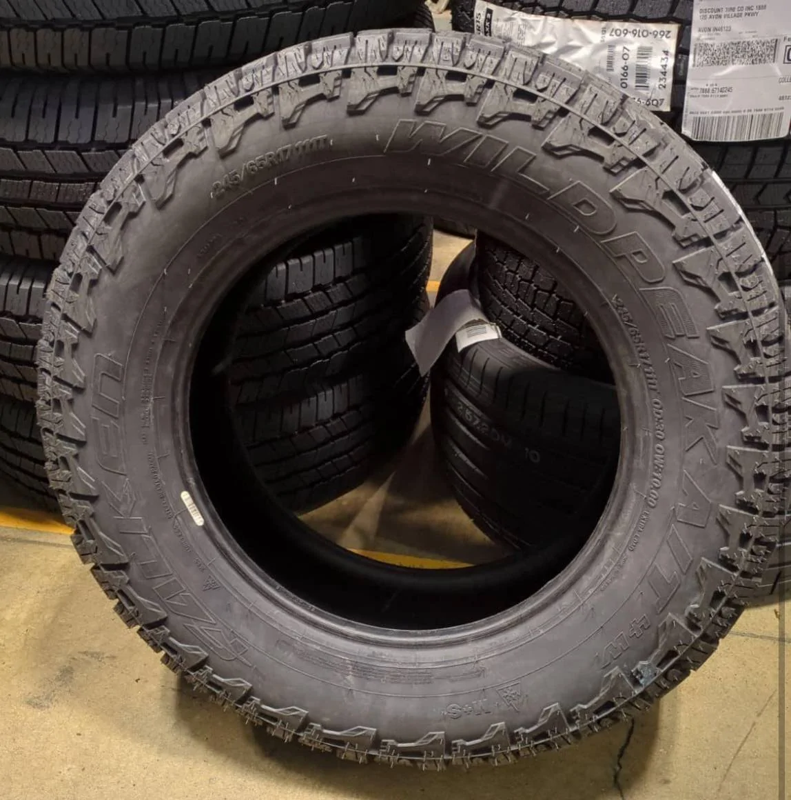

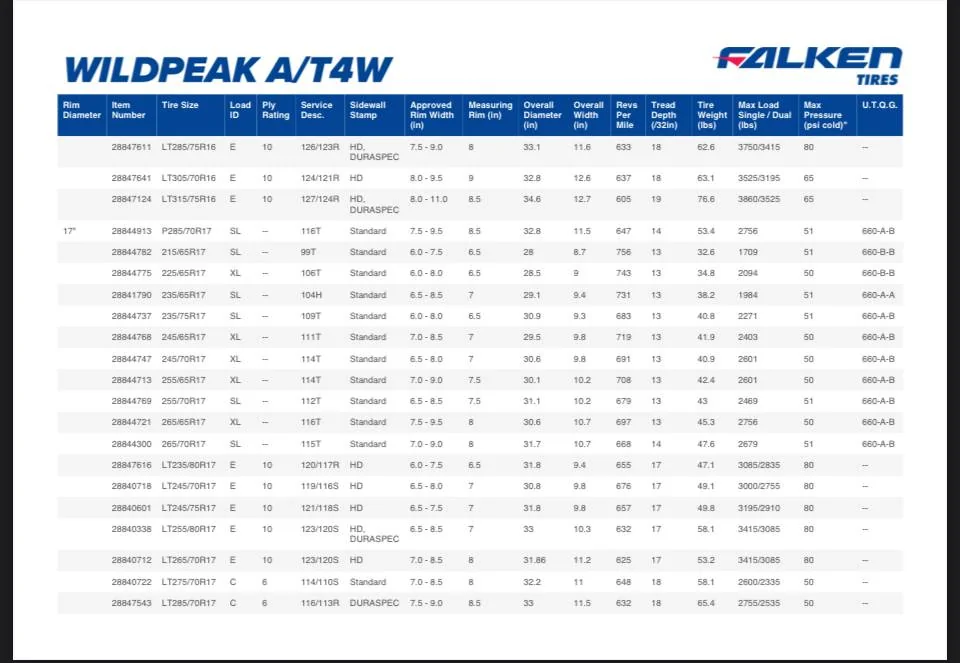

Update on Falken Wildpeak AT4. Only “certain sizes” are 3ply. Basically if it doesn’t say Duraspec or HD on the sidewall then it’s likely still 2ply.
I noted a pdf spec sheet on their website and emailed to confirm.
sharing in case others are like me in that if Im going to be adding that much weight the sidewalls best be 3 ply. Disappointed.
