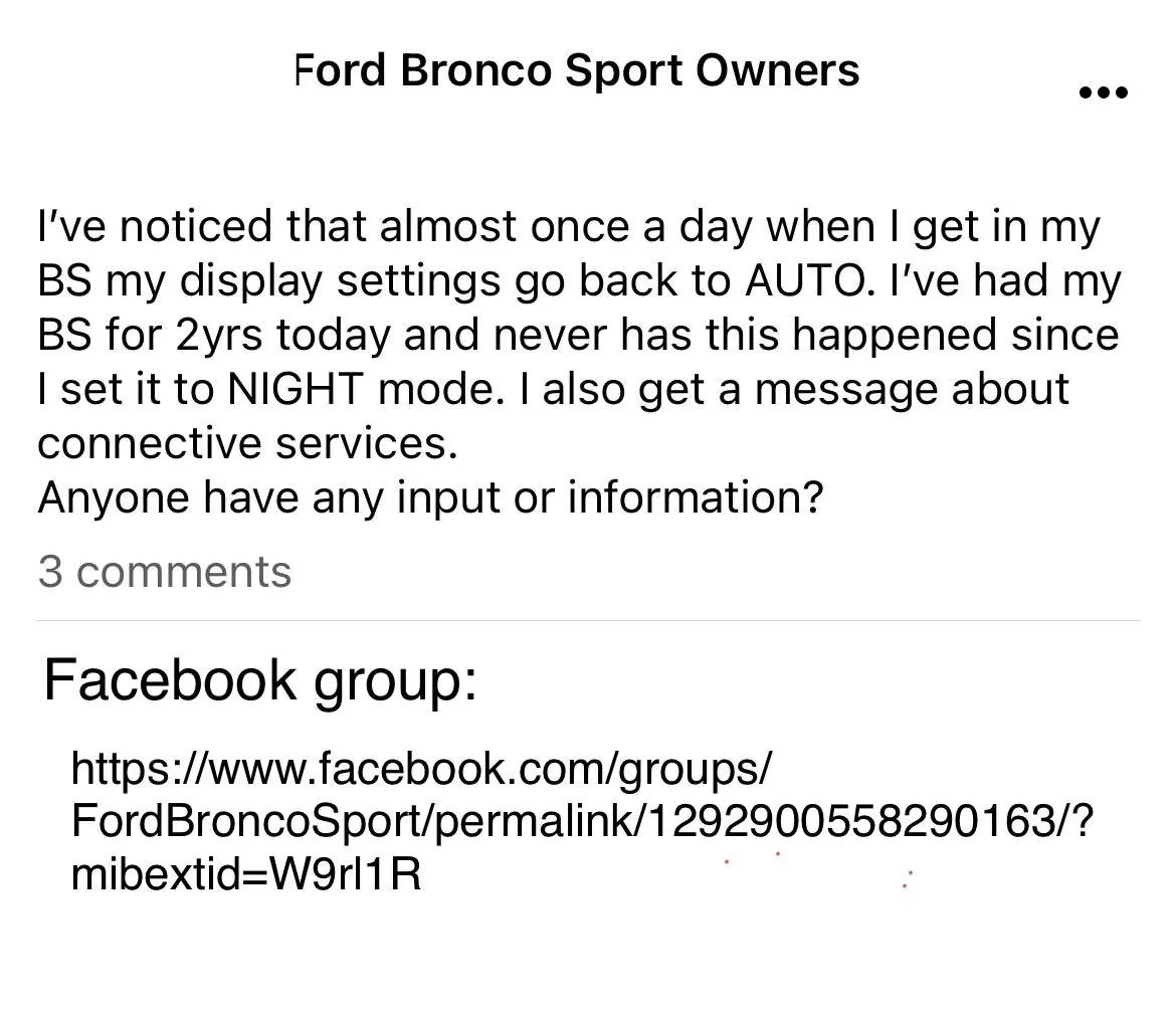

today another person posted on a Fb group they are having the default settings issues posted in this 22251 thread.
Ford Bronco Sport Sync 3.4 Build 22251 Default Issue 1687278090182
@thomasm23 .. any new info from the case # you filed?
