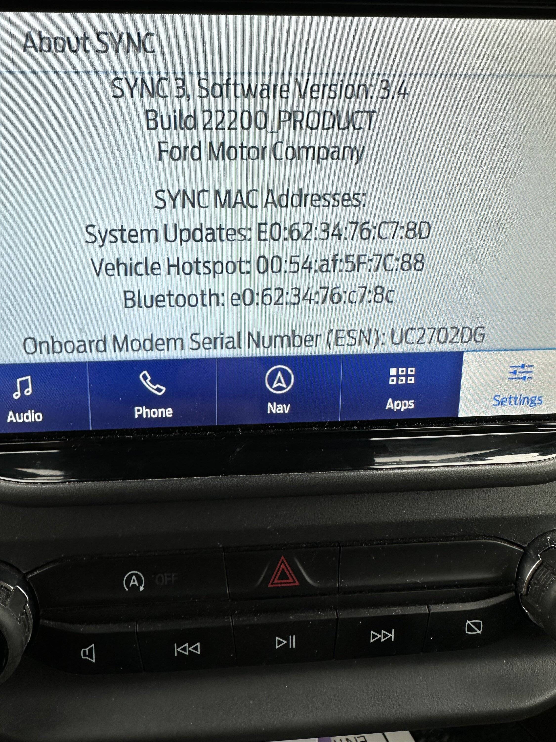

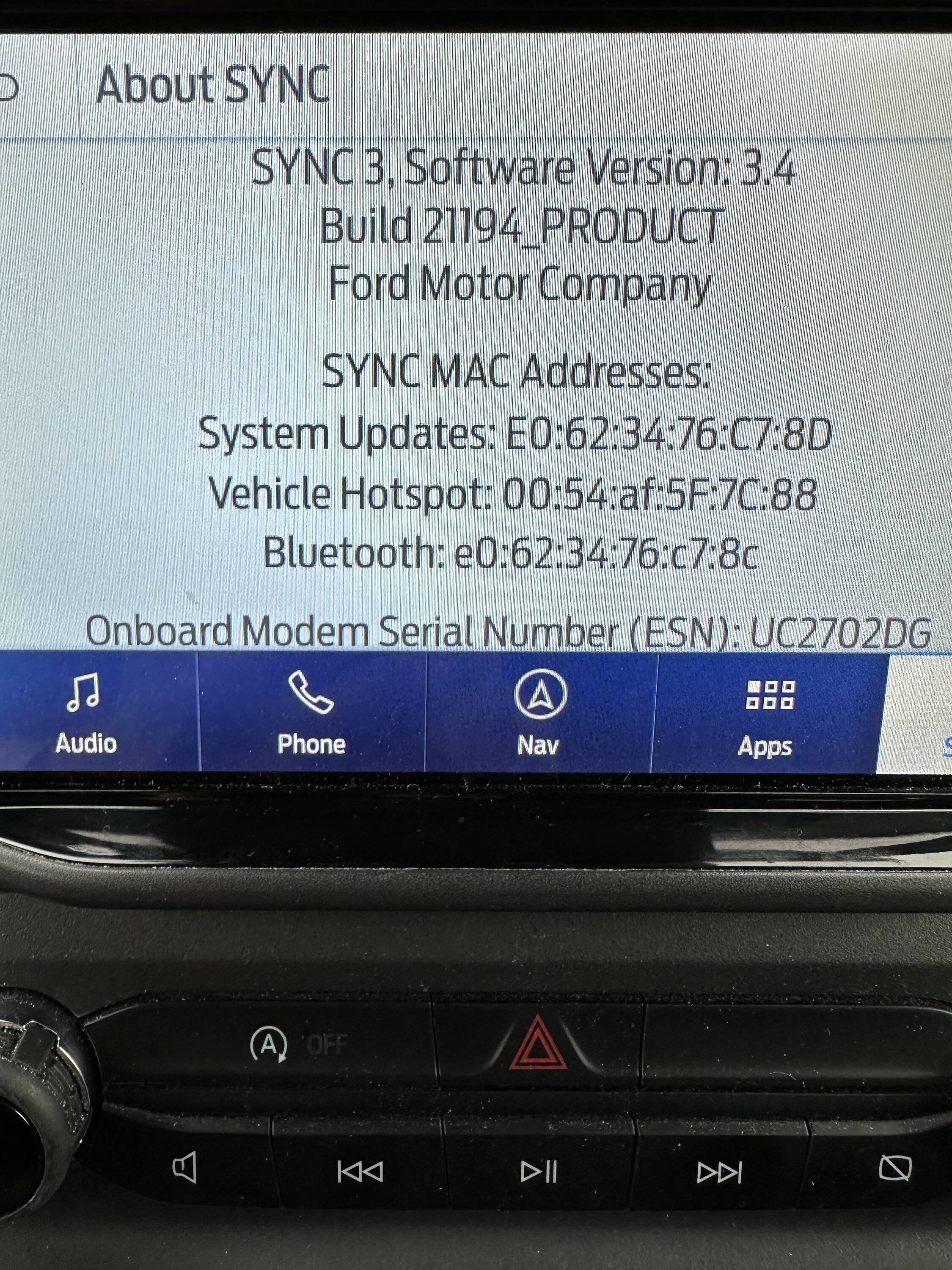

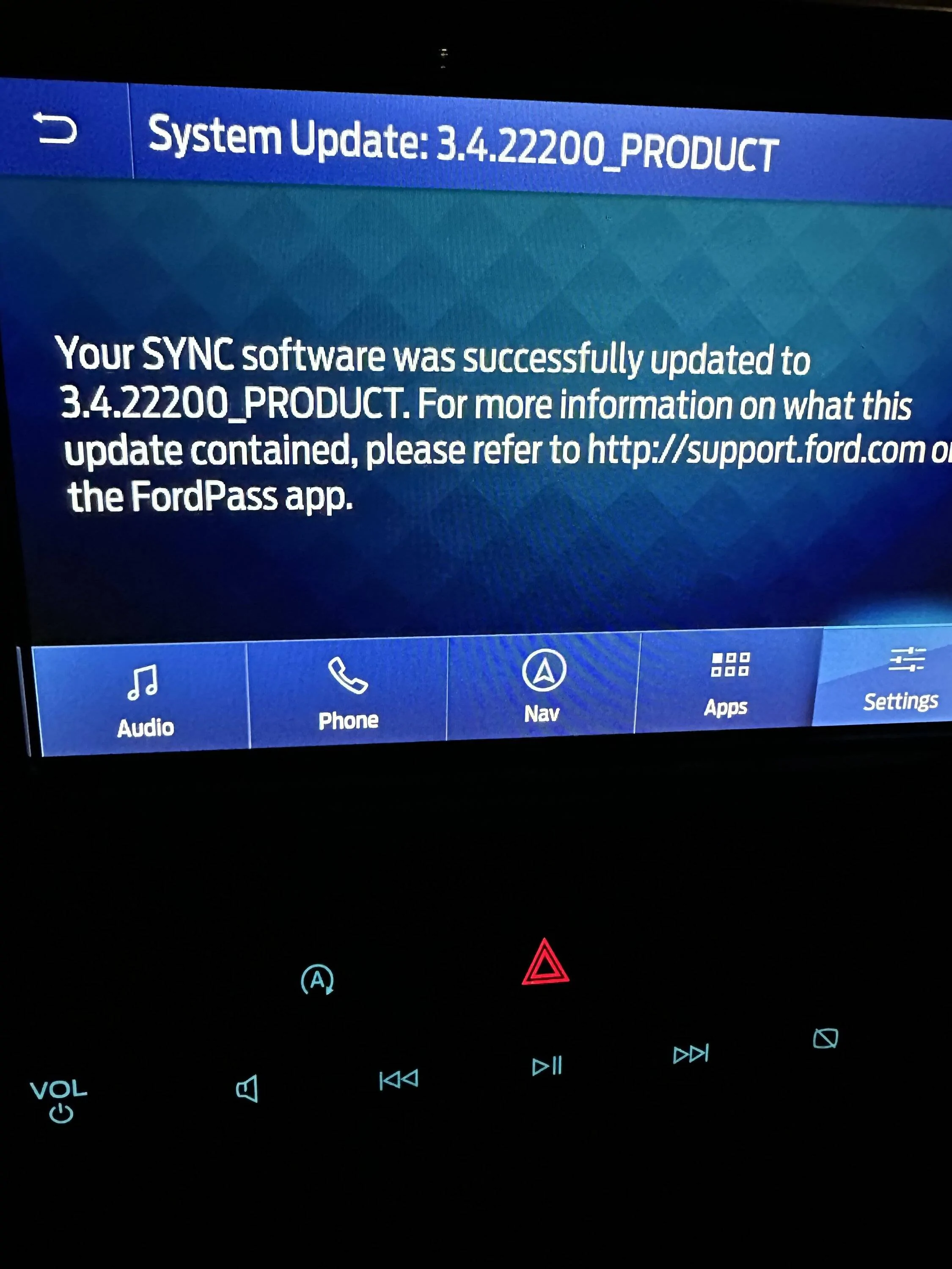

SYNC 3.4 Build 22200 now available.
https://www.ford.com/support/sync-maps-updates/
Update can be done using Scan for update now on the head unit or downloading the update to a computer and using a USB flash drive.
I used a USB flash drive. It took 20 minutes in the vehicle while running.
