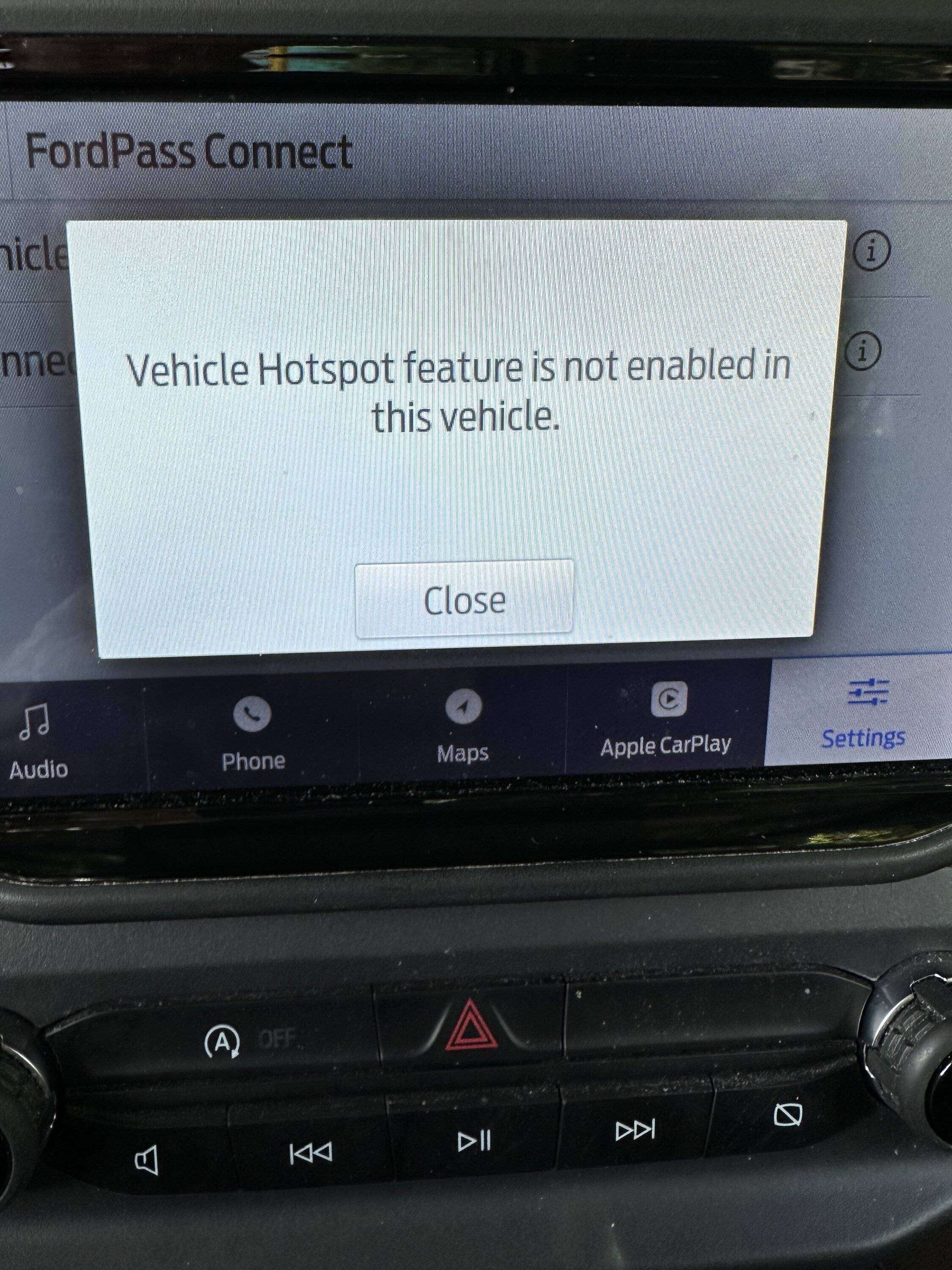

I have been having issues over the last month with Sync 3.4 Build 22251 settings changing back to default.
I set SiriusXM to show 6 pages and it will default back to 2 pages.
My Vehicle Hotspot indicates that it is not enabled.
I called Ford Pass and they worked me through a master reset. This brought back the Vehicle Hotspot. Other settings are still defaulting and being changed.
I found the following on Cyan Labs regarding this issue.
WARNING - STORAGE ISSUE ON 3.4.22251
There is an ongoing issue where rwdata partition is getting full, triggering some issues like settings going back to defaults and/or problems with upgrading to a different version. Check these threads for reference and workarounds:
Published: Tuesday, 02 May 2023 12:55:23 (Updated: Tuesday, 02 May 2023 12:55:44)
Anyone else seeing this issue?

You stated you contacted FordPass and I recommend you get a case open with the SYNC3: Connected Services Team
+1 (833) 389-0848 if you haven’t done that yet.

Ok I read over the cyanlabs info. I think you are heading towards getting your dealership to replace your APIM (Accessory Protocol Interface Module).
this is one of the main modules for Sync 3 but there maybe another module causing your issues as well.
suggest you keep pushing to get your dealership to do that.
Just my opinion. Get other opinions as well.

The issue may be lack of memory or storage as logs are being created that are reducing available space.
I do not believe this is a hardware issue.

Yes, I performed a Key Cycle. This was part of the master reset. Ford Pass tech had me do master reset, then Key Cycle, then re-pair Ford Pass app to vehicle.
I originally talked to Ford Sync tech support. They then transferred me to Ford Pass tech support to do a master reset.
I still feel this is due to Build 22251 and the excessive logs that are being created. No previous Build had this issue.
Many times the dealer just gives up and replaces parts. My vehicle is out of warranty. Ford may be readying a new Build to address this issue.
I feel there are more vehicles on this forum that are experiencing this issue, but are unaware that it is happening.
