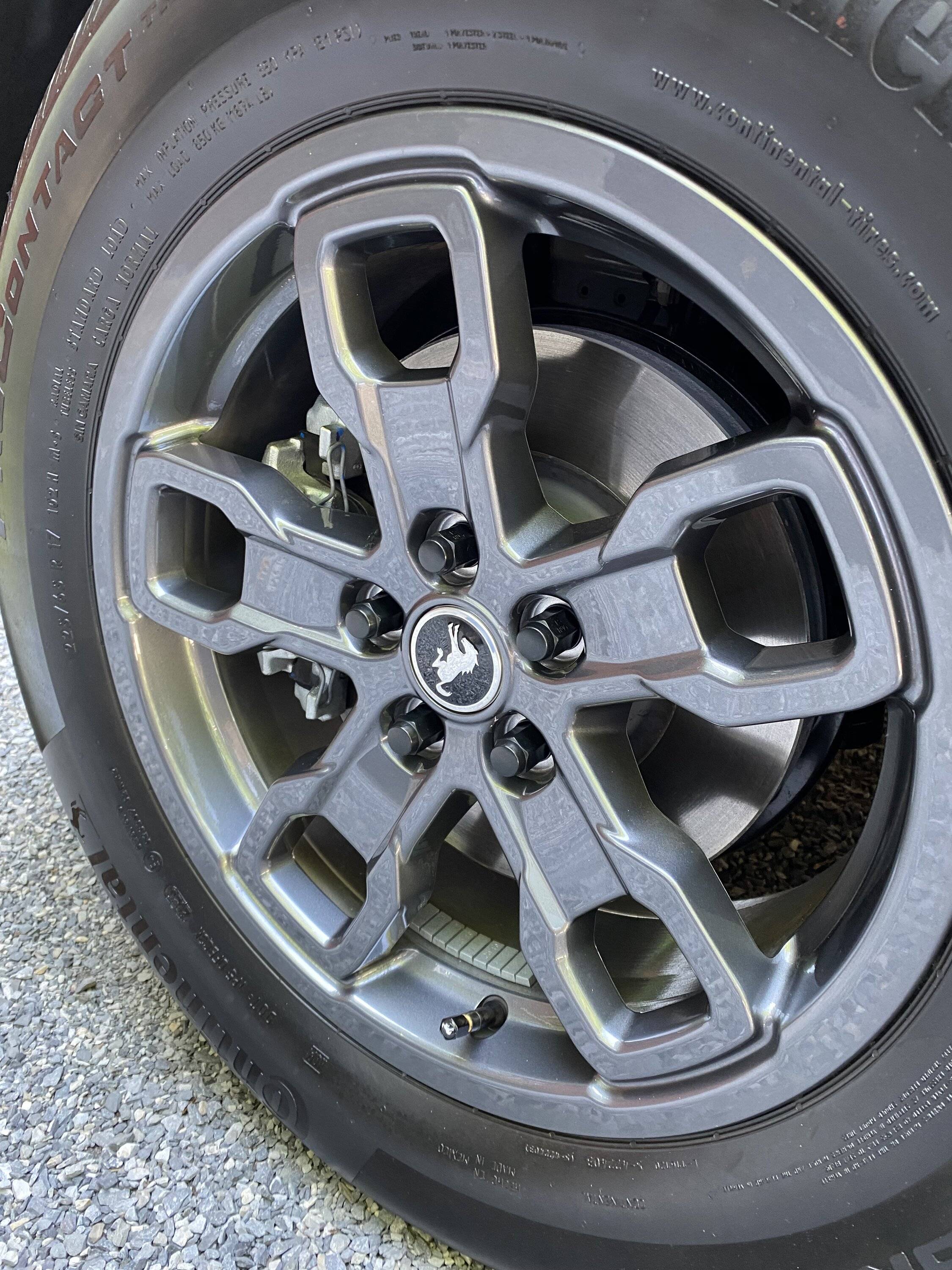

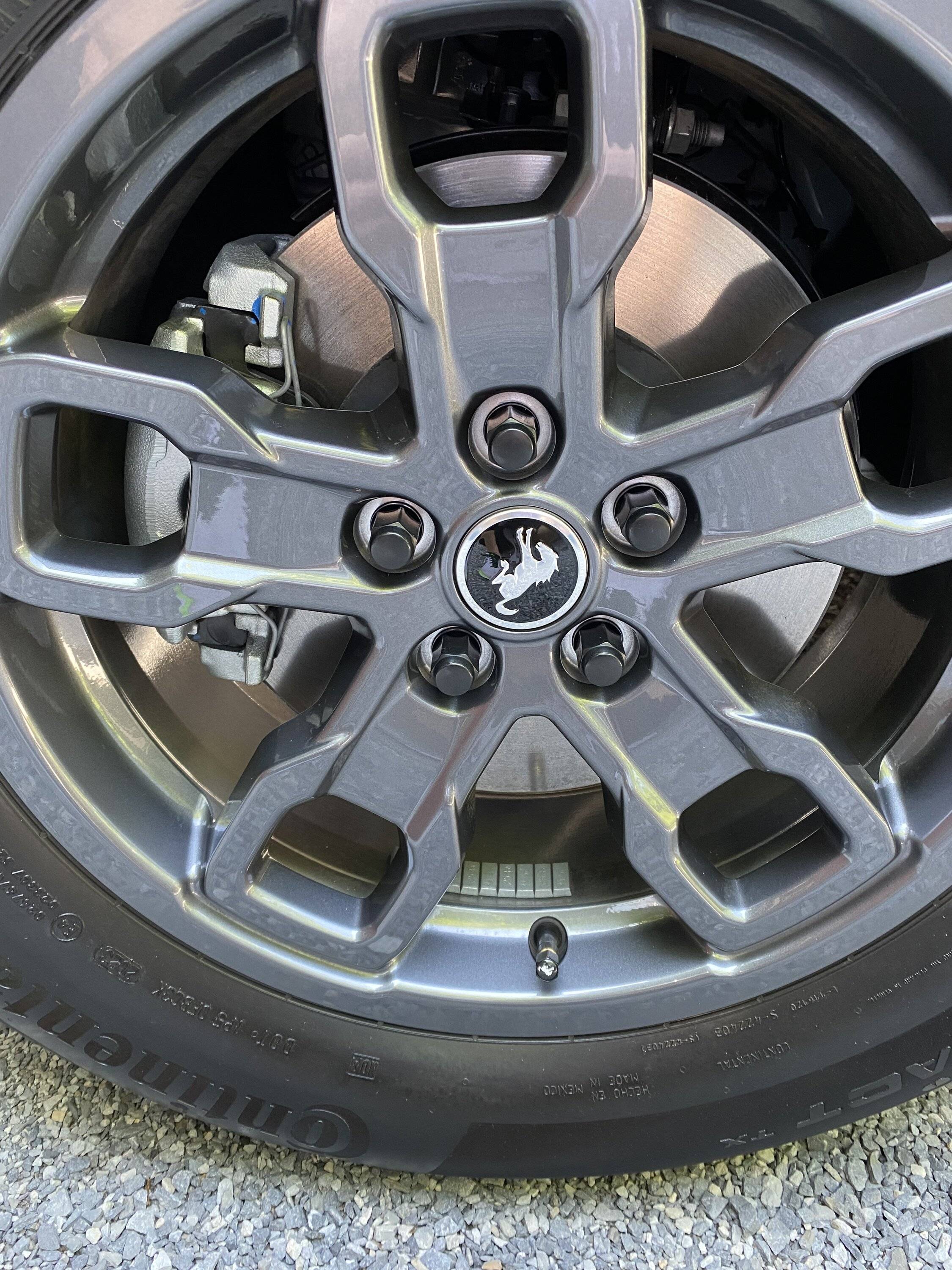

Nut swap complete.
Dp Accessories closed-end M12 x 1.5 thread / 19mm hex bulge acorn conical style.
$40 for the set @ Amazon. Part # LCB3B6HE-BK04020

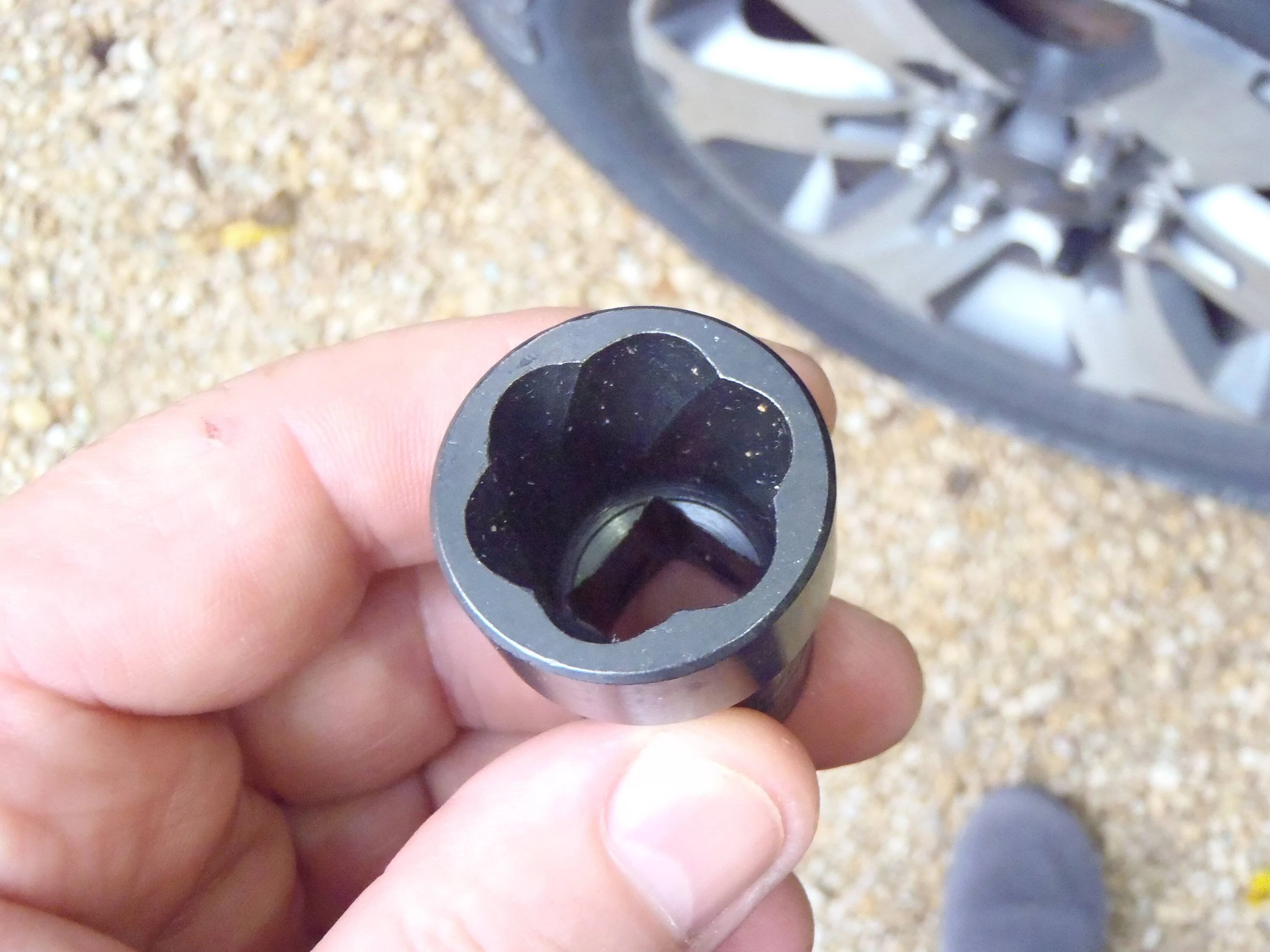

There is a socket one can buy that will bite into the lug nut and def takes it off. They call it a turbo socket and it is specifically designed for wheel nuts. I got one for my F150 in case any of the nuts refused to come off as I replaced them with Gorilla nuts. I didn't have to use the turbo socket so I can't tell you, my experience.

They call it a turbo socket ...
Caliper bracket bolts were corroded and rounded with a regular socket when I did the rear brakes on my '14 Escope in January at 98,454 miles.
DEWALT MAX IMPACT Extractor Set (5-Piece) DWABEXTRACT5 - The Home Depot
Worked GREAT! Highly recommended purchase if you're doing brakes on a high-mileage vehicle.
My review is in the comments. Another review also mentions them working great for corroded brake bolts.
