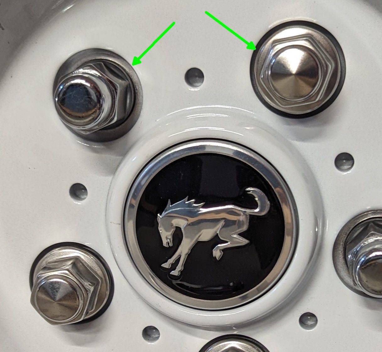

The next mm size up socket, preferably 6-point (20mm iirc?), will do the job on your swollen schwetty nutz. Worked for me.

Yeah, but the 20mm will get your swollen nuts off so's you can install the new ones. Had to do that on my '17 Escape.

Got my new nuts from DPAccessories on Amazon. They're perfectly functional and certainly more functional than the OE junk.
But... the flange is smaller, so they don't fill up the counterbored holes in the wheels. No one will notice just walking by, and for sure not at 70mph... but it's something.

See Car & Driver's article about Ford's horrible lug nuts. Experienced this myself, including having to get a half size socket to remove swollen and chewed up lug nuts, and switched multiple Fords over to McGard lug nuts.

My '84 VW GTI had removable plastic caps...a lug wrench would not fit over them and they were easily pulled off by hand.
The Ford lug nuts have a non-removable, bonded chromed plastic outer piece.
They will leave you stuck at a most inopportune time when you have a flat and your lug wrench won't work due to distortion of the plastic from previous removals/re-installations. Worse yet, a dealer may try and charge you a small fortune to replace them when they can't rotate your tires during your routine maintenance.
