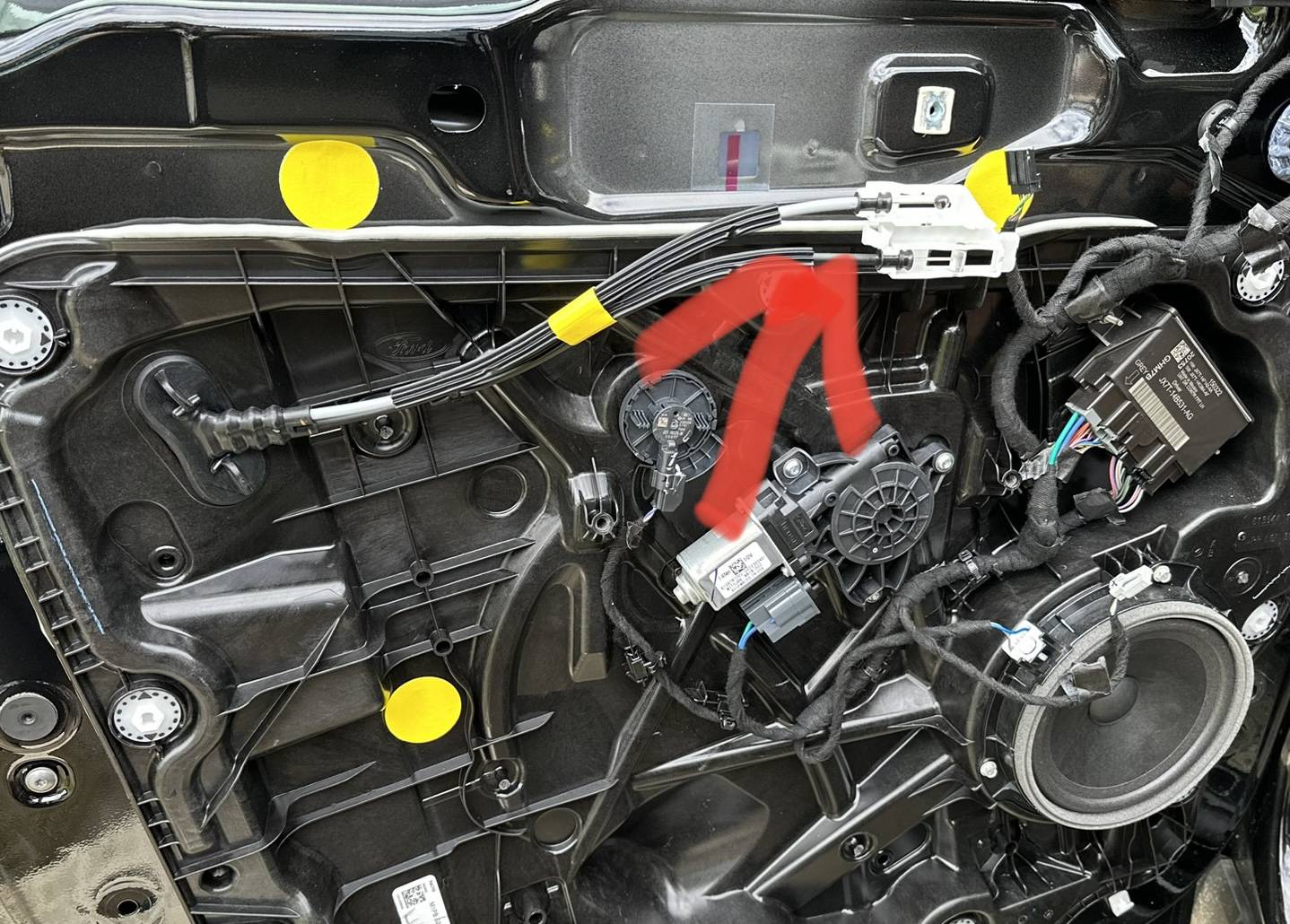

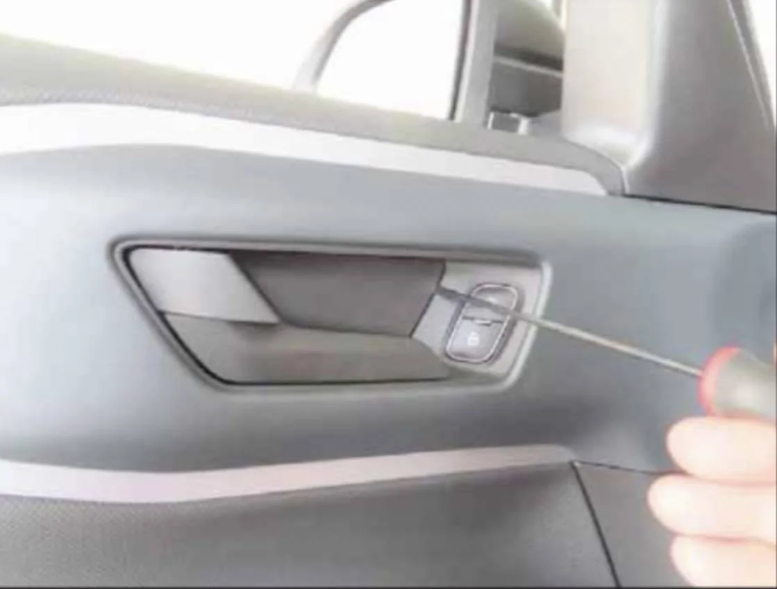

I did the front doors the other day. It was pretty easy other than two small items. First, the little panel behind the door latch lever is very difficult to get behind. What seemed to work for me was to insert a small plastic trim tool in the front gap and then use a small flat head screwdriver to pry it off. When I tried this technique with 2 trim tools, the plastic tool just flexed. The second problem is that the cables for the door latch are held with a clip that apparently doesn’t want to come off and in the end just breaks the tab off. I don’t think this is truly a problem going forward but it happened on both sides without me even realizing it was happening until it was done.
The other thing to be prepared for is that the door latch cables will stay attached. Unless I’m missing some way to release them. So, I had a stool sitting close to sit the door card panel on while I worked. If you are just doing the speaker, I would say this is about a 15 minute job per door. Maybe a little slower on the first door and faster as you go.
I used a 10mm socket/ratchet, 8mm nut driver (door latch area screw), 7mm nut driver (behind reflector and 2 on bottom edge of door card, and plastic trim tools.

There’s a clip to press to remove the lock mechanism on the side of it and goes back in same way, just touch it and it’ll release the whole cable connection. To put it back in, you have to move the lock latch on the door and will clip in. The plastic panel behind the door handle, just push a trim tool in towards the front middle of that panel and it’ll pop right off. I’ve had the doors off 5+ times, always came off easy. Never broke anything. Look at the tip of the red arrow, you’ll see the release tab. Push that towards the front of vehicle and it pops right out.
