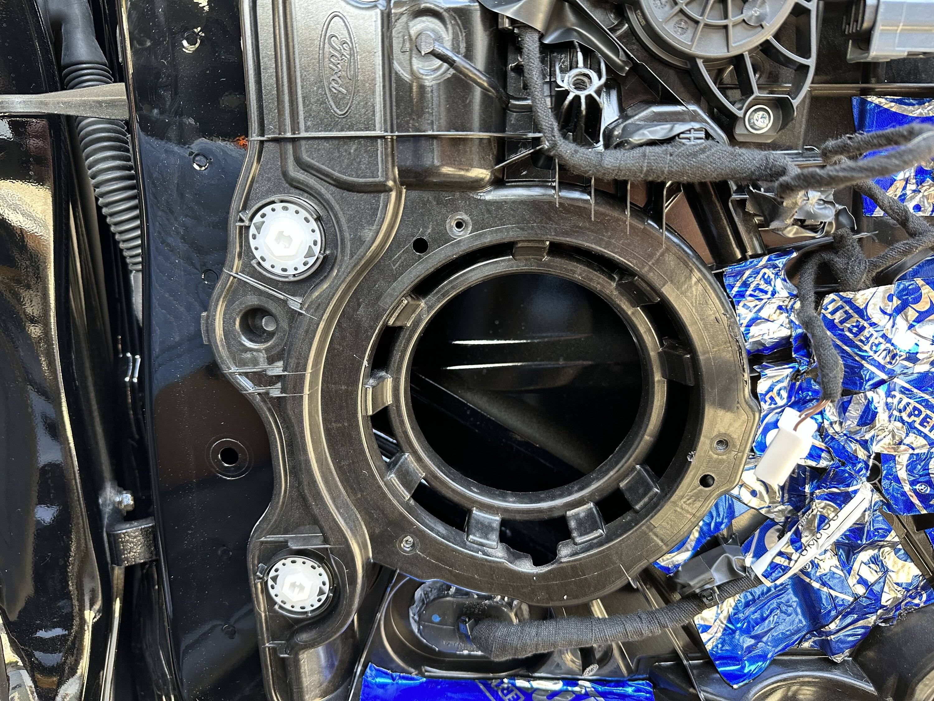

I was crutchfields guinea pig. They recommended speakers that they said would work and didn’t. Crutchfields recommendations were the worst fit out of the many I tried. They are going by size, not that they actually installed them into an BS. I tried a bunch to see what would work. Different sizes, depths, style, etc. Also on their site 6.5” speakers just means they’ll mount up to 6.5” opening. The one set they sent me was actually a 5” speaker but would mount into 6.5” and they call it 6.5”. Is weird.
You could use either, the Powerbass component set or the 2 way front or rear. I went the two ways up front since I didn’t want to pull the dash apart again. (Waiting on Ford to fix my constant rattles) but the tweeters if you did components up front will mount into the dash no problem. I did check. Crutchfield also says only like 7 speakers will mount up front since it’s listed as 6 3/4”. Pretty much any 6.5 will fit since you have to use mounting adapters. The rear doors could be an issue with a big magnet mid woofer the way they sit in the doors. The terminals won’t let it sit flush. I tried. Here’s pic of rear door.
