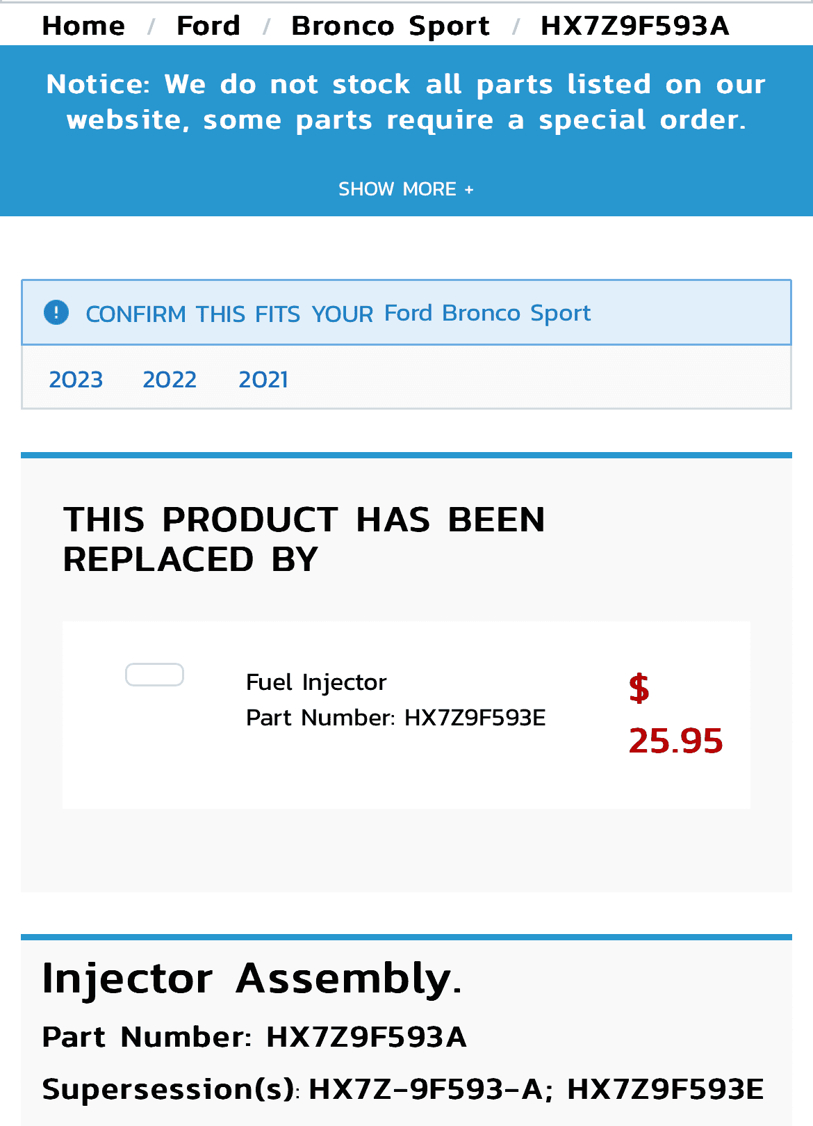

Can you please share your source for this? From what I can see these parts are interchangeable; there is nothing to suggest one superseded another.
This does show the A part is replaced by the E part. Can’t tell if the E part is redesigned or from a different manufacturer.
Ford Bronco Sport So it happenedšŸ˜¢ā€¦.. 1688307512361
Please share a link to the site instead of a screenshot.
Nevermind, I found what I was looking for. It does appear that "A" model injectors are no longer available, and customers are redirected to the page for the "E" model. There is no data indicating the reason for the change. Retail parts available direct to consumers often carry different part numbers than OEM, so these may be completely different from those installed at the factory.
Everything appears to be identical between the "A" and "E" versions except the part number, including the price, which indicates to me no change in quality. I do not find this to be compelling evidence that the parts installed at the factory were faulty.
I simply googled the A part number (also googled the E part number). Every Ford parts site I looked at shows the A part was replaced by the E part.
(Google HX7Z9F593A)

Now all we need are the complete Ford parts drawings for HX7Z9F593A, and for HX7Z9F593E and to talk to the Ford engineers responsible for the HX7Z9F593E part to know what changed and why. Ford designs or sources replacement parts all the time, sometimes to fix issues and sometimes for cost reasons.
It’s a diff revision - anyone with a 2021/2022 BS should get the updated part to avoid future issues.

It’s a diff revision - anyone with a 2021/2022 BS should get the updated part.
There's nothing stopping you from purchasing and installing them if you believe it's necessary. Personally, I'll trust Ford's engineers.
There’s no question it’s a different revision and the old part cannot be purchased now so anyone buying needs to get the E part number or later revision if that happens.
I used to design for a major auto manufacturer and I’ve designed and redesigned many parts for many reasons including cost. All I said is I would like to know what the E part design was for.
I agree with your last sentence because there is no way to know what changed from info I found online but I don’t agree with your first sentence .. I carefully looked at both parts on several
sources of information and I cannot tell what changed and no way to know about quality based solely on cost. All we know is the E part replaces the A part and looks like apparently the A part cannot be purchased. Not much else is known.
