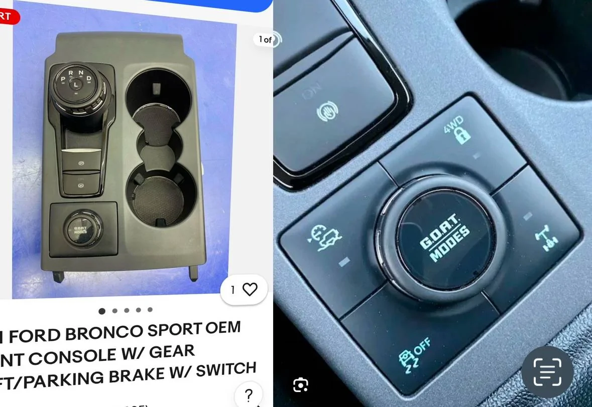

You can roll your eyes, but does my OBX have traction control? If so, where do I find it? Remember, I’m a So. CA kid and we just don’t have weather to worry about this kind of stuff.
Thanks.
115
4,762
5,865
A vehicle computer automatically controls traction control on the OBX. See this post for the setting to enable/disable):
https://www.broncosportforum.com/forum/threads/how-do-you-turn-on-off-traction-control.2842/
I haven’t been in an outer banks model but I’m guessing yours looks like the pic on the left while the pic on the right is for the Badlands and other models with the 2.0L and its controls (on those, traction control is the button on lower left).
