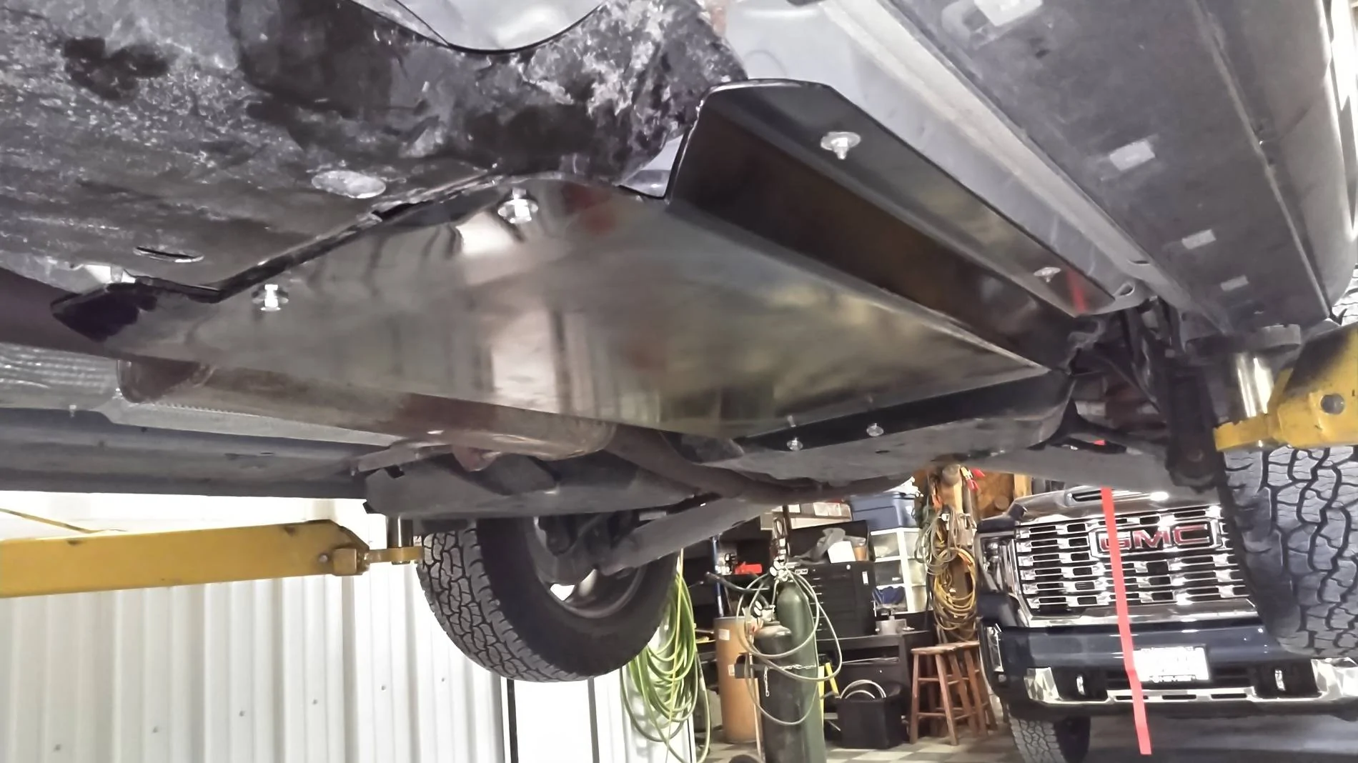

First time off road I ripped the felt pad off my Badlands. Ford did a good job with underbody protection, EXCEPT This! The after market ones sat lower than I like and required modifications to work on the Badlands, so I decided to make my own.

Drilling through that pinch-weld for my installation was a mother! Not sure how well those stamped steel speed nuts will hold up though, if that's what you used on the outboard sides

Looks great! I like how well you have it tucked up nearly flush with the side rails.
I will see. The bolts at the front and back are the main support. I may add a few more bolts if needed. Will be testing it in a couple of days at Big Bend National Park in a couple of days

Very nice work. You should sell those. I ripped mine off the first offroad trip as well. I've found that on rutted roads, the catalytic converter also needs protection, so I bought a skid for it too. I also put a 1-1/2" lift on. Very capable rig now. I have the skid for the other side, but I'm not sure I need it.
Drilling the pinch welds ate through several DeWalt bits in the first 1/2 hour, and only drilled one hole. I ordered a "13Pcs Cobalt Drill Bits Set, M35 HSS 135 Degree" set from Amazon for $10, and it went through the welds like magic.
I ended up getting carbides, the cobalt ones only seemed to scratch the paint and polish the steel
