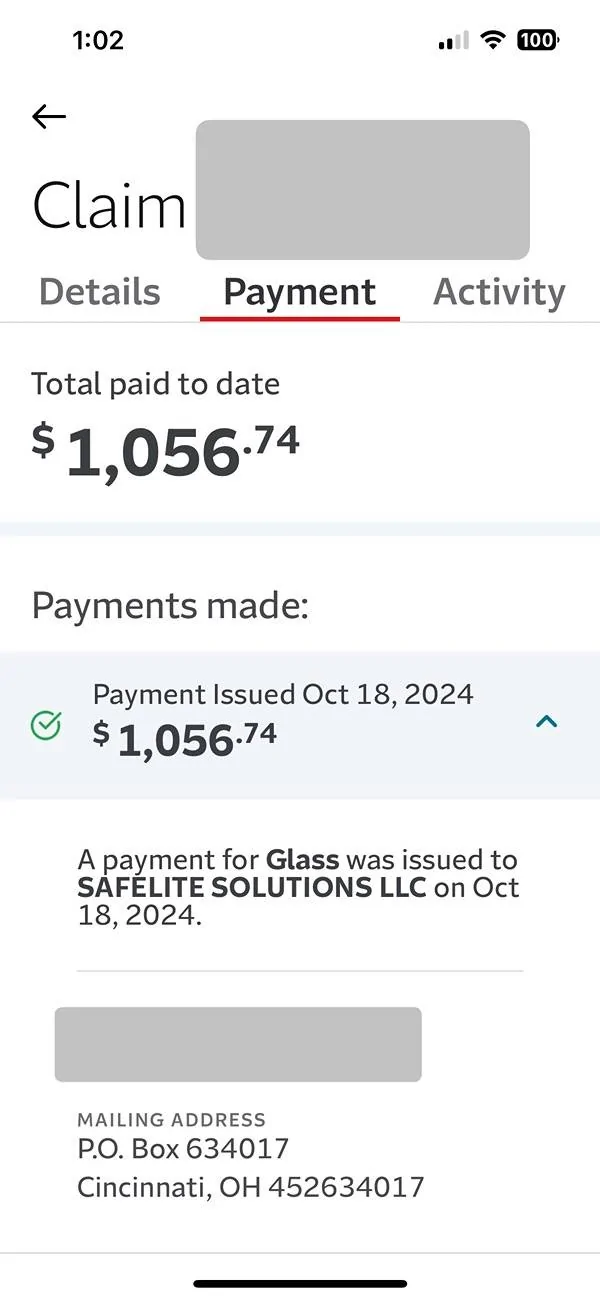

I feel like you answered your own question. Since this is 100% out of pocket, go with cheapest option. Next one is covered 100% insurance so go with what you can afford. My 21 BSBL got replaced 6 months ago it just cracked stopped at a light. Nothing hit it. Seamless replacement with Safelite $1056 but 100% covered by insurance. Just ensure if you have tech like lane assist and collision assist they drive the car at 45 mph to recalibrate.
Ford Bronco Sport Should I Go With Factory/OEM Windshield Replacement or Aftermarket? IMG_3909
