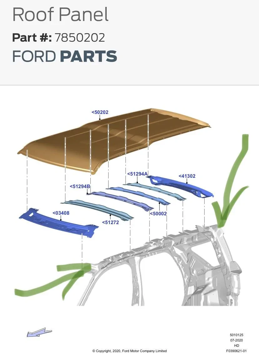

GaryS
Dec 5, 2021
59
NYC
The 600 pound static weight limit is the weight that the top part of the body frame supports. The roof rails purpose is to transfer the weight to the body frame (not the sheet metal/glass on the roof). The reason for lower dynamic weight limit has nothing to the bronco sport’s structure becoming weaker in motion. The dynamic weight limit is solely for keeping the risk lower for loss of control due to a higher center of gravity.
like dbcamp said, the moonroof assembly weighs more than the section of roof it is replacing. The 50 less lbs is because Ford determines a certain weight above center to be safe in motion, not because the 50 pounds would be to heavy for the sheet metal/glass combo. Like I said, the sheet metal/glass does not support any weight
