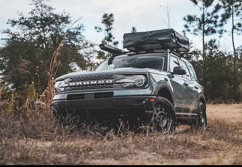

Here is a BL+BL aka w/ moonroof (100lb dynamic weight limit) Not only does this have the tent, but also crossbars and awning.
I highly doubt they uninstalled those accessories and transported them then re outfitted for the photo in the field. That’s a dynamic weight over 100lbs. So either they didn’t get the memo or knew it was safe and wouldn’t harm the vehicle

That is what I have been noticing in Ford's promo photos. over the weight limit!
