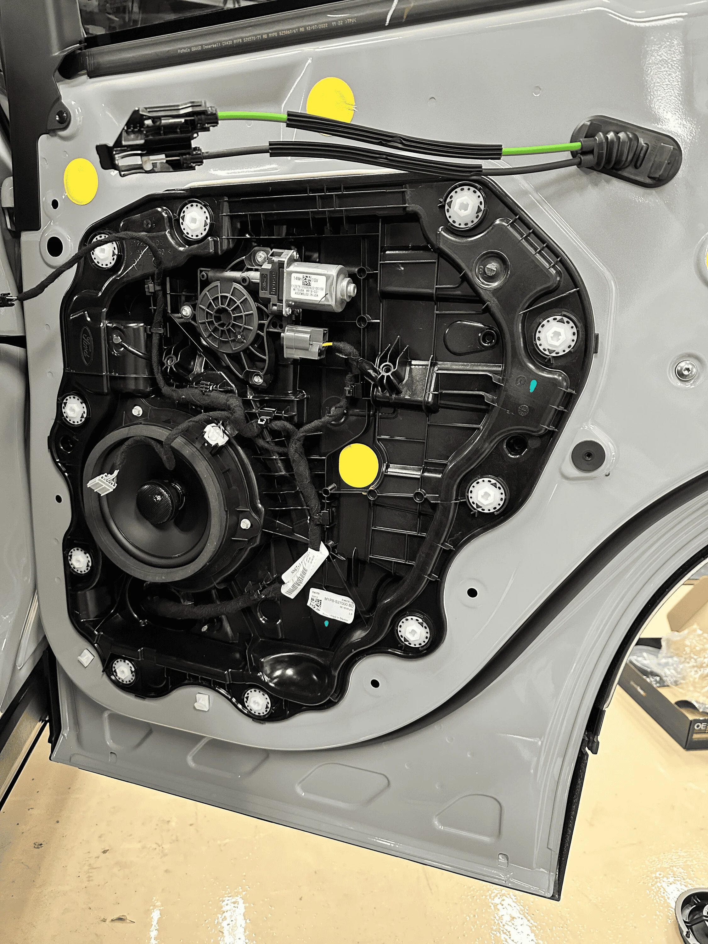

Once you take the door panel off, you still can't access the window track. Everything is behind a big plastic panel that is riveted (IIRC) to the metal door.
Edit: Not riveted, see picture.
