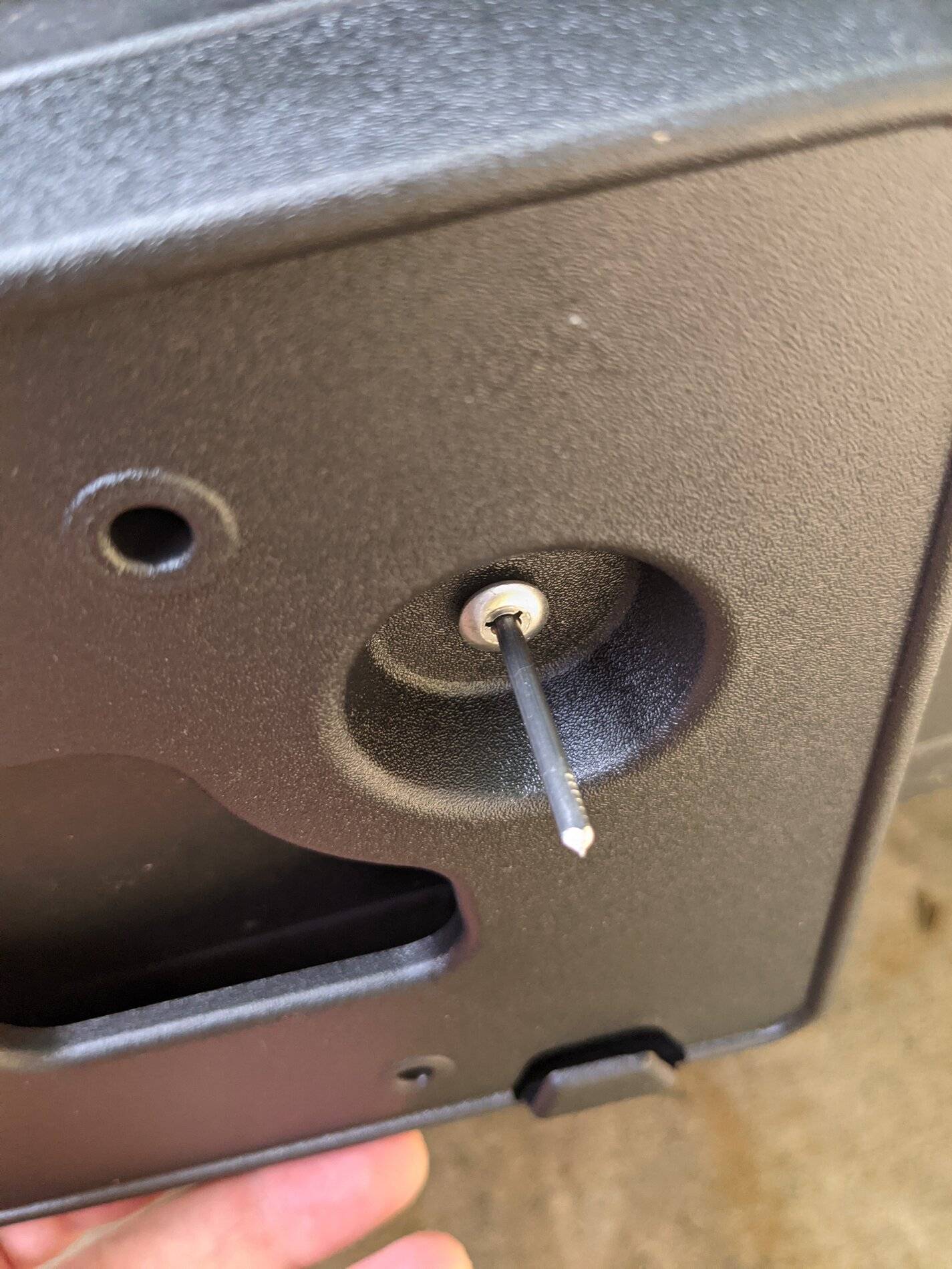

For whatever reason, my dealer didn't install the front license plate holder, even though I live in a state where they're required. They told me it was just a matter of drilling a few holes and screwing it in and I should be able to figure it out just fine. Took quite awhile to find the front license plate mount, but it was hidden underneath the spare tire.

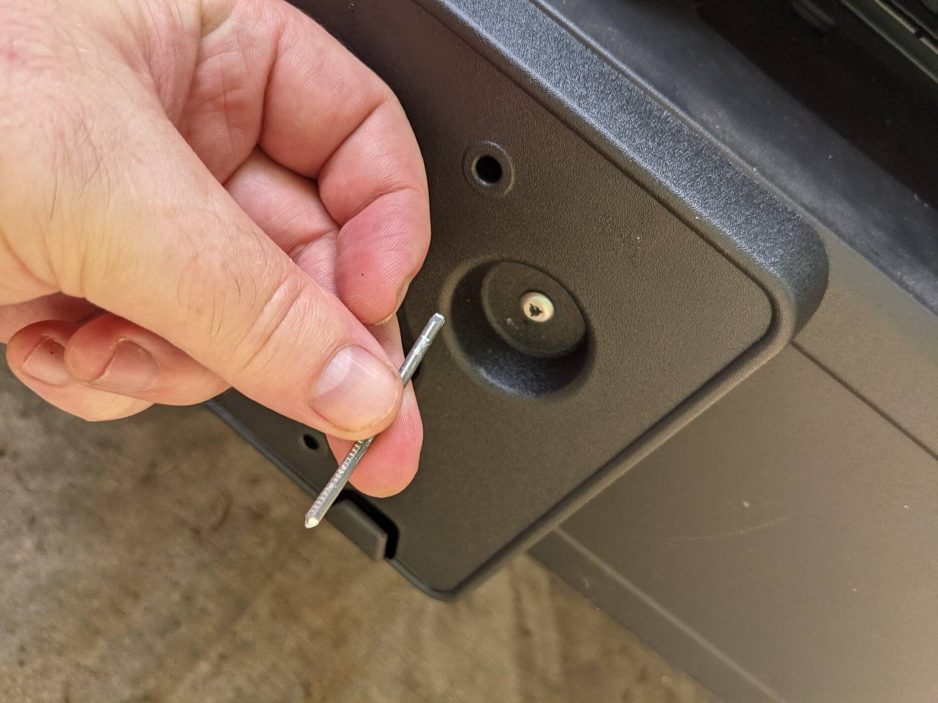

However, the only mounting hardware was these odd nail things. (Yeah, I know, stop laughing at me...) There were also no instructions of any sort and I couldn't find anything online.
Ford Bronco Sport Installing front license plate holder PXL_20210529_142246759

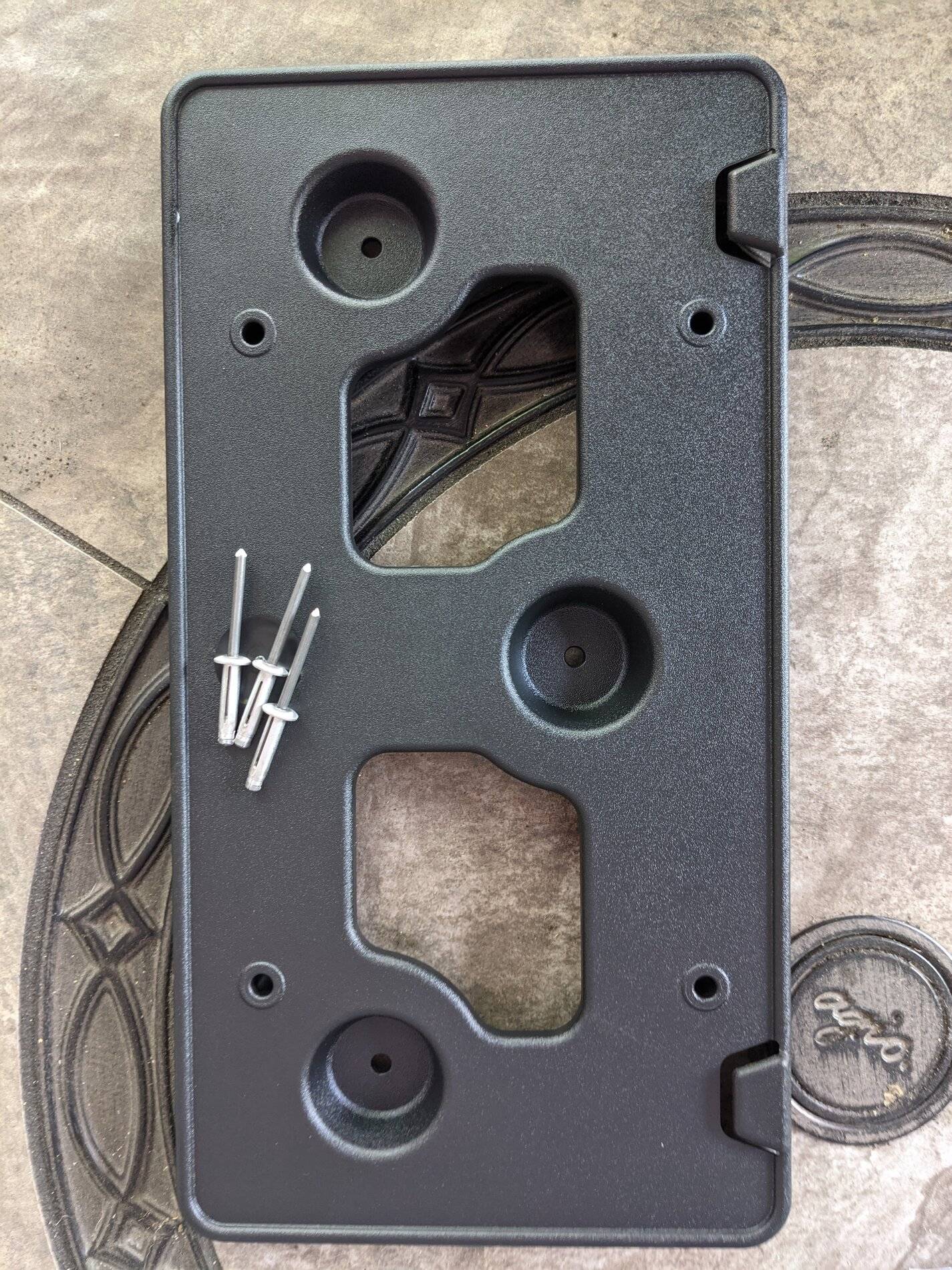

So those are pop rivets, which took me way, way longer to figure out than it should have. (Yeah, I know, I'm not the brightest...) To use them, you need a rivet gun, which thankfully are cheap-ish ($20) and easy to find.

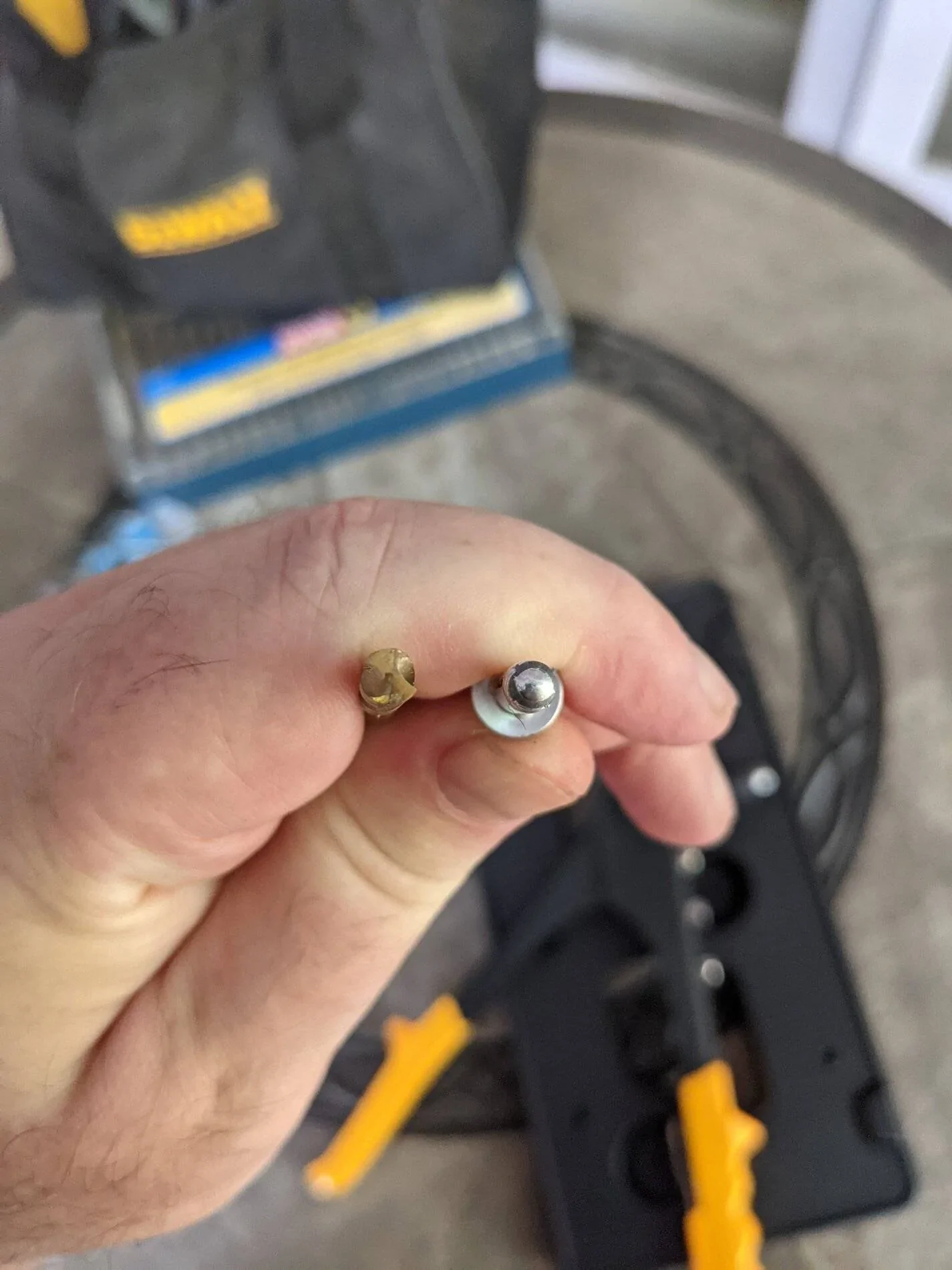

You'll need to drill three holes in the front bumper. I think I used a 3/16" bit, but eyeball the thick end of the rivet and see:
Ford Bronco Sport Installing front license plate holder PXL_20210529_142846311
The bumper is really thin where the mount goes, so be careful not to push too hard when drilling.

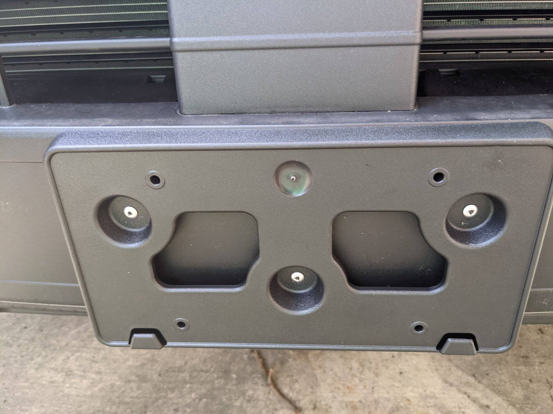

Ford Bronco Sport Installing front license plate holder PXL_20210529_143046824

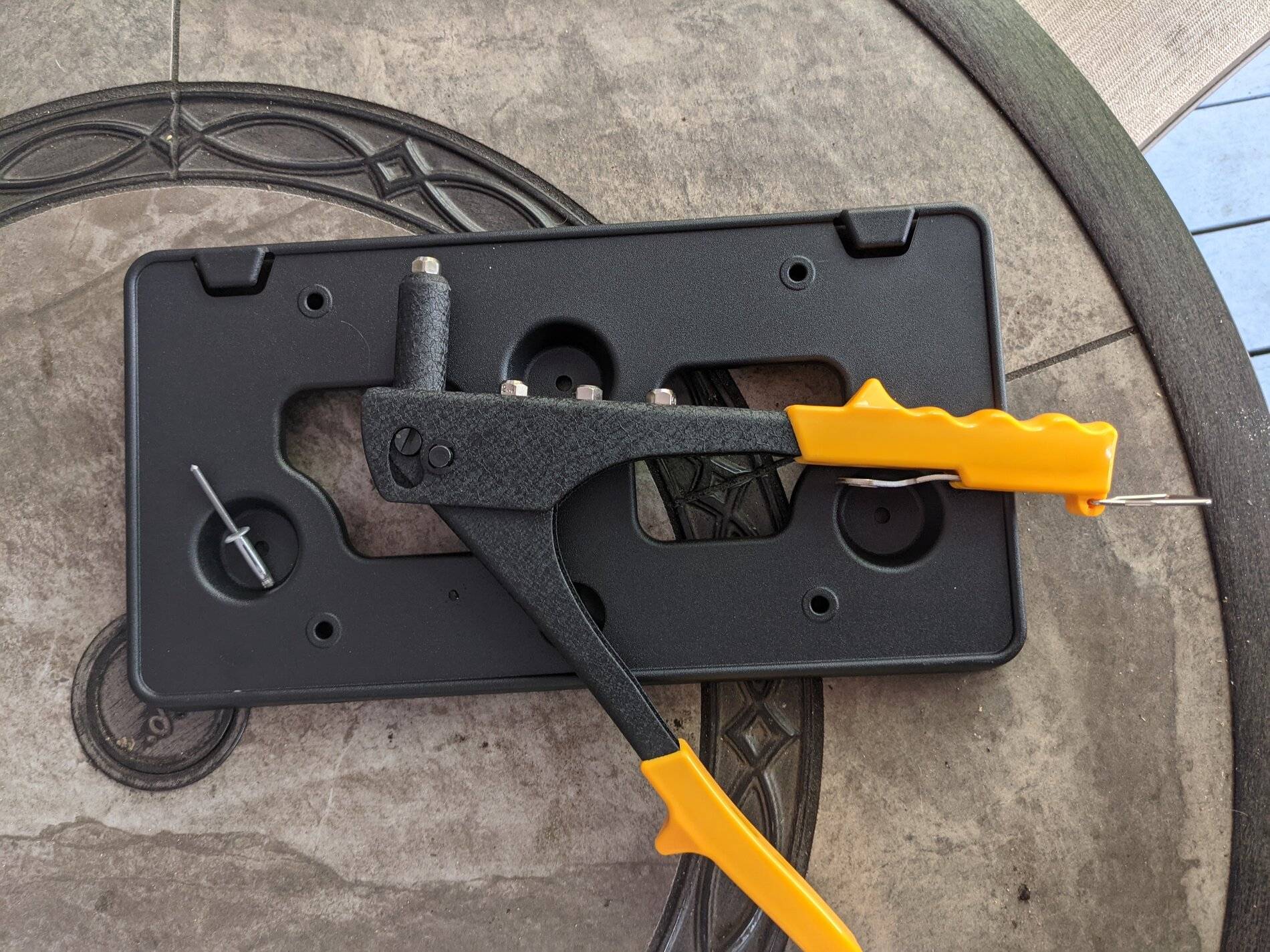

The thick end of the rivet goes in, and the nail sticks out:
Ford Bronco Sport Installing front license plate holder PXL_20210529_143255753
Put the rivet gun on the nail and pump the handle a few times until the rivet flattens and the nail pops out.
Ford Bronco Sport Installing front license plate holder PXL_20210529_143502253
Finish all three and you're good to go!
