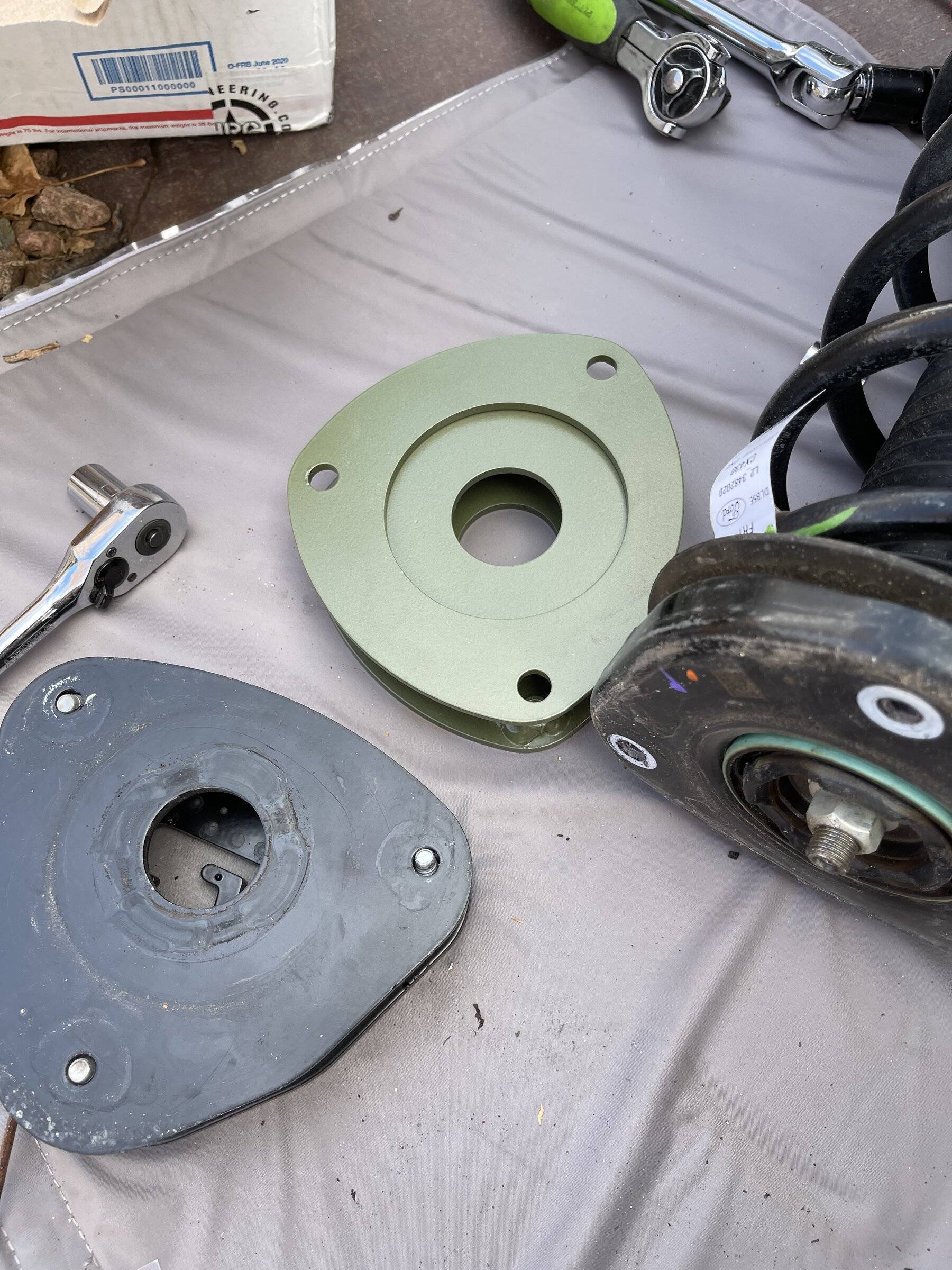

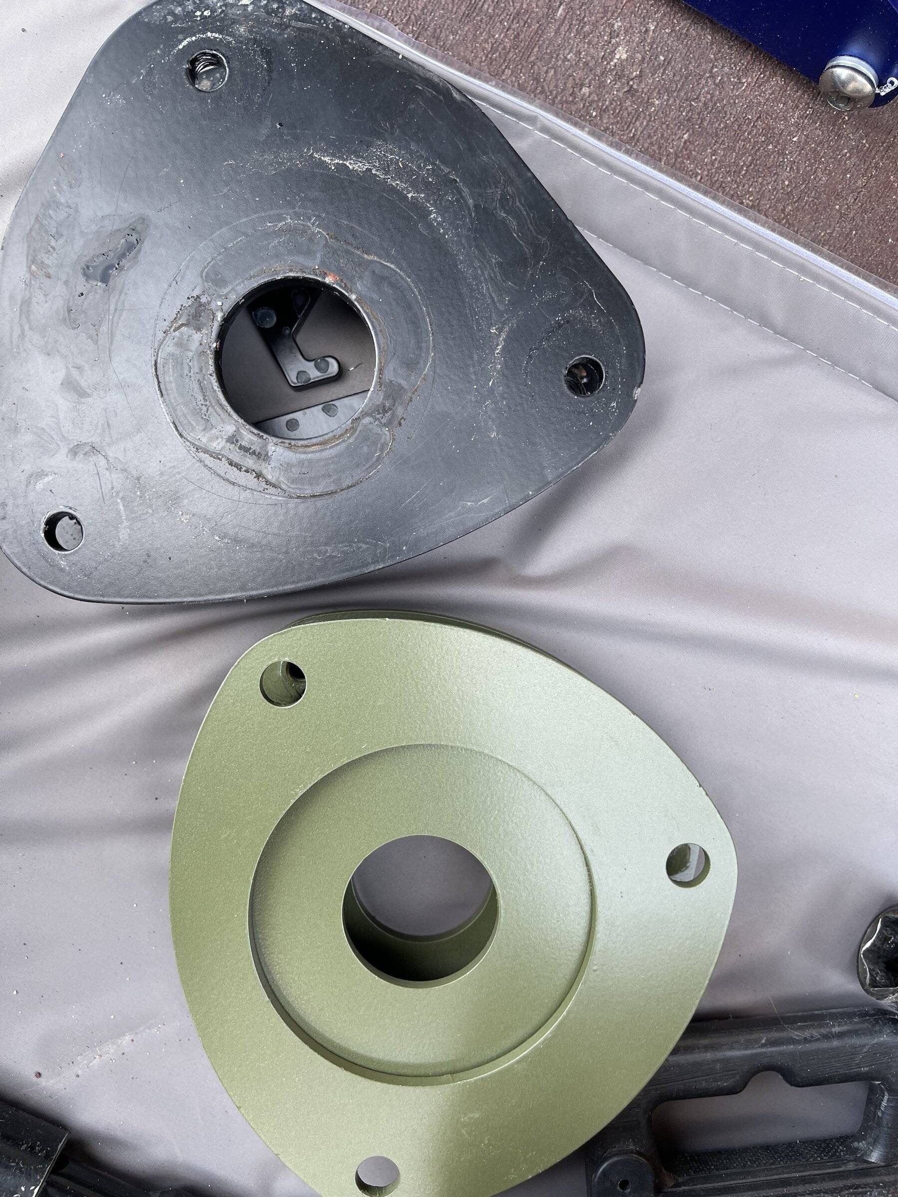

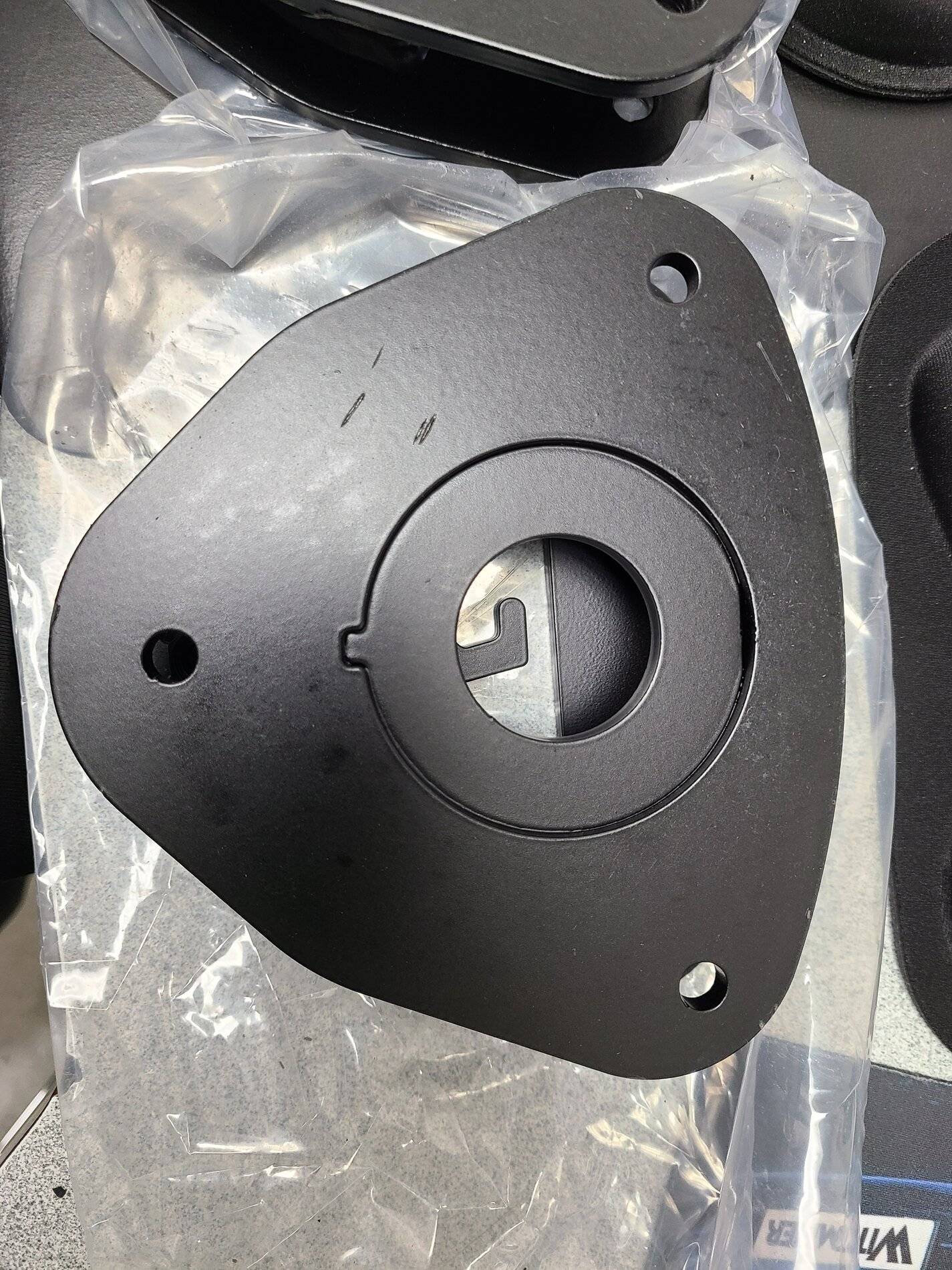

Hope it works out for you, it did not for me. I had to replace it went with hrg lift. Ready lift sent old parts which they claimed were updated for the strut rattle. They were not. Make sure to inspect parts first. The spacers need cut outs for strut hat and the sway bar link brackets were updated to sit flat in strut housing. I would recommend hrg any day over ready lift. I learned the hard way.plus hrg sends new links for sway bars not brackets that can break.also you can get camber bolts with it and it’s still 100.00 cheaper. And you will need camber bolts for proper alignment. Hope this helps you, here are a few pictures of wrong and right spacers the green ones are hrg you can see it has cut out for top of strut and the black one ready lift which does not. The rattle drove me crazy ?

Holy cow, awesome to know. I scheduled the fit a couple weeks out so I’ll see if I can see the parts beforehand. Did you buy directly from HRG?
