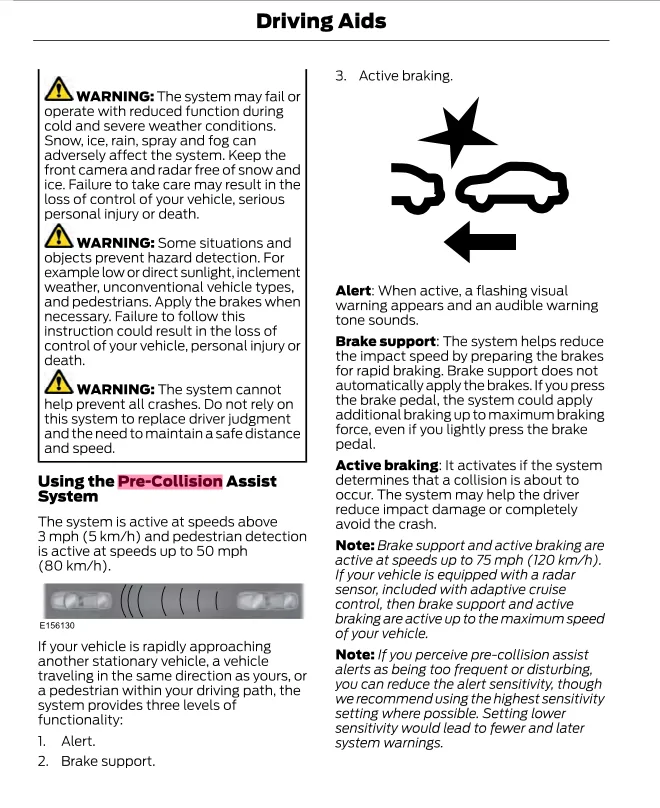

I guess someone has to be "that guy" and so I guess it's me, but, does anyone read the owner manual? Despite the manual's warnings, I also prefer a lower sensitivity setting for this. Typically the warning goes off when someone turns in front of me or encroaches from the side. I think the warning is more for a situation where the other driver does a stupid. As long as the other driver keeps going or stops there would be no collision but the system makes you look for the issue. I don't think a pedestrian has ever set off an alarm but I also don't think anyone has ever run right at my driving car.
Ford Bronco Sport Pre-Collision Alert? 1766069904015-so
