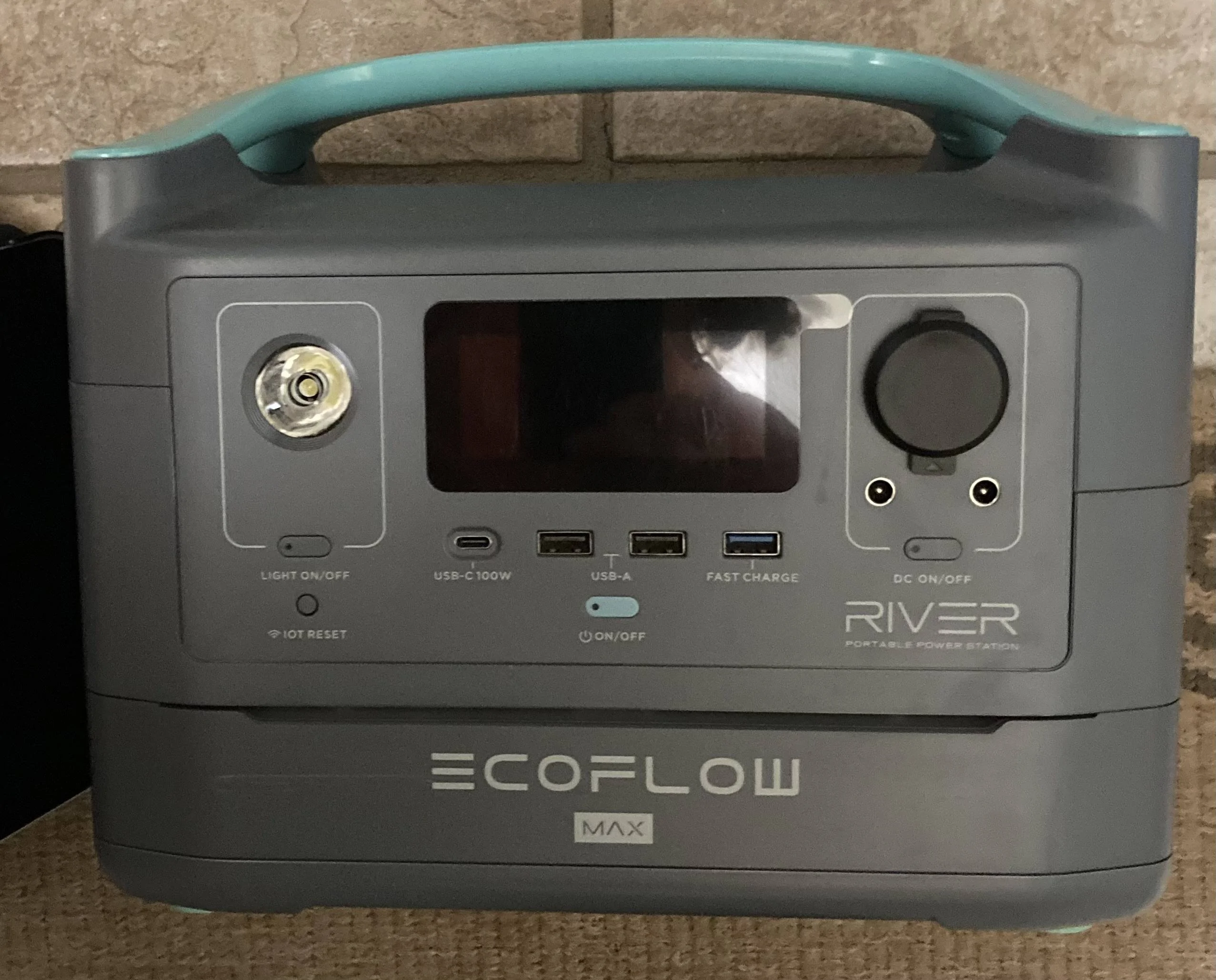

I have been using the Ecoflow River Max for just over a year and really really like it. It can run my Dometic CFX40 cooler for 3 days or so without needing a charge. My favorite thing is how quickly it charges ā€¦ I can get a full charge when plugged in for just a couple of hours. It is also easy to recharge while driving (although it takes more than 2 hrs). I paid $420 for it but have been more than happy!
Ford Bronco Sport Portable Power for camping IMG_1617
