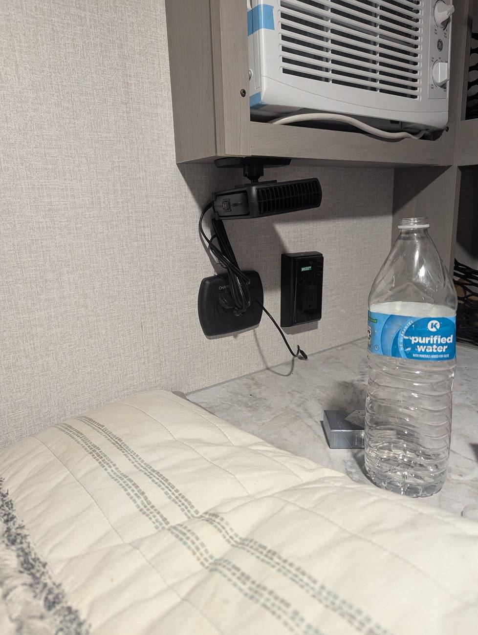

So I think The little mini heater that I bought as well as the bigger ones that I've been looking at are ceramic heaters which I think are more efficient. It says that it pulls 160 w. But yeah I left it in and running overnight and I didn't feel much of a difference but it may have brought the temperature up a few degrees. And yeah it definitely drained the batteries. That was the first time that I got a low battery warning when I woke up. So because I always have the fan running I cracked the side window and I open up the top cover like an inch and I put the fan on its lowest setting just so there's some circulation in there. I'm looking at just getting a small propane heater and since I'll always have that fan running, I feel like it should be safe enough to just do that. And that way I don't have to rush myself on trying to get an inverter and make the stock heater work without shore power or trying to buy a generator that I really don't want to buy.
Also, just so y'all know mine at least that I bought from general RV in Utah came with two AGM Marine batteries that are rated at 100 amp hours and when I was running the lights and refrigerator and fan and everything when it was warmer it didn't even get close to depleting the battery and it does come with 190 w solar. So I think for what I do it's plenty unless I add an inverter and want to be able to turn on the AC or the heater.
Also the solar just that one 190 w roof panel seems to be enough to refill the batteries in less than a day.
Also I did notice that my battery charge when I got up to Flagstaff at the end of the day even though it was plugged into my car and I had didn't have anything on it was showing the battery at like half power. Now I'm not sure that I'm reading all of the screens right, but it has a little battery icon in the corner with up to four bars and I only had two bars and from what I read online the cold weather makes batteries less effective and output less. So that seems to be the reason.
Now if anyone knows my my little solar controller screen it said that right before I went to sleep it said the battery temperature was 51° which is pretty good because outside it was like 20°. But if I were to add some kind of heating element to them if that was possible. Would that help where I could have full battery capacity even in sub freezing temperatures?

All electric resistance heat is ~100% efficient: electric baseboard; portable heaters; toasters; hair dryers; the automotive ones on Amazon with fake flames shooting out of them; "emergency" heat in heat pumps; ceramic heaters, etc.
That is, almost all of the electricity they use is converted to heat. Of course, the type of heat can vary -- convection vs radiant. If a person is generally in one location, radiant heat can be a good choice because it warms objects and bodies, not the air. So the user can be comfortable with a lower room air temp. -- like being near a fire on a chilly night.
If/when you get an inverter, that will not solve the heat problem. Inverters are <100% efficient (sometimes a lot less) and there is simply no way to use batteries to generate enough heat to keep an RV warm for any length of time. Without shore power, a person might need dozens of batteries.
The same is true for A/C. The MS2000 I installed in our RV will start and run the rooftop A/C unit, but it will not run for long on the two 105Ah/1,344Wh LFP batteries. Depending upon the ambient temp, the A/C will pull 12-13 amps at 120V, or up to 1,560 watts. With the loss through the inverter we'd be lucky to run it for 1 to 1-1/2 hours.
Two options that come to mind are propane, or a generator. Propane really is the best choice. There is a guy on one of the RV forums who likes to ski where temps can get down to zero or below. He has a factory/OE propane furnace, but it is only ~50% efficient, so he bought a catalytic heater that's about 99% efficient. That works for him, even in serious winter conditions.
It sounds like you have good ventilation, but just to be clear, the only propane heaters that can be used indoors are the 99%+ efficient ones -- sometimes called 'ventless' heaters.
Cold temps reduce the amount of current a battery can supply, but not its ability to be fully charged (100% SOC). Your 2/4 bar indication had some other cause. Perhaps it was not actually connected to your BS (the connectors can be flaky), or it was but the voltage was too low (for bulk charging it should be 14.4 to 14.6V). Also, those battery monitors in RVs are notorious for being inaccurate. If you want accuracy, you could use something like this:
https://www.victronenergy.com/battery-monitors/smart-battery-shunt
Some lithium batteries have built-in heaters, but they are not necessary for lead-acid (incl. AGM) and of course they would consume power.
