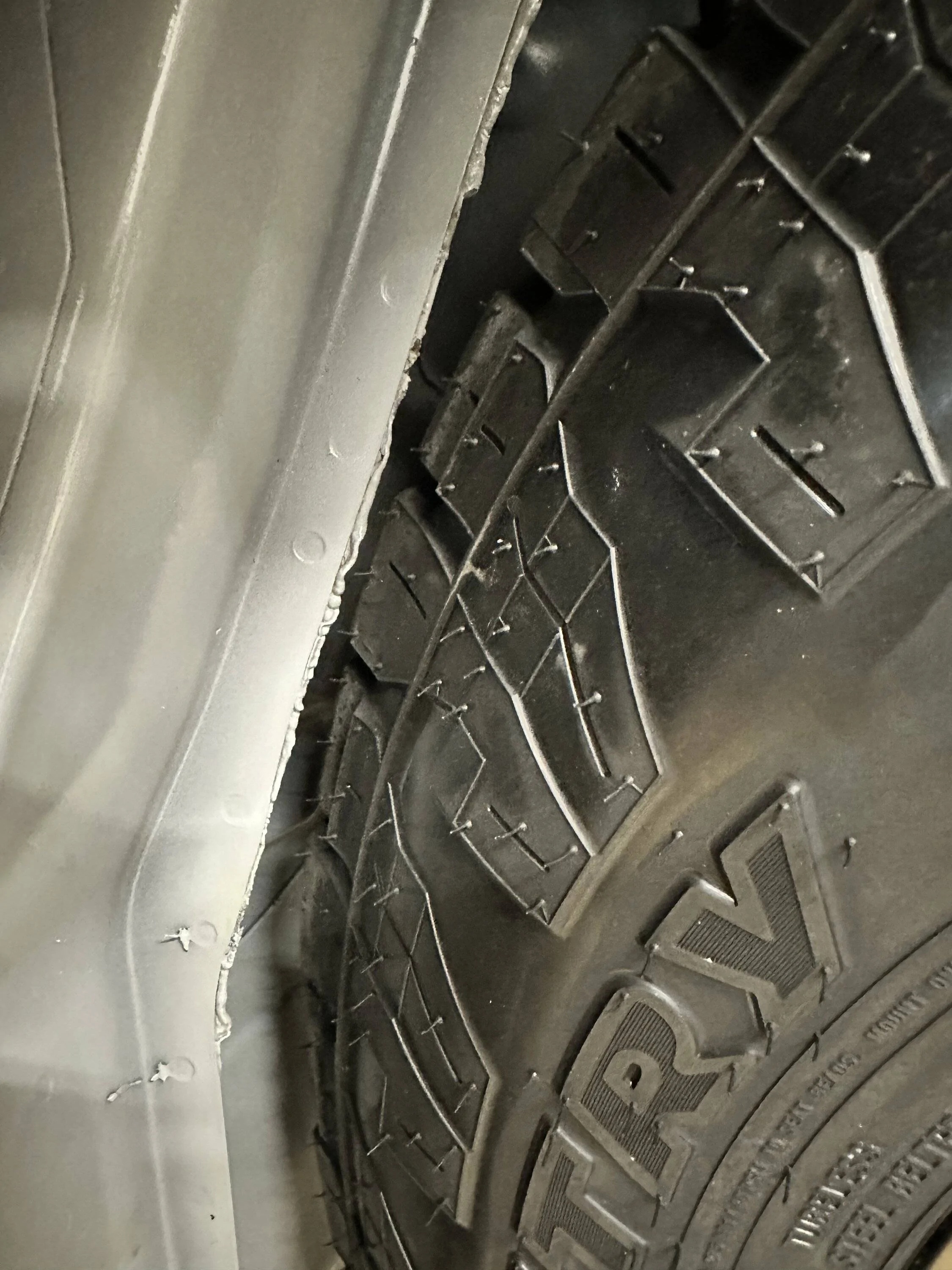

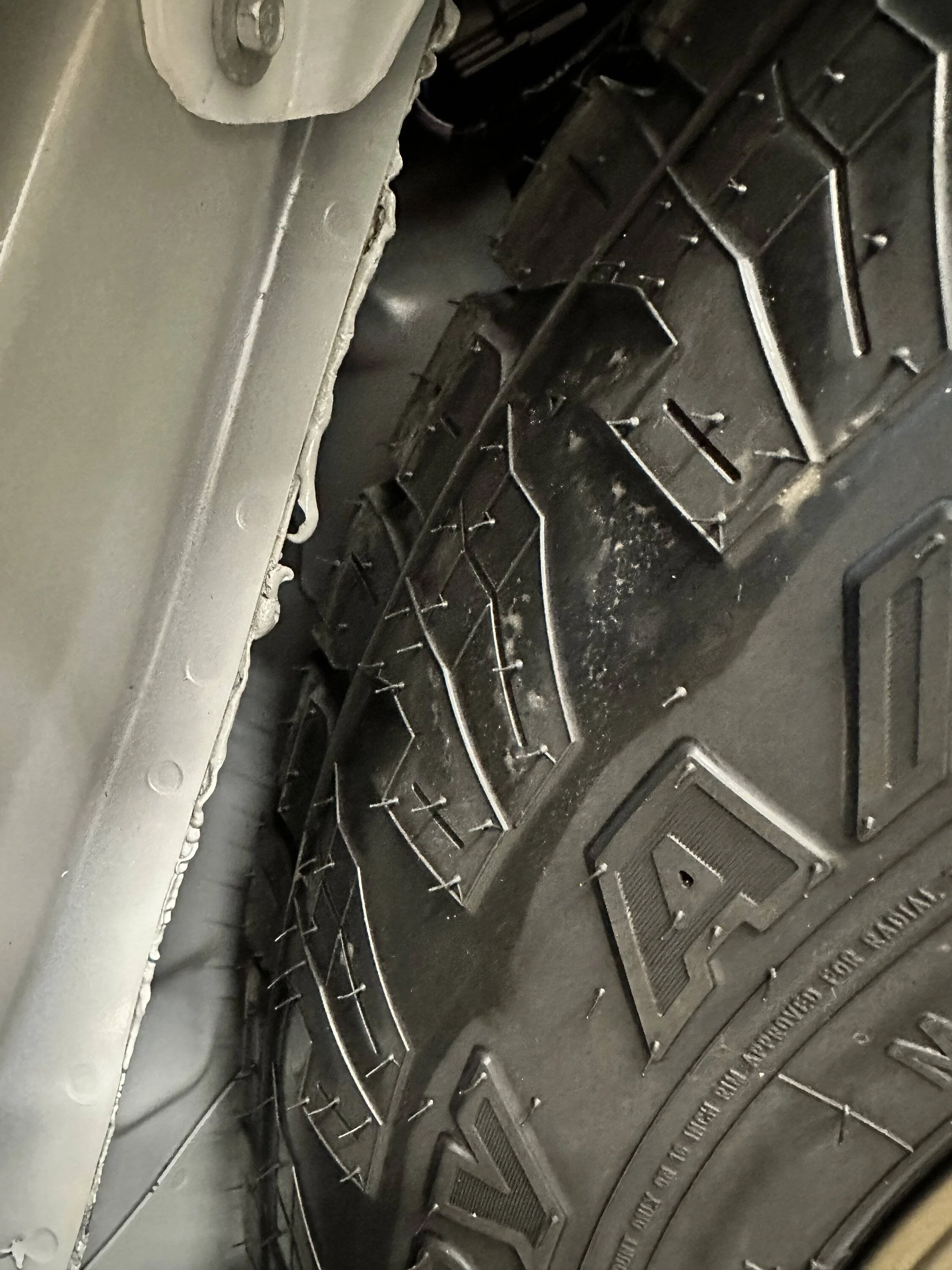

While installing my lift kit, I decided to pull the spring off the strut and look at how the tire approached the unibody. I think there is some interesting findings here.
With the steering at full lock and the suspension compressed (without the spring), you can see that there is little to no gap behind the tire. I’m predicting to contact to the liner.
Ford Bronco Sport Olive - Meanderthal’s BS BL 1667437973146
Ford Bronco Sport Olive - Meanderthal’s BS BL 1667438021508
What this tells me is that trimming the pinch weld will do nothing to prevent rub, at least not a full lock. It also tells me that a lift will help with clearance, a little bit.

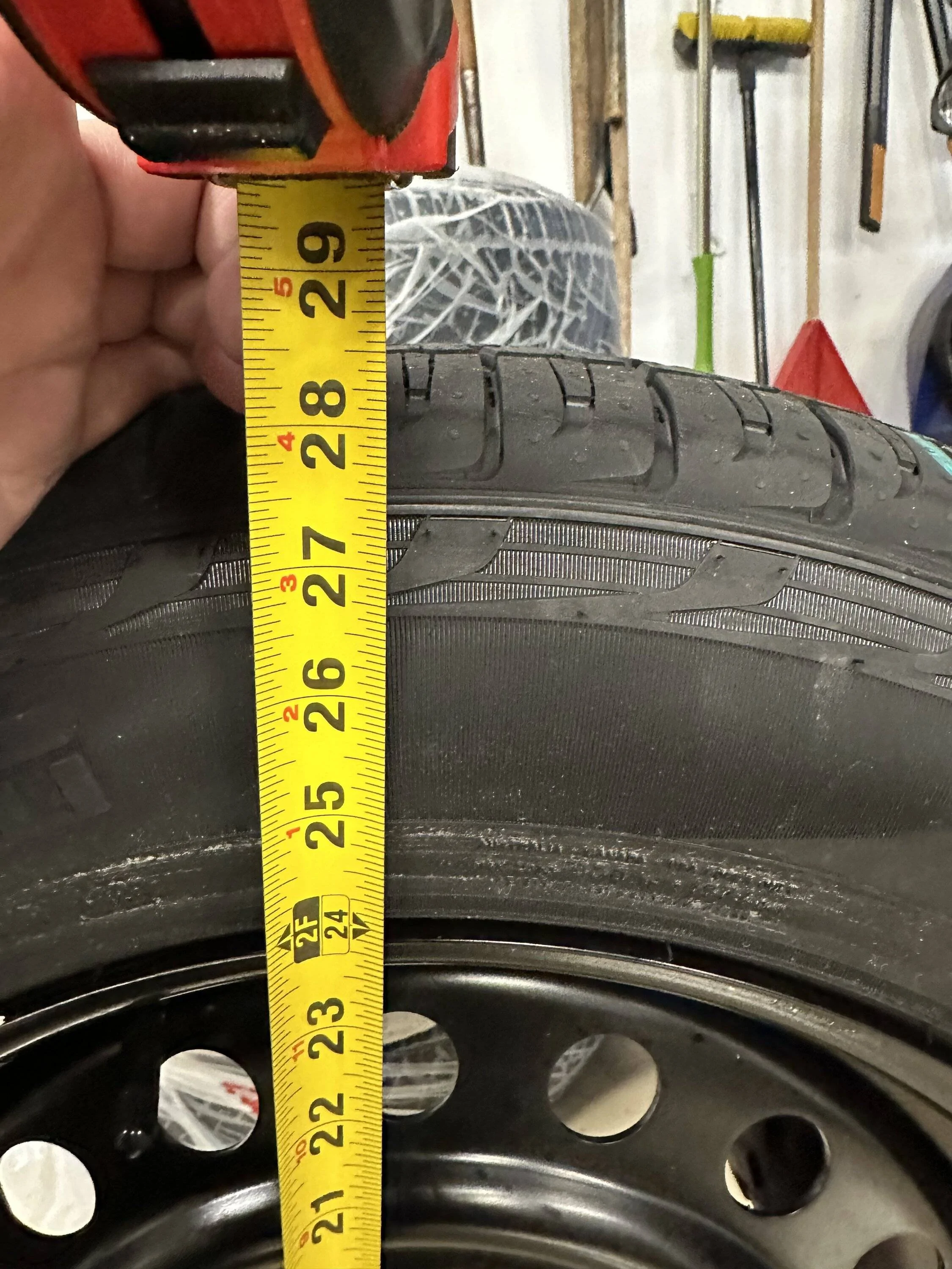

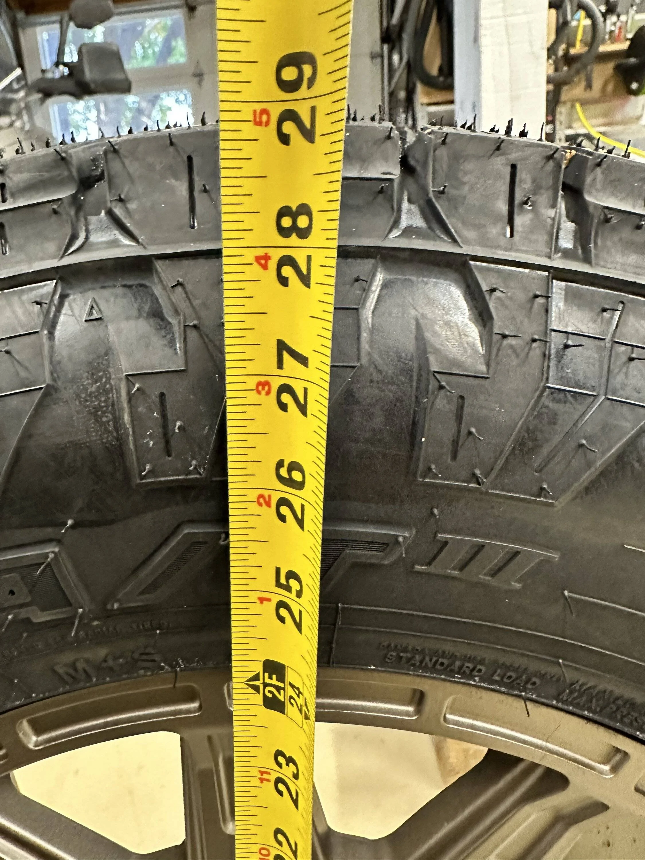

Another interesting find is that the stock tires measure at 28-1/2” diameter, which is what the specs say they should be. These Toyo Open Country A/T’s measure at 28-7/8” diameter, which is about 1/2” under what the specs would indicate.

The pinch weld can be a rub point, but it is the upper portion of the weld, not the part at the bottom. As you turn the steering wheel back to center, the tire will move away from the pinch weld.
Ford Bronco Sport Olive - Meanderthal’s BS BL 1667438180151
To give me all the clearance I could get, I trimmed that squeeze out along the pinch weld, which gives maybe 1/16 to 1/8 of more clearance. That allowed me to bias the liner to the back a little to give as much room as possible.
