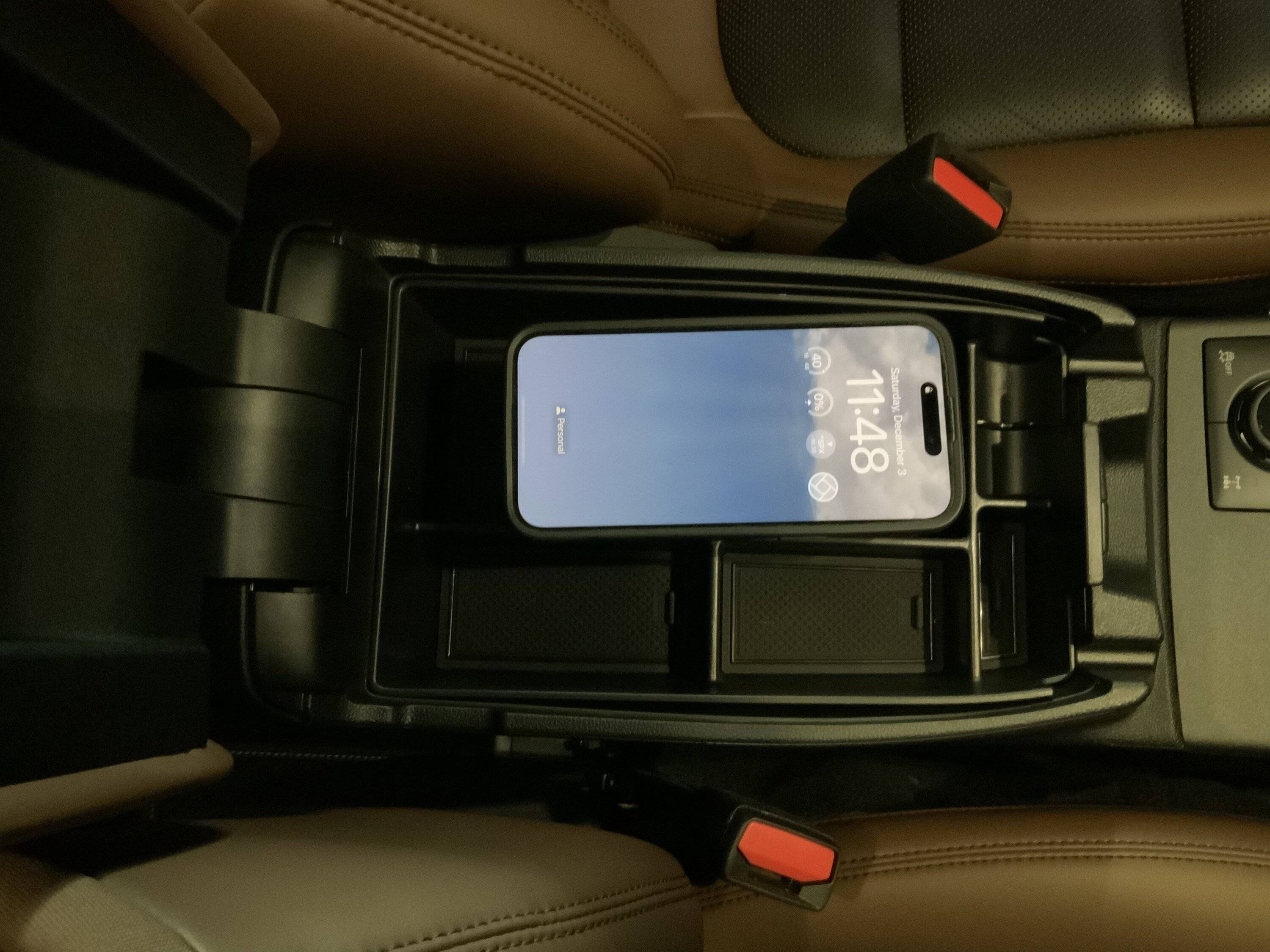

I order a Quad Lock charging mount a couple weeks back on a Black Friday deal. I already had the case with the magnets, so it made sense to get a charger for the BS. The built-in QI charger seems to be hit/miss for actually getting a charge, especially with anything but the thinnest of phone cases.
I’m not a fan of having the phone hanging around on the dash, or in this case from a vent. So, I came up with a different place to keep it, the console. I ordered one of the console trays months ago.

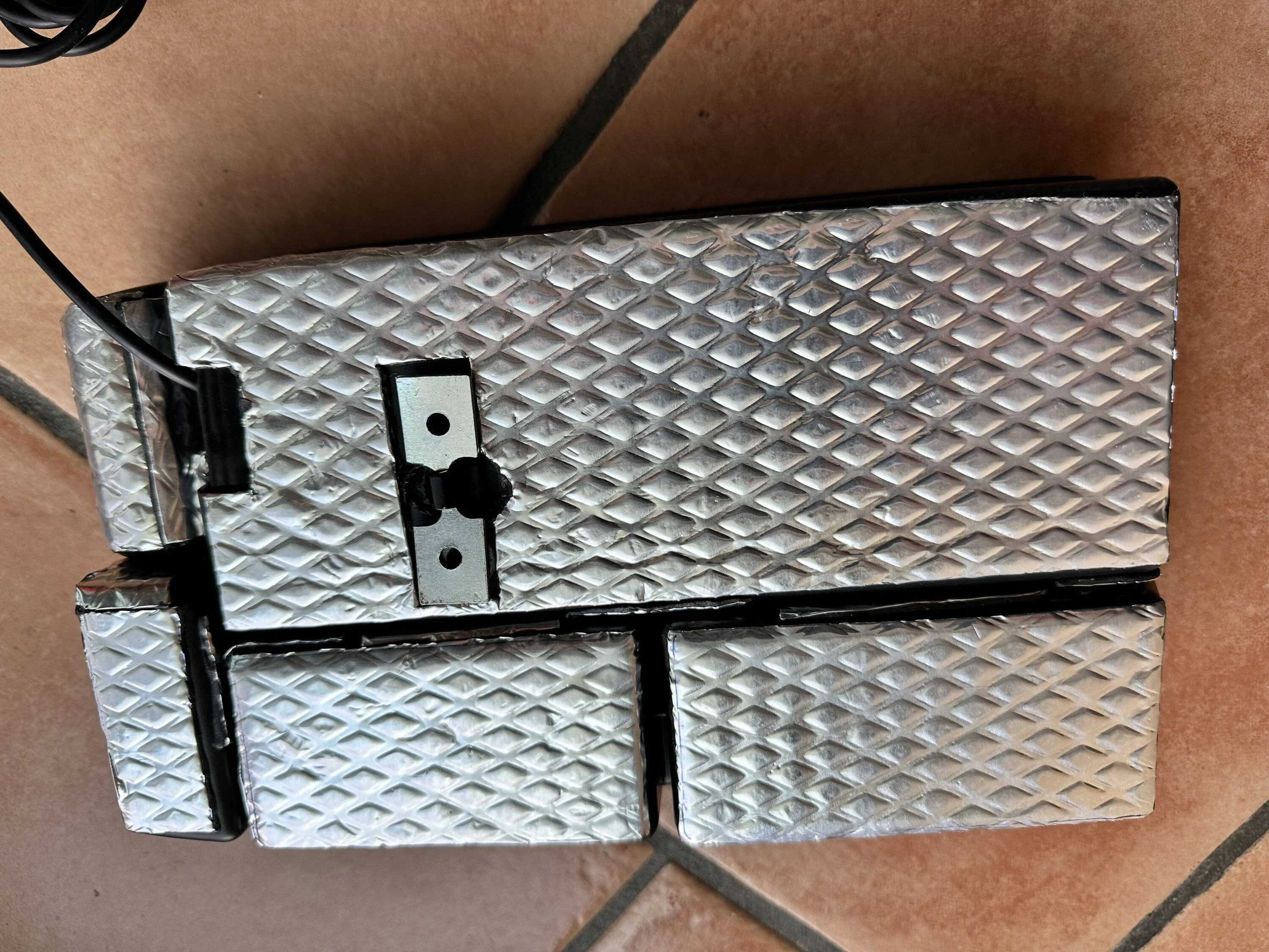

I started by applying some knock-off dynamatt to the underside of the tray to deaden any sounds of items I might put in the tray. The tray comes with some rubber pieces that lay in the bottom of the sections, but I wanted something more.
Ford Bronco Sport Olive - Meanderthal’s BS BL 430FAE42-1826-4B07-82B8-1780D49063C8

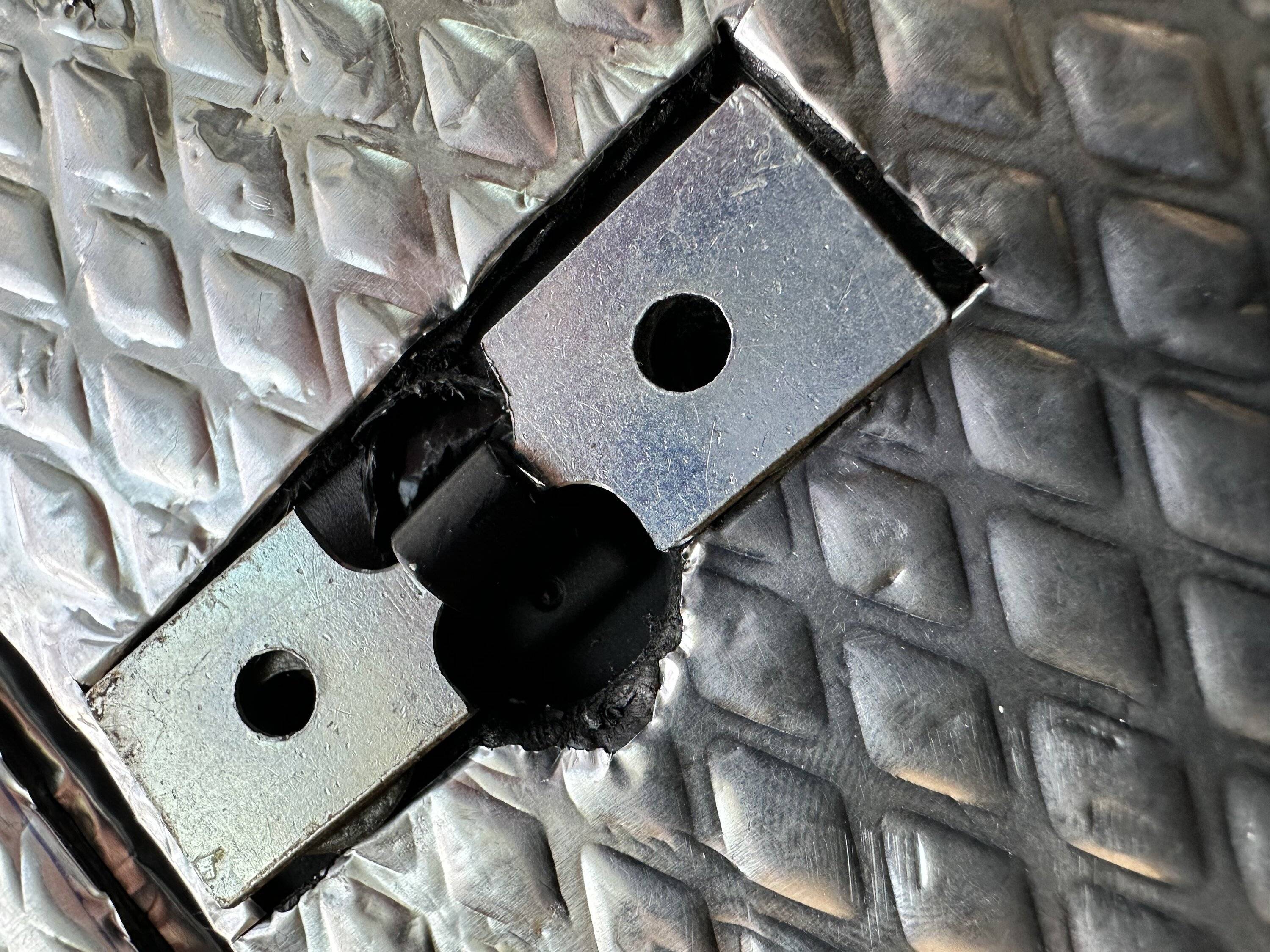

In that picture above you can also see how the mount is attached. I had a little metal plate in my garage collection, which I cut into a “dog bone” shape using the Dremel. That allowed the little hook on the Quad Lock vent mount to reach through and grab it. Obviously I had to drill a pretty big hole in the bottom of the tray (a step drill works well here) and cut a similar hole in the rubber pad for that section of the tray. Here is a close up of the dog bone piece and the hook from the vent mount.
Ford Bronco Sport Olive - Meanderthal’s BS BL 0A6C25EE-3128-42BE-BECC-AD4BA0933B0C
I had to put a couple washers under the dog bone to get enough height for the hook to tighten everything in place. I glued those washers and the dog bone in place.
Once installed it gives a very nice “out of the way” spot for my phone to be when I’m driving. The only issue is remembering to grab the phone when I get out.
Ford Bronco Sport Olive - Meanderthal’s BS BL F222DF07-6299-4D43-834C-ED94C362765B
Ford Bronco Sport Olive - Meanderthal’s BS BL F4654D9B-80A7-4F97-917F-535B9B26F3C7
I have a wireless Carplay adapter to play music and get directions (when needed). The phone stays pretty well charged with my 30 minute (each way) commute. Now what else will end up in this console tray?

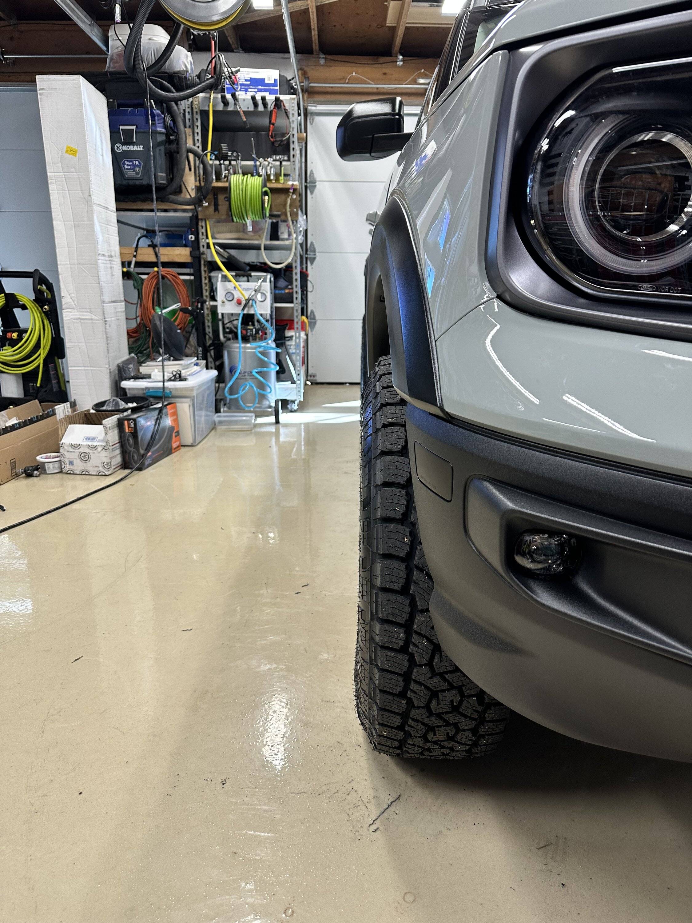

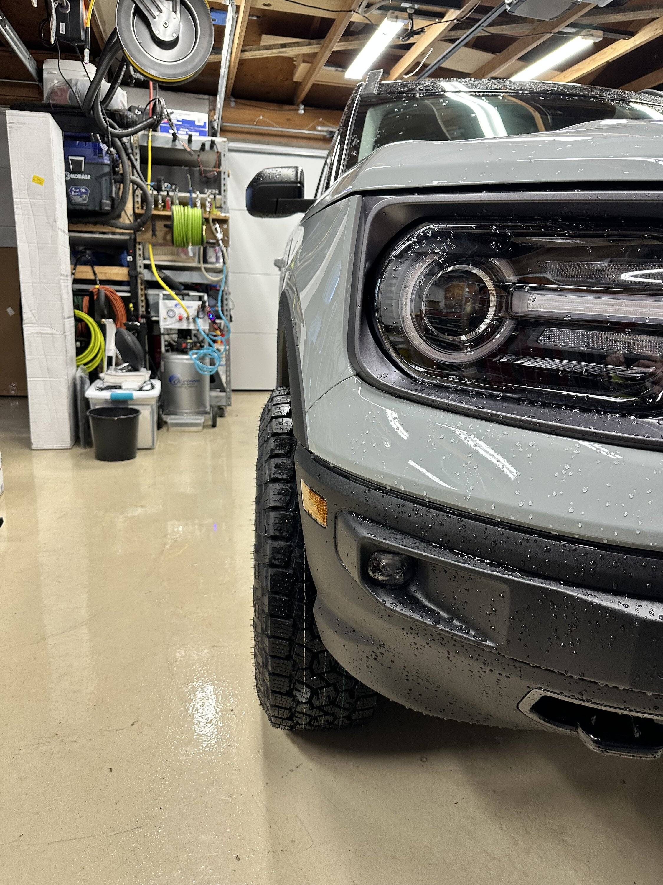

I really wanted to have a more aggressive stance. I didn’t want the tires to stick out but I don’t like the “fake bolt” fender flares. Luckily Air Design has nice clean fender flare set. This flare set looks very “stock”, which I like.
The 245 tire on a 30mm offset wheel sticks out just a little. When a 1” spacer is added, the tire really sticks out. Maybe something that some others would like. Adding the fender flares, brings it back to about flush. To me, this is perfect.
The decrease in wheel offset from 38mm to 30mm moves the outside surface of the tire out by 8mm (about 5/16”).
The increase in tire width from 225mm to 245mm means another 10mm (about 3/8”) of the tire pushing out, and also the same amount pushing in.
Stock
Ford Bronco Sport Olive - Meanderthal’s BS BL 1667438311049
245/70/16 30mm offset (stock offset is 38mm)
Ford Bronco Sport Olive - Meanderthal’s BS BL 1667438365391
245/70/16 30mm offset with 1” spacer
Ford Bronco Sport Olive - Meanderthal’s BS BL 1667438402215
245/70/16 30mm offset with 1” spacer and Air Design fender flares
