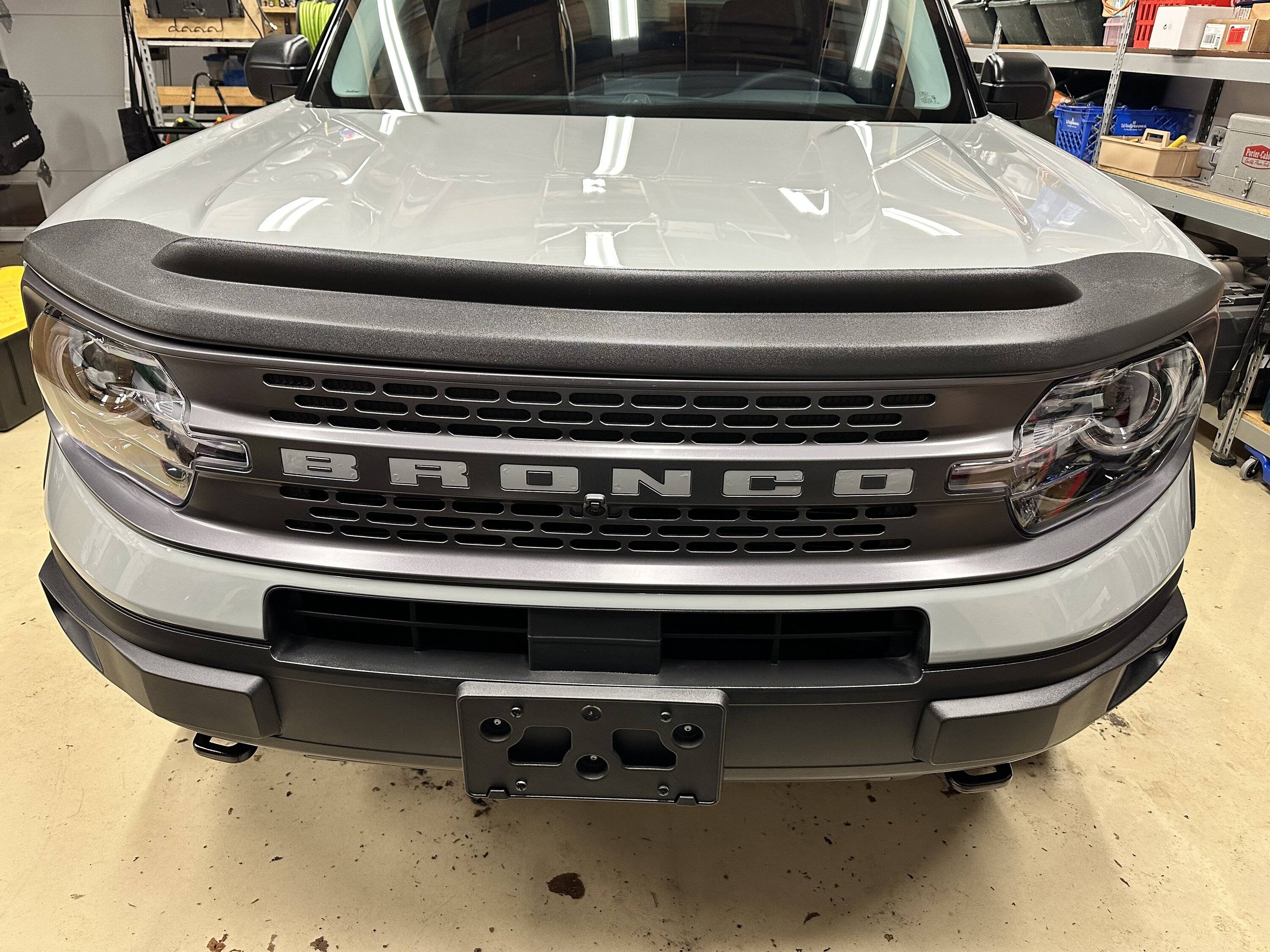

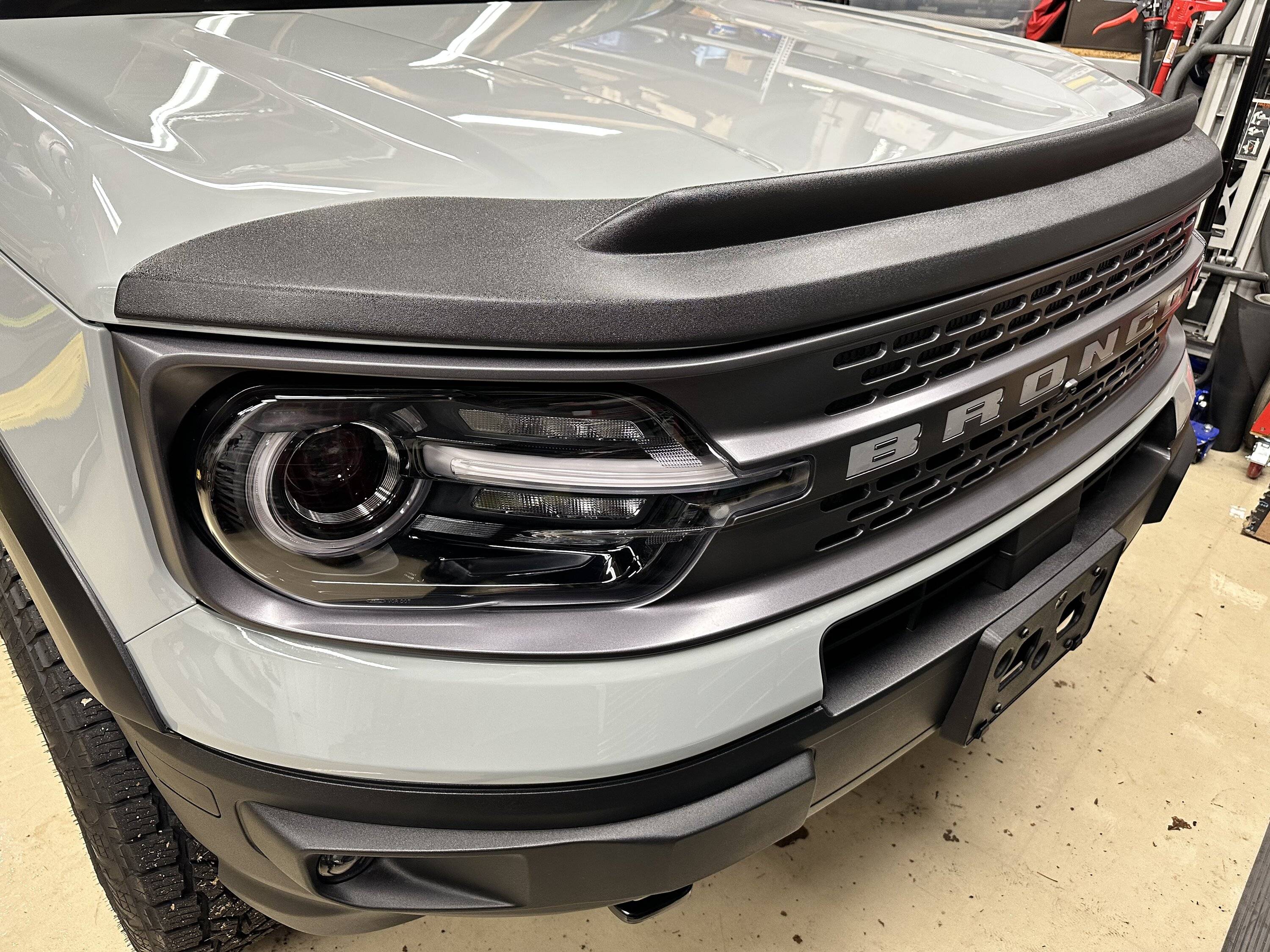

Hood Deflector
Nothing really new here, as many others have already done this. But a couple of learnings for anyone that might be planning to do it.
Ford Bronco Sport Olive - Meanderthal’s BS BL B31BD18C-F374-4A0A-A8C3-329A85415C07
Ford Bronco Sport Olive - Meanderthal’s BS BL 680A311A-1A91-4468-933E-2B9B30C362D8
  1. Aligning is the hard part and I didn’t get it 100% right. You can see in the second photo that it is a little higher on the left side of the picture. I think I got it positioned left/right pretty well though. To position it left/right, put tape on the hood at either end until you have it centered (within reason). Once you have that, then place a piece of tape near the center that goes from the hood to the deflector and then cut the tape along the edge of the deflector. I just used my fingernail to cut through masking tape. This is how you are going to easily find the center when the tape is exposed and you start at the center.
  2. The instructions say to pull the tape liner on the back side. That is what I did, but I don’t think that is the right way. I think you should start along the front edge of the hood. That will allow you to align the bottom edge of the deflector with the bottom edge of the hood.
  3. When you partially peel the tape lining, use a little bit of masking tape to hold the tape lining to the top side of the deflector. If you don’t do this those little buggers can easily get behind the deflector and you will have a really hard time getting at them. It didn’t happen to me because I learned this trick elsewhere. Just heed this warning and do it.
  4. Lastly just a plug to use CeraKote Trim Coating on this piece of black plastic and all the other pieces of black trim (so many of them!). I don’t have any connection to the company, I just like the product.
I think that covers it. If you are attempting this, good luck. I did it by myself but I would recommend a second set of hands if you have them available.

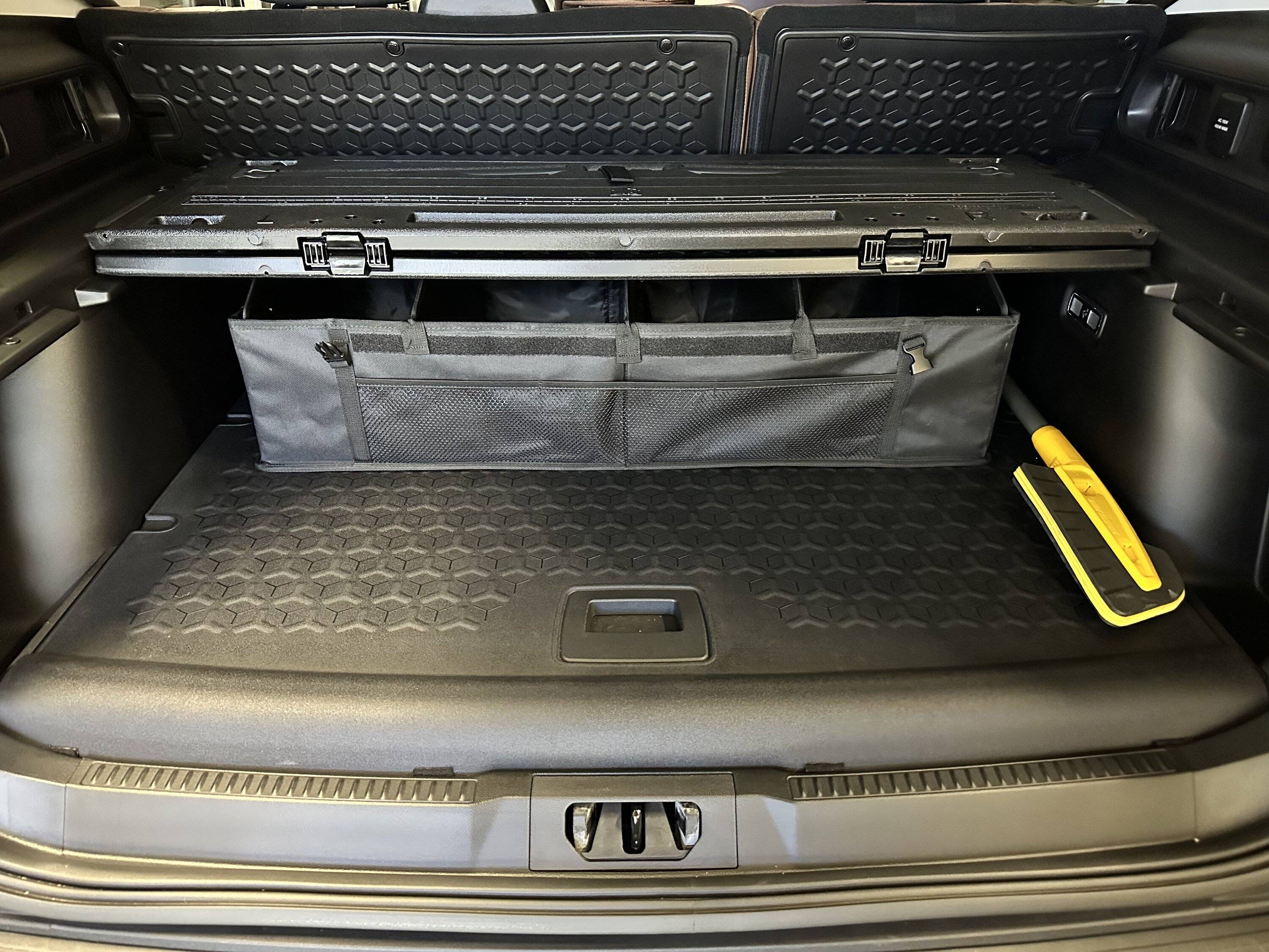

Trunk Organizer
It’s not particularly easy to find an organizer that will work with the cargo management system but I found one that does. Amazon Link. You might even be able to use 2 of them if that was your thing.
Ford Bronco Sport Olive - Meanderthal’s BS BL 4DB61BE9-C39C-4ED3-A071-1830A0B3109B
You can fold it up to be pretty compact if needed and it slides under the shelf as shown above. It can also sit on top of the shelf if needed. This one happens to be a Cyber Monday deal right now.

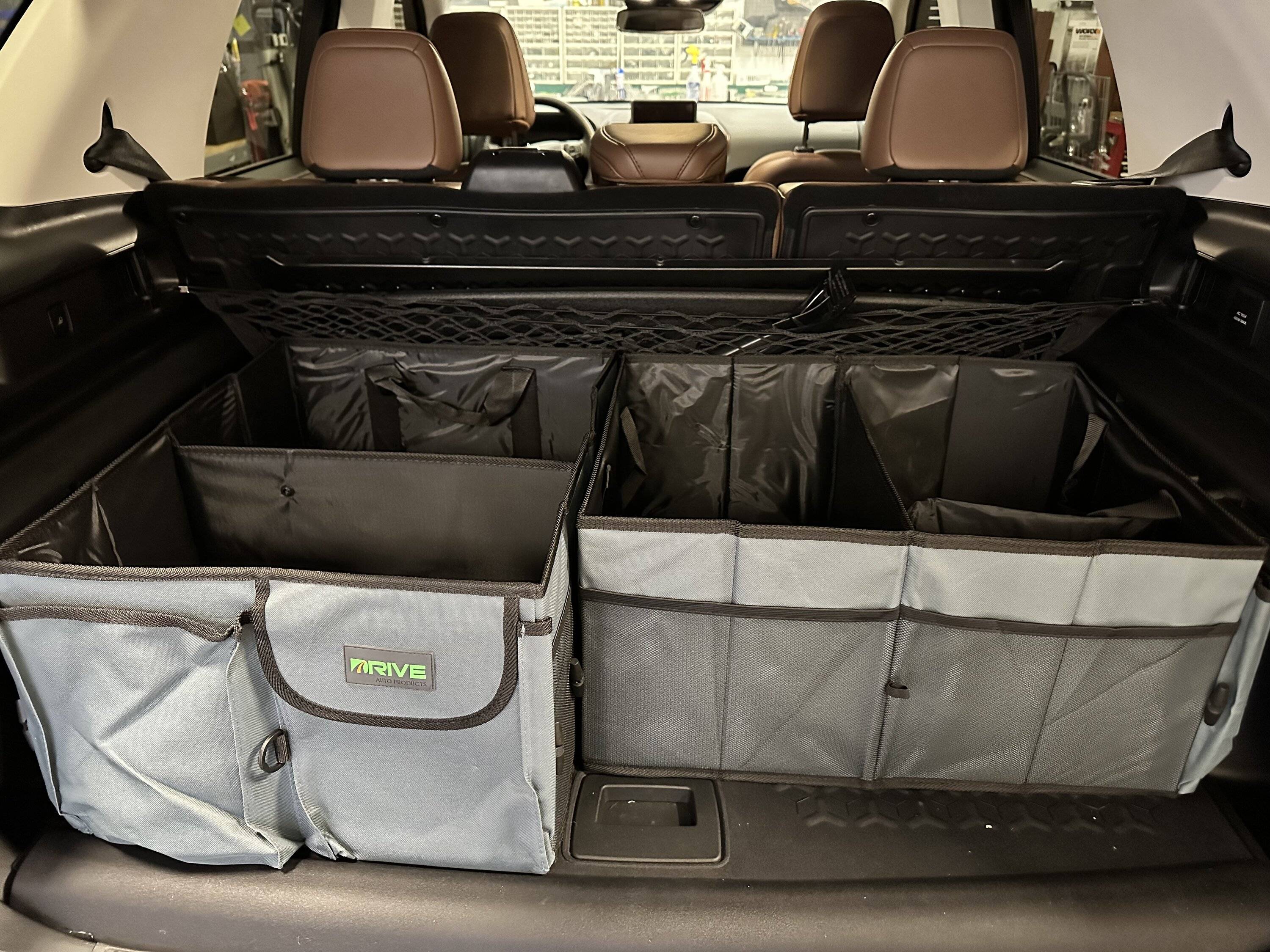

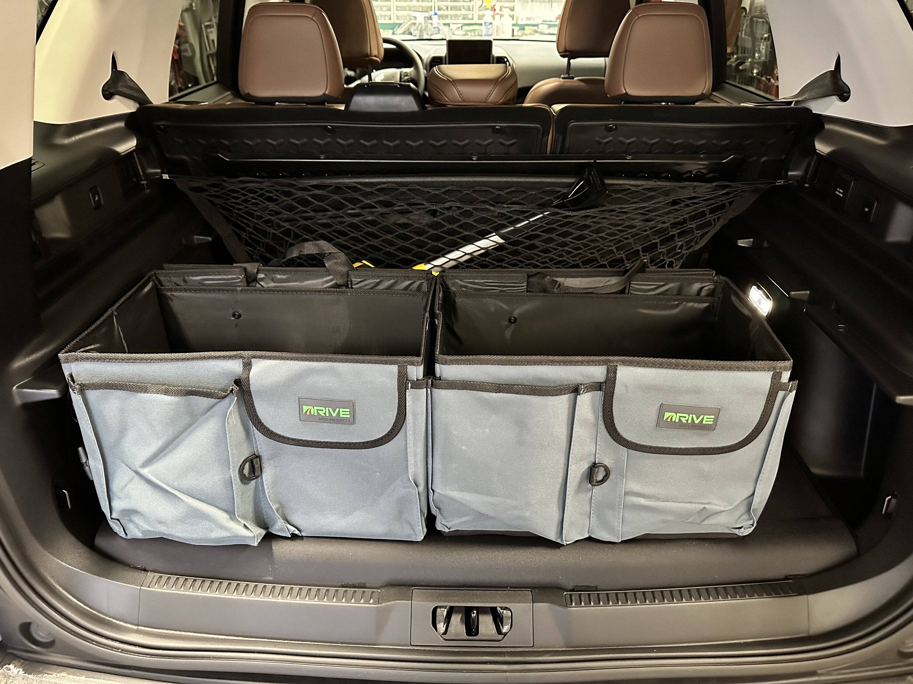

That one works great for the ability to work with the cargo management system. Recently, Colorado decided that too many people were throwing their grocery bags away and started charging everyone $.10/bag at the grocery store. It’s a PITA but I understand why they did it. So I started looking for something that could serve that function for me. I found what I think is a really great option for the BS, although not compatible with having the shelf over them.
Ford Bronco Sport Olive - Meanderthal’s BS BL 1675124216888
Ford Bronco Sport Olive - Meanderthal’s BS BL 1675124407891
The do collapse down somewhat flat, although still about 1.5” thick. There is a solid bottom part that can be used in the 1/2 open config or the full open config and still allows for the full collapse. A lot of little pockets if you need that sort of thing. There is an interior divider too, which you can just barely see in the one on the right in the picture above. They have handles which will make getting the groceries from the cart and into the BS easy. I think that they will fit into a grocery cart but I will find that out soon. In the position above, they will not move around while driving (normally). They claim to have a non-skid bottom but I have to call horse puckey on that. They do come with straps that could be used to hold them to one side or the other but with 2 of them there is no need for that.
I’m really impressed with the over quality of these. If you are looking for something similar I would recommend them for sure. I don’t get paid anything for this recommendation.

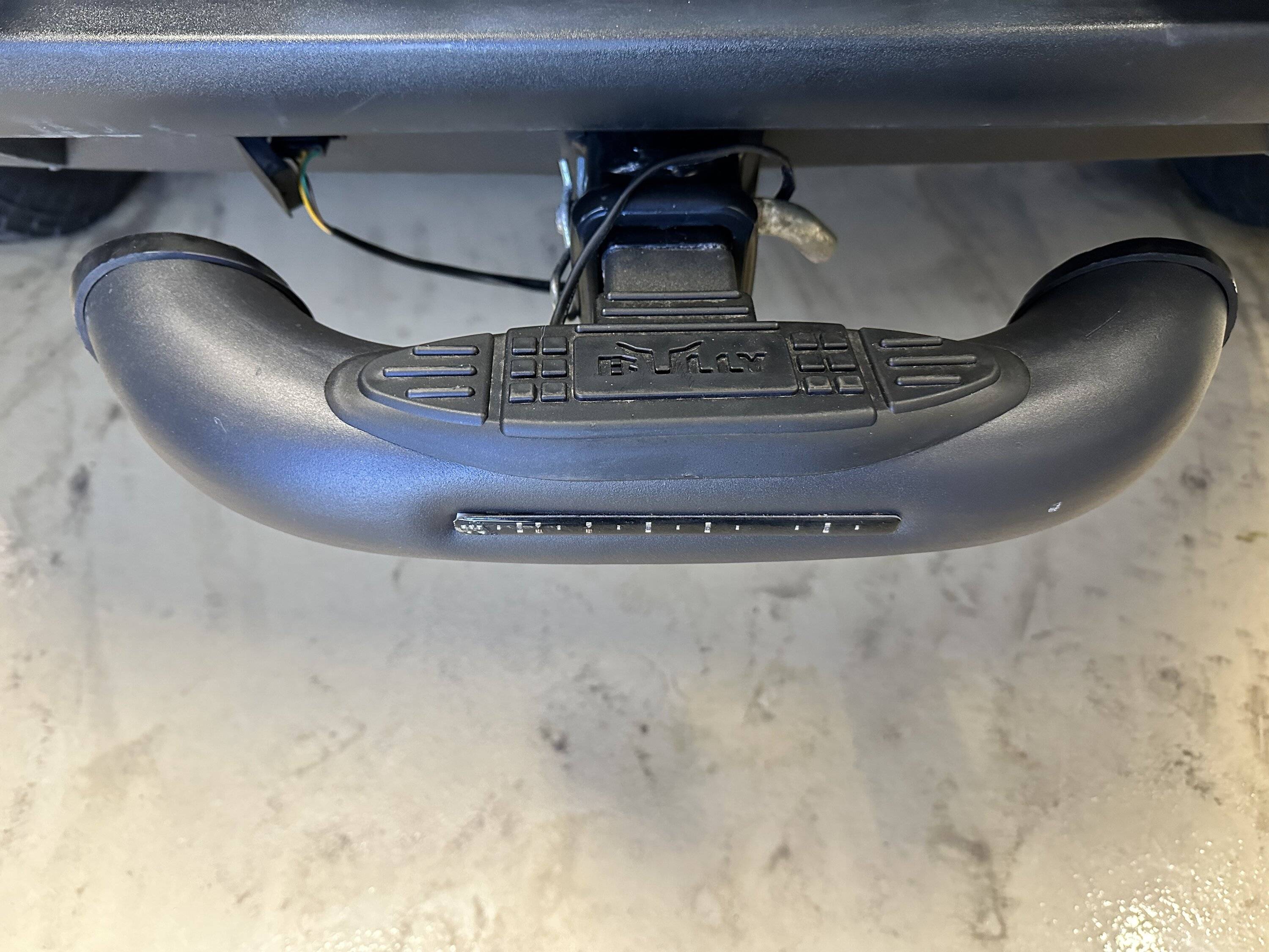

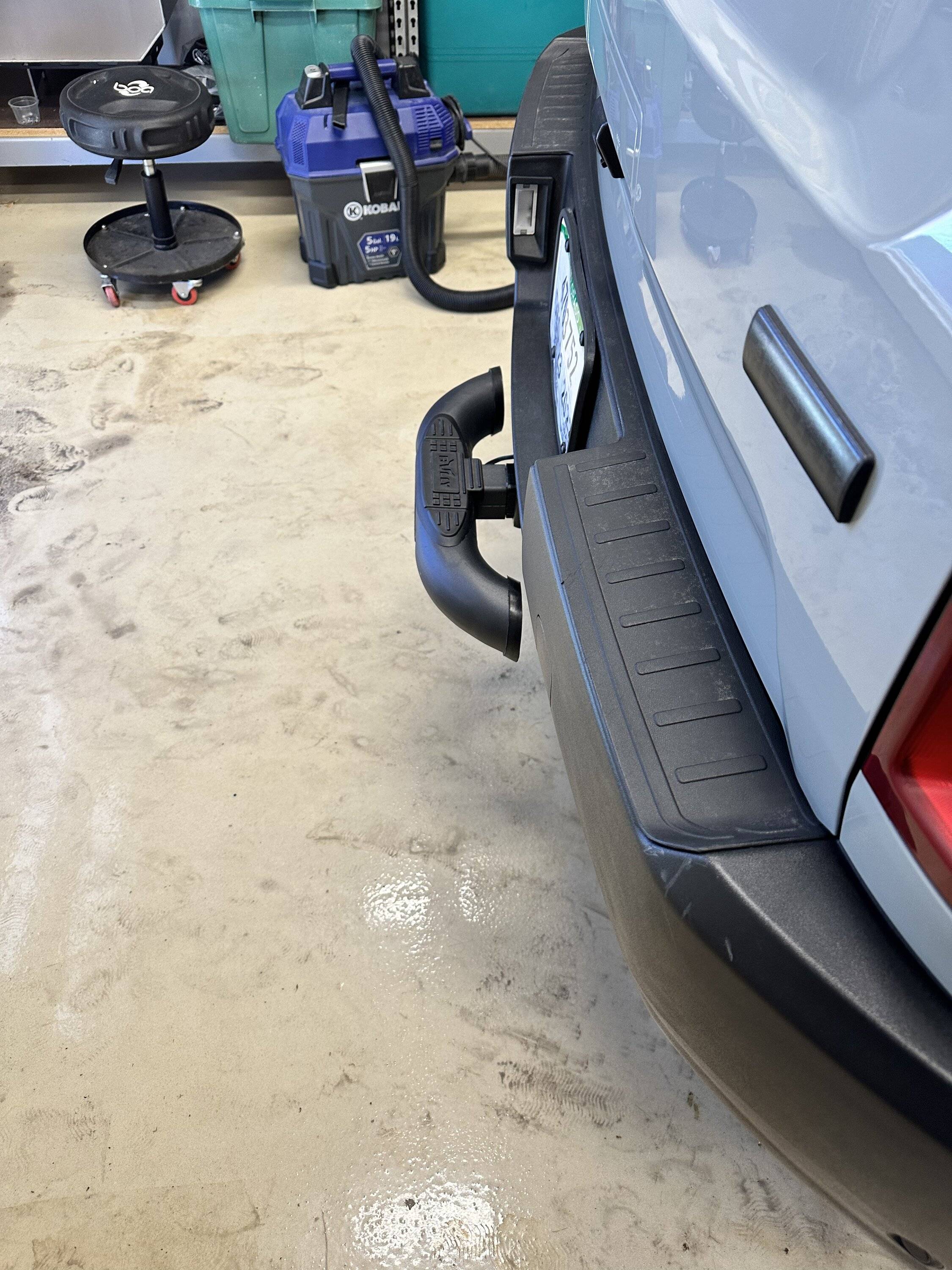

Bump Step
I ordered the step without the built in brake light but they sent the one with the brake light. Not sure if I want that plugged in all the time. I like this one because it is all metal and the curved sides will hurt a little less if I bump into it. Bully BBS-1104L
Just want to add that if you buy this bump step, do not get one with the lights. The BS is not happy with these lights and error codes are thrown every time you step on the brakes or use the turn signals. It’s a little cheaper without lights anyway.

Link not working. Can you re-post it?
2,164
3,155
Belleville, IL
I updated the link above but I am also posting it here. Maybe one or the other will work.
Trunk Organizer for SUV Car, Truck, Auto, Minivan - 4 Adjustable Compartments Foldable Portable Trunk Organizer, Heavy Duty Durable Car Organizer, Removable Flexible Cargo Storage Bag https://a.co/d/2Ii2jjX

What is the height measurement under the shelf? I am interested in organizers but thinking of a couple of cubes as opposed to one long one.
