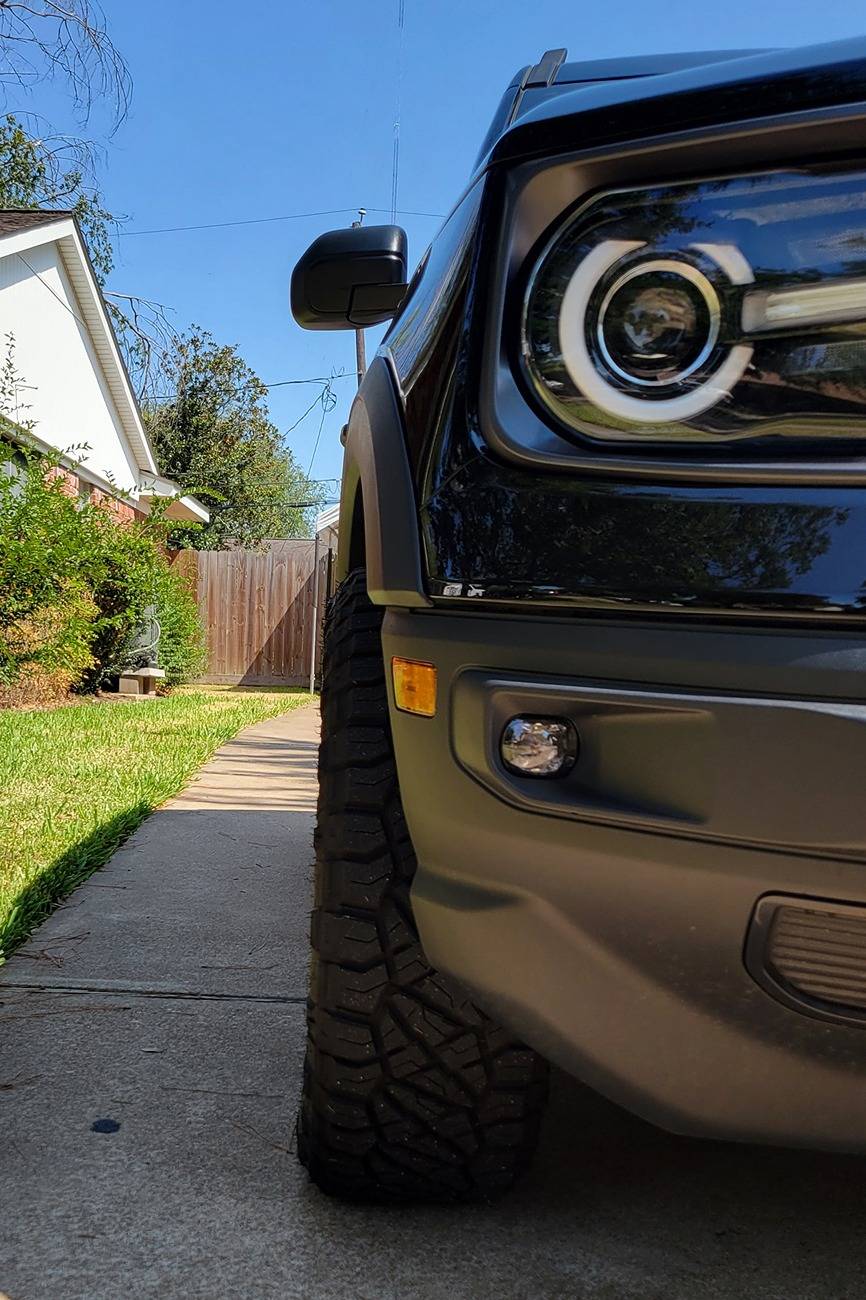

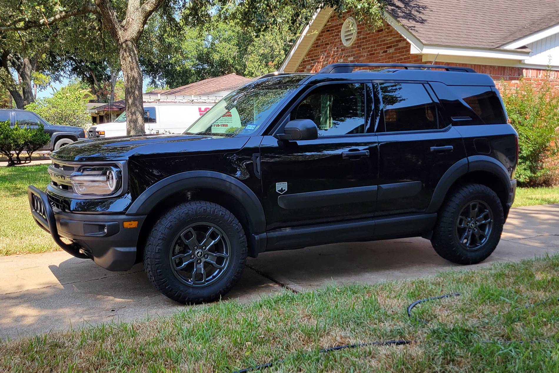

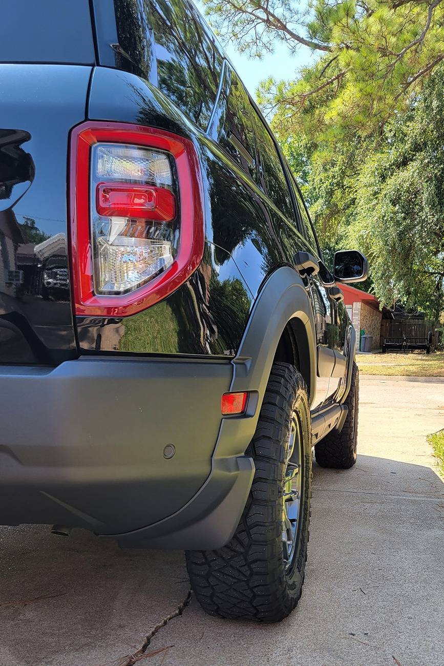

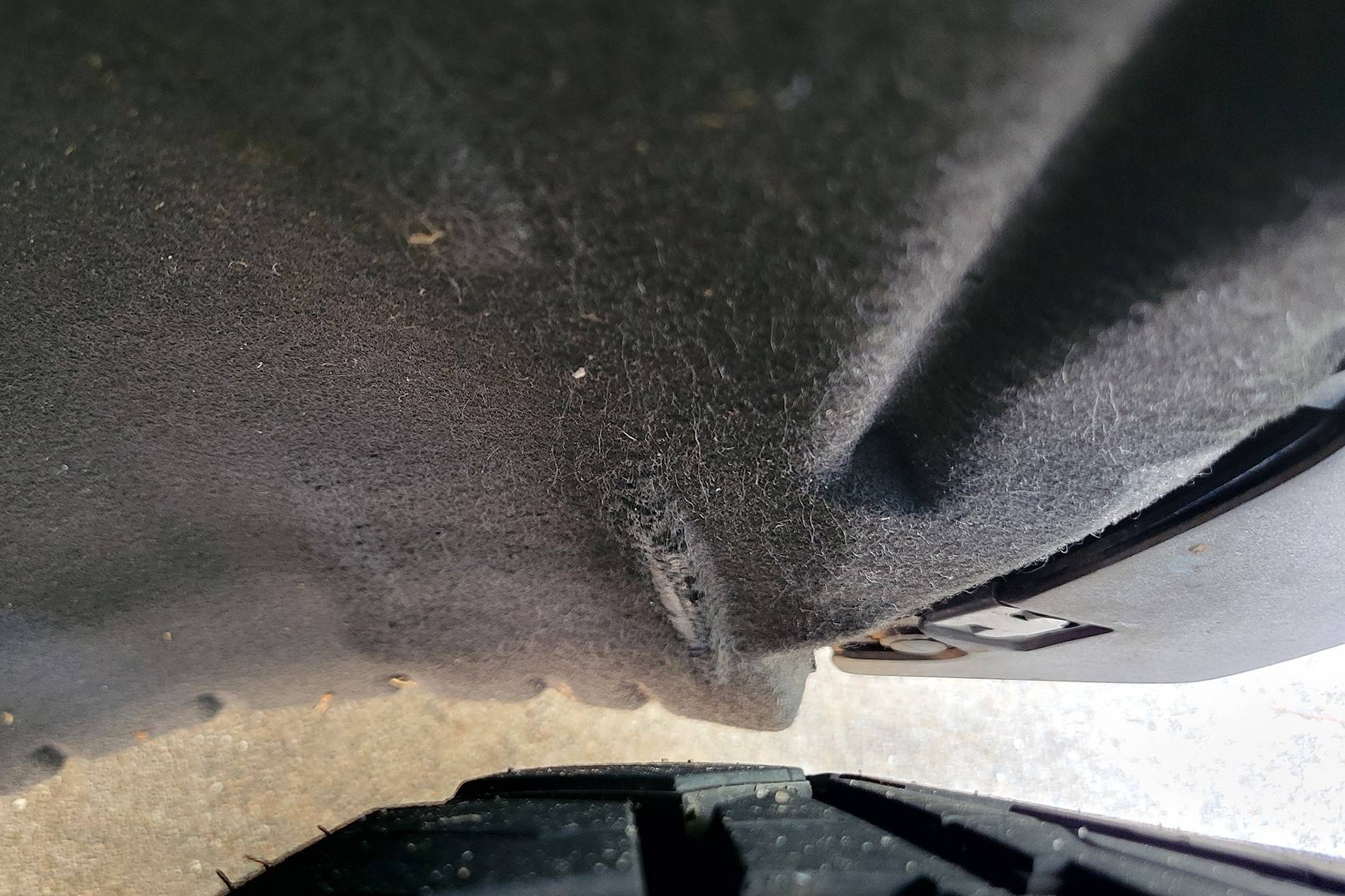

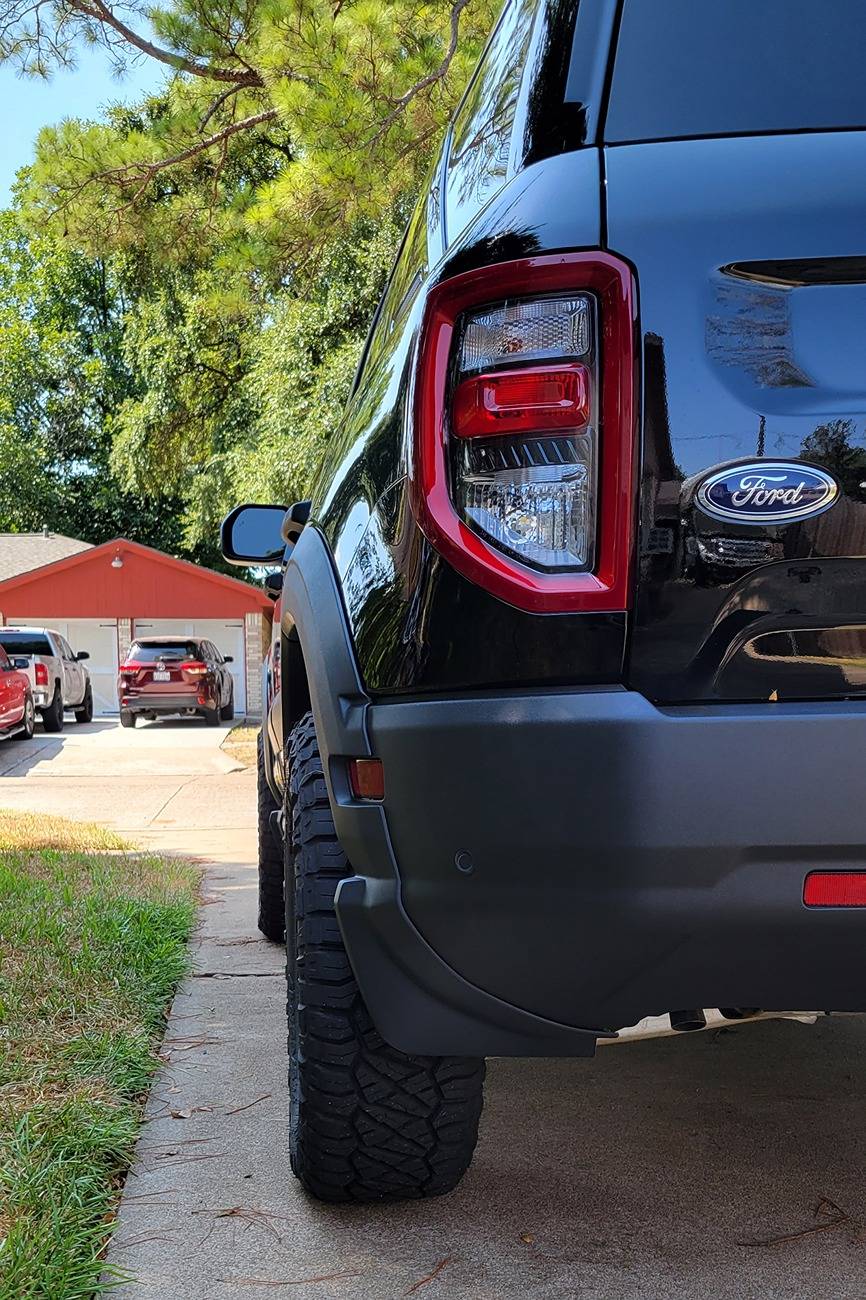

This is my wife's 2022 BB with the Rough Country 1.5" strut and spring lift (not the spacer lift), stock wheels with a 1 inch spacer and Nitto 245/65-17 Ridge Grapplers. It also has the Air Designs fender flares and door moldings.
It only rubs a tiny bit on the fender liner on the driver side by where your foot would be... and only when turned and flexed. Which could probably be fixed by bending over the pinch weld under the liner.

Looks amazing!!! I was thinking about doing a 265/60 because it’s a little wider and not as tall but these 245s with the one inch spacer look perfect! Thanks for all the photos!!! I will post some before and after when we get done.
