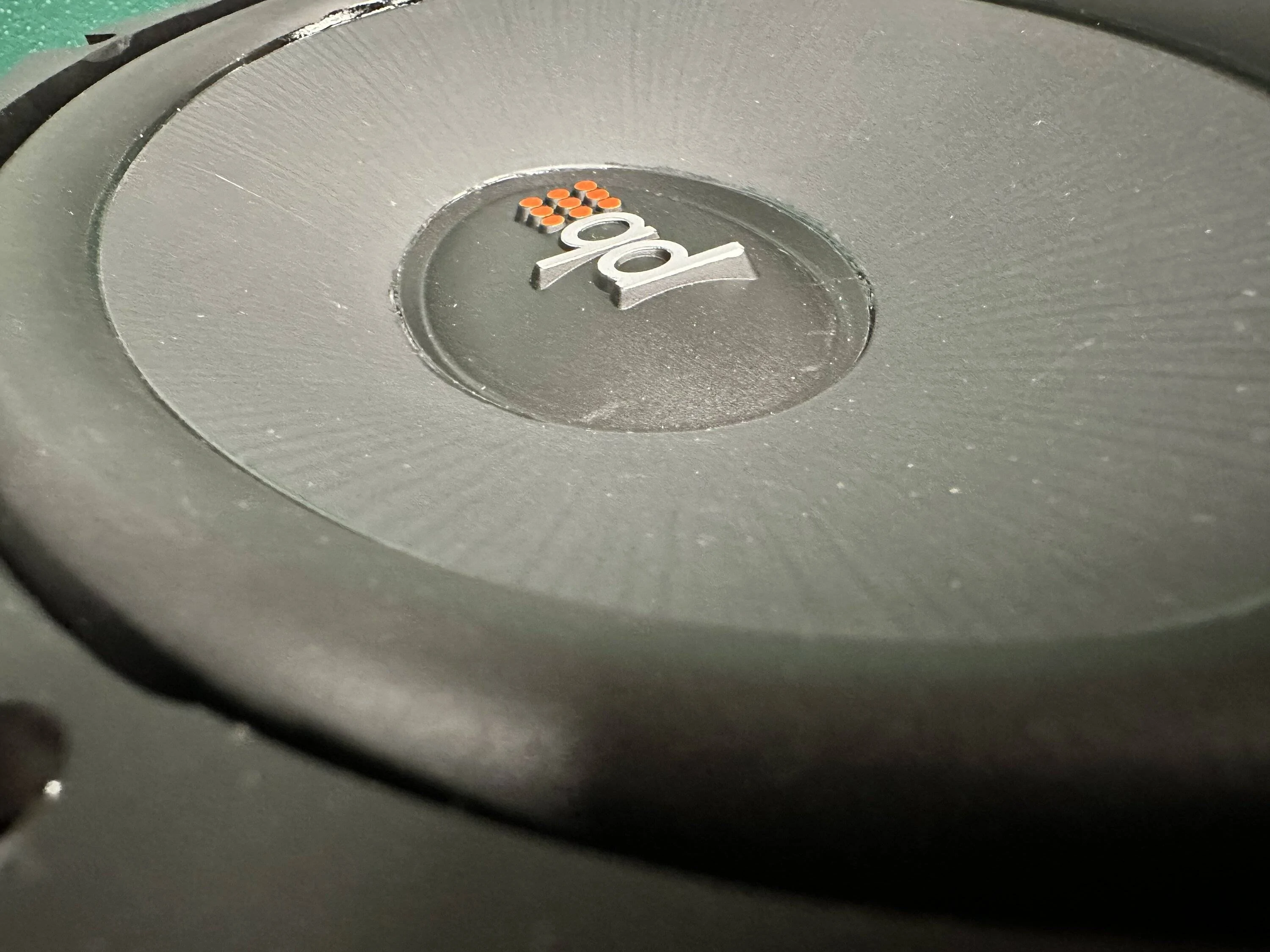

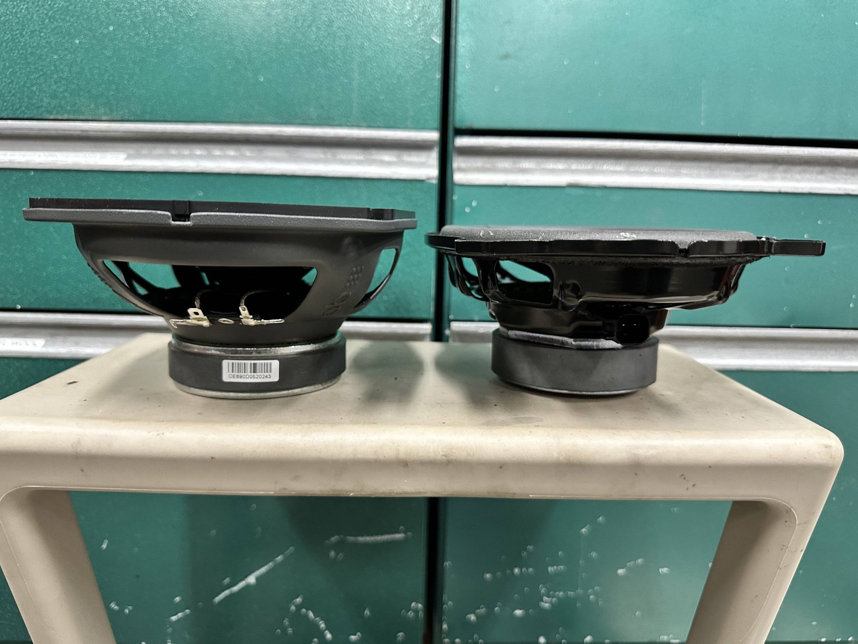

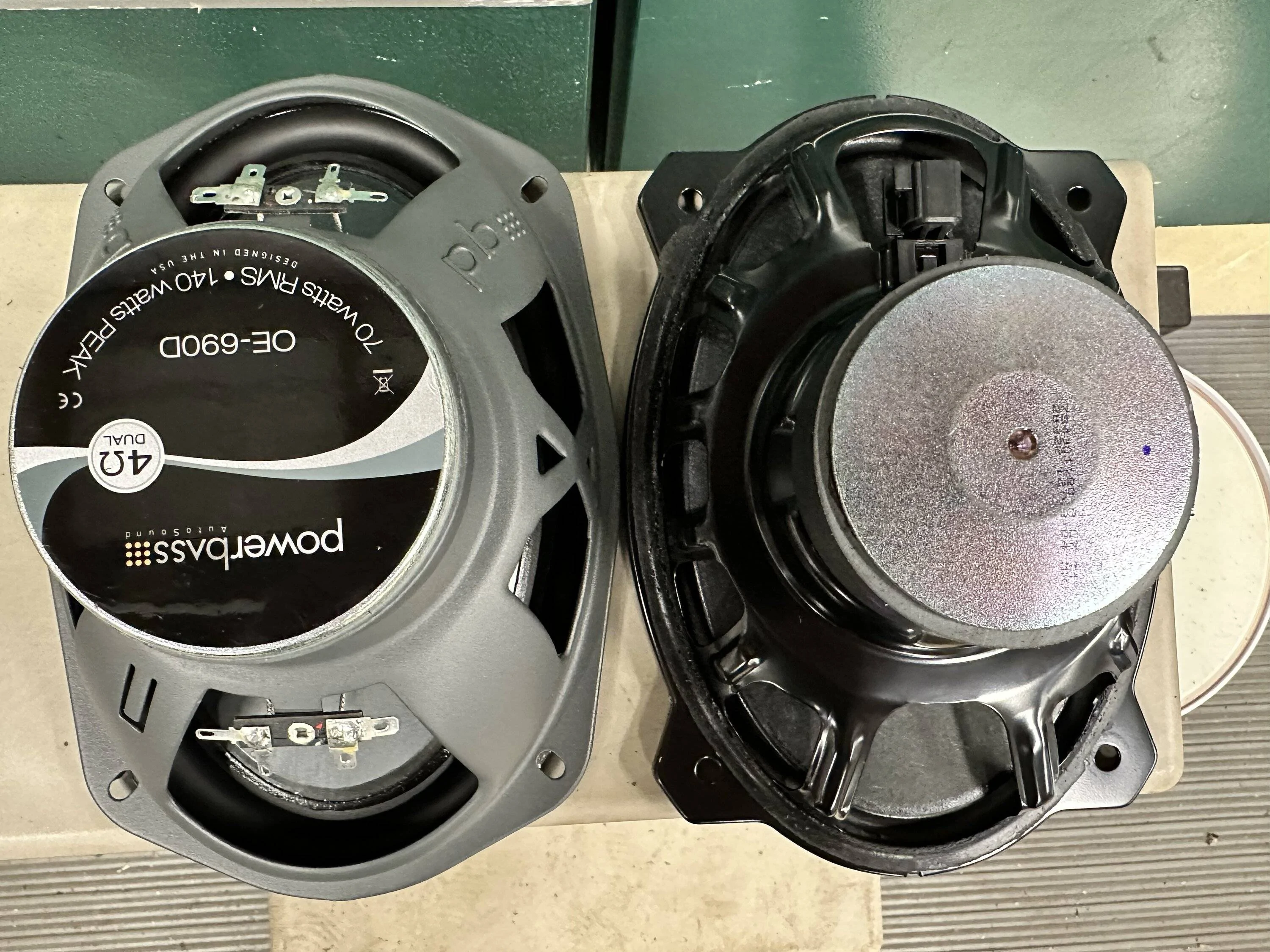

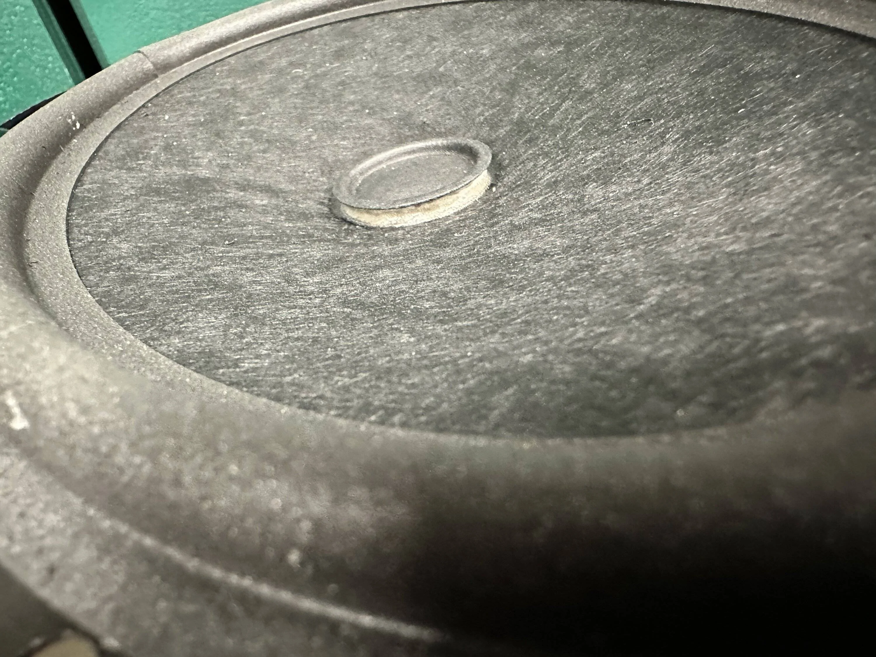

I had looked briefly for a potential upgrade for the 6X9 subwoofer in the B&O system. I found something that just would not have fit, but I didn’t know until I did this that for sure it would not have fit. I happened to get an email from Amazon with a list of other PowerBass speakers. In that list was a set of 6X9 speakers. I got that email because someone else had asked about which PowerBass speakers to buy to replace the door speakers. What peaked my curiosity was that they were from PowerBass and I have been very happy with the door speakers. If you haven’t done it yet, take a look at this post to see what you definitely should do. The other thing that drew my attention was that they could be run at 2 ohms. That means more power to the speaker, if the amplifier will drive a load that load. I was left to make the experiment myself, since I haven’t seen anyone else attempt this.
Here are some pictures comparing the PowerBass unit to the Ford unit:

What you can’t totally tell from the pictures is the cone on the Ford speaker has no structural integrity. If it wasn’t glued around the edge it would just about flap in a breeze. In the picture the Ford one has some damage because the cover grille was glued down to the edge of the cone, so removing that grille to reuse it requires essentially destroying the Ford part.

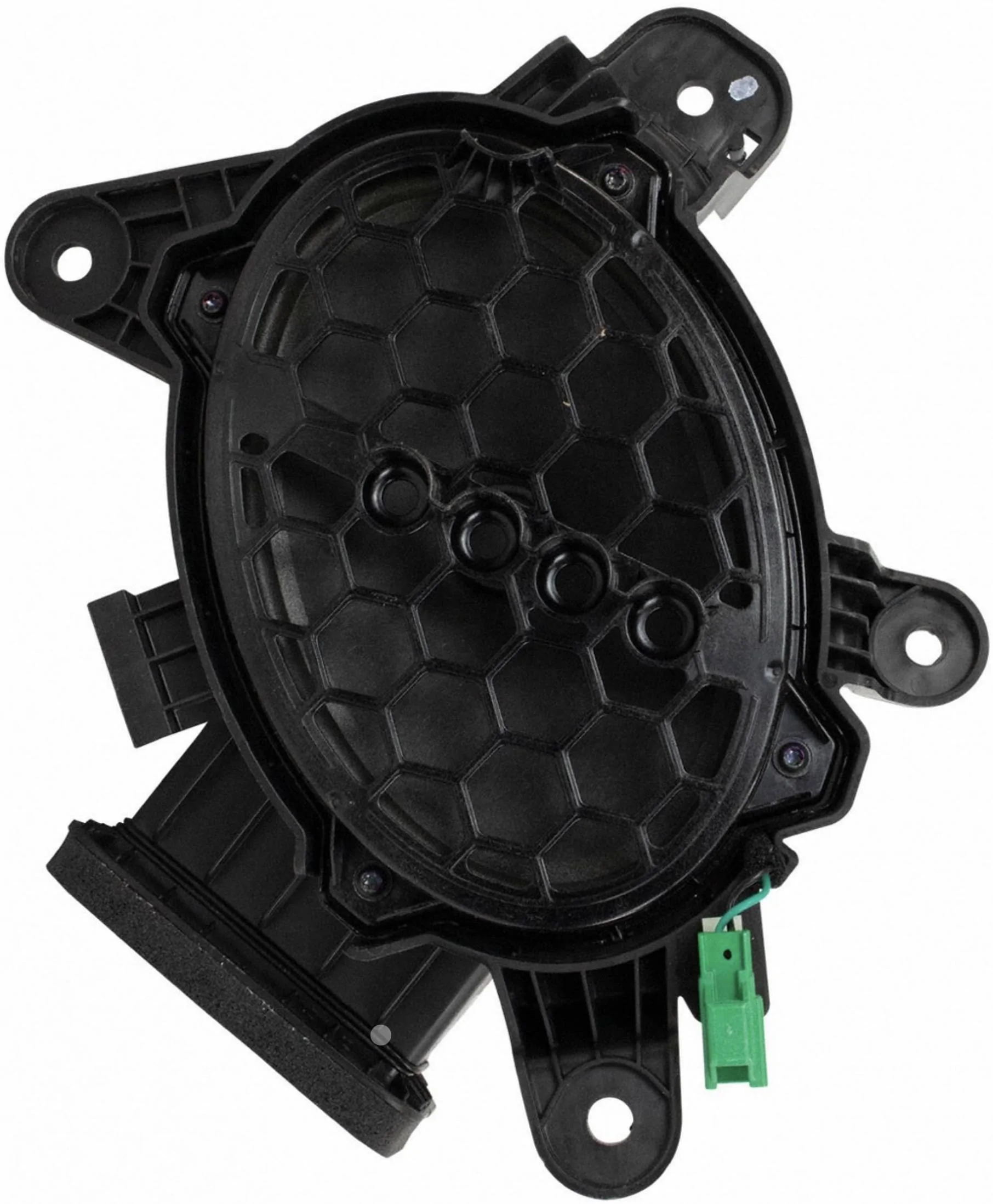

Here is what the Ford subwoofer full assembly looks like:
Ford Bronco Sport Olive - Meanderthal’s BS BL 1687915707602
That is how it sits in the BS, more or less. You can see the 4 bolt holes, where you will need a 7mm socket/nut driver to remove it. The electrical connector has a little button/lever to push and it then releases pretty easy. Once you get the assembly removed, you need a T25 torx driver to remove the speaker from the housing. To remove the grille from the speaker, you have to get aggressive with a couple flat head screw drivers and work hard at it. It will come, but it doesn’t want to. The glue is very flexible so you have to push it past the point that it wants to just go back.

Now it is time to install the PB speaker into the Ford housing with the Ford grille. Wait, you are first going to have to cut the pigtail wires from that green connector and wire the PB speaker. In order to wire it at 2 ohm, you will need to connect positive to positive and negative to negative on the back of the PB speaker. Then connect the green wire from the pigtail to the positive terminal and the black wire to the negative.
