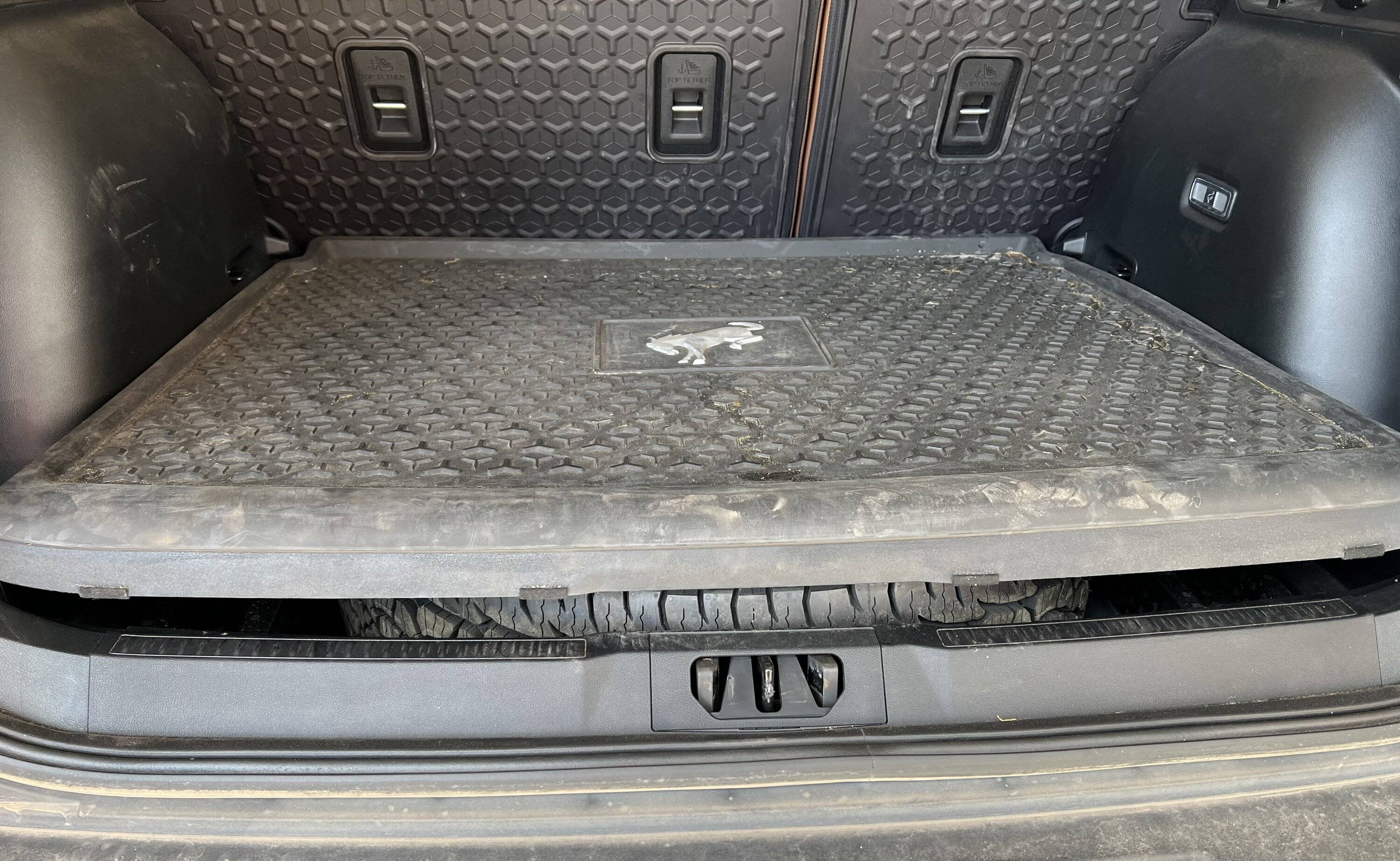

First remove the foam blocks from the sides of the spare tire area, and cut the center of the “carpet” out. I used a 1” snap knife to cut the carpet.
Ford Bronco Sport Olive - Meanderthal’s BS BL 1667437200269
I went a little further than I think most do and cut the center of the carpet out by following the indentation left by the stock steel wheel.
Ford Bronco Sport Olive - Meanderthal’s BS BL 1667437231166
Then just put the jack back into place.
Ford Bronco Sport Olive - Meanderthal’s BS BL 1667437260582
Now the 245 tire will fit.
Ford Bronco Sport Olive - Meanderthal’s BS BL 1667437298345
Slide the floor panel back in the the “high” slot at the front. Basically, if you just lay the panel on the tire and slide it forward, it will go into this slot. Sorry, the panel was dirty from wet cardboard boxes that I brought the stock wheels home in sliding across the panel.
Ford Bronco Sport Olive - Meanderthal’s BS BL 1667437341567

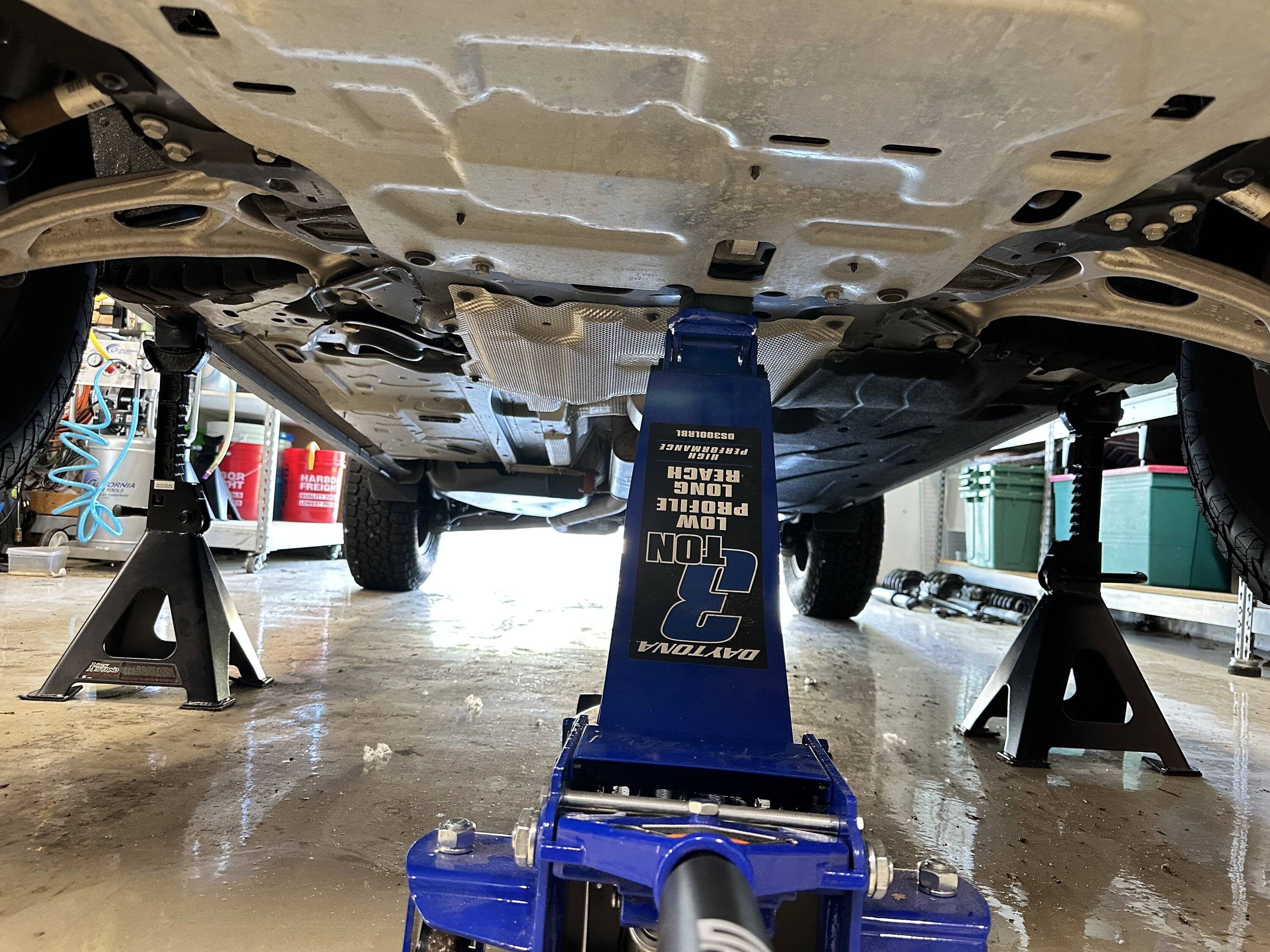

I thought that it could be useful to share some information on where to jack up the BS and where to place jack stands. So here goes.
If I am going to put the BS up on 4 jack stands I will use the front door jack point. Jacking from there will lift the entire side of the vehicle up and you can place jack stands under the back door jack point and then I put them as shown here in the front:
Ford Bronco Sport Olive - Meanderthal’s BS BL 1687308758287
Note that this picture shows just the front jack stands in place, not the rears. The other thing to note, is that I have rubber pads for my jack stands that work against a flat surface like this and also on the pinch weld jack points.
For doing an oil change, I jack the car up from here:
Ford Bronco Sport Olive - Meanderthal’s BS BL 1687308936005
Note also that the jack stands are under the front pinch weld jack points. That is where they stay while I do the oil change.

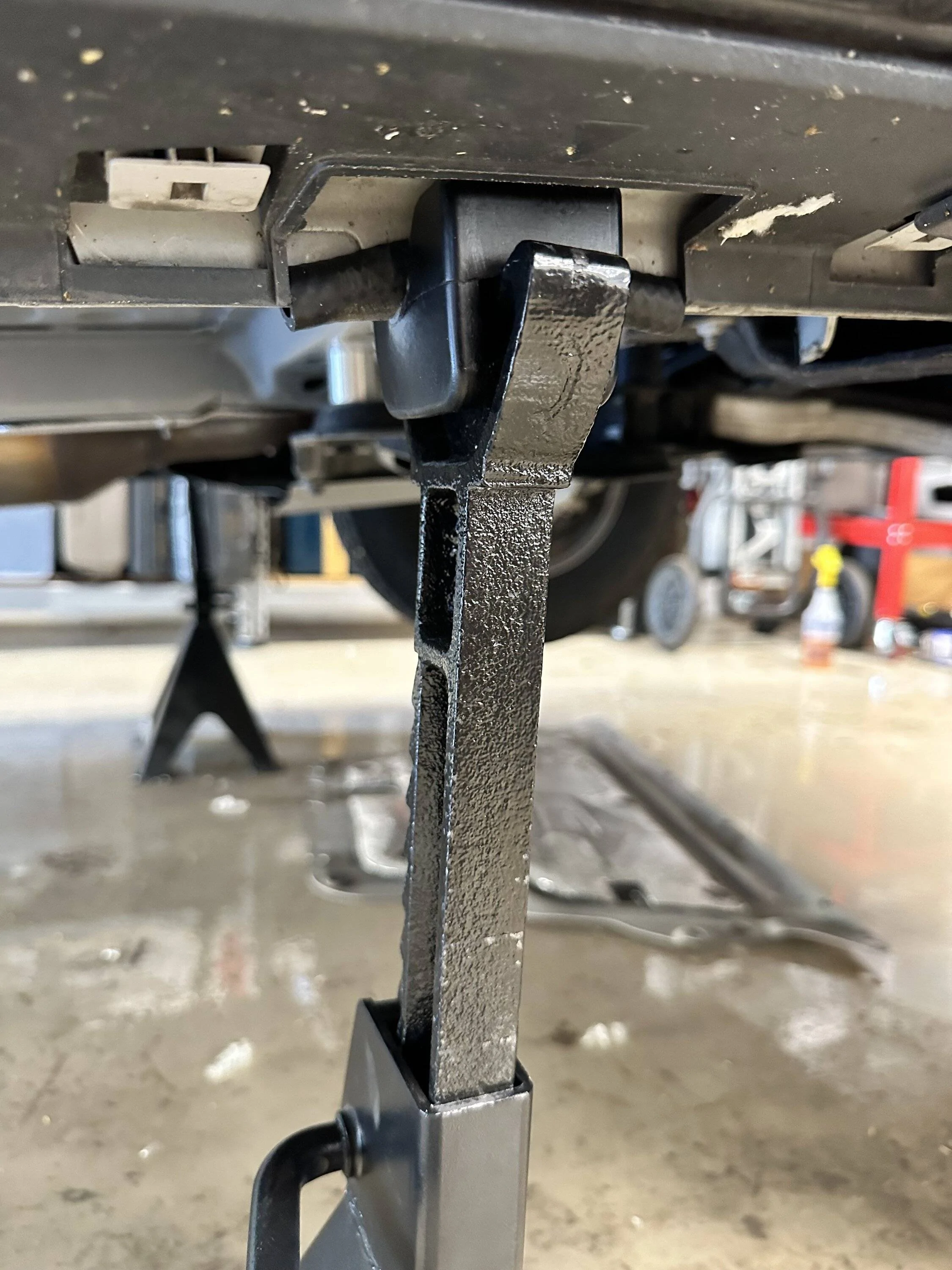

Those rubber pads on the jack stands are new ones. The previous set were essentially cut in half by the pinch welds. I am attempting to avoid that now by taking a piece of 1/4” fuel line (left over from the hood shake fix) and slicing a slot in it. With that on the pinch weld, it should hopefully keep the pads from getting cut by the pinch weld.
Ford Bronco Sport Olive - Meanderthal’s BS BL 1687309197100
I don’t know if I can just leave the tubing in place all the time or if I need to remove it every time. It’s cheap enough and I have enough left over to just try it. If you are going to do this, cut a piece of tubing that is 4 to 4.25” long and then slice down the center. Be careful not to cut yourself!

@Meanderthal .. on those pics do you have some aftermarket skid plates installed and are the pics for a 2.0L model? Thanks!
2,164
3,155
Belleville, IL
No extra skid plates installed (yet). Yes, this is on a BL model (2.0L)
