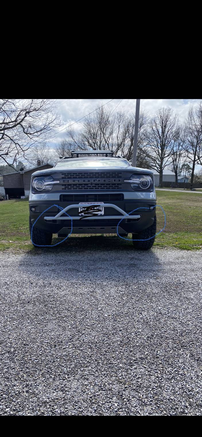

now im planning to paint the tow hooks red and add a rally innovations bumper skid plate and the light bar

I like the light bar. But he is expensive at $499 currently. The top part seems lower than what I remember. Does it block the camera or 360+ equipment?
Oval Office
Feb 12, 2023
43
105
Willow springs Missouri
22 bronco sport badlands
It doesn’t block the camera, I think it is lower also, blocks some of the license plate. I won’t do that again
