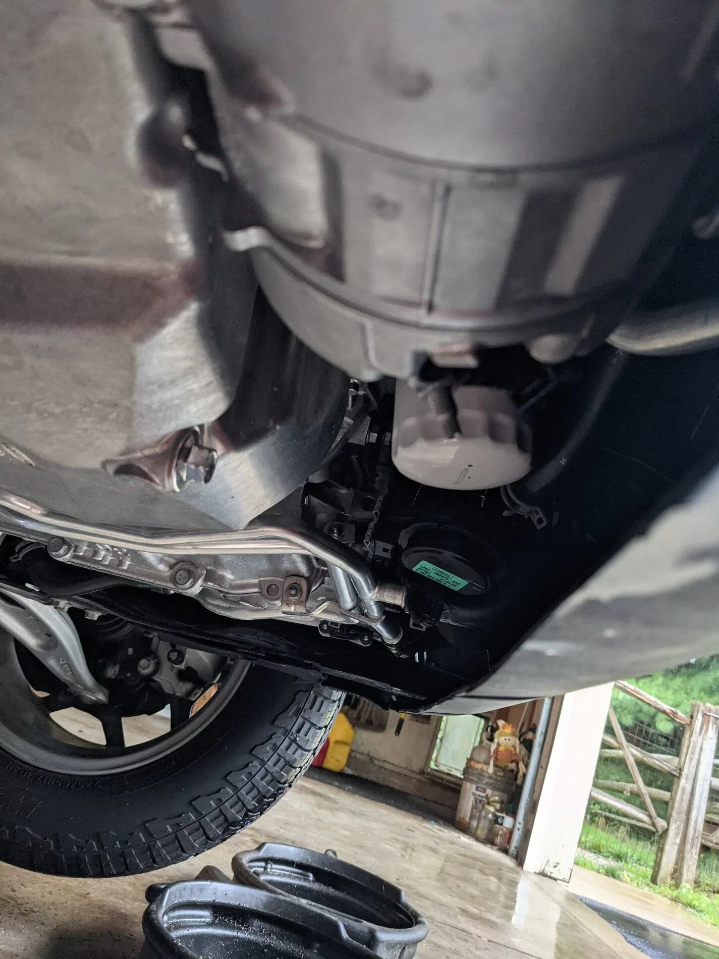

Just changed my oil on FE @ 1300 miles.
So you need T30, 13 & 15mm socket and 76mm oil filter socket.
I had a bigger OEM filter.

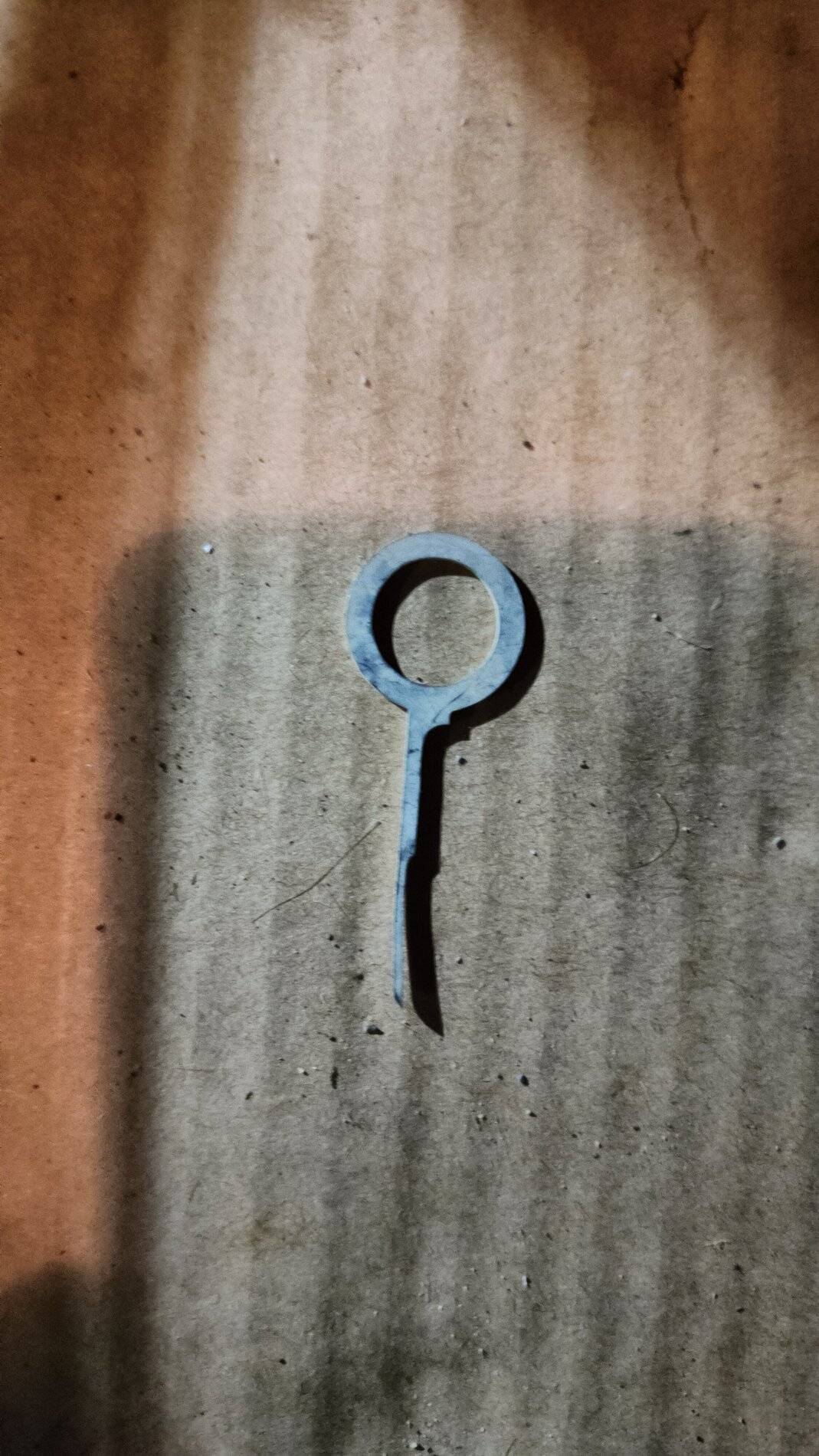

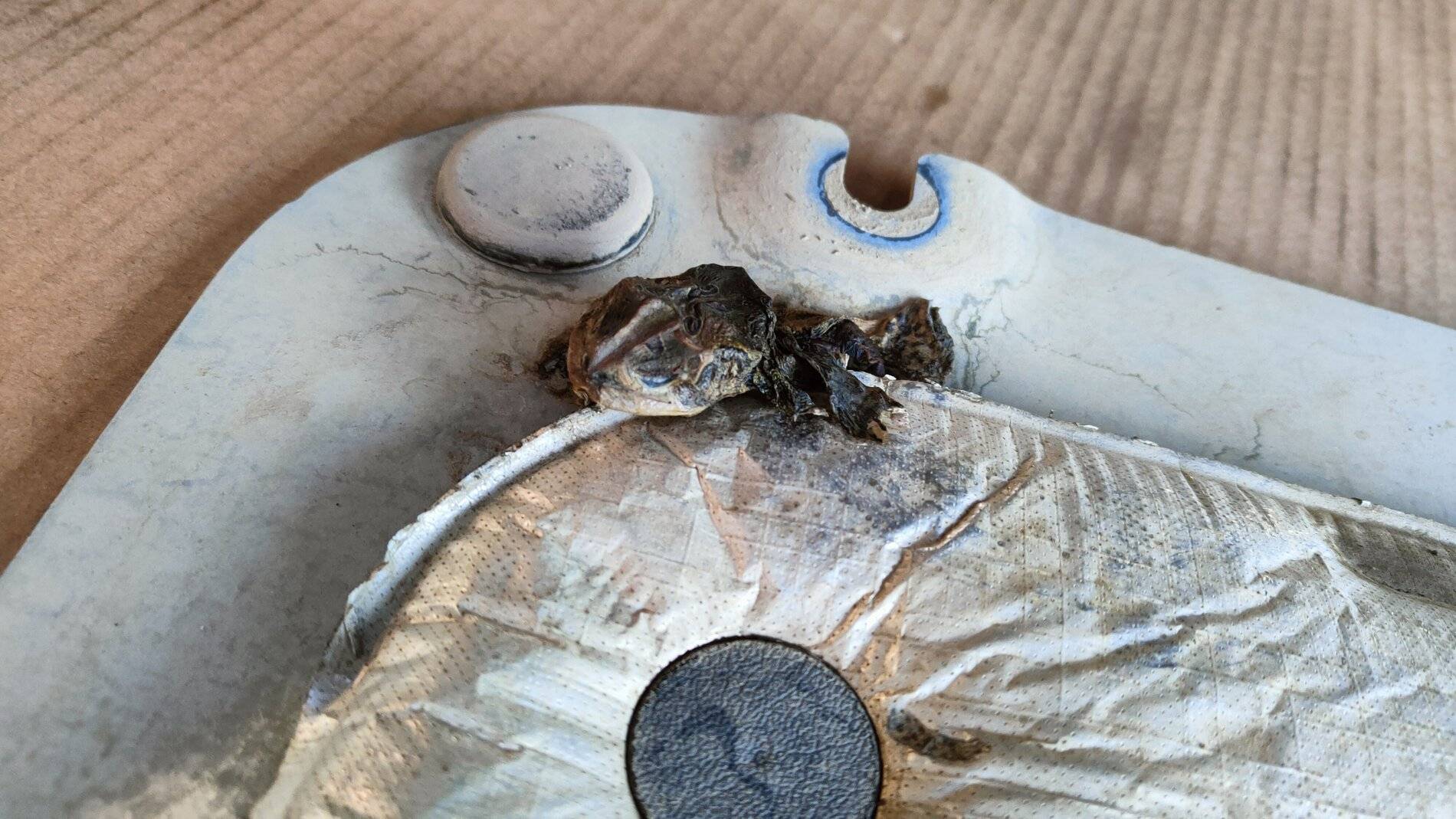

There were 2 surprises.. first a key/pin looking thing fell out (anyone knows what that pin/key for?) and second I got a present from Mexico. Last picture.

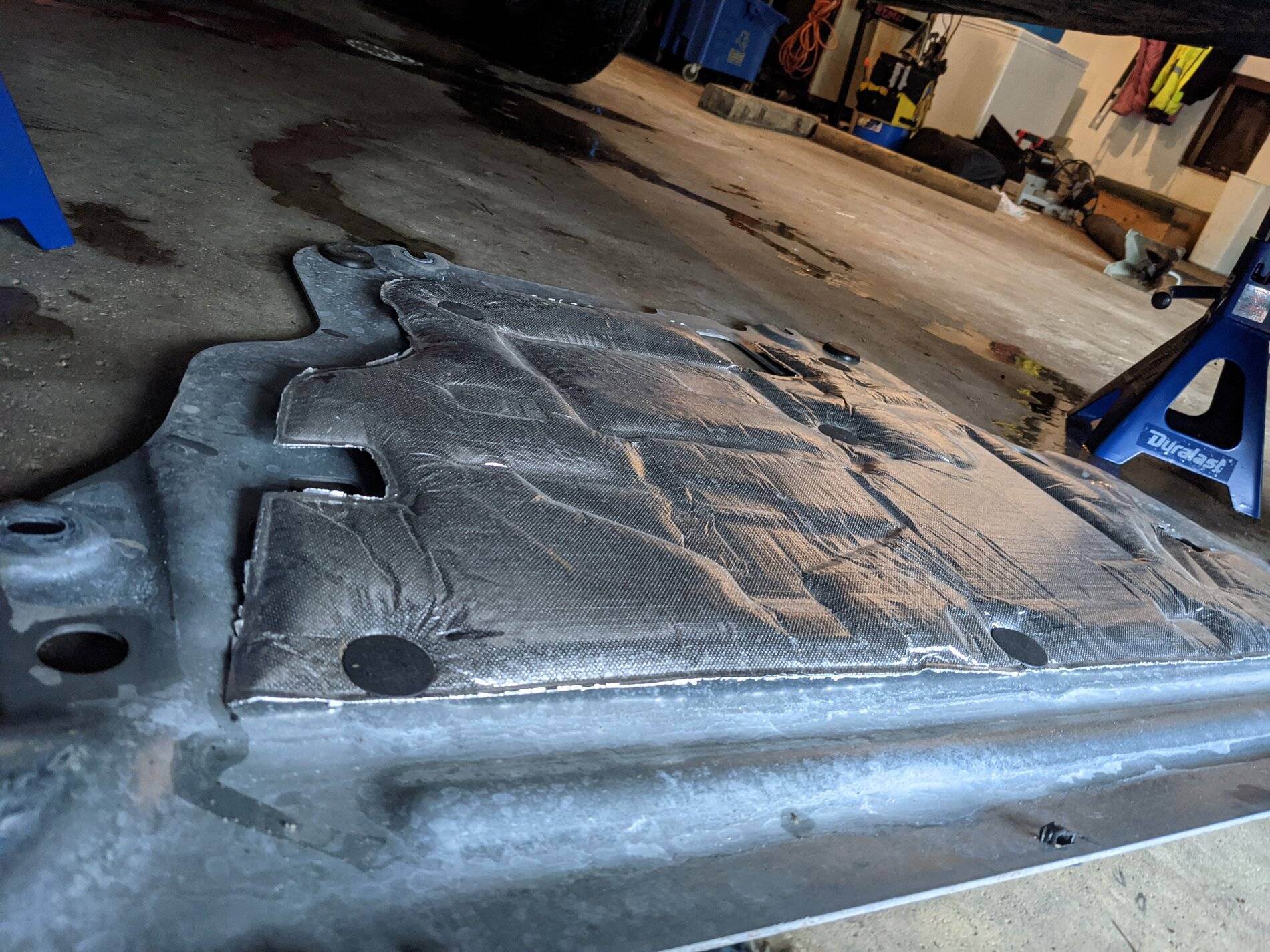

Just finished the first change on my 2.0L at 3,267 mi. I can verify it's 4 x T30 screws attaching the bumper cover up through the bash plate from underneath (remove these first); and 6 x 13mm bolts attaching the bash plate (watch out, it's heavy and just drops right out). 15mm drain plug. The OEM filter and my FL-910-S were the same size. Using 5W30 MC Synthetic Blend as recommended. Curiously the cleanest oil change ever, it all just comes right down without getting on anything. It was easy to fill and screw on the new filter too. While 5.5qt did indeed come out, It was just about full at 5qt 8oz having filled the filter first, so I left it. There is definitely a little bit of fuel blowing/washing by into the crankcase in these engines. Oil was dirty enough already. Haven't seen any,, but haven't inspected the bottom of the drain pan yet for any shiny bits. Slide the bash plate forward in its mounting holes to mesh best with the bumper cover attachment/screws. Reset meter. Take in used oil.

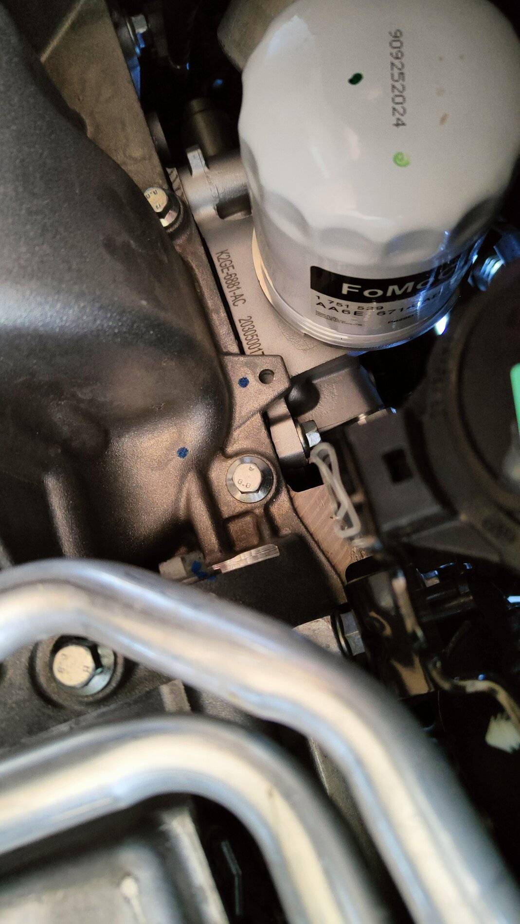

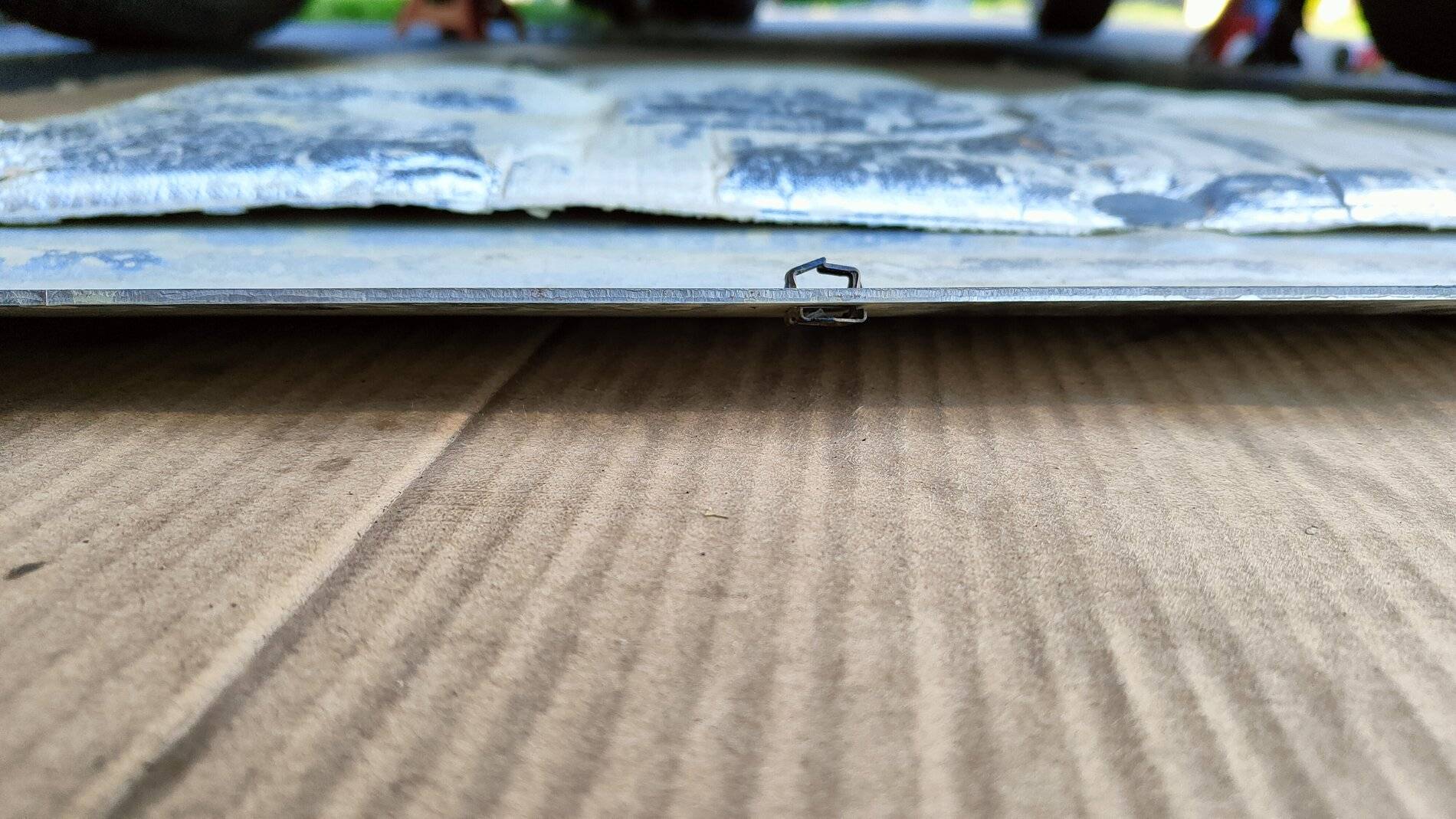

Went really smooth. The metal plate is heavy-ish but balanced. Thanks for the torx and mm wrench details. My filter was pretty snug so I used a filter wrench to take it off... probably still a bit warm when I took it off so it was likely swole a little. No issues just easier getting my hands on it after a few turns.
Out the door for $21 oil and filter. Hard to beat. And I can dispose of oil at the local bus garage they have a oil furnace for winter and use up old oil. Bonus.
Ford Bronco Sport Oil Change PXL_20210630_171001242
Ford Bronco Sport Oil Change PXL_20210630_171005880
The insulating panel on the bash plate was interesting. Likewise the location of filter and oil plug couldn't be much better. So simple.
* and to my mild disappointment, no random keys or lizard bait...just a normal oil change with maybe a bug carcass from highway travel that's about all the surprises I got
