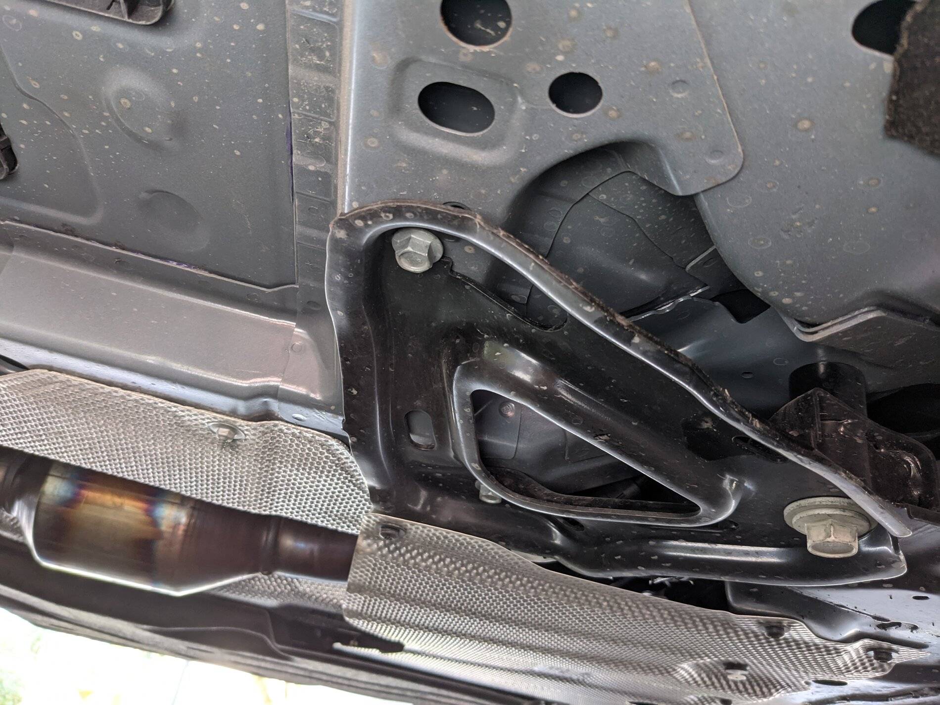

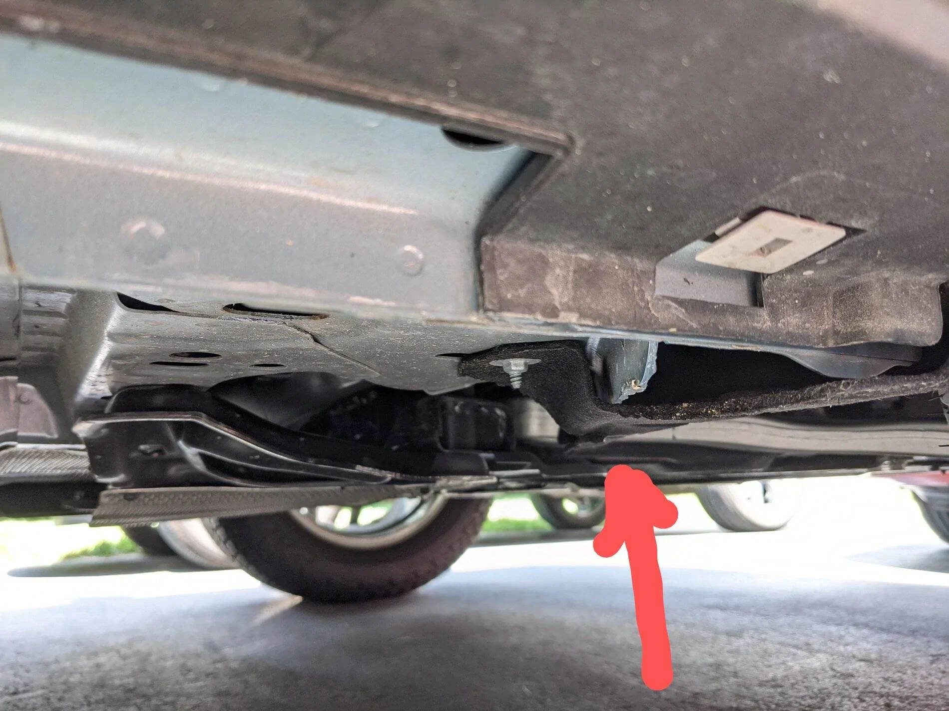

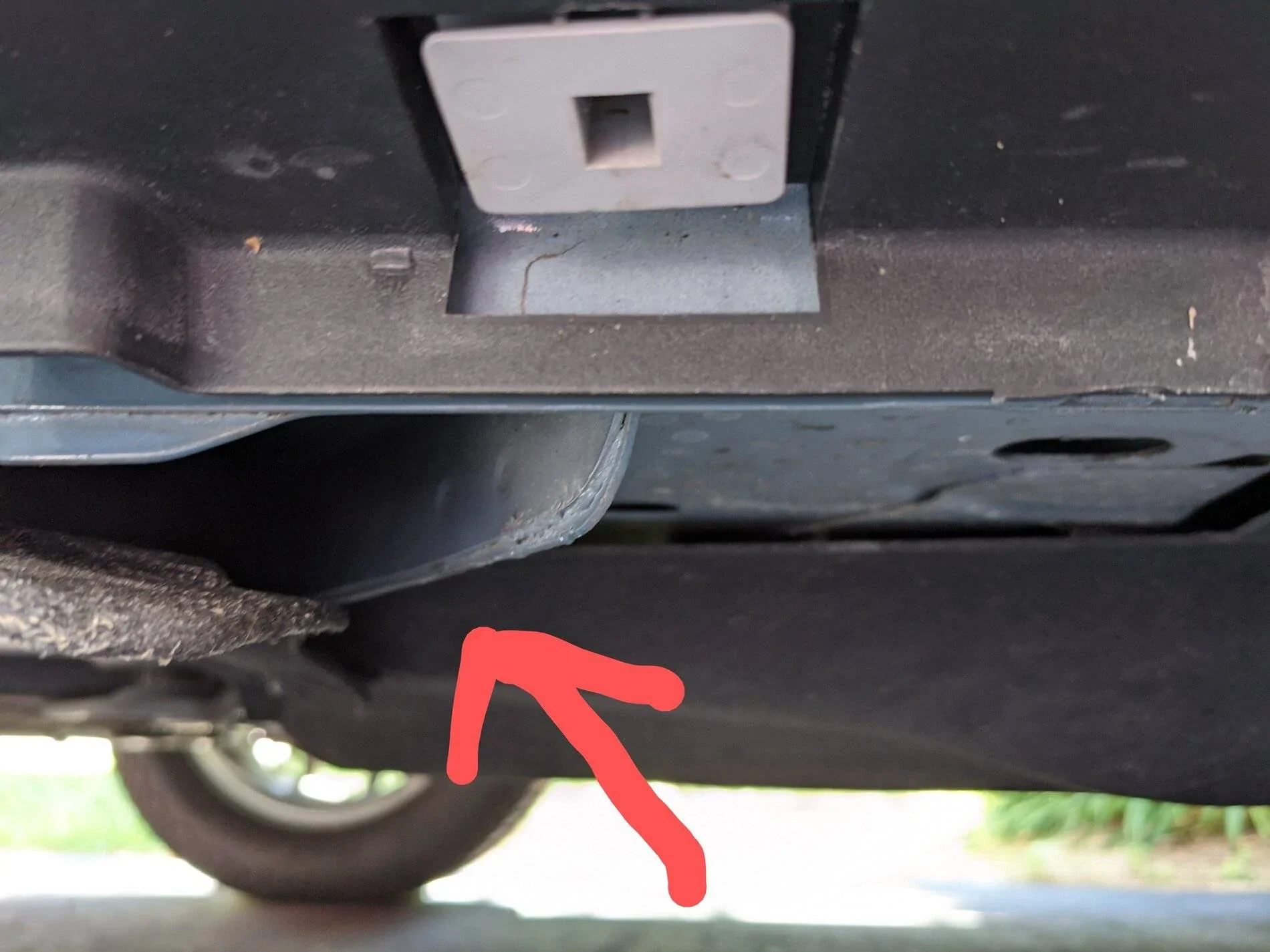

13MikeH -- where did you put the jack stands?
I have a 3.5T jack, used the jack mounts on each side to lift. From there I saw similar weld points angled toward the engine and placed one under each of those and left the jack extended on the passenger side. No problems and felt very stable. I even accessed and closed the driver door and it held solid. I'll post pics of options in a bit. Working on a project as I type.
Basically I just followed the pinch welds with the red arrows. Also a lot of solid bracing and jack points. You could also use control arms according to the manual.
