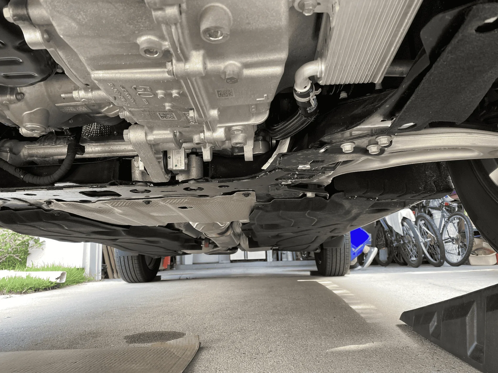

I changed the Oil in the BS today & man was that Factory Filter on there tight , I crushed it getting it off . Its funny , never had a car/truck that you couldn't start the Engine with the Hood up . I used Mobil one Truck/SUV 5-20 full synthetic.
The under carriage sure looks good with both Covers on , has to go faster with them both there , LOL
Thats not oil spot on driveway , its from the A/C condensate .
Thats not oil spot on dri1veway , its from the A/C condensate .
Ford Bronco Sport Oil Change tempImageCeVKAL

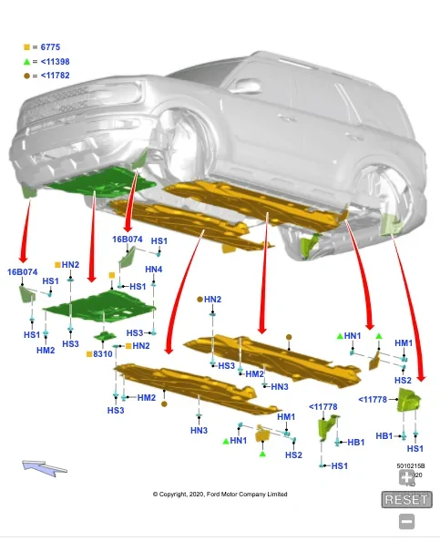

I believe the BL and FE are supposed to only have one. If you look at the replacement parts they offer 3. A driver side and passenger for part-time drive and then one driver side for FTD which I am assuming is the 2.0 engines. ?‍♂ could be wrong but Ford has not mentioned anything. They have "omitted" the engine cover so people are aware as well as the 12v plugs and the addtion of rear washers for all trims for builds after May 2021. Either way the bigger engine will make up for lost aerodynamics ????
Wonder why that would be .

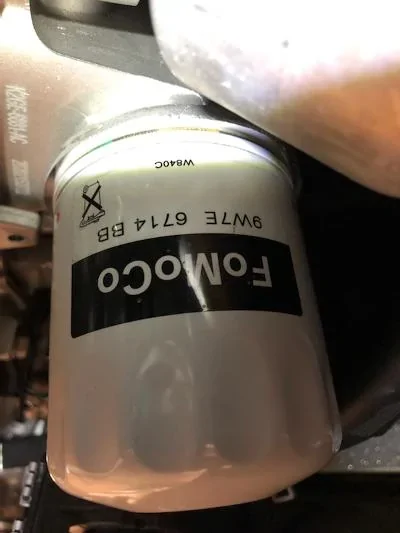

OE filter I'm about to remove for my wife's badlands, 2.0, oe filter

I had this same filter on my FE which got its first oil change at 4k miles over the weekend. I was actually surprised at how small this factory fitted filter is along with the standard FL-910-S filter.
Is there a better non-Ford part from Amsoil or Mobil1 that fits these 2.0 engines ?
Fortunately my factory filter was just able to unscrew by hand...just.
Would be super fast oil change if not for that skid plate.
This is my first time DIY oil change on a DI Turbo motor and, although I am not an expert, my two observations are that the oil was filthy and absolutely full of gasoline.
I generally use Amsoil in my cars but went with Mobil1 this time.
Daniel.
Generally, 5k miles is the limit for these DI engines because of the gasoline dilution. If you do a lot of short stints, you will likely have more. The Motorcraft (Ford) Filter is your best bet for quality and price. You can pick up the filters at walmart, and auto stores. The filter you took off for the initial oil change , while put on by Ford, is not related to the motorcraft filter you can buy at the store and dealers and is exclusive to the factory only. I noticed they really wrenched that filter on when I did my initial one as well. Hope that helps.
