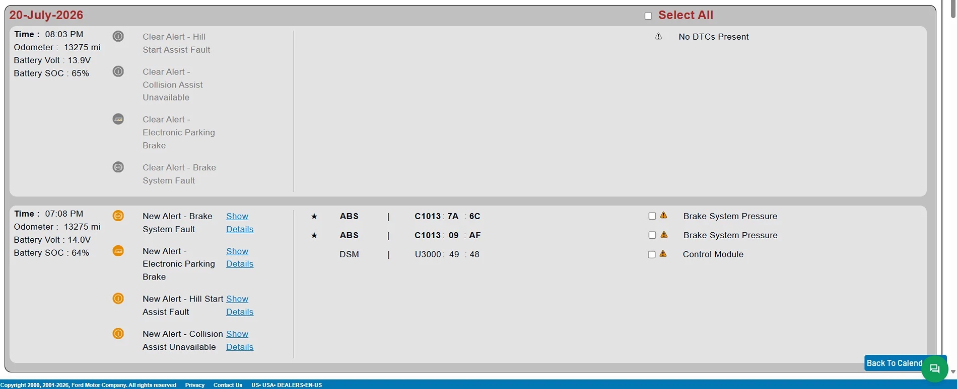

It has not reported any data to the cloud since yesterday 8pm when you cleared codes. I don't see any IPC codes, so that must have started after. If you can, post a screenshot of the code. If not, I can run the VIN again after you drive it to see if it reports itself to the cloud.
Ford Bronco Sport Mustang Mach E Conversion 1784656972624-5m
I’ve driven it quite a few times since I cleared the codes. Which is why I think it’s a soft trouble light. I’m not too concerned about it, especially if you’re not seeing it on your end. But I’ll connect it this evening, and upload a photo.
Thanks for your help.
Strange that it hasn't reported any data, but I agree that it's most likely nothing.

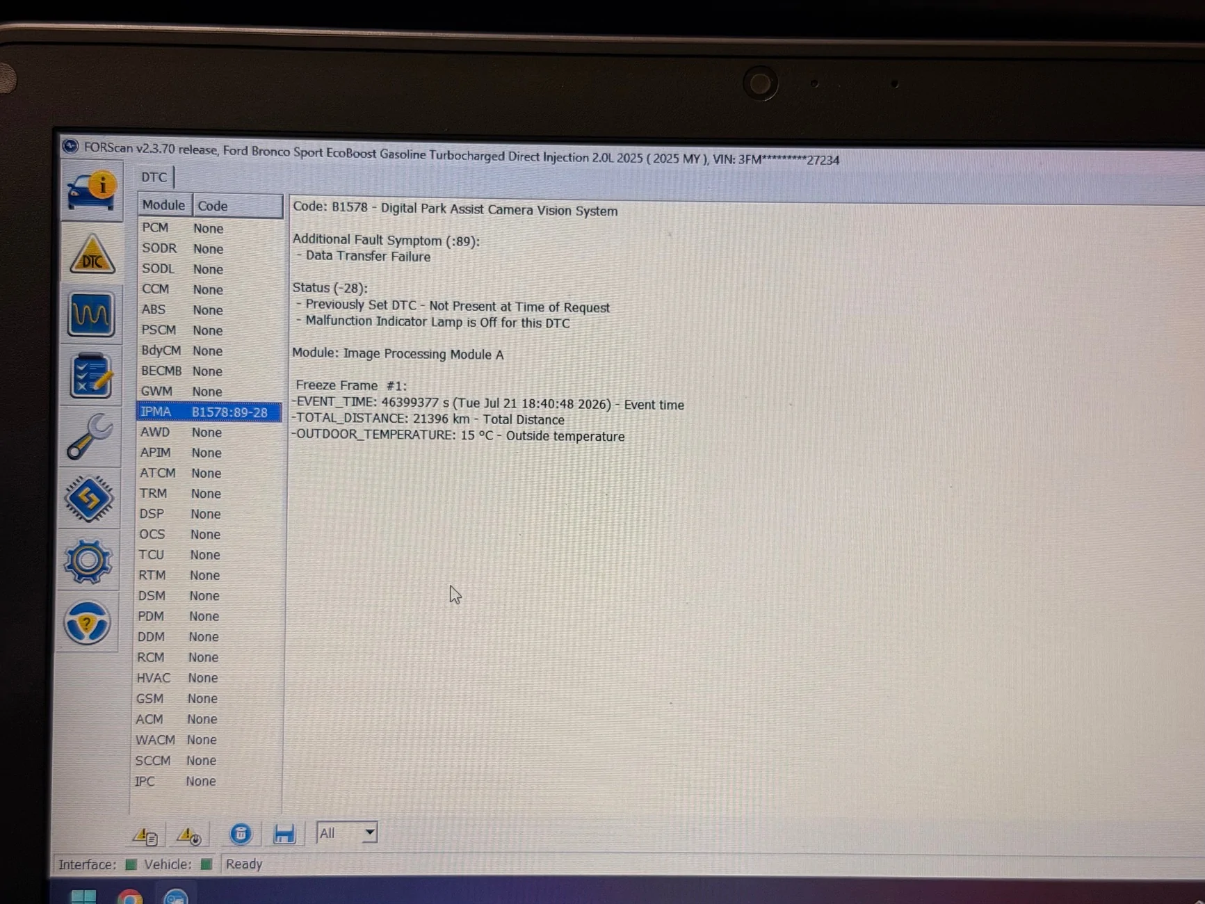

As expected, it must be a soft code. Because I just drove it another 10-15 miles, and when I got home, I hooked up to ForScan, and the code I got today, is different than last night.
Got it cleared, and everything seems good to go.
Yea, those data transfer codes happen all the time. It's a stored code and nothing to be worried about.
