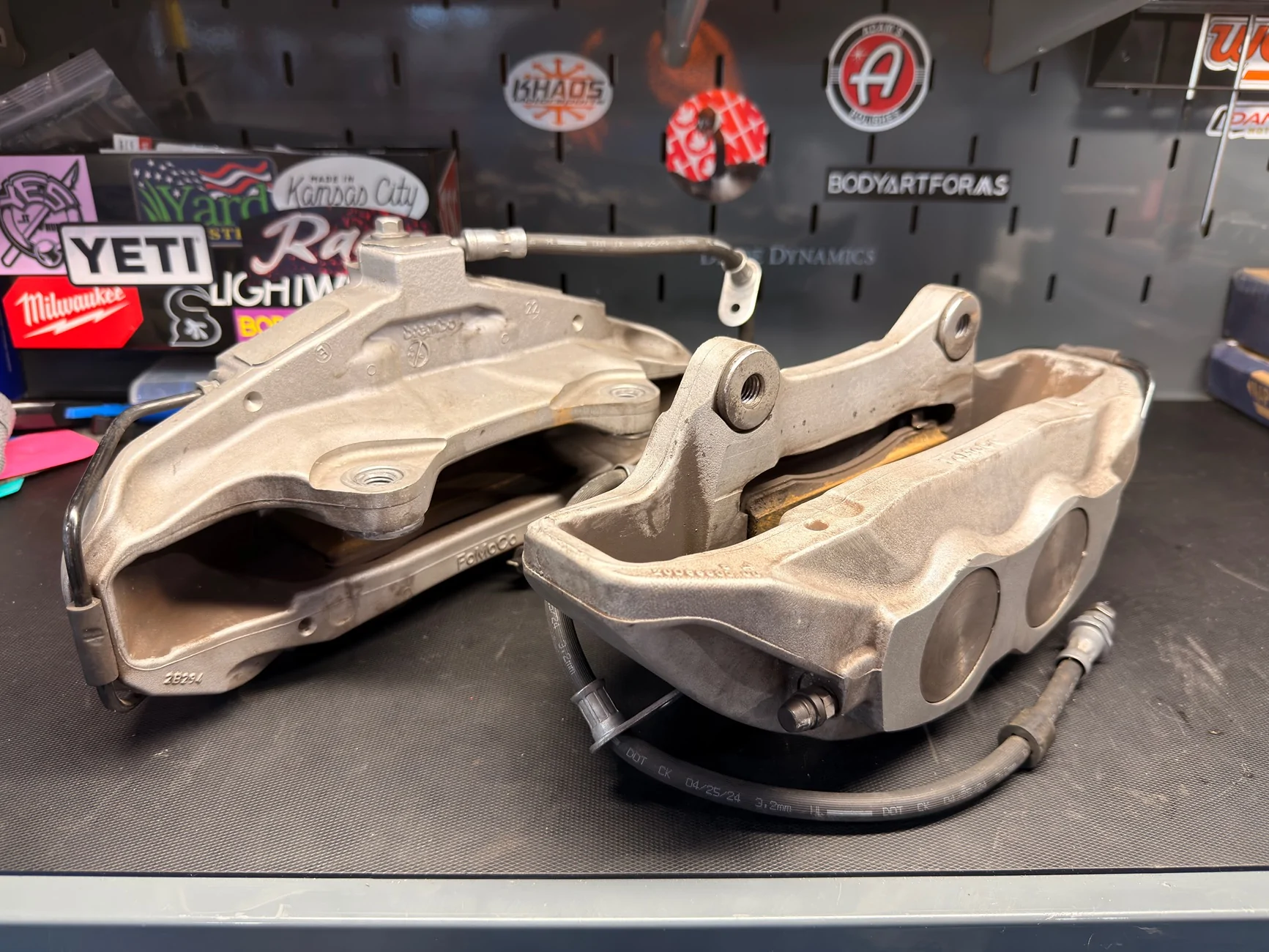

Just ordered a set of Mach E Brembo calipers.
Found a used set on eBay with 17k miles on the donor car.
From everything I’ve read, it seems like a relatively straightforward process. I ordered two sets of rotors from work, because there is a 17” wheel setup and an 18” wheel setup that work with these calipers.

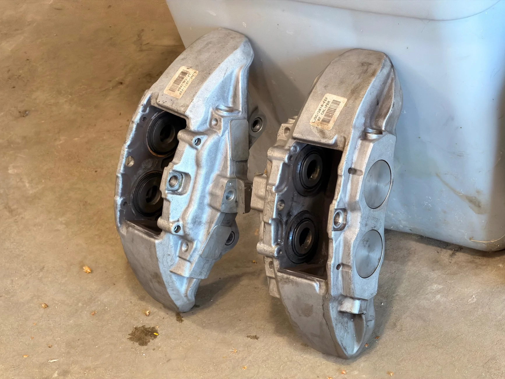

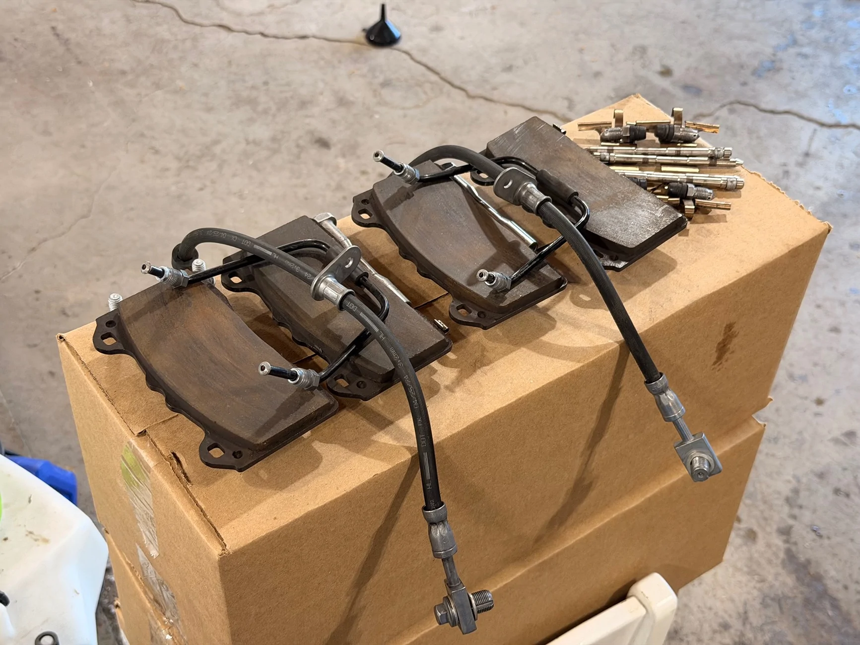

They arrived today. Very clean overall. Took and disassembled everything on them. Going to be giving them a fresh badlands orange paint job and then the work on getting them on begins. Hoping I can get away with the smaller rotors, and maybe still utilize my stock wheels. I don’t have HIGH hopes, but there is an option for 17” wheels with the brembo brakes. 🤞🏻

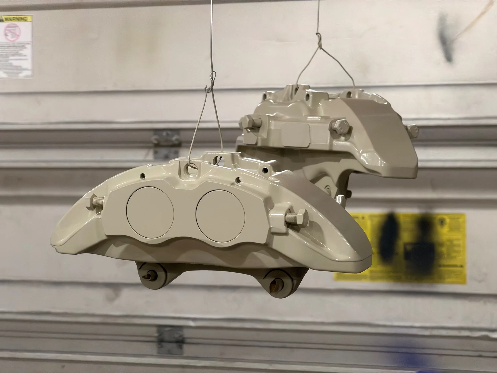

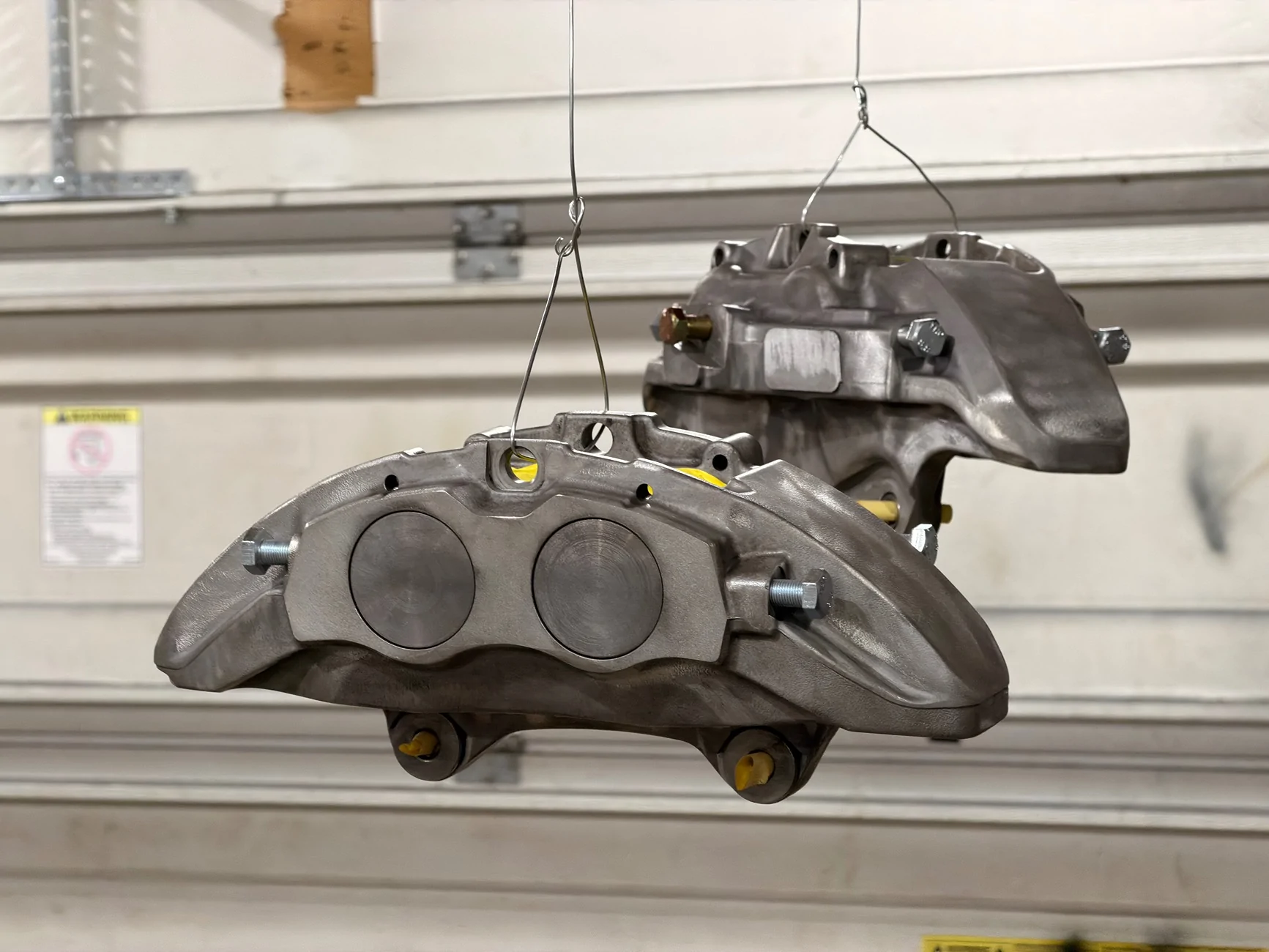

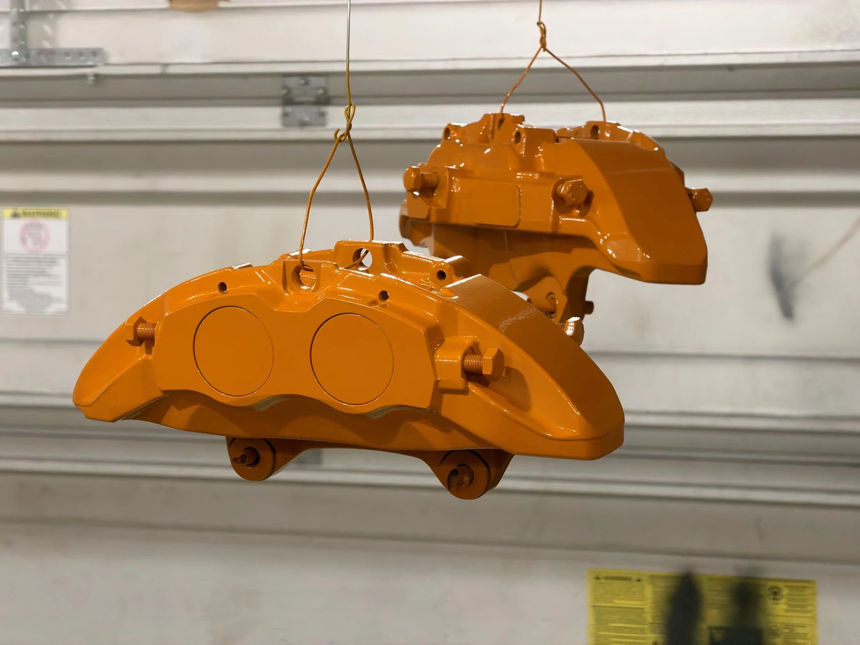

Got them all cleaned up after work today.
Hung them and primed so far. Doing a little more than needed… as is typical with me.
2K epoxy primer, 2k base coat, then a 2k clear.

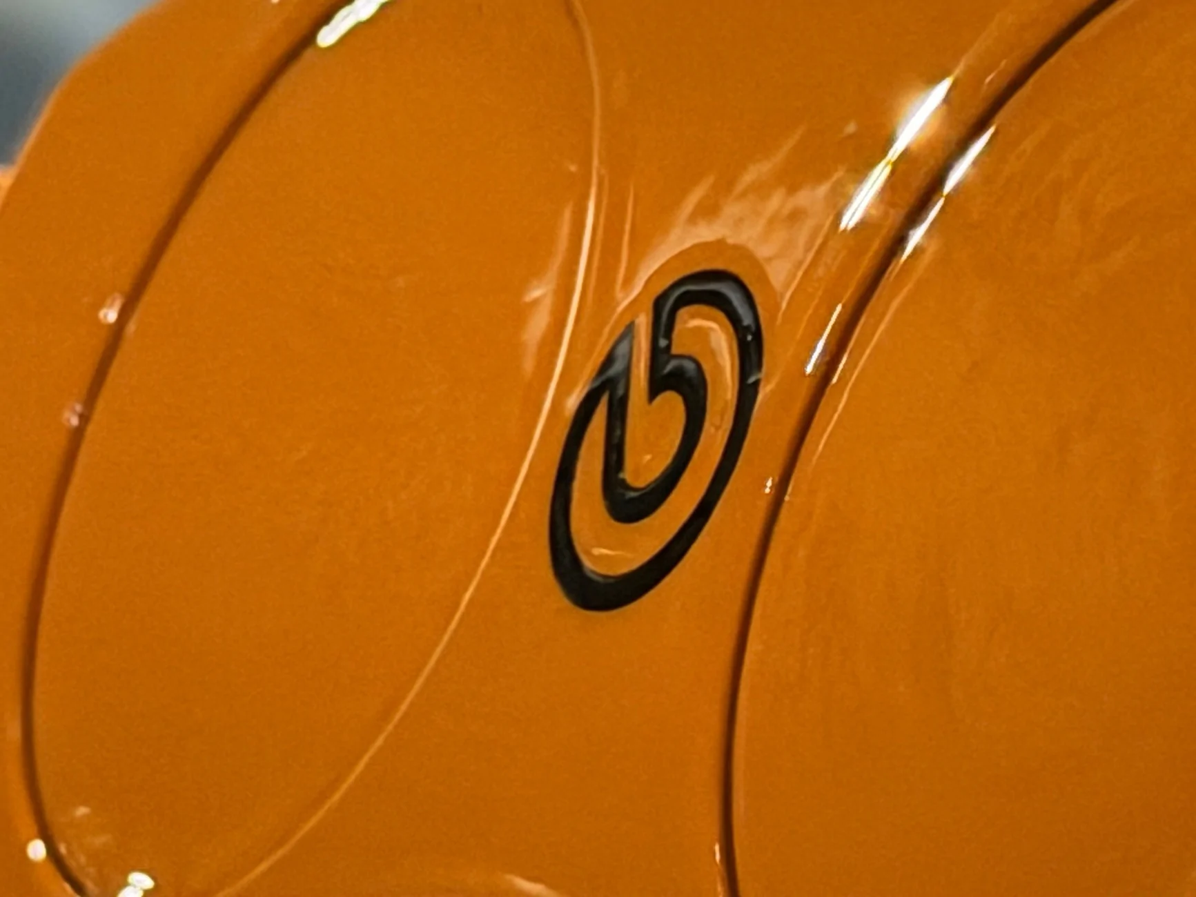

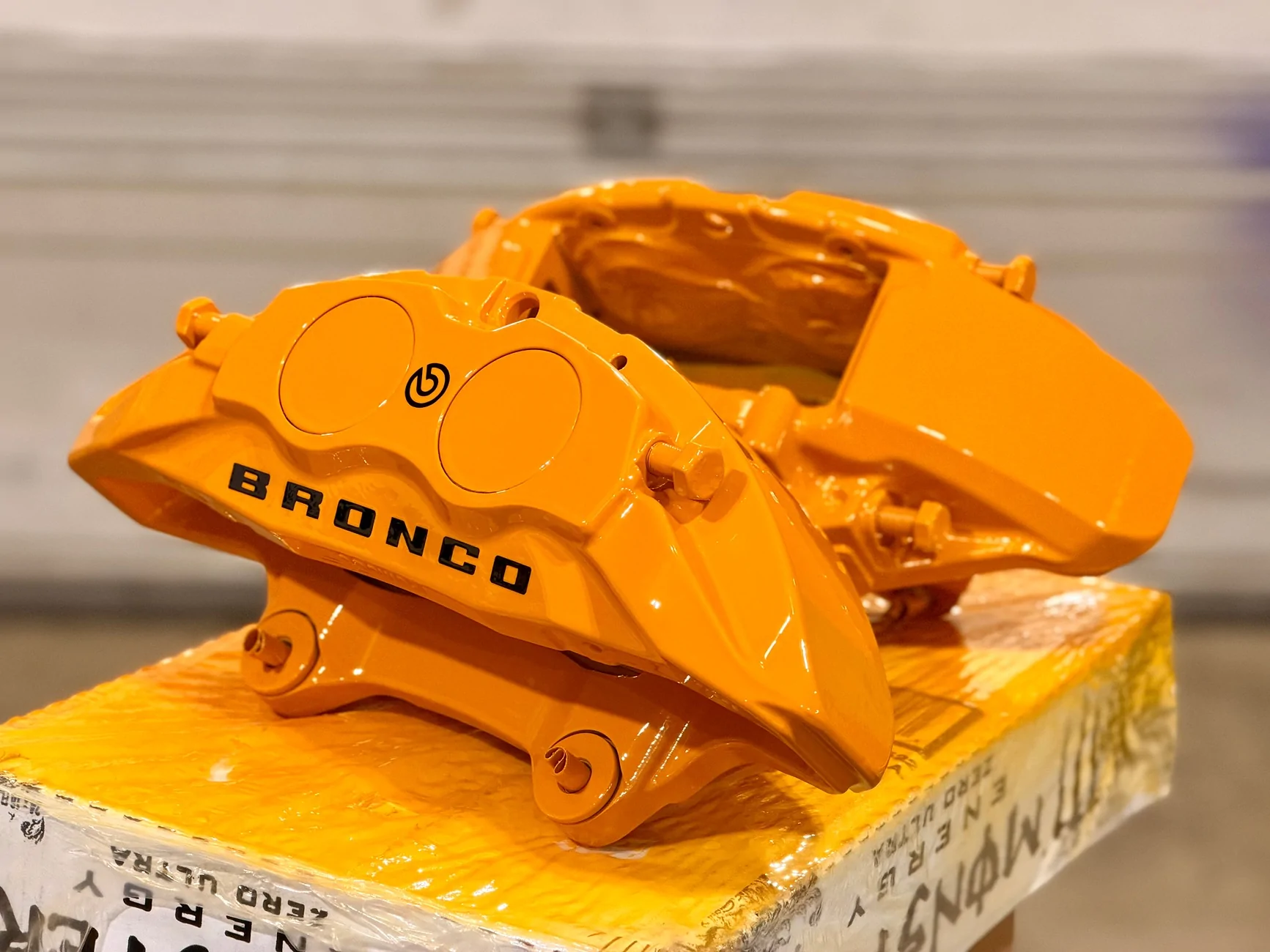

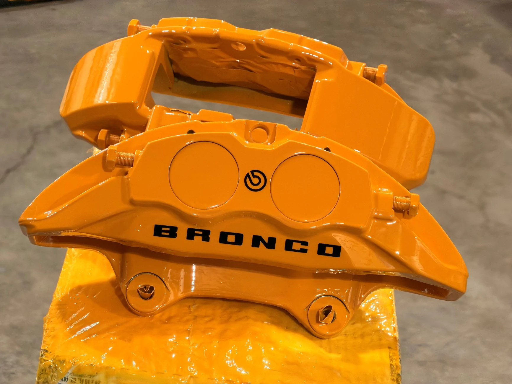

All done. Primed. Painted. Decals applied. Clear coated.
Those decals aren’t going anywhere ever. 😝

That looks fantastic!!!
Thanks! Now comes the fun (expensive) part of getting them to fit. Have to figure out a set of 18s that’ll fit on there without catching the barrel of the wheel.
From there, though… install is pretty straightforward.
