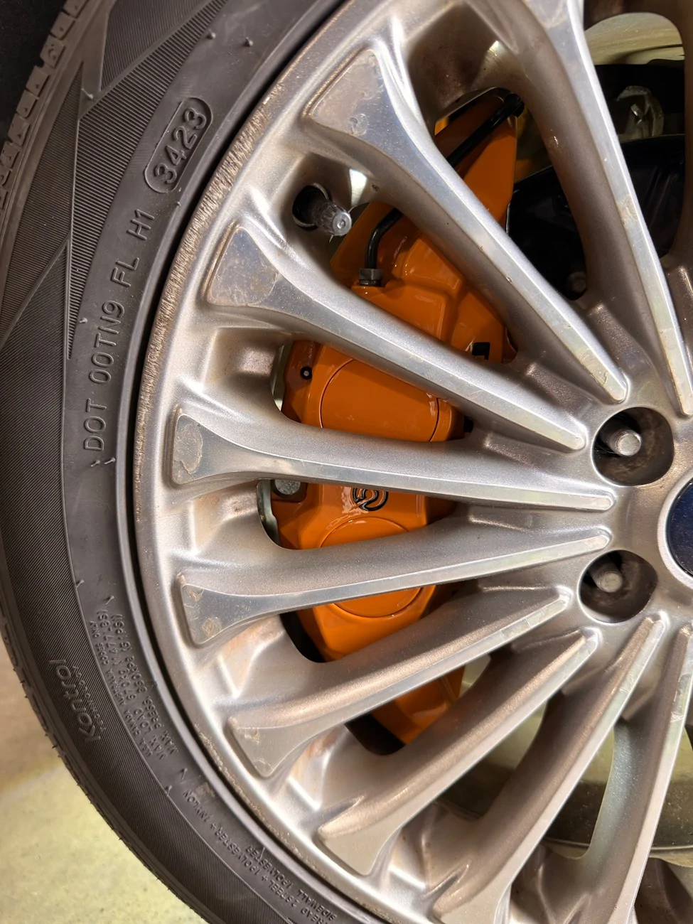

Amazing! So 17" wheels definitely won't fit then?
Haven’t had the time to check yet. But I’m going to go with my gut and say no. Lol

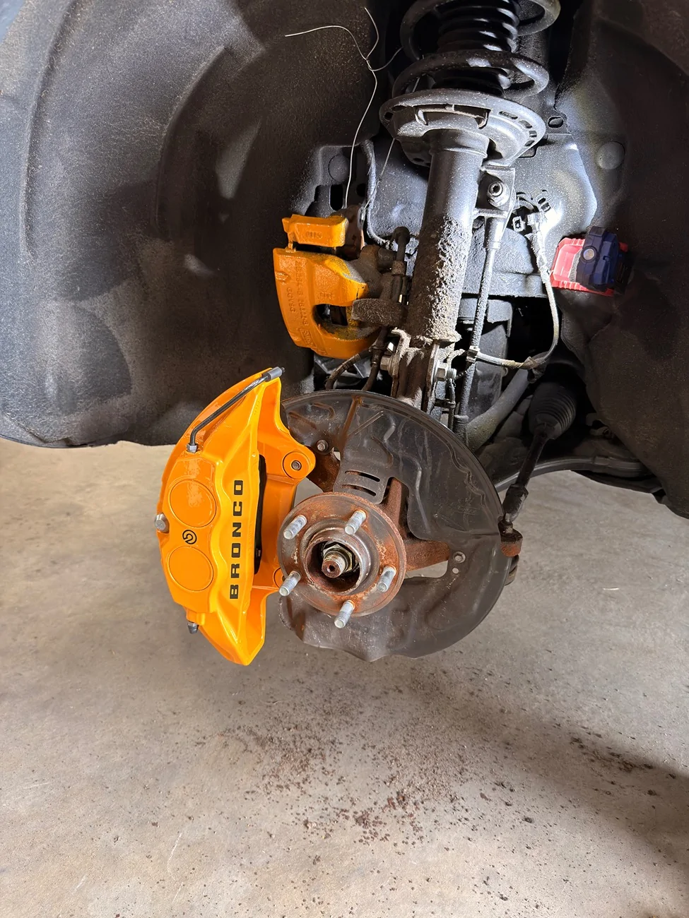

Ford Bronco Sport Mustang Mach E Conversion IMG_6714
Ford Bronco Sport Mustang Mach E Conversion IMG_6709
Ford Bronco Sport Mustang Mach E Conversion IMG_6710
All done. Primed. Painted. Decals applied. Clear coated.

These look AWESOME! If you can, try to see if the 17" wheels clear the calipers. If this can be pulled off without changing the wheels, I am going to follow your lead on this.
I’m going to try… not sure when I’ll have time to get to it… but I will try. Going to wrap the calipers with painters tape before I do it, so they don’t get scratched up IF they rub.

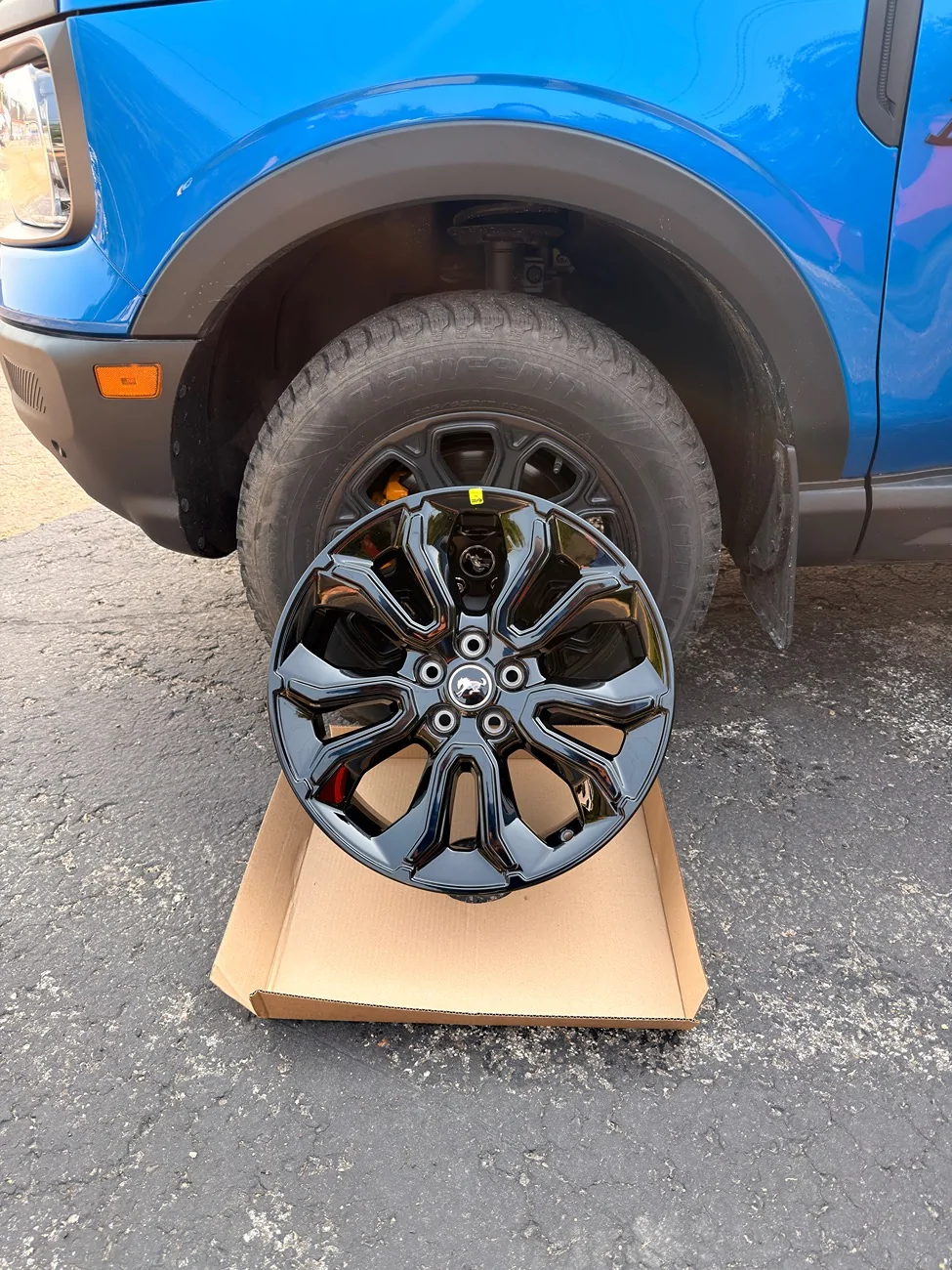

Ford Bronco Sport Mustang Mach E Conversion IMG_7038
Ford Bronco Sport Mustang Mach E Conversion IMG_7040
18s are the smallest wheel that’ll fit. 100% certain that 17s will not fit. Found a fusion wheel in 18” and it fit.
And yes, I’m aware it’s upside down… I just grabbed one to test fit.

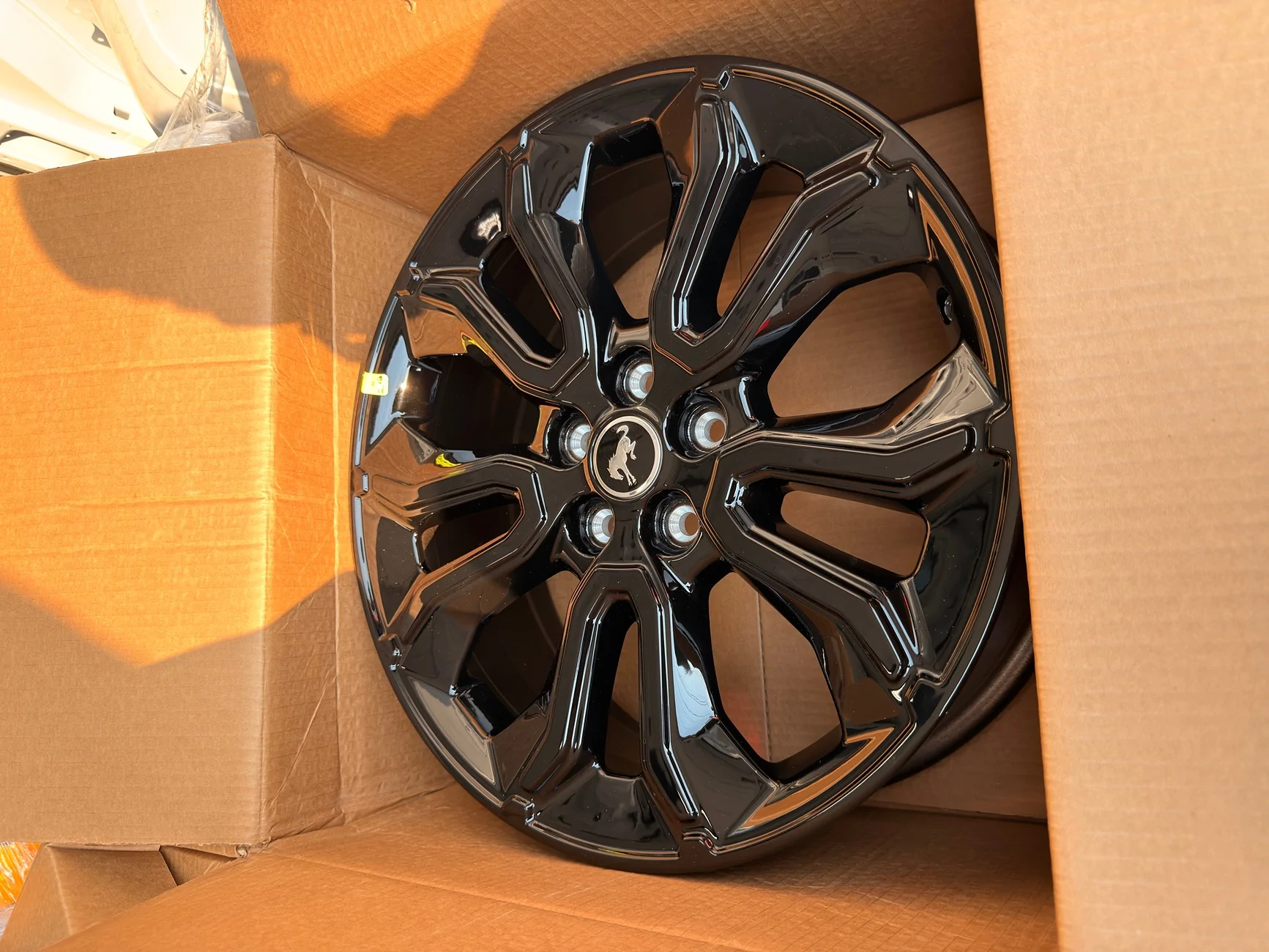

Wheels and tires are ordered.
Going with Ford Bronco 18x7 wheels, and Toyo Open Country AT III in 245/60/18.
Ford Bronco Sport Mustang Mach E Conversion IMG_7139

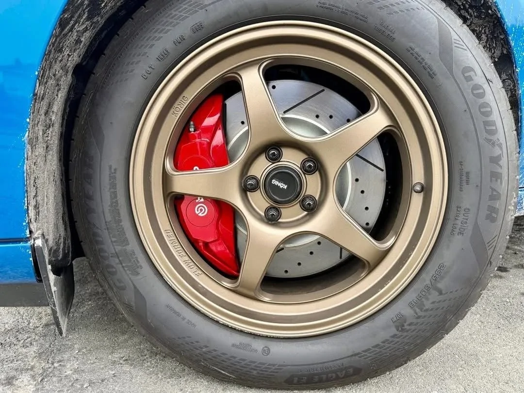

Saw a dude post in the Maverick group on FB running 18s… makes the calipers look absolutely chunky.

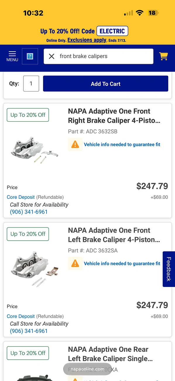

Also just learned, there is this option out there, from a Volvo S60R (2004-2007 body style) that uses the factory rotors and just needs a minimal amount of trimming the mounting surface approx .1”
They need new lines to mount from the chassis hard line to the caliper. Which is about $125.
I may order these and just compare and see what I think. It does have me wondering though… that same Volvo also has Brembo calipers in the rear… it would be complicated with the electronic parking brake, but anything is doable with enough time and brain power.
