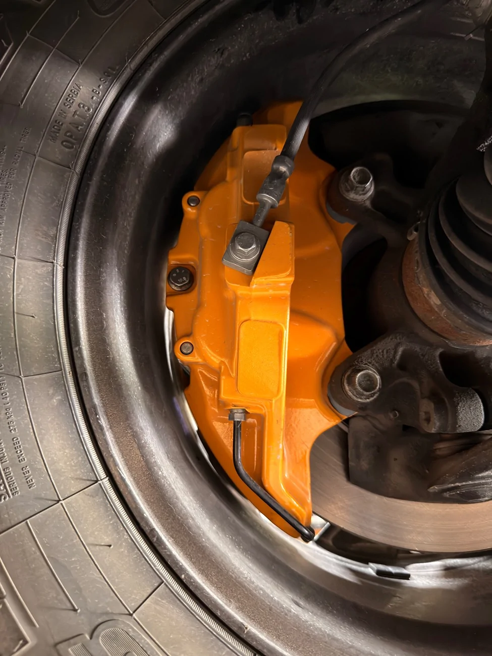

I don’t even know how to explain how nice these stop. Went and got the brakes bedded in, and when I got home the rain storm of the year started. So, good timing on my part on that.
But ya… ummm… holy crap stopping power.
Ford Bronco Sport Mustang Mach E Conversion IMG_7467
Your Bronco Sport looks great with those orange calipers!!
