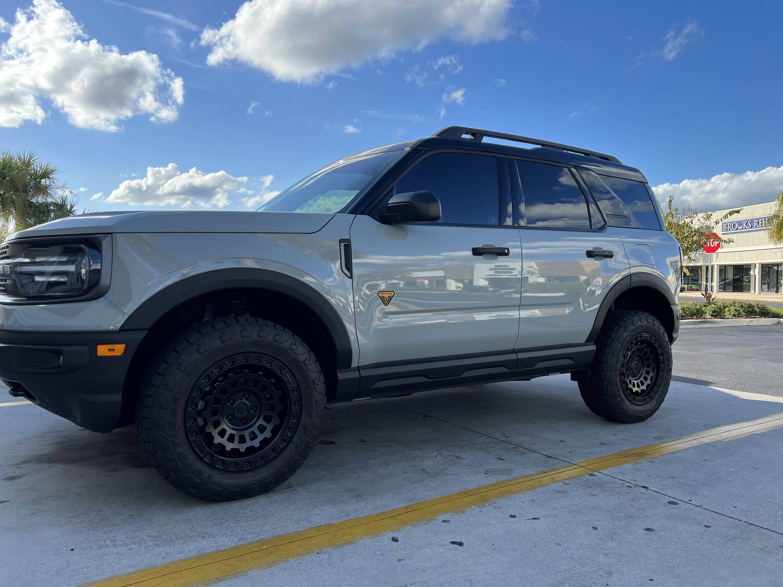

I have noticed more noise since having Fuel Black Zephyr wheels installed. All same specs as stock except the offset is 25 instead of 37.5 on the stock and the width is 8.5 inches instead of 7 inches like the stock rims. Would this cause more noise ? What is the minimum offset I could have without it causing noise, if this in fact what is causing the noise.

You shouldn’t have more noise. What kind of noise are you getting? You may get a little more road noise. Turn lock to lock etc and see if anything is touching. Eyeball it and see
1,415
1,450
I believe I read on this forum that the least amount of offset should not be below 30 if your stock is 38 .

It's hard to describe but if I was to describe it, it would be very loud road noise. It is really bad when I turn at a slow speed, sometimes when I am just going straight at a slow speed or slowing to a stop. It lessens as I speed up.

Have you double checked that all the lug nuts are tight? I’m just worried by your description of it being so much worse at lower speeds.

Yes they seem tight enough but I think I will bring it in tomorrow morning to get a balance and rotation done

Hey @cgui1971 ! How many miles are on your Bronco Sport now?
We wonder if the the bigger, heavier Fuel wheels have had a negative effect on your wheel bearings. The factory Badlands wheels are around 27 lbs each last we checked, and the Fuel wheels in that size are around 33 lbs. each. Usually, if you hear a strange or clunking noise when cornering, or have a shaking steering wheel, it could be wheel-bearing related.
While you're getting a balance and rotation, ask the shop to check for any noticeable play with the wheel bearings - if the tech is experienced enough, they will know what to do. If there is noticeable play, then the wheel bearing may be on its way out.
