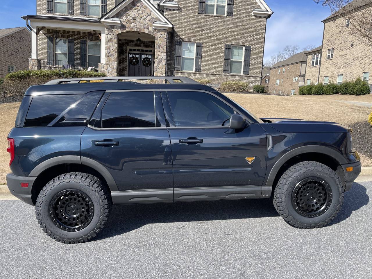

delm
Mar 1, 2022
268
540
Atlanta
It's the tires. You have meaty aggressive tread, and as others have said, more of it on the road.
I love the Fuel wheels, by the way, and I've got even bigger tires on mine. And yes - I have substantially more road noise than the Pirelli Scorpion 225/ tires that came on the car. I don't mind the noise, at all. I accept it as coming with this set up.
