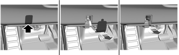

You want be able to get it out of park to push out of the garage for jumpers. At least in happened at home and not out in the woods.
Look for "Manual Park Release" in your Owner's Manual.
Use the manual park release to move your transmission from the park (P) position in the event of an electrical malfunction or emergency.
Activating the Manual Park Release Cable
  1. Apply the parking brake.See Electric Parking Brake.
Note: If the vehicle battery has run out of charge, use an external power source to apply the parking brake.
Ford Bronco Sport Lost my battery at 19 months {filename}
  1. Locate the manual park release cable access cover on the lower instrument panel dash to the bottom left-hand side of the steering column.
  2. Remove the access cover using a plastic wedge or pry tool.
Note: Do not pull the tether until you are in the driver seat.
  1. Power your vehicle on without your foot on the brake pedal.
Note: Do not attempt this procedure when the engine is running. Failure to follow this instruction could result in vehicle damage not covered by the vehicle warranty.
  1. Once in the driver seat, press and hold the brake pedal. Do not release. Pull the orange tether towards the driver seat until the tether locks in the override position. Leave the tether.
  2. If done correctly, a Park Not Available, Transmission Not in Park, or Shift System Fault appears in the instrument cluster display.
Note: Your vehicle is now out of the park (P) position and is free to roll.
  1. With your foot still fully applied on the brake pedal, disengage the parking brake. See Electric Parking Brake.
  2. Switch off the ignition.
  3. Disconnect the negative battery cable from the battery.
