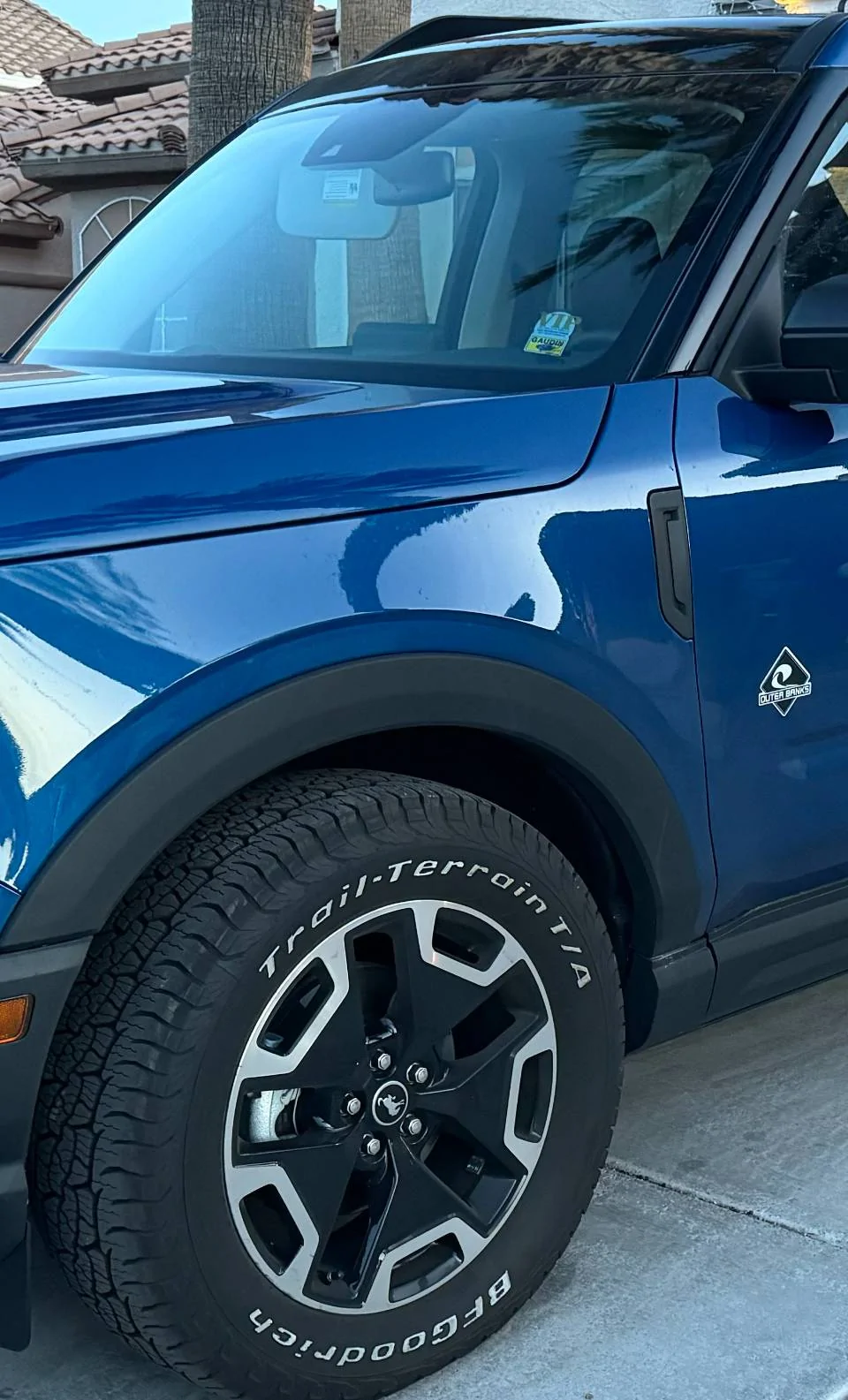

On BFG’s website they also vary in weight, the ones with raised white outlined letters are 7 lbs heavier than the ones without!
Wow, that white text is heavy!

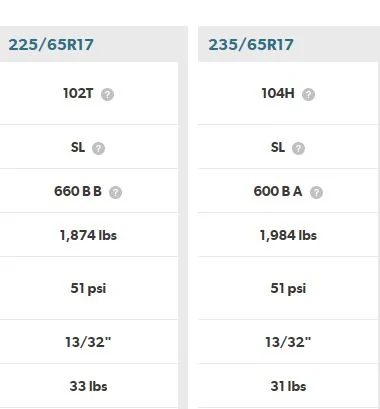

I've been doing comparisons on Tire Rack, and have run into a couple oddities too. Like it shows the Falken AT3W is heavier in 225 (33) than it is in 235 (31).
It also shows the 235 Falken AT-Trails weighing in at 36 lbs,5 more than the AT3w's. Seems fishy.
As far as the stock 225 Pirelli ATR's that I have, shows them at 25. So if I go up to something around 40lbs, like the Mickey Thompsons, it would be a 60 lb difference. I can't figure out how big of a deal that is, or not...
Who out there has gone from a stock tire, like the Pirelli, and moved onto a notably heavier tire (like up around 40lb)? And how has it worked out? Any noticeable negative difference?
Ford Bronco Sport Lighter Off Road Tires tires
Faulken AT3 at the 235 size are specifically made for Ford as the OEM tire for the BS. Because if this they weigh less, are less aggressive, and result in higher mpg for which they were designed to be within spec for Ford. That’s why even the narrower 225 weighs more. It’s manufactured at a different spec to the 235 OEM Ford tire size.
I run Toyo AT3 245s and get about 20-21 mpg per the computer. Actually closer to 20 or slightly below when hand calculated.
3,471
5,066
I've found a couple instances where TireRack's specs are different from those listed on the manufacturer's website. I don't know where/how the disconnect occurs, but consider checking specs at the manufacturer's site before making any decisions.
