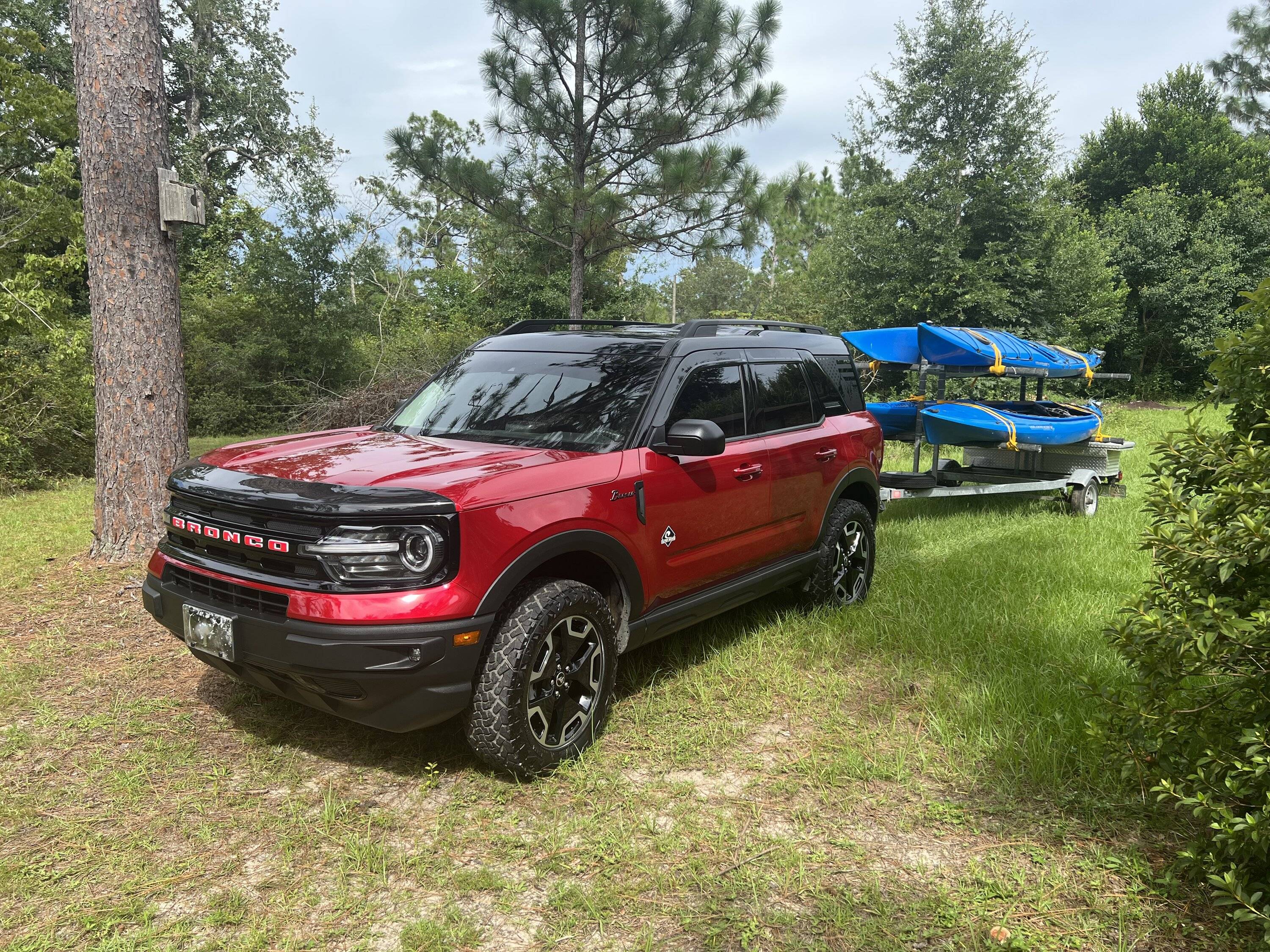

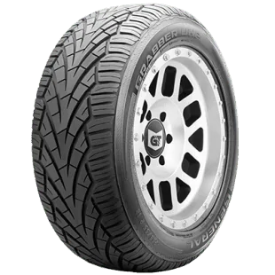

I put the Rough Country 1.5" lift on my Outer Banks. I then put these tires on it, General Tire Grabber_UHP255-55-R18 . The tires do clear without rubbing but there is little room. I choose this tire for the loose dirt and sand we drive in. Any other tire of this diameter and width should work as well. I have almost 10,000 miles on the lift kit and have not issues or problems. I hope this helps.
Ford Bronco Sport Lifted tire size.. beating the issue to death Grabber_UHP255-55-R18

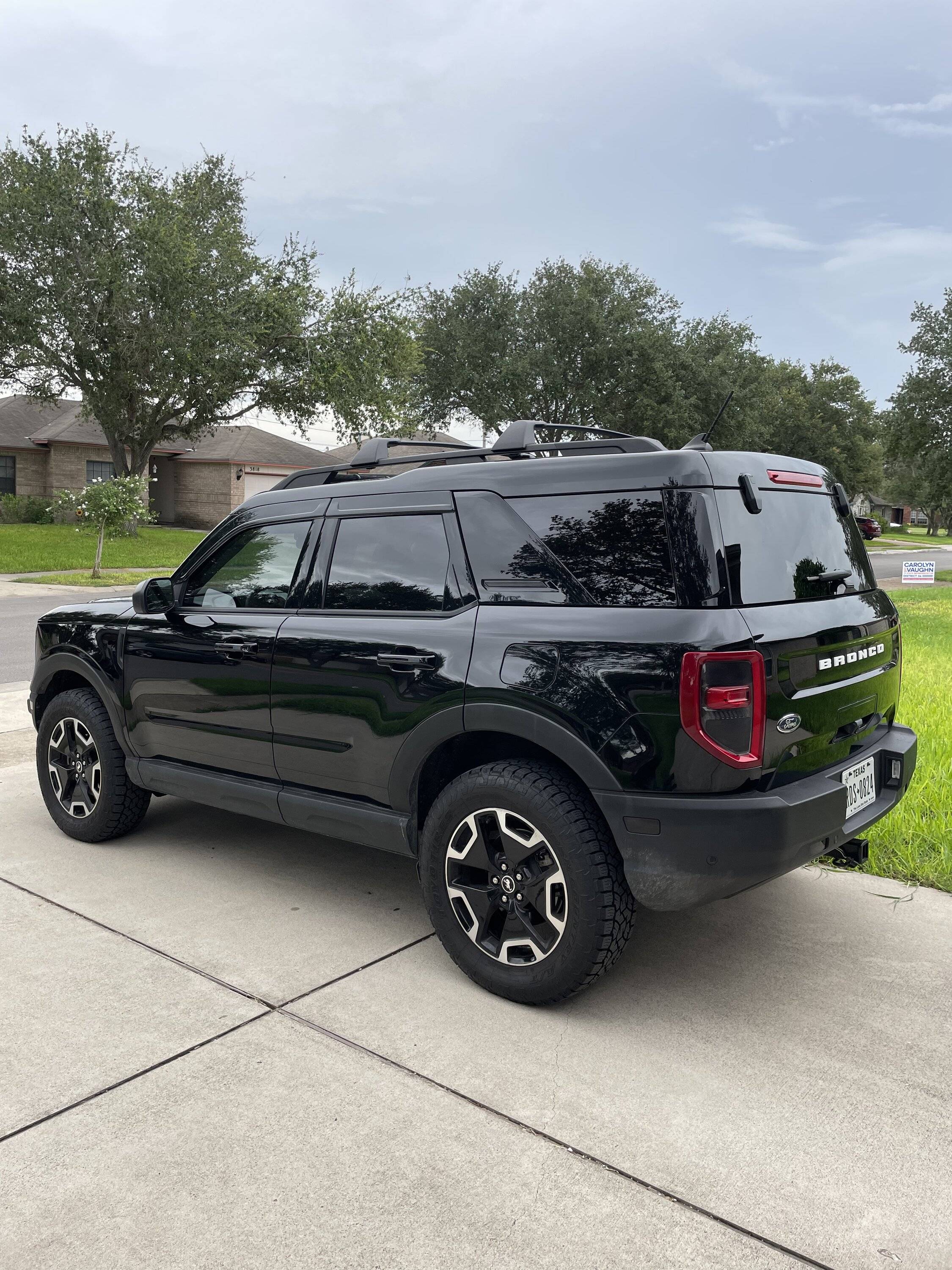

245/65 18 Venom Power Terra Hunter X/T
Doesn’t scrub at all, even at extreme angles. Louder than I anticipated though.
If you have the cheaper RC 1.5 lift I would recommend remove the sway bar link drop brackets and order the longer ones from HRG.
Ford Bronco Sport Lifted tire size.. beating the issue to death 31089196-8138-430F-ACB7-F23CEC8E41B3

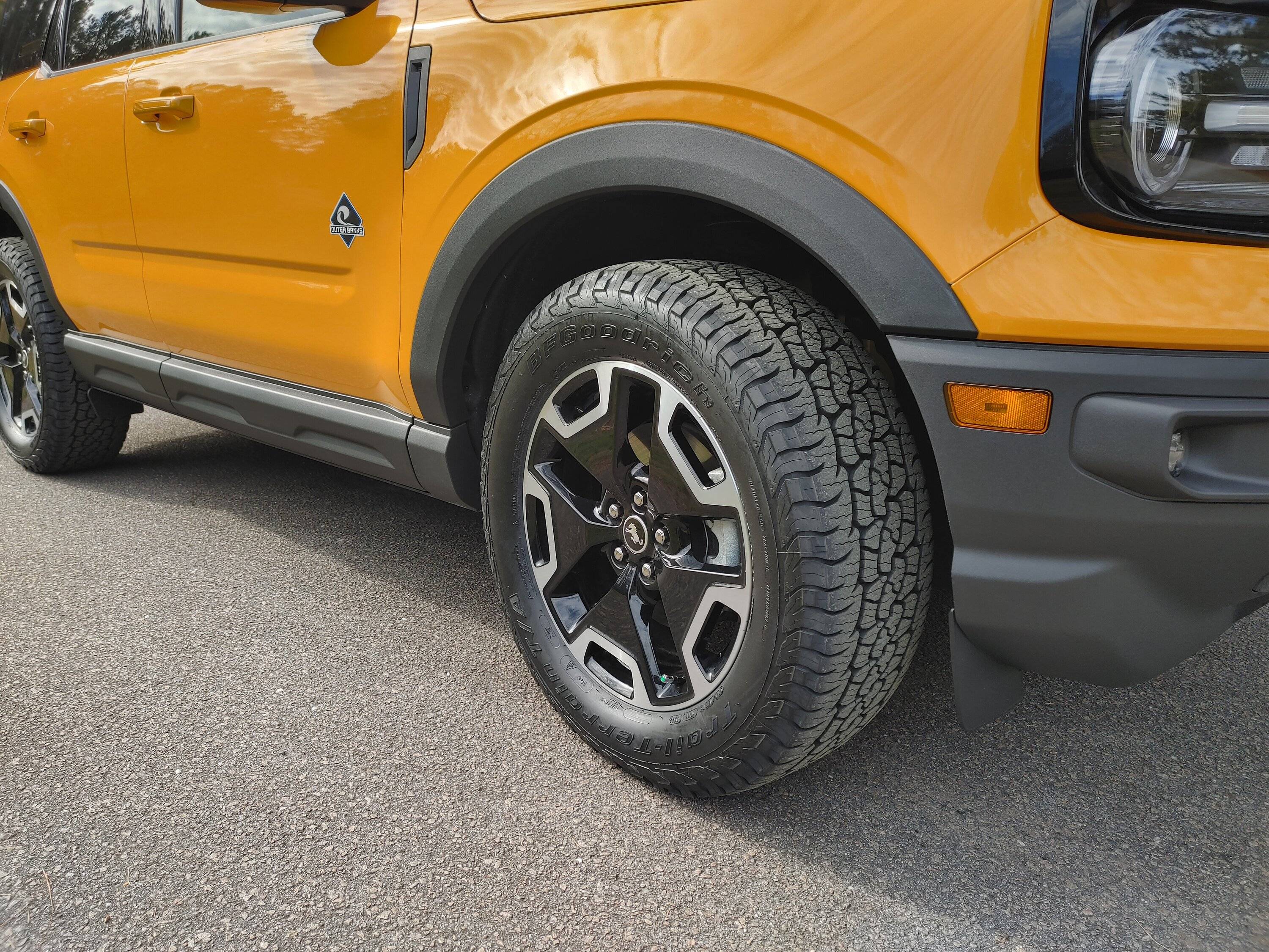

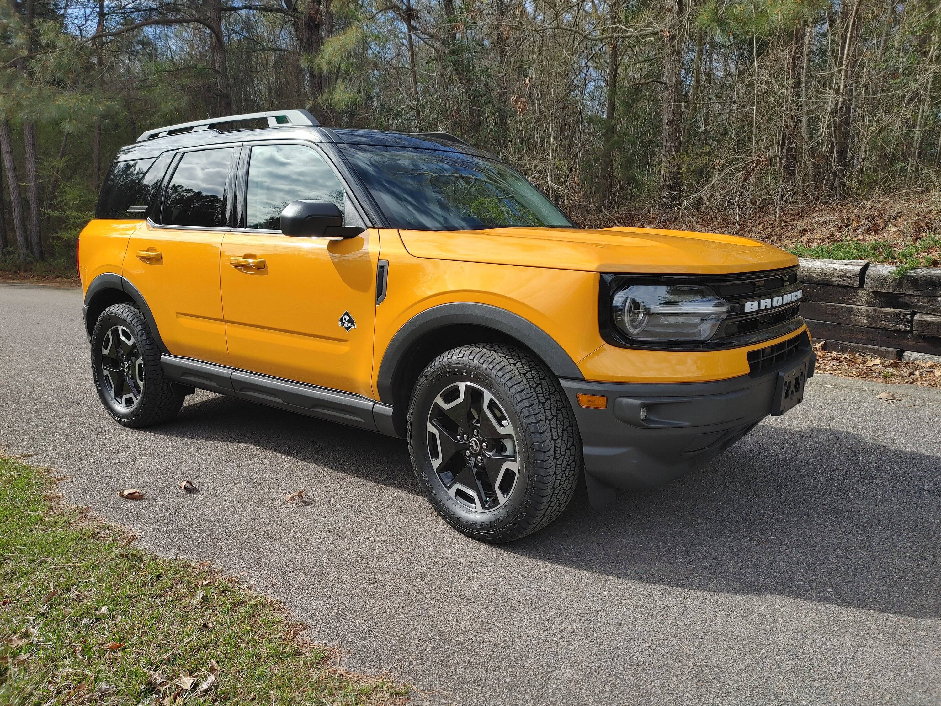

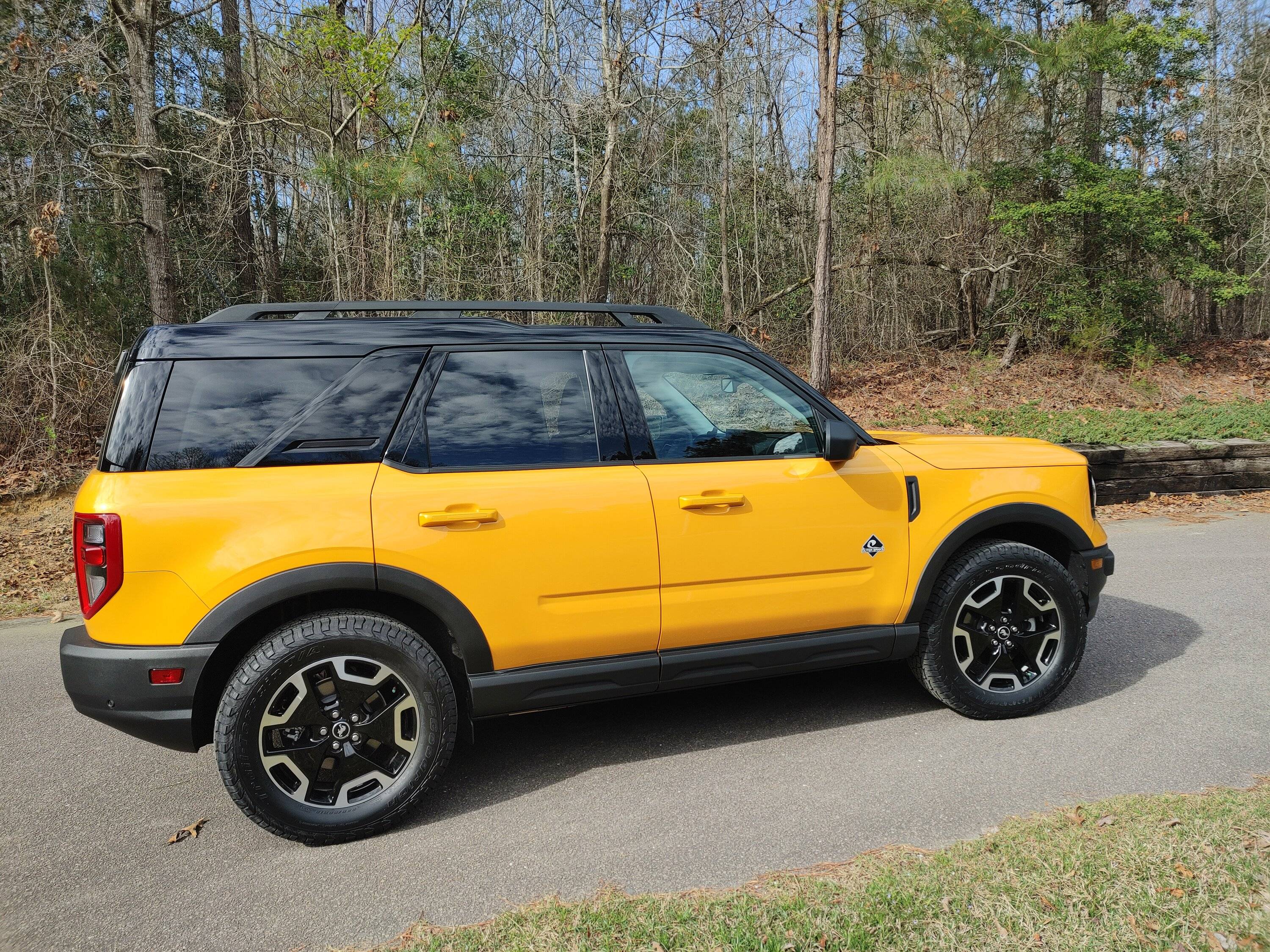

Mine are BFG Trail-Terrain 245/60-18 on a stock 2022 OBX
Ford Bronco Sport Lifted tire size.. beating the issue to death 0311230931
Ford Bronco Sport Lifted tire size.. beating the issue to death 0311230931a_HDR
Ford Bronco Sport Lifted tire size.. beating the issue to death 0311230932_HDR
