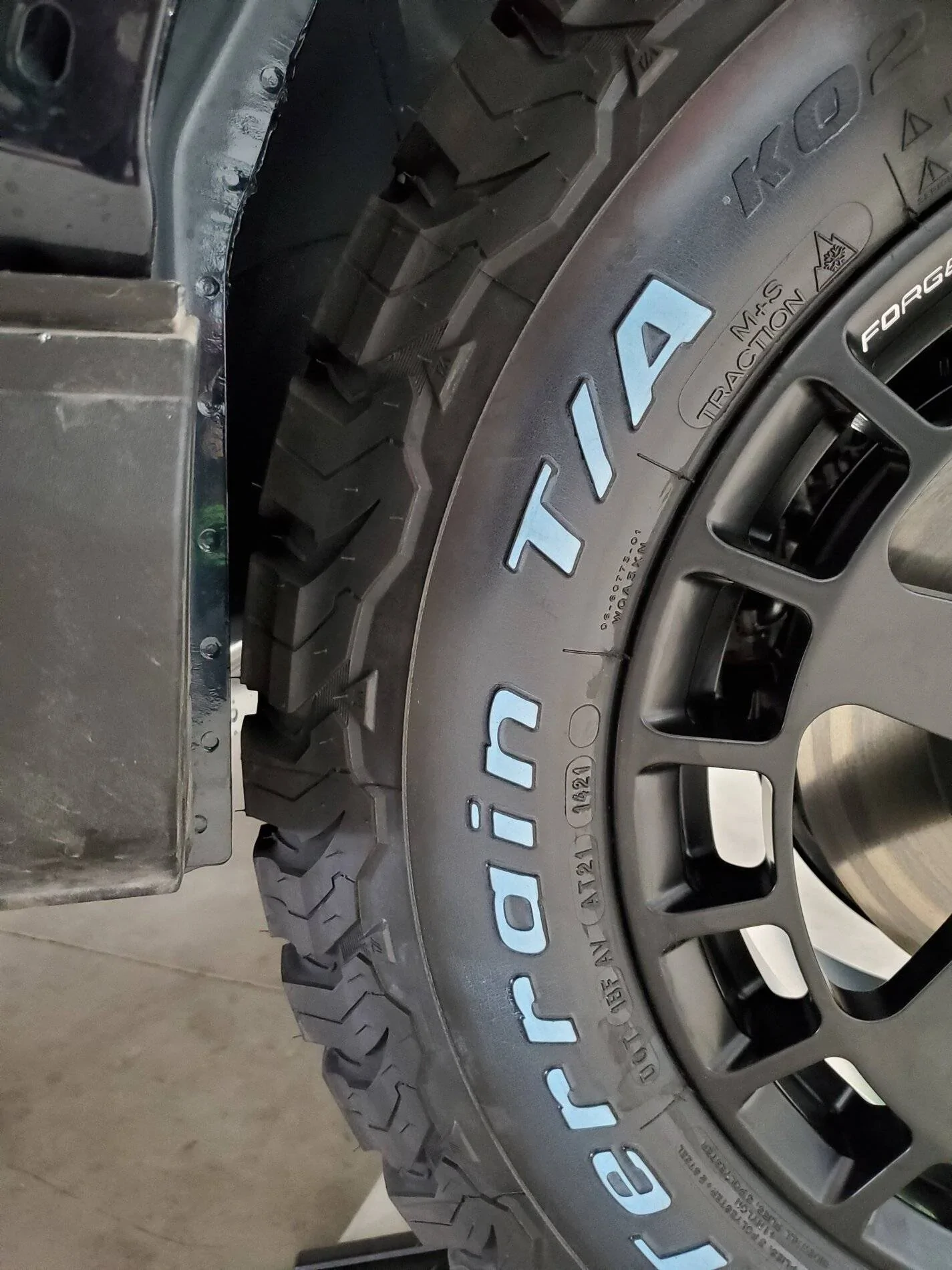

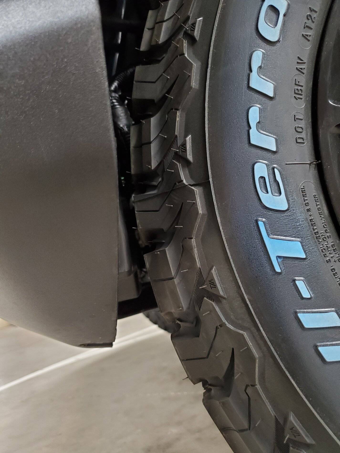

Yeah, I thought it looked a little beefier than the 245/65 people usually put on. Looks awesome. I was going to try to fit 245/70 on mine after the lift but may do what you did.
Any rubbing at the pinch weld in the backside of the front fender?

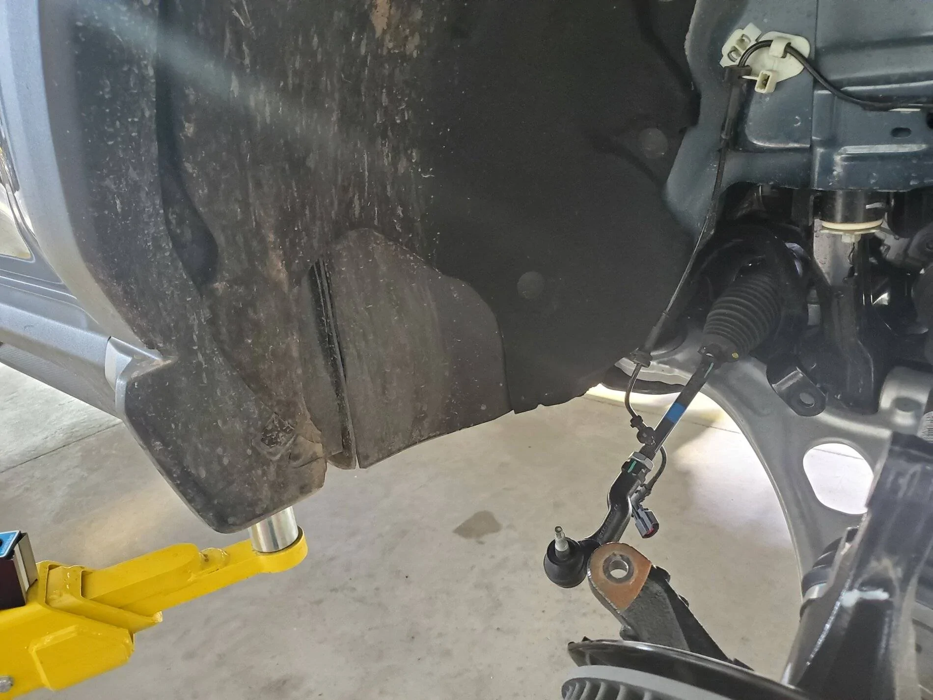

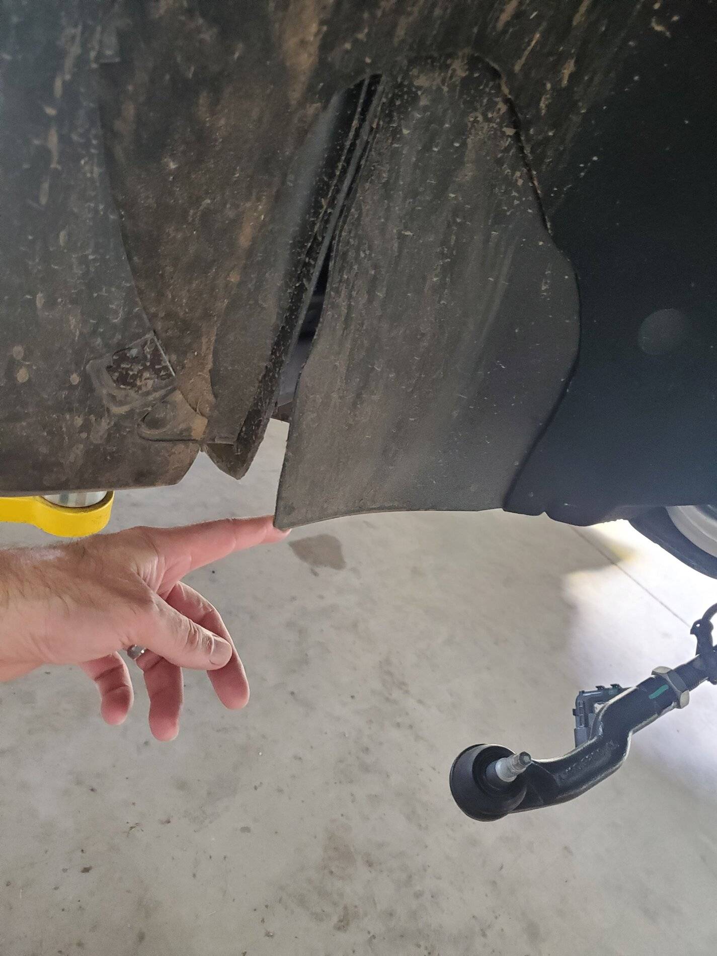

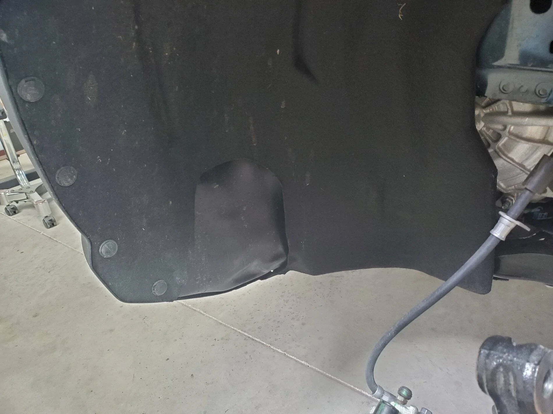

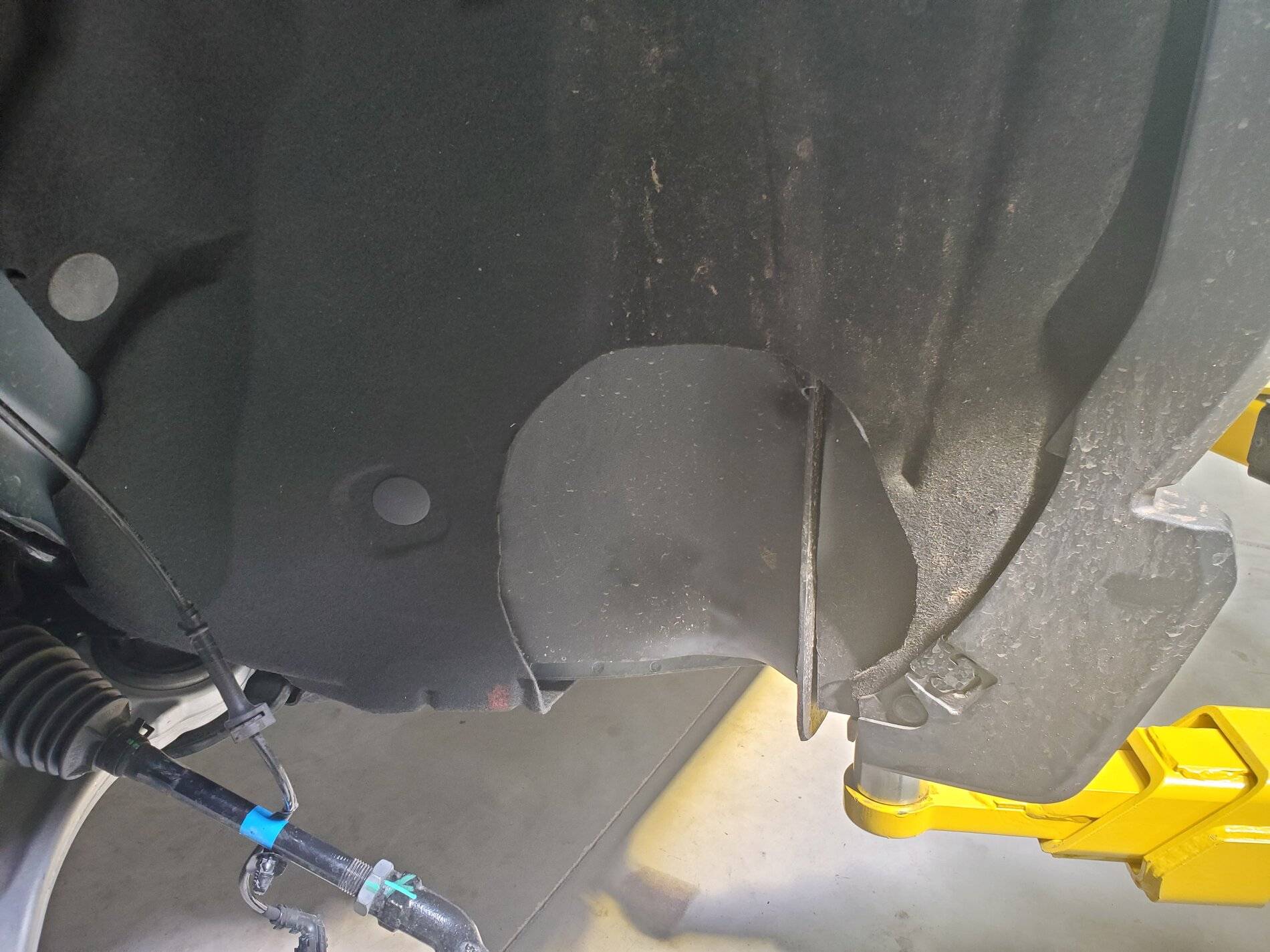

They rubbed on the felt liner but missed the pinch weld by a quarter inch. I took some pictures.
I trimmed the felt a little (about a 6-8inch oval. Then I thermoformed some Kydex sheets to the fender well behind the felt. I used a heat gun to soften the Kydex.

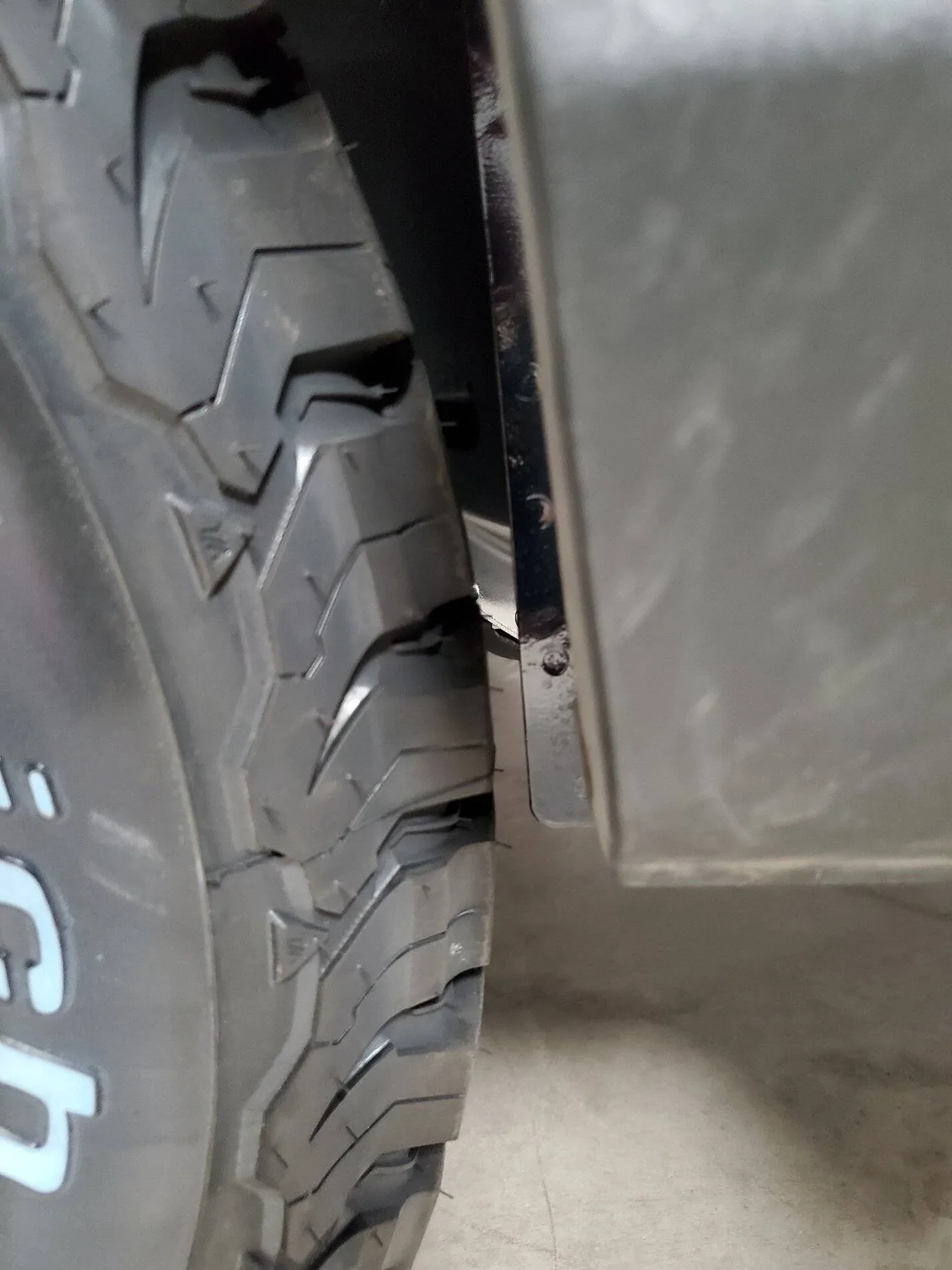

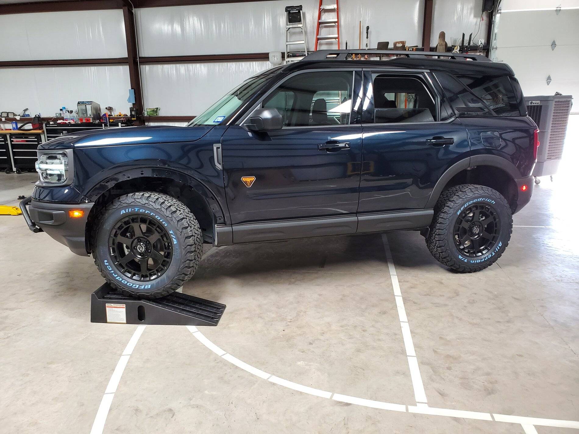

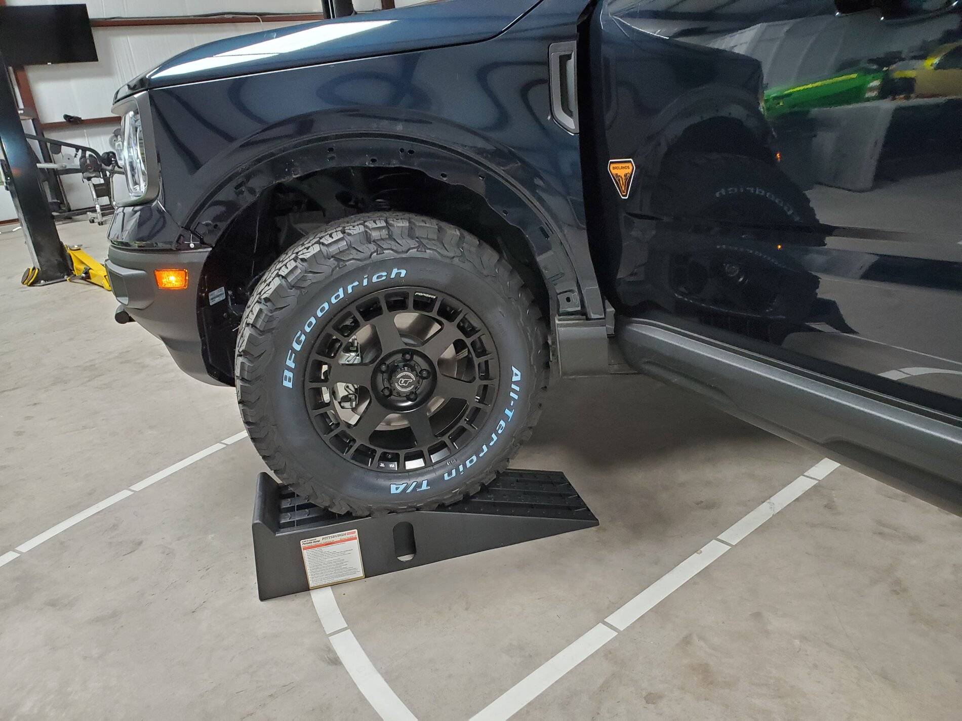

I used a grinder to take a little off the pinch weld and painted it with black paint.
I cut a slit out of the Kydex sheet and left the lower pinch weld bare. I flexed the front suspension on my ramps to check clearance.
